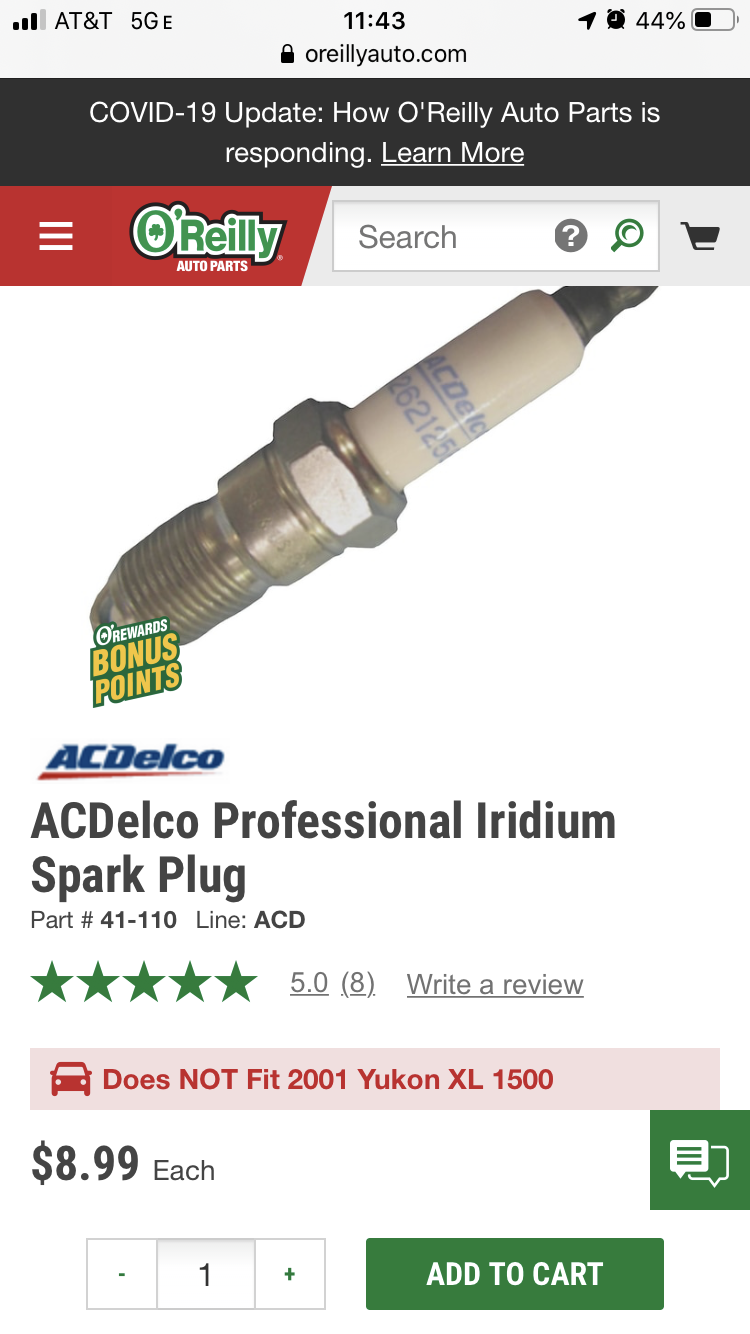

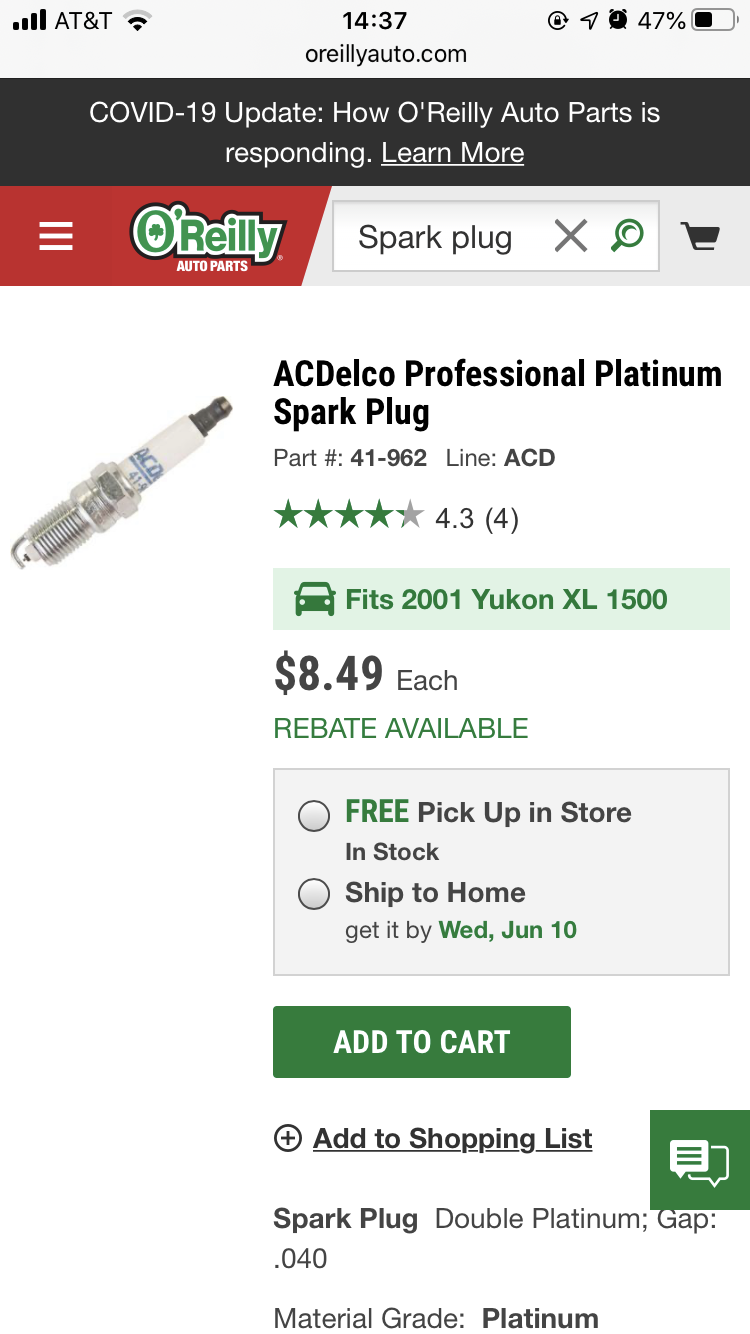

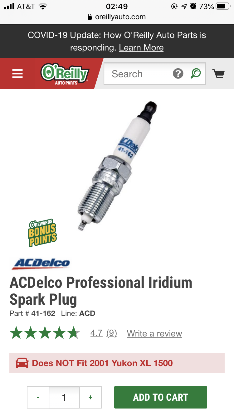

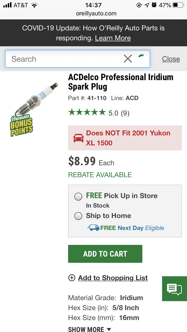

I pondered whether the switch back to platinum for pre-07 trucks was a way to remain competitive price-wise on maintenance of the older trucks, but that however doesn’t make much sense since:
41-110 is $8.99
41-962 is $7.49 (only .50 cents less)

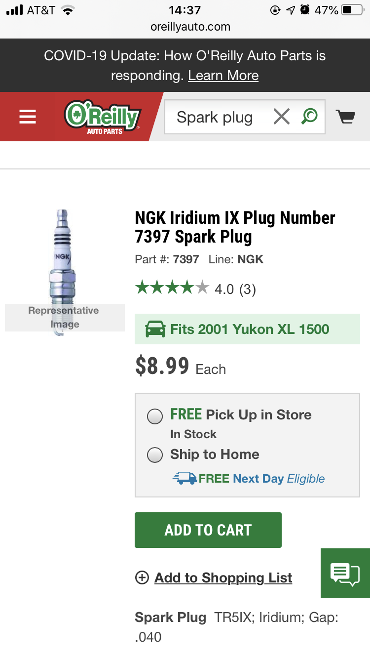

And if Iridium is no longer approved for use with the 5.3 Vortec... Why is the NGK TR5IX (7397) Iridium plug on the O’Reilly fit list???

Here is an interesting summary of the “best” plugs for the 5.3 Vortec:
https://sparkplugsguru.com/best-spark-plugs-for-5-3-vortec/
Although it lists 41-110 at #1, the second on the list is the NGK TR5IX, in bold letters states that it will prevent misfire.
While the third is the 41-962 Platinum, highlighting in bold that it will increase MPG.
Gimmicks? The saga continues.
