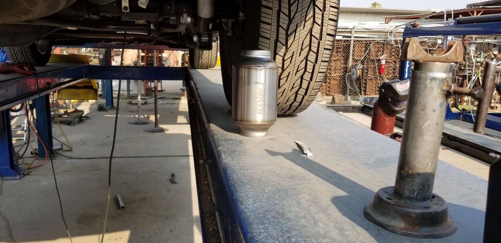

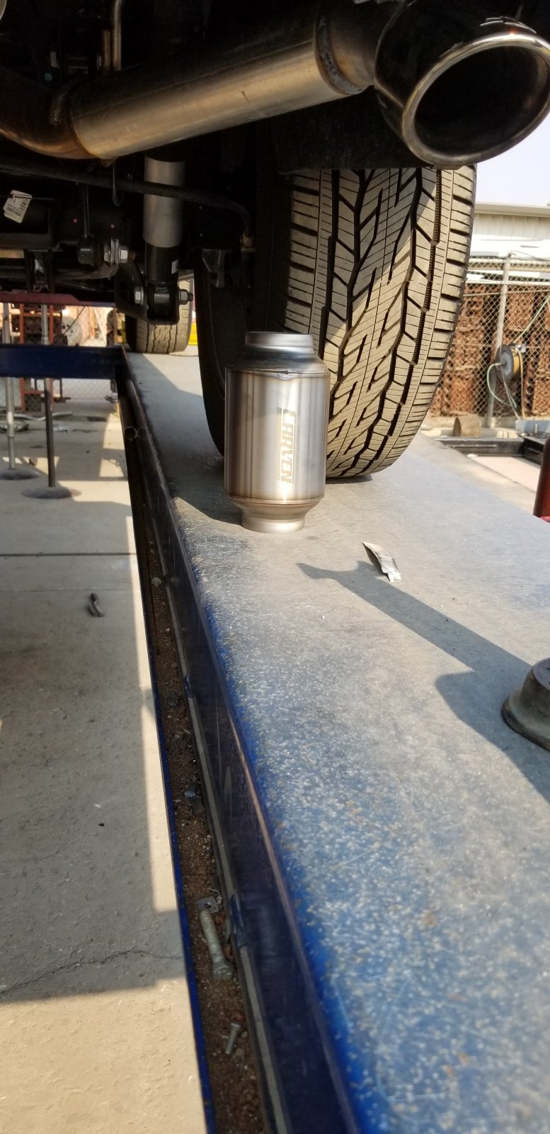

Mar 5, 2019
2018 Tahoe premier. I installed a carven muffler and removed the resonator. I kept the original cheome Chevy tip. We get no drone noise inside cab. It belong to wife, she loves it. Stays peaceful until you step on throttle. I do recommend to remove resonator.
