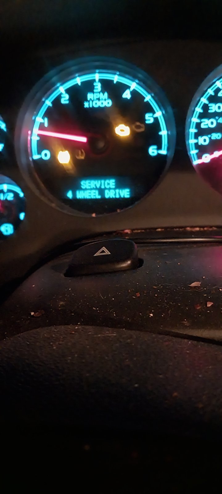

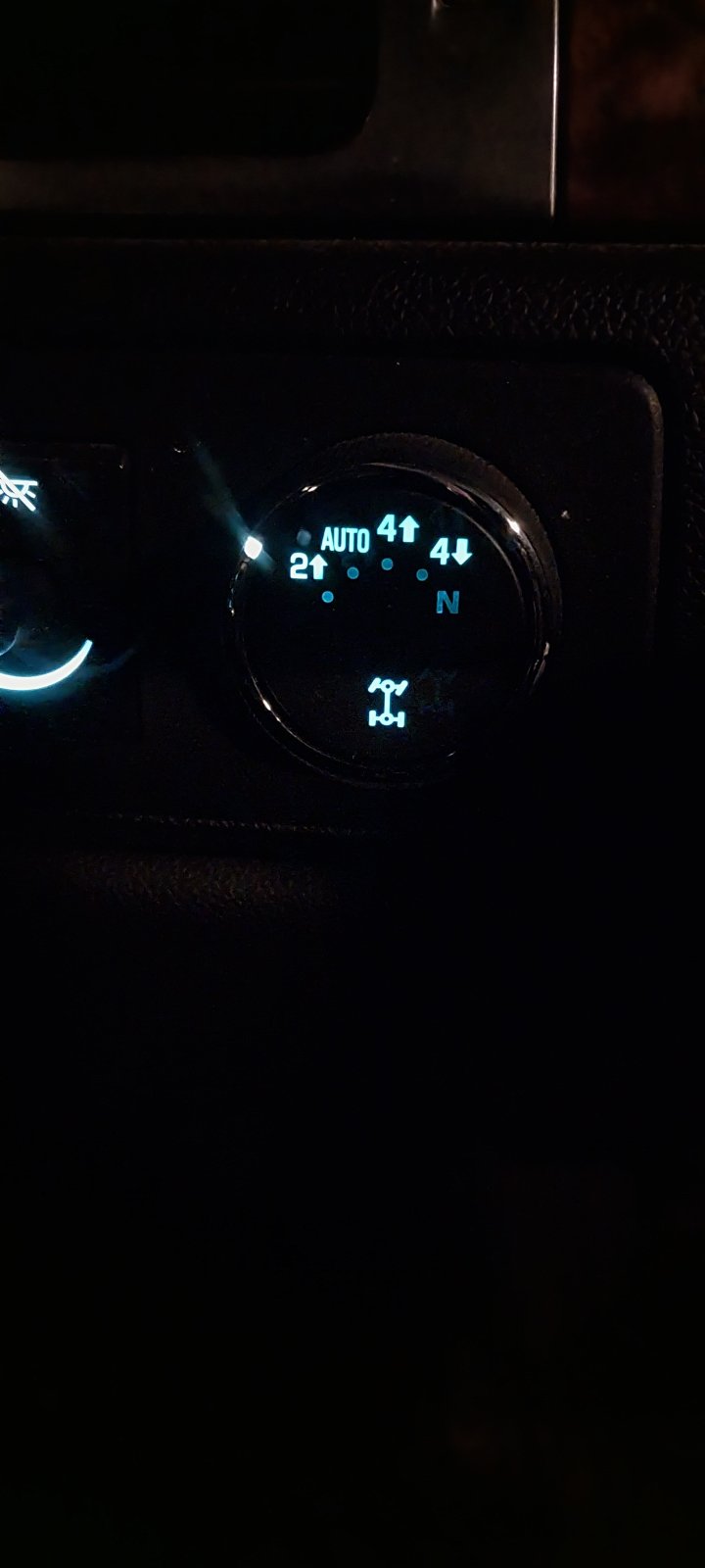

Appreciate it. Well, my 4WD has been faulty for over 5yrs. Sometimes the light comes on on the dial and shows it in 2WD but only for a couple days and then it's off and I get the Service 4WD error. I have replaced or re-done every ground cable, replaced the TCM module, toned out and ohm checked every wire to and from the TCCM to wherever....It is getting 12v to the TCCM but that selector dial is dead (replaced also) and sometimes at random every few months I it suddenly on and I can cycle the 4WD modes.
The strange part of it all..... When I start the vehicle the dial is dead....but the second I put it in reverse or drive and a little gas...the dial "boots up".. Like there is a short somewhere or a bad capacitor...Then some days (months) it's dead completely... I have not been able to find the TCCM under the number I pulled out... and I still am not sure what the problem truly is. I was just told that the front wheels should free spin....yet when spinning them by hand as fast as I can....they only go maybe one rotation and stop after letting go. Friend said it may be stuck in 4WD but not sure. I just know that I am exhausted with trying to get this thing back to a check engine light off and 4WD working normal or humming noises etc not showing up every couple months. 265k on it now so I don't think she will be crisp ever again...

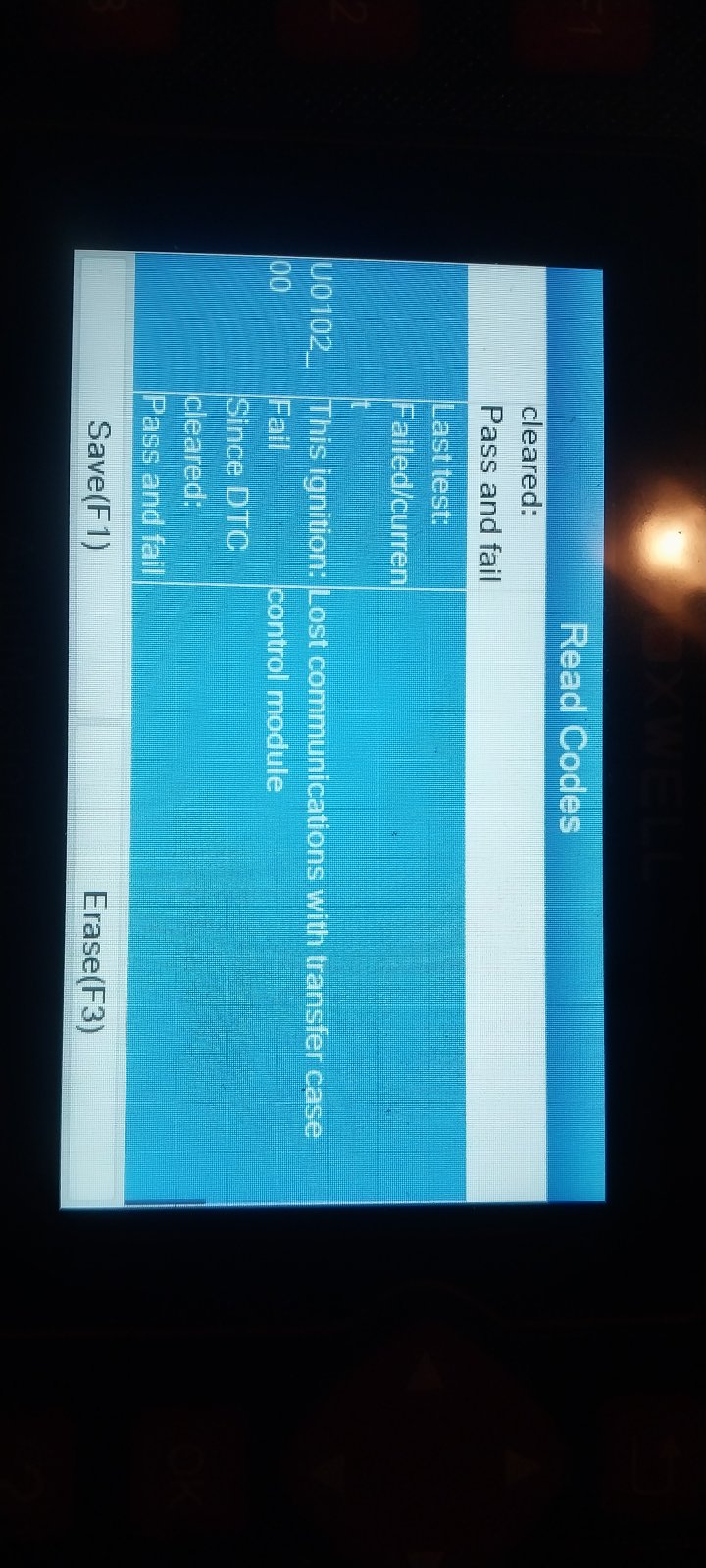

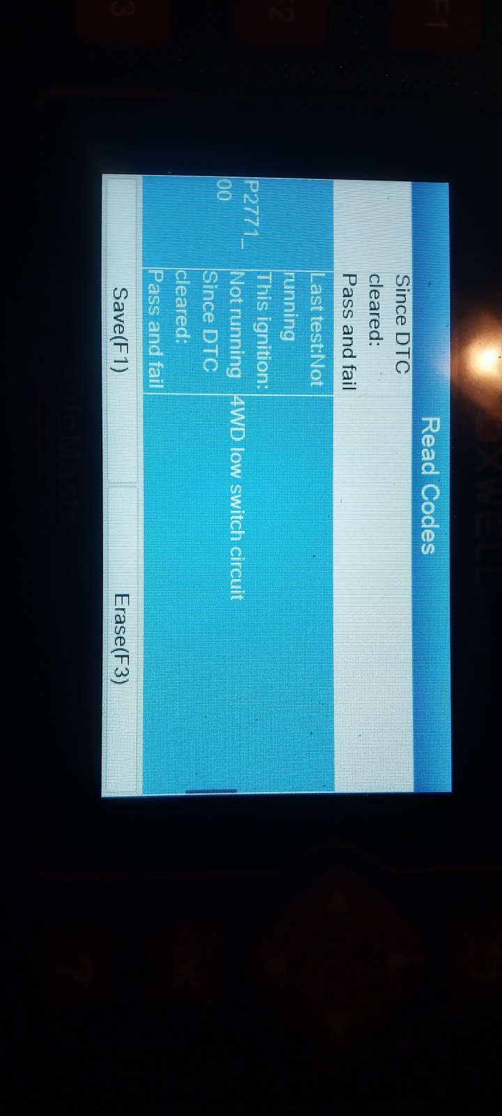

Why not put a good scanner on it when the Service 4WD error shows up? Find the C-code that is causing the Service message. Or have you already read the chassis code(s)?

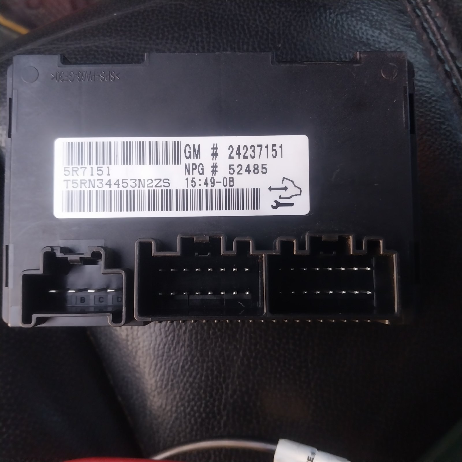

Appreciate replies from everyone thus far. Here is my current scan...and that TCCM I pulled out and can't seem to find a reman of.

I've been wrestling with this 4WD issue for years... I've replaced nearly every electrical component involved with the 4WD system as well...and you know that saying "always go with your first instinct"?.. I should have. The issue was the TCCM (not to be confused with the TCM). You see, randomly that selector dial would boot up and everything would work as it should for a week or so...Then, it would be dead for a few months, then work. Cycle repeated for years but the time between working and not working grew longer. Usually when temps changed is when it would be on, especially when a cold front moved in (Oklahoma). Myself and others figured this to be a grounding issue somewhere as the cold contracts the wire. With have over 250k miles and a little corrosion here and there from the vehicle being from FL...I went full out replacing nearly every chassis ground I could find. Some, I replaced the whole wire. No change in the results. I replaced the TCM with no change and also had transfer case rebuilt, encoder motors, etc. When I replaced the encoder on the differential, the dial lit up (which I also replaced). The system worked for a few weeks and then it was off again. I was convinced this was a wiring issue somewhere... The one thing that was the hardest to find was the TCCM for my year.. Dealer told me it HAD to be one from 2007....I couldn't use one from 2008 etc.. That TCCM from dealer was $600 while one from a 2008 was only $340. At this point I decided I don't really use the 4WD anymore now that I don't drive out to oil fields on service calls, which was when I really used it anyway (those kids loved running those company trucks on the muddy road to the rig and digging the deepest rut they could)...
Well, with this other issue in the post...I found one at a junkyard for $85 and put it in...presto. Everything works perfectly fine and haven't programmed it. The droning sound under my feet is still there but not quite as loud. I think I was stuck in 4WD and burned up some bearings....Just don't know if it's from the newly rebuilt transfer case or the front diff... I know I can feel the "waah waah waah" low droning noise in the floorboard right where the pedals are so....The damage has been done...However, the 4WD now working eliminates 1 of 2 codes that has kept the check engine light on for 3yrs at least.. The other is the oil pressure being at zero. I replaced the sensor on back of intake years ago and I know the screen got clogged not long after when I ran some seafoam through the engine...So, I will check it again and then onto the tube in the oil pan (sigh).. Would be awesome to have my remote start and everything functioning normal again....
