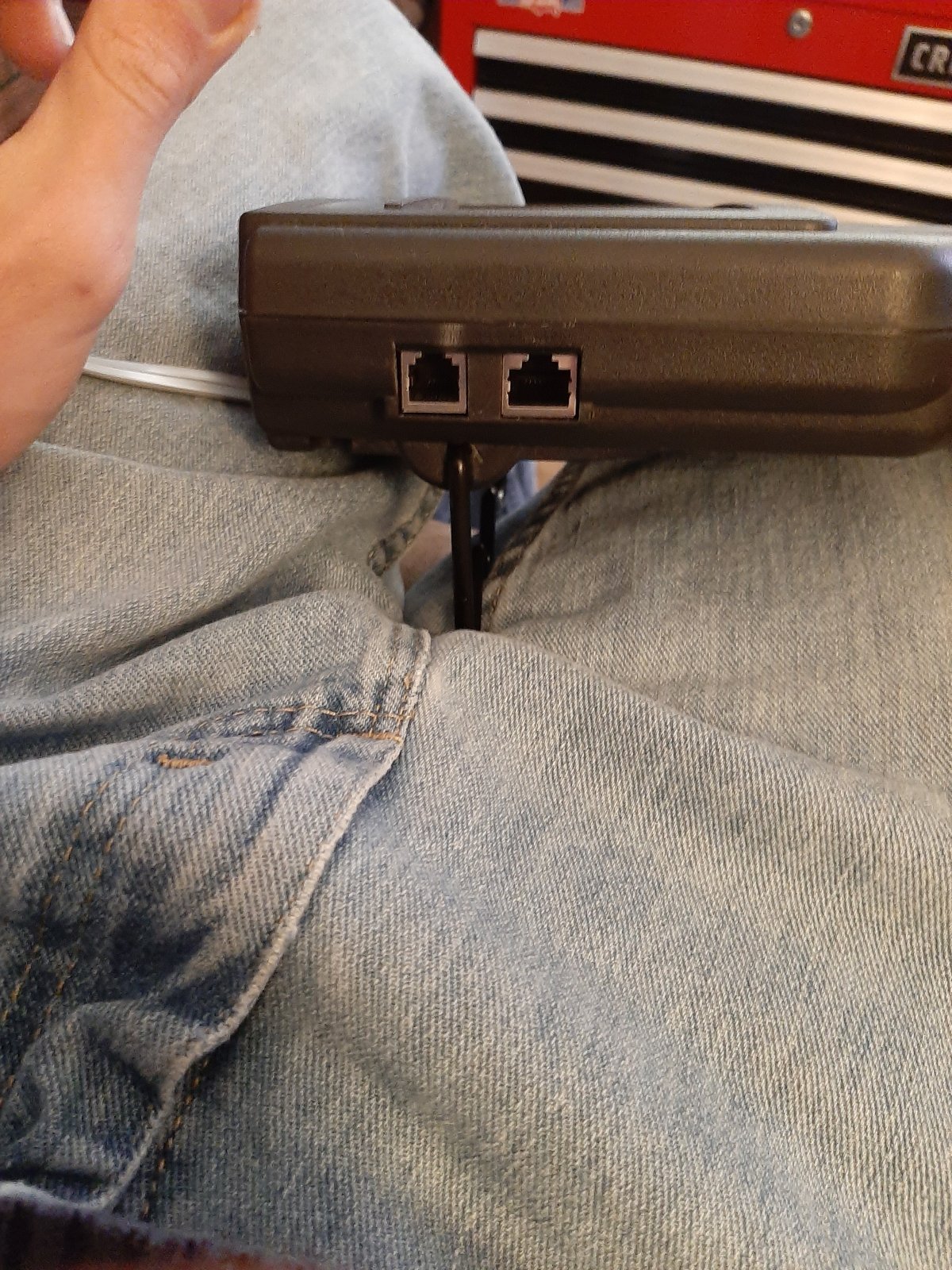

So do you have to use the rs232 plug because I just went with a rj45 plug and it hasn't been reading it, and is it the bottom or the top port?

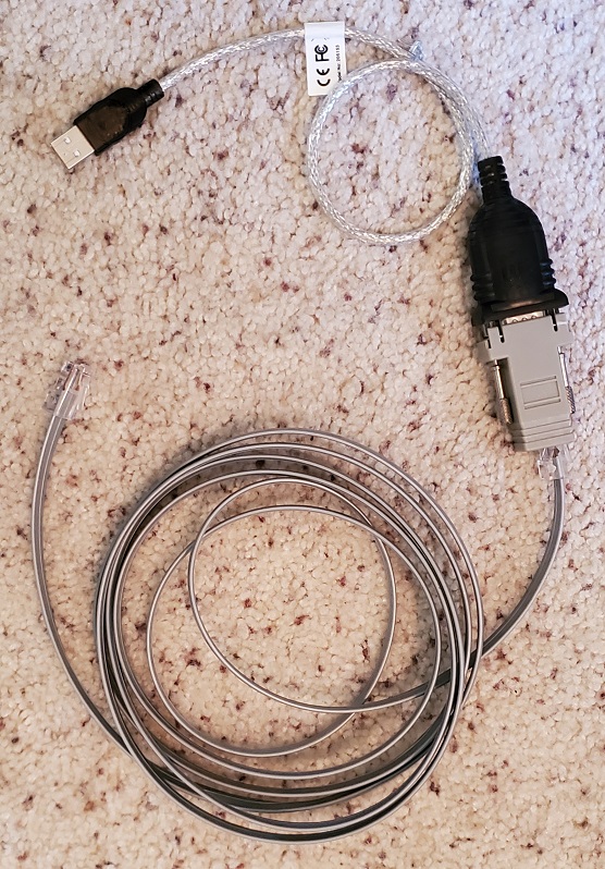

The bottom, larger (RJ45) jack. You should have a flat ribbon cable that has the RJ45 connectors (8 conductors) on both ends; you can substitute a Cat5e cable. That connects to the Tech 2 on one end and the gray adapter that connects to the DB9 of your USB-Serial adapter.
I have not dealt with programming through the web, but I'm sure that your GM online software needs to know which serial port your USB-Serial adapter is using.

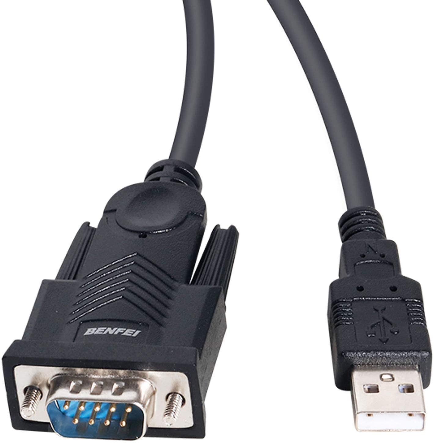

Erg well I'm at my end with this stupid thing I bought a rs232 port to usb hoping to god this stupid thing will find it if not I have no idea hoping dealership at that point.
