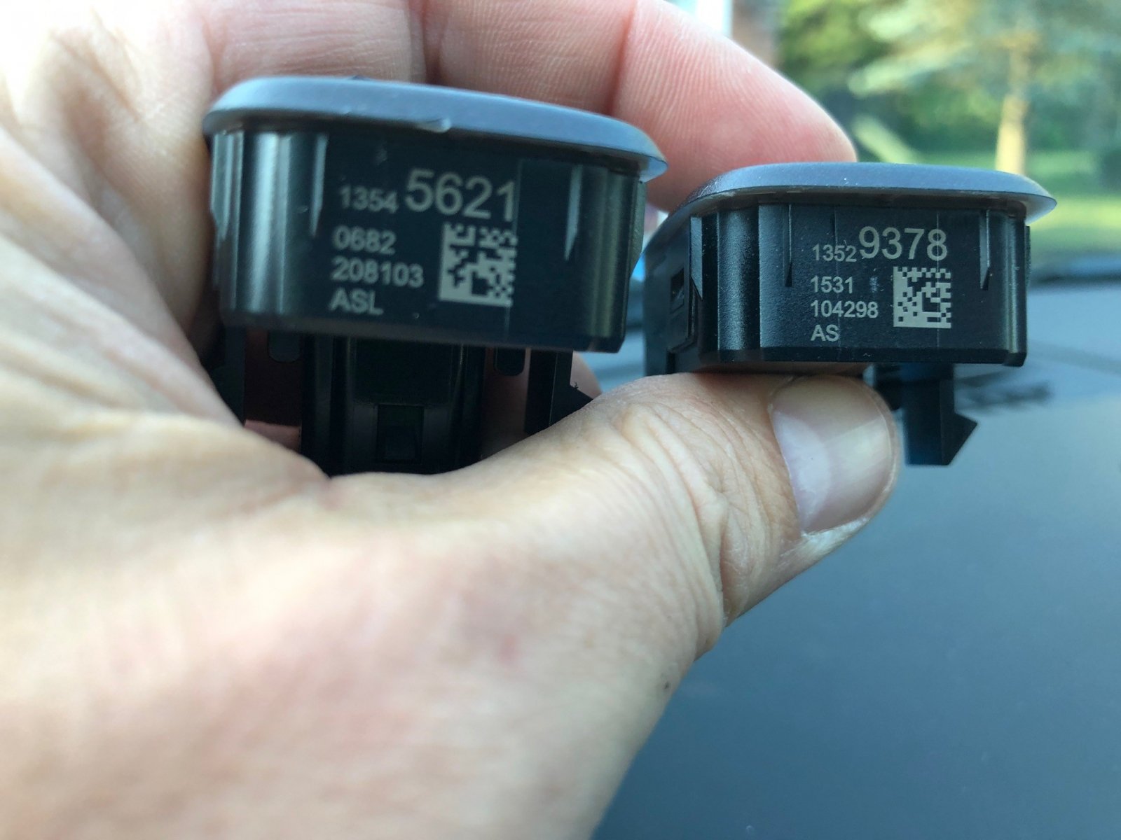

When searching I stumbled upon a lot of info in a corvette forum. Seems the C8 vets have P/N 13529378, older sensors with that p/n are good, newer ones aren't. Those guys are pulling serial numbers together to try to figure out a cutoff (props to them for the effort as some of them reference coming here when researching too). When going to dealers, before the shortage, the P/N 13545621 was being used to replace there's. Seems to me the two are likely backwards compatible so I'm going to try the older one from an ebay seller that seems to have old stock (at least the vet guys have had success with that seller but who knows what you'll get). Should have it in 4-5 days, I'll report back if it works as they seem to be more readily available, even though we could still get a bad one if not old enough inventory...
Replaced the original 13545621 with the 13529378 last night (that does appear to have an older serial #) and I had headlights off and DRL's on the entire ride in this morning in the sun. Headlights were on in the garage as well as testing by putting hand over sensor. Also put flashlight on sensor and headlights went off. Form, fit, function seem to be the same, pin configuration matched, so this does seem to be a viable option.
Note, for the swap, I started with taking the dash panel off with some trim tools and some of the clips were really tight as I got closer to the windshield. Could envision something cracking or breaking a clip. I aborted that, put some painters tape on the dash right next to the sensor and pried it up with a small flat head screw driver. Popped up easily once I got under it and plenty of slack in the wiring to comfortably pull it out a bit to unclip the connector.
Original on the left, replacement on the right.

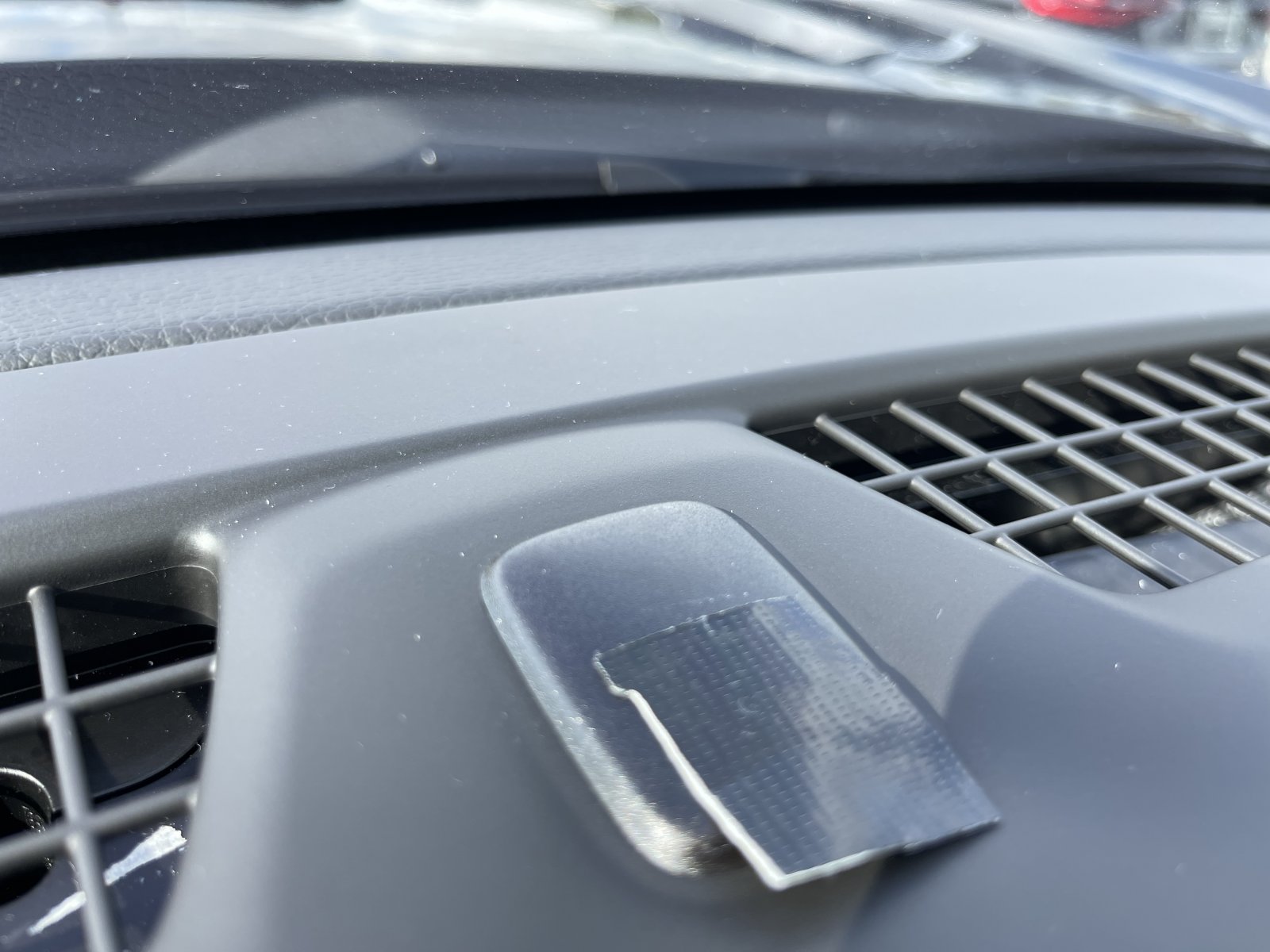

Just rigged it until the sensors become available. Don't feel like messing with a 90k new truck however annoying it may be and really shouldn't have too.
