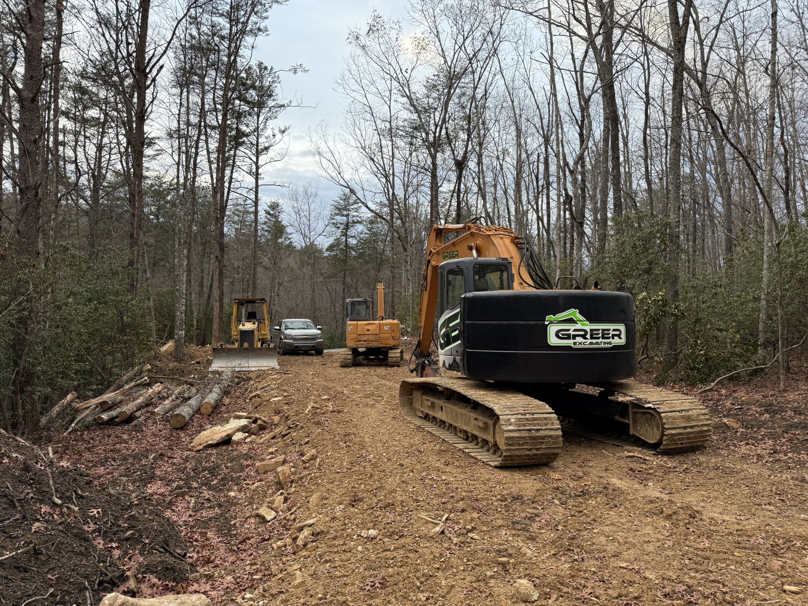

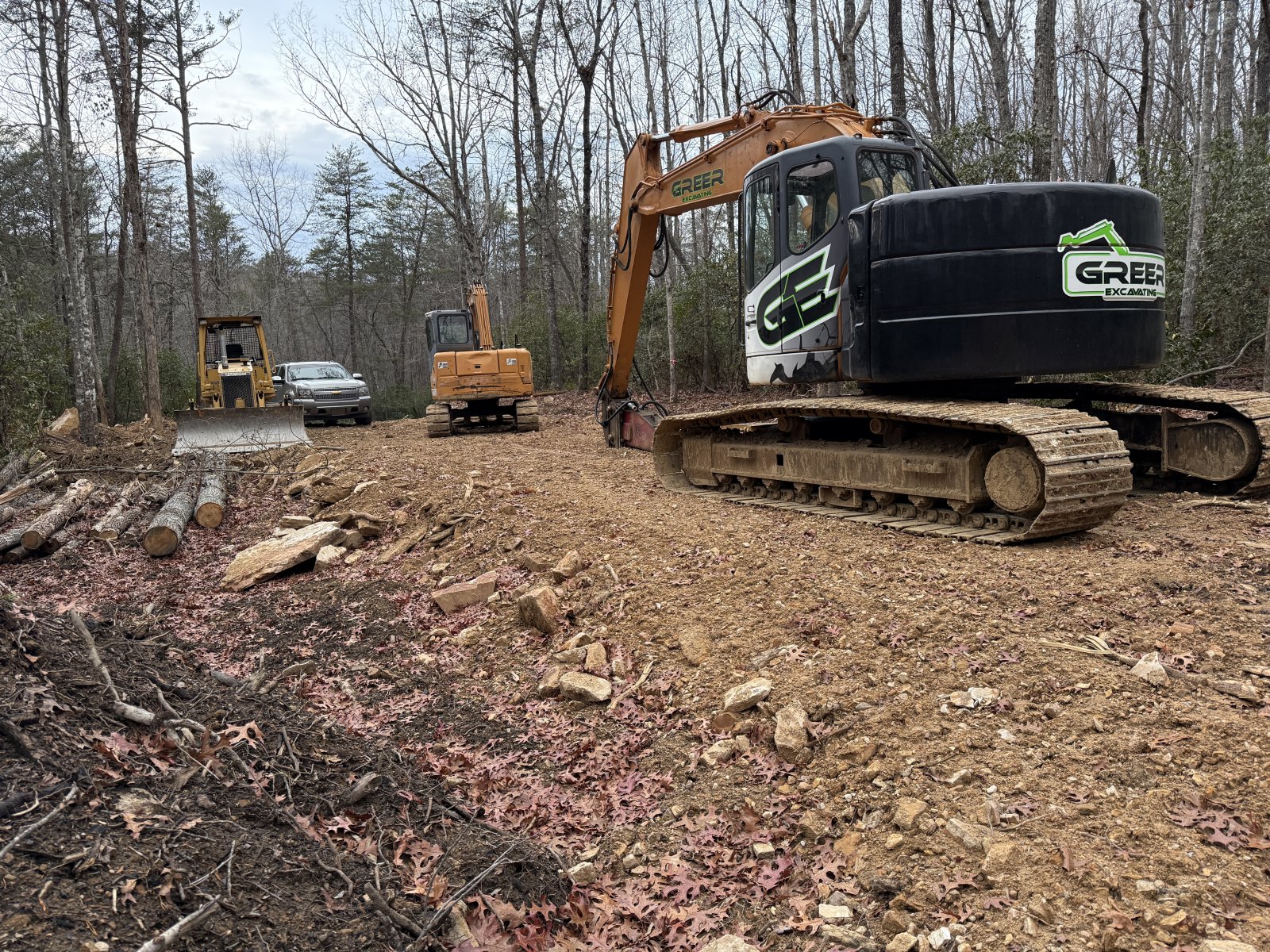

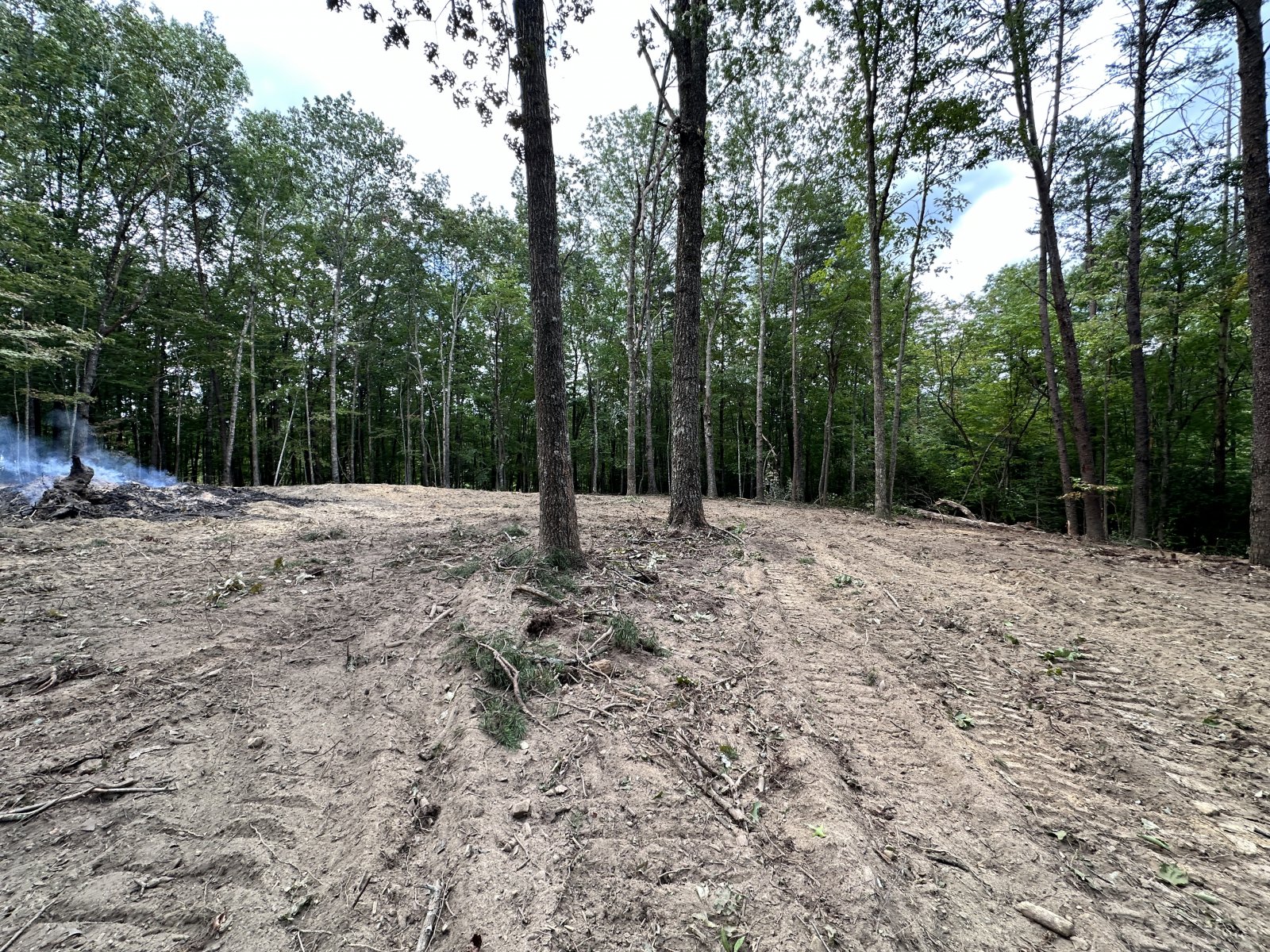

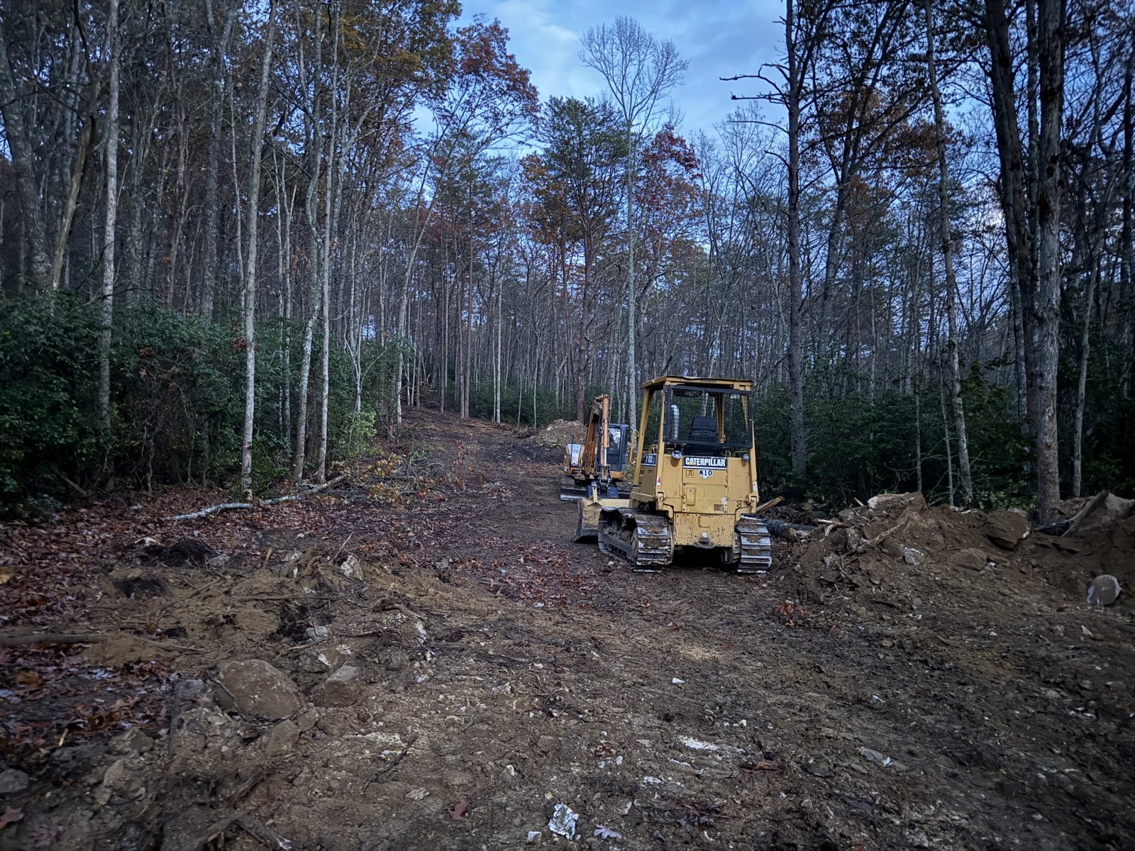

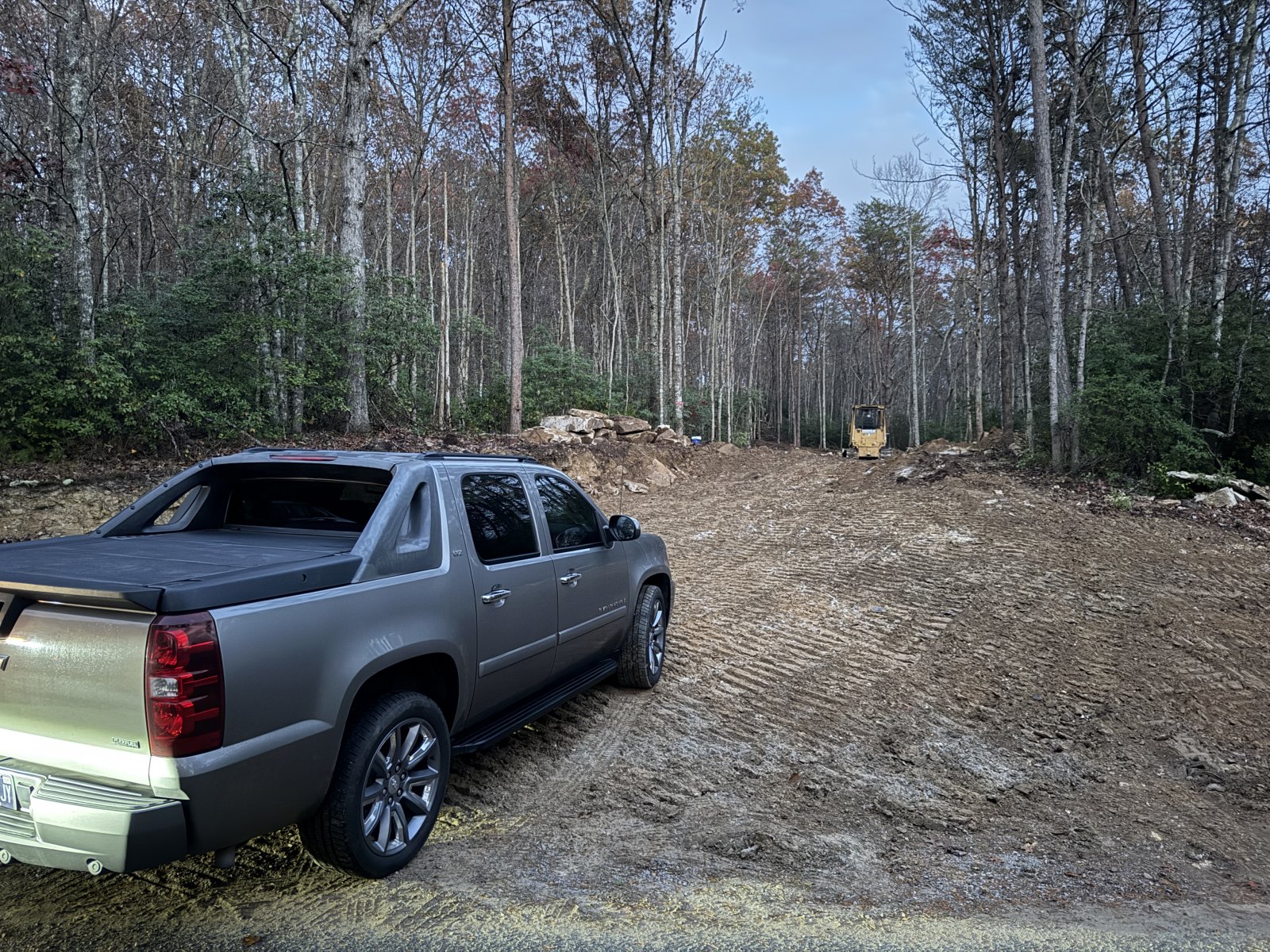

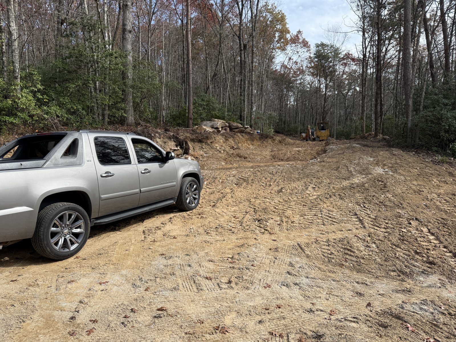

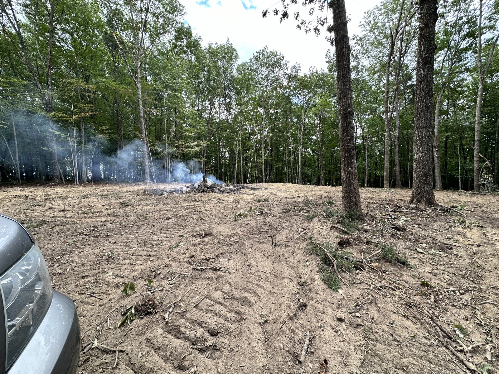

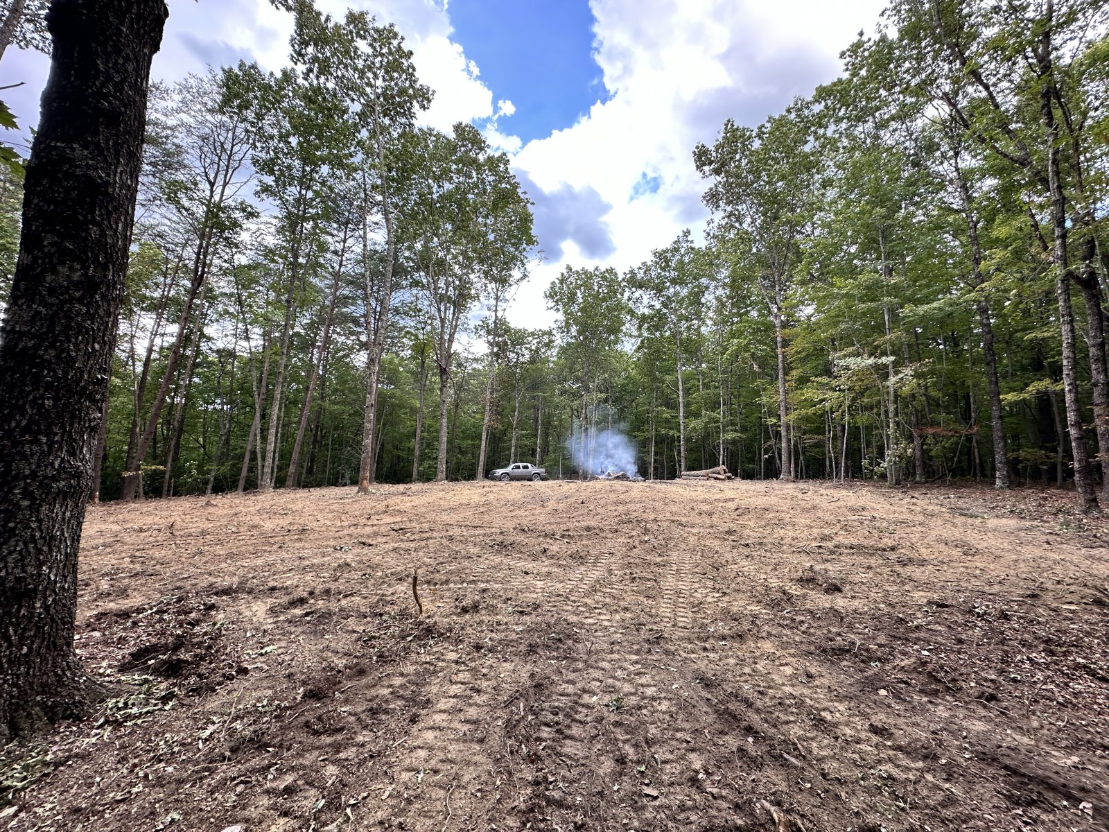

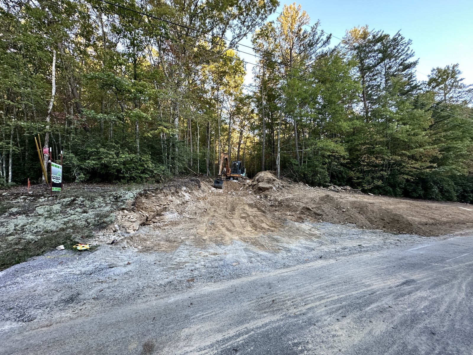

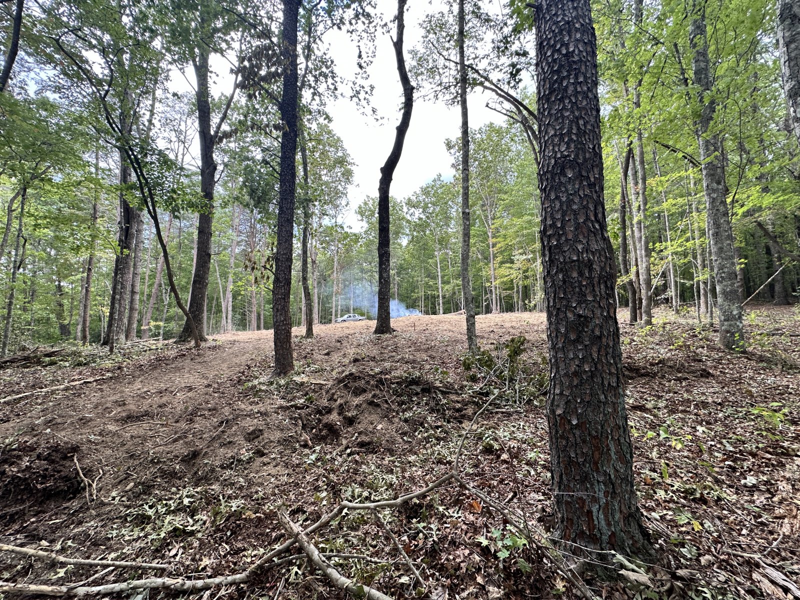

Little more progress. This was in September.
They were going to thin out the back of the lot where we're building. They cleared a little more than we expected, but whatever. This gave us a little better lay of the land
The avalanche is parked where the garage is going. I'm standing in the trees where the house is going

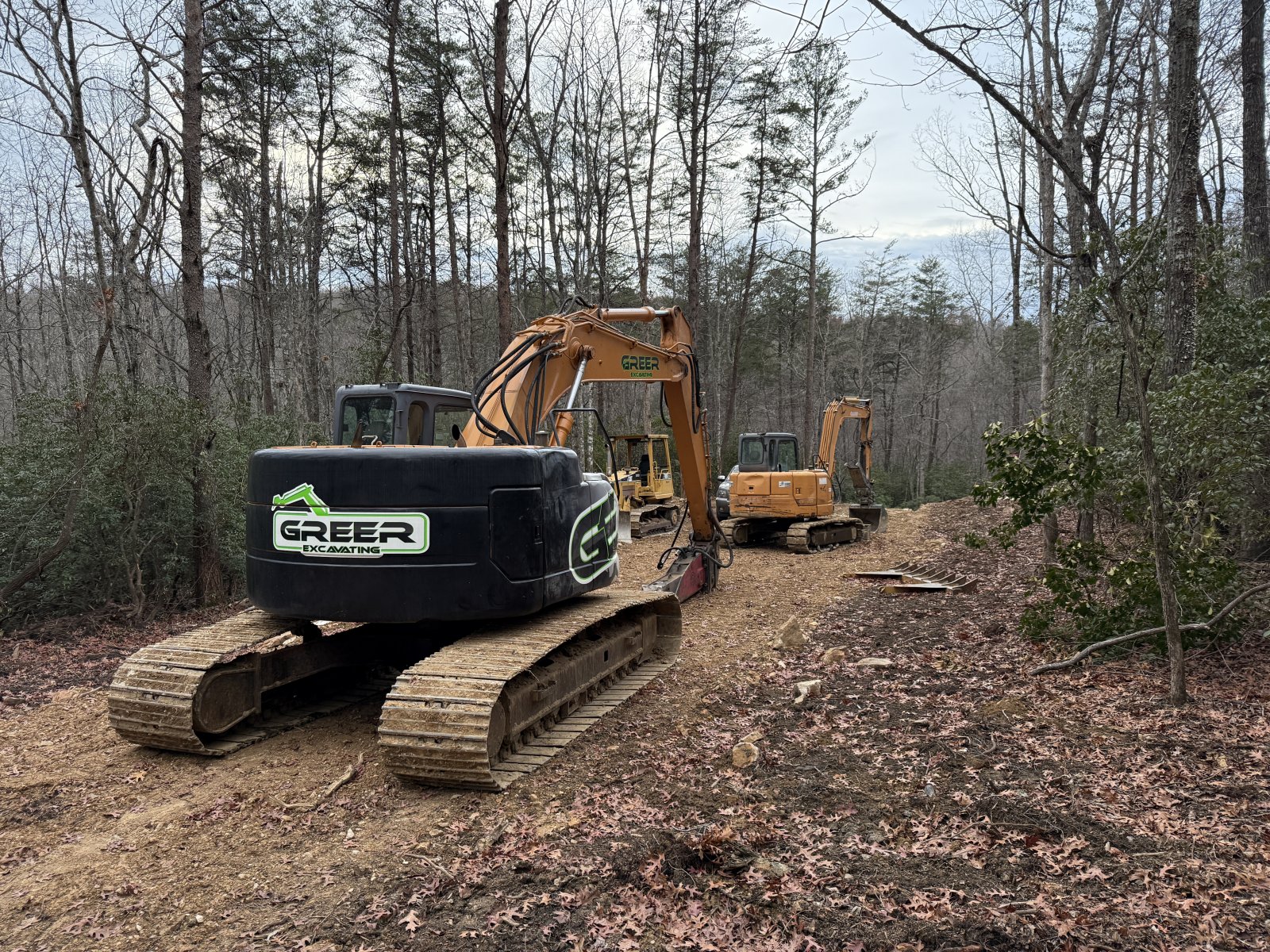

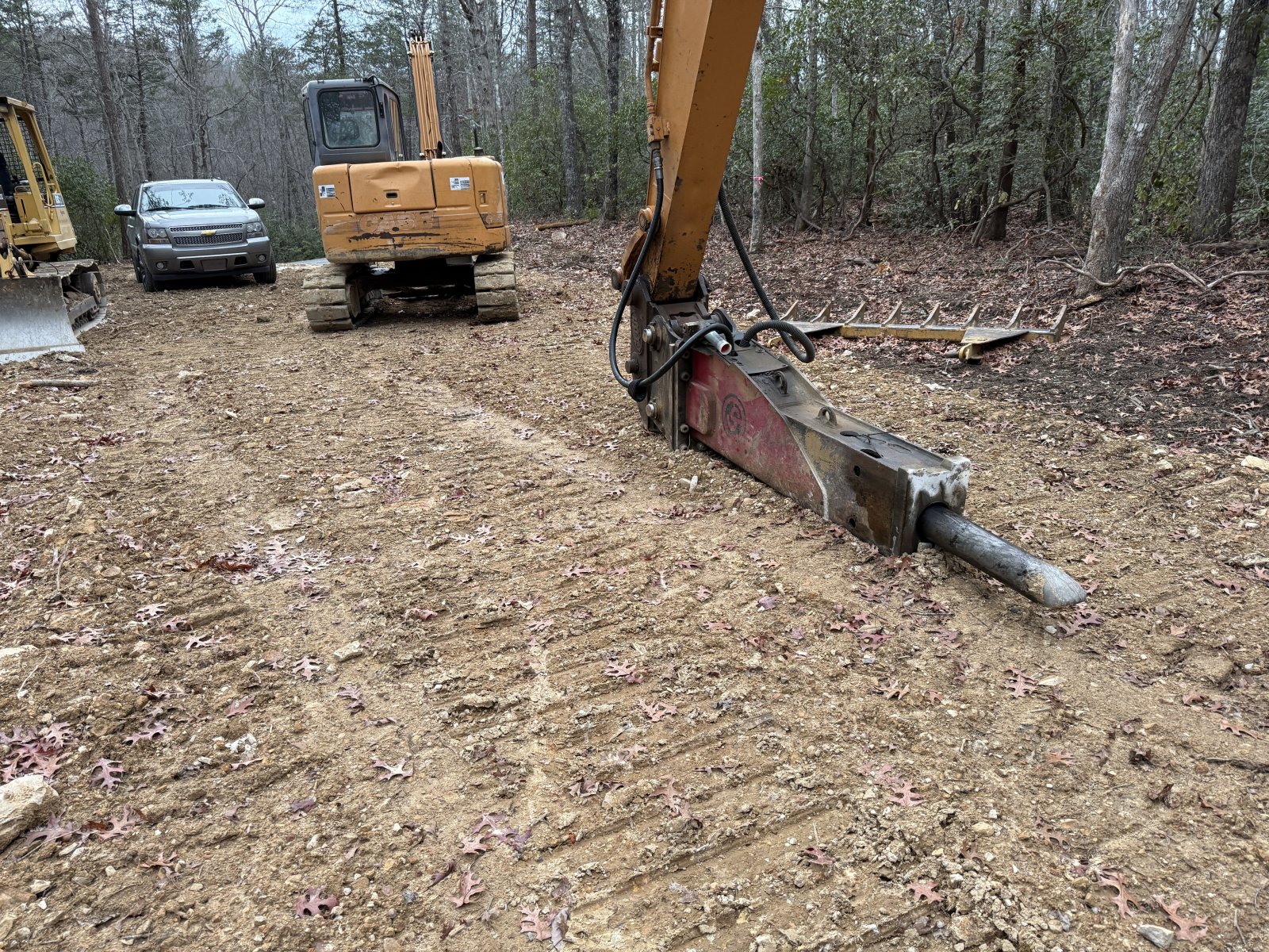

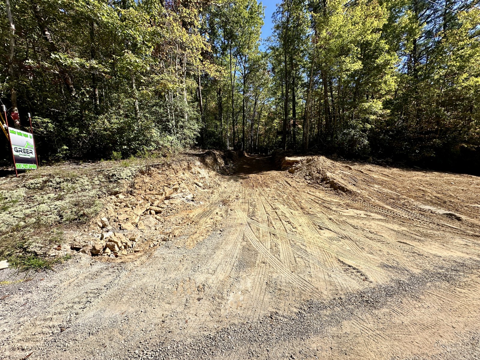

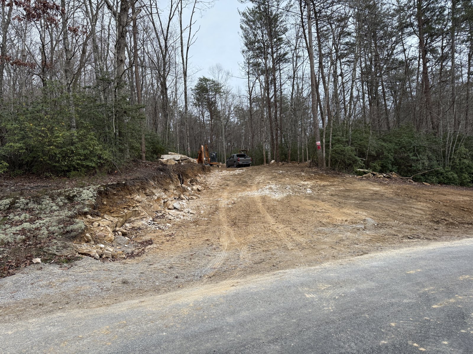

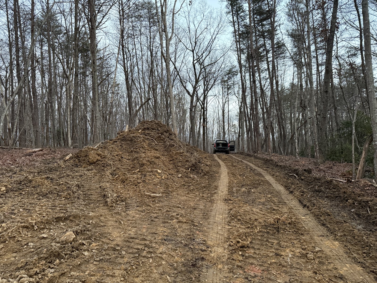

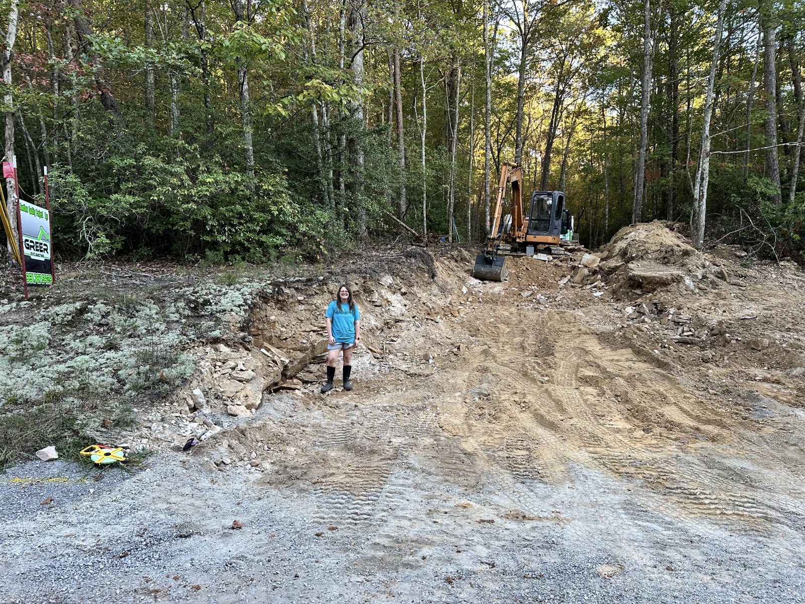

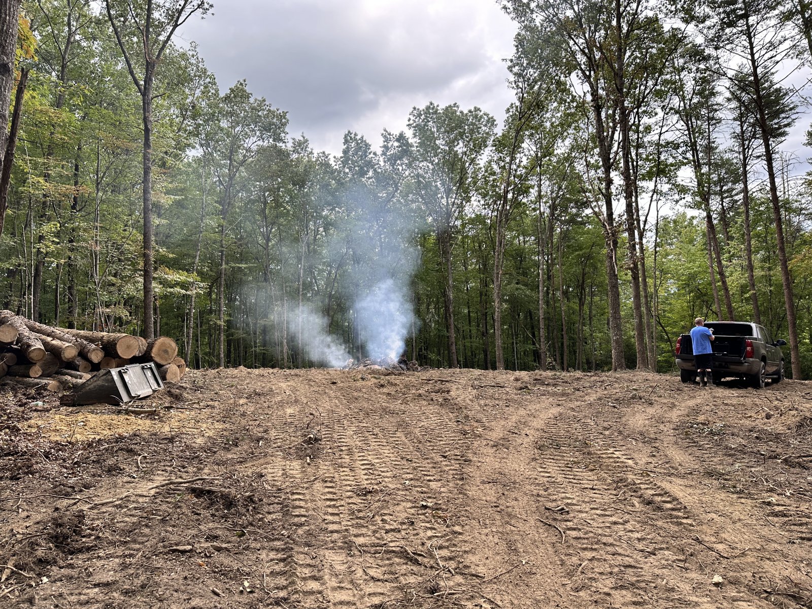

Next up, the front hill was still too steep, so I had them hammer more. This got the entrance down to a more manageable slope and carried it back around 140'. Total hammering was about 8' deep and 35-40' wide. More trees were taken out as well. Looks like I-40 east bound going through here...
Steph for scale. This is when I realized we didn't have enough land to simply grade out the difference and we'd have to install a retaining wall

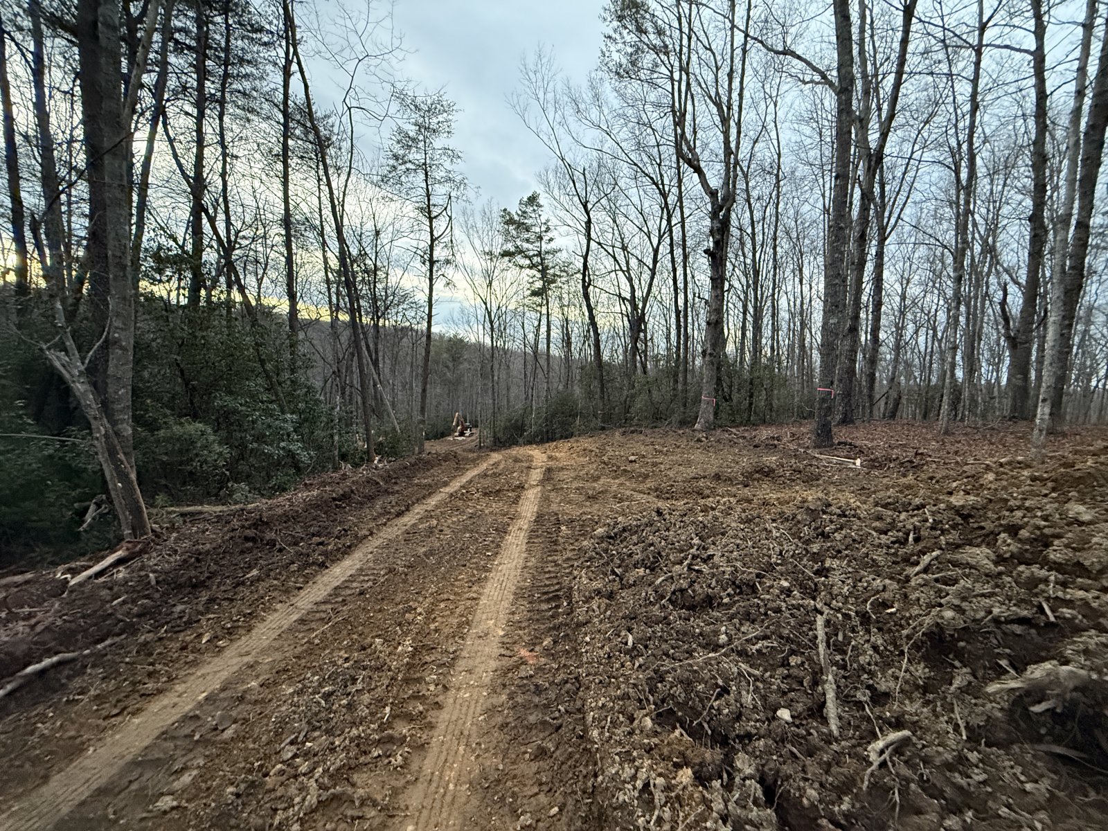

More hammering and more grading.
They used the material they hammered out to build up a little low spot. They blended the area into the second hill nicely. It's built up about 4' in through the middle
Little more hammering..
Starting to take shape

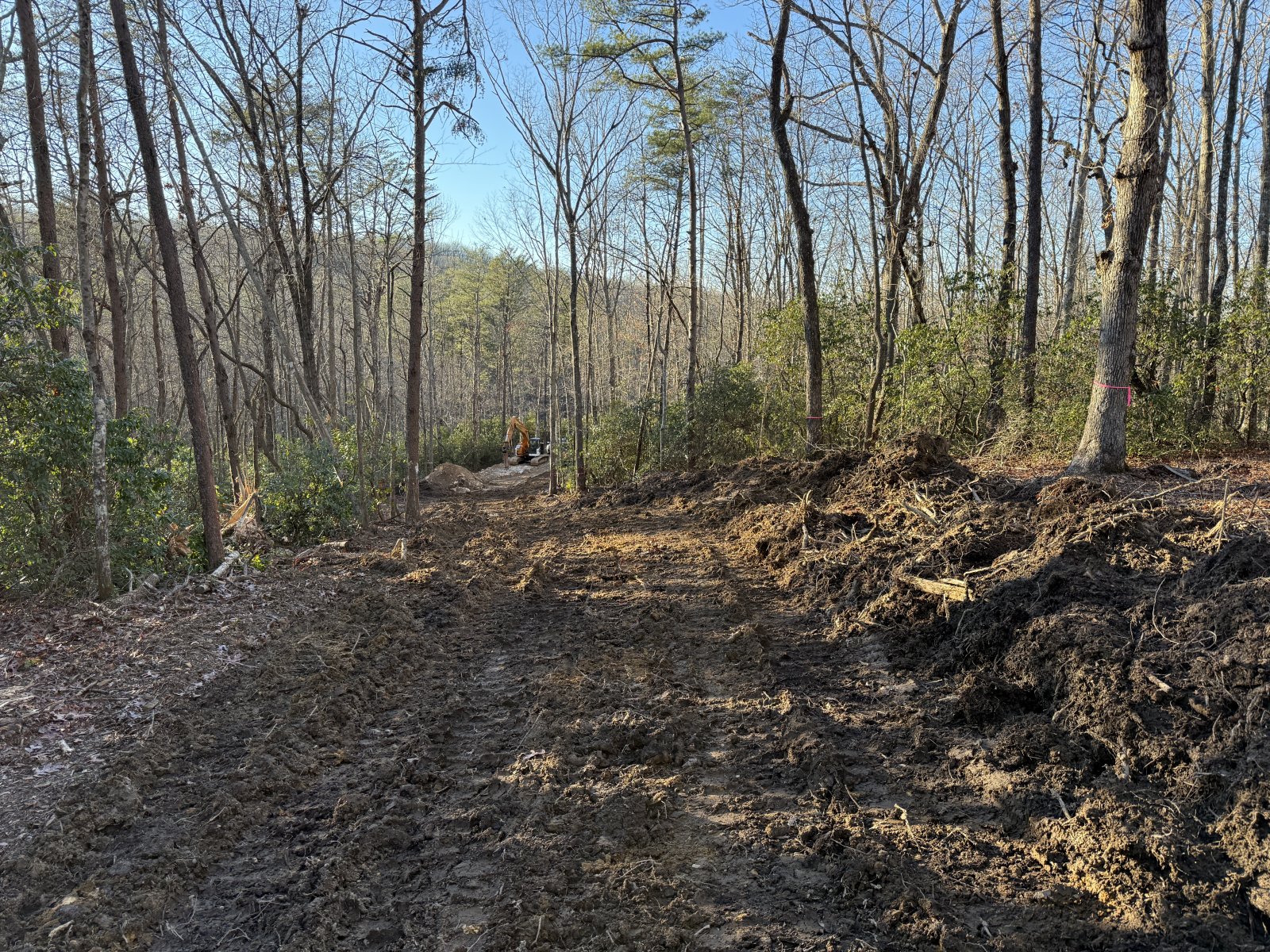

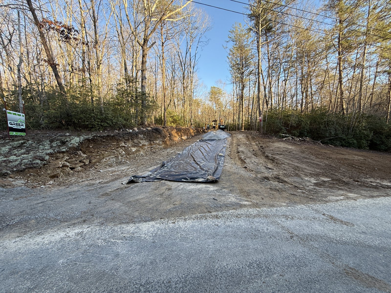

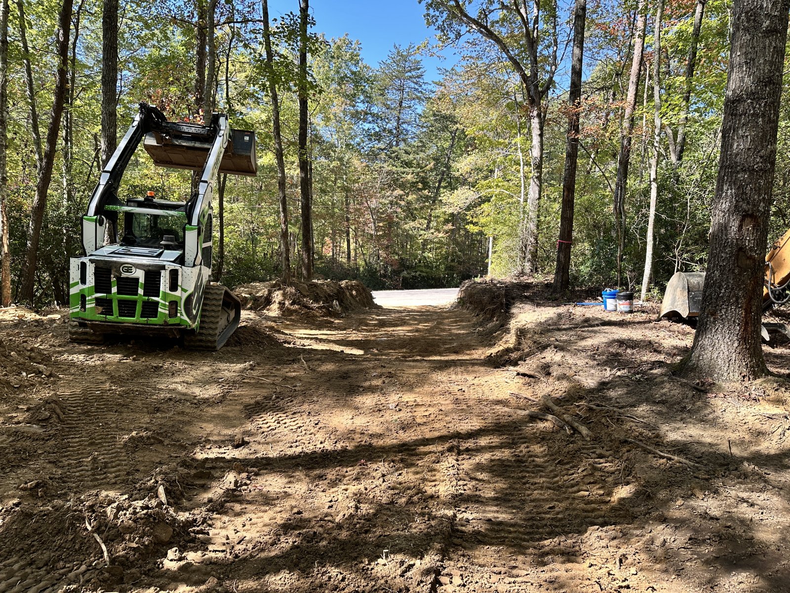

By this time, we're already into December. We've met with our builder and he says he can start after the first of the year.
They started cutting on the second hill and getting the front entrance ready
Rained started in November, so we were working on it as we could.
Second hill, looking towards the road
Looking toward home site
Geo fabric laid, we're at rough final grade

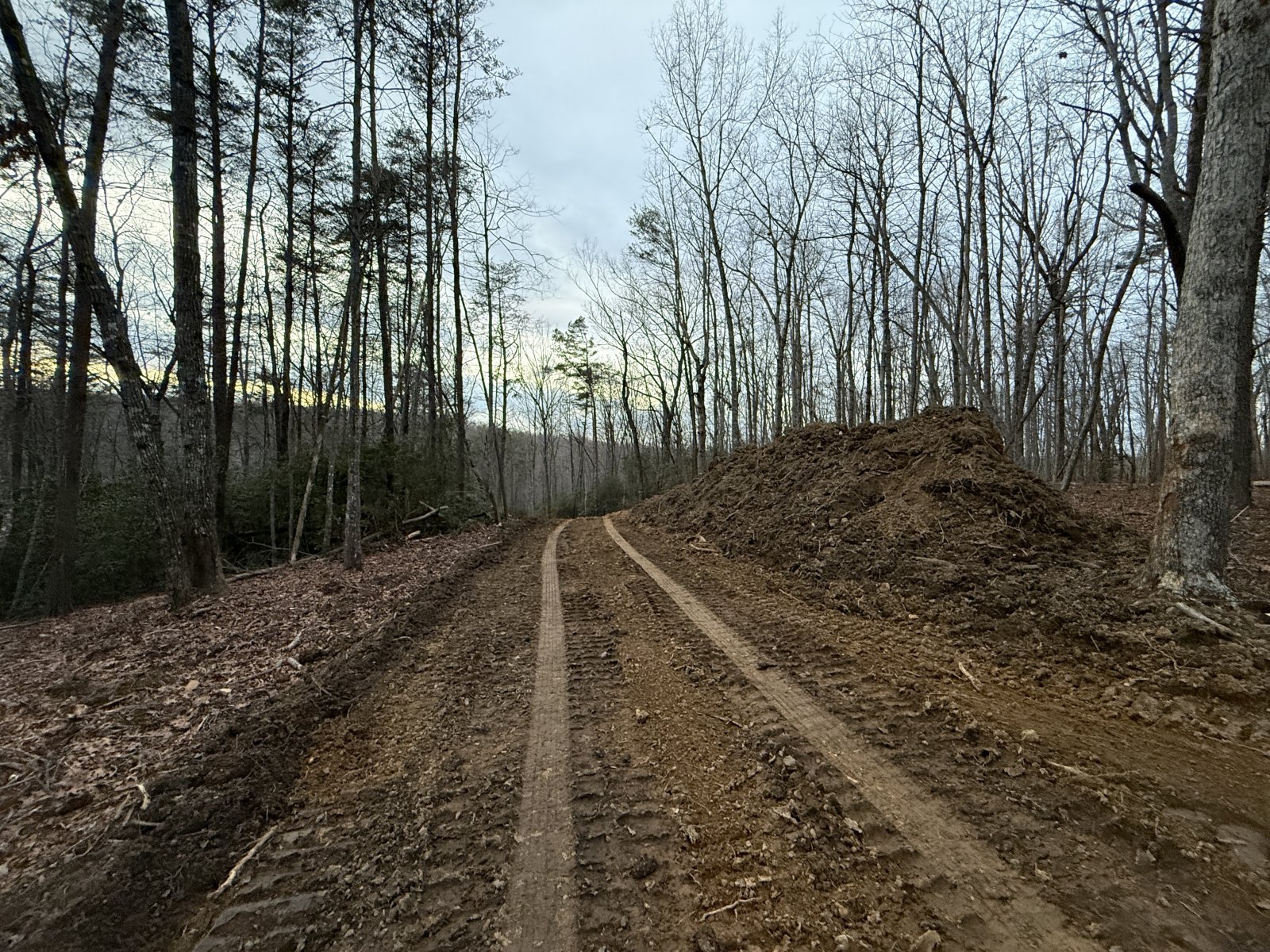

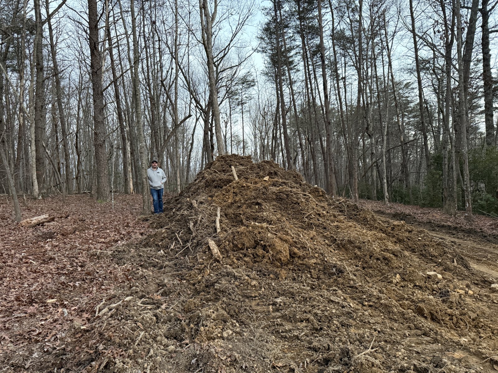

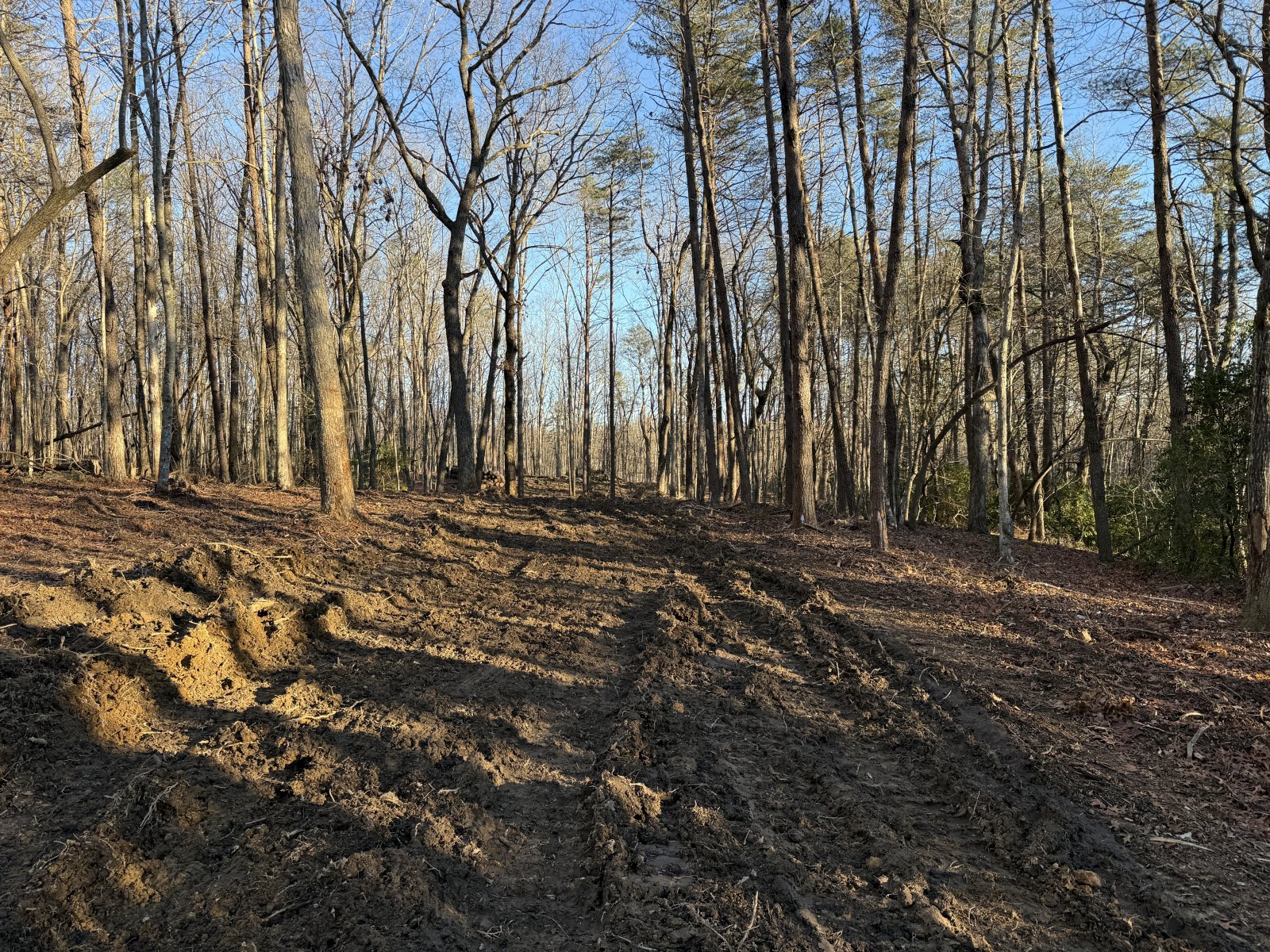

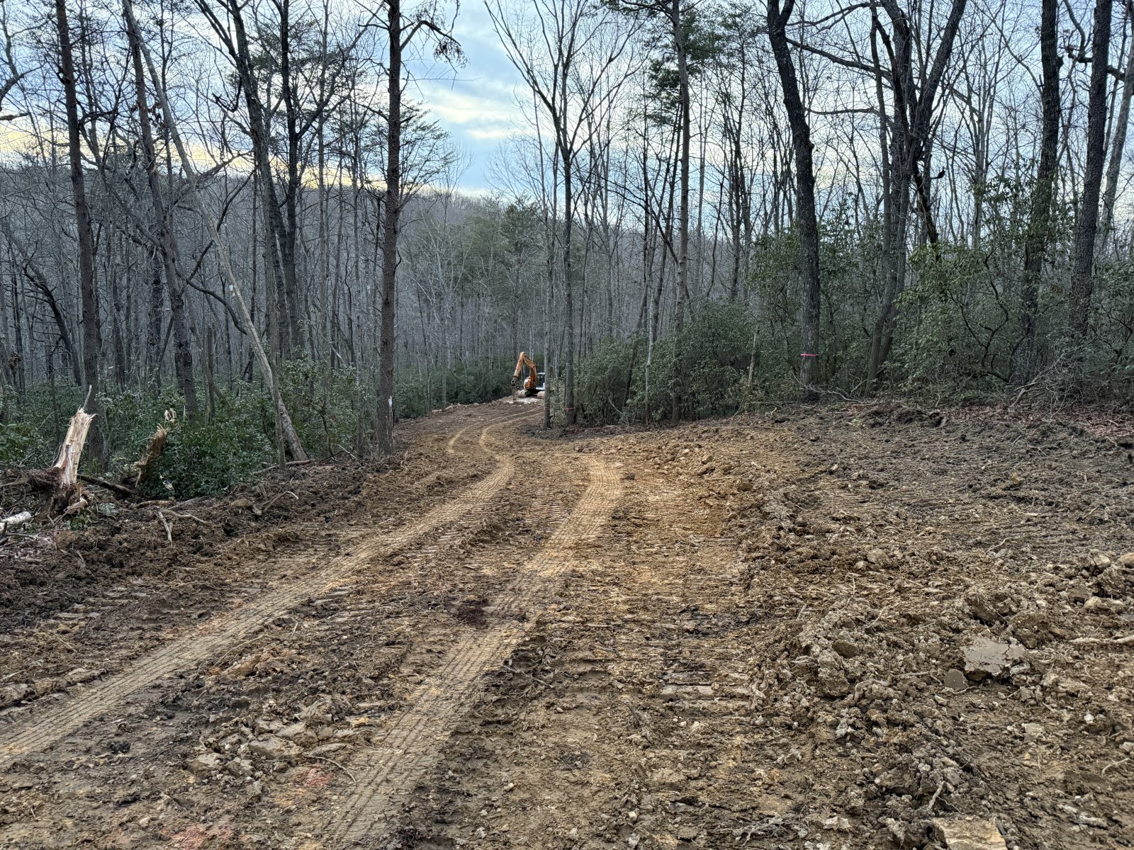

More grading on the second hill. This post will wrap up 2024
By this time, I'm over the rain and I'm over project managing this shit. Hopeful that 2025 will dry out and we can get my responsibilities over with...
Hopefully by now, you can tell what's looking towards the road and what's looking toward the home site...
Casey is 6' 2". Quite a bit of material has been cut

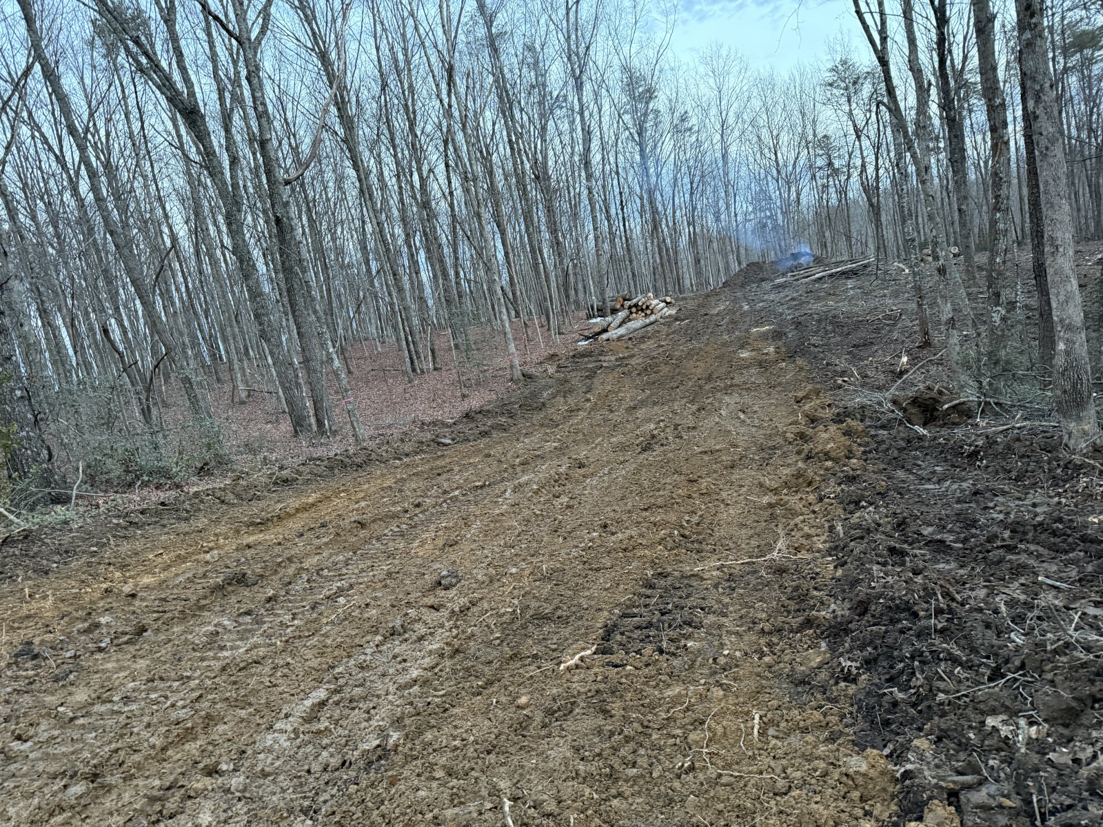

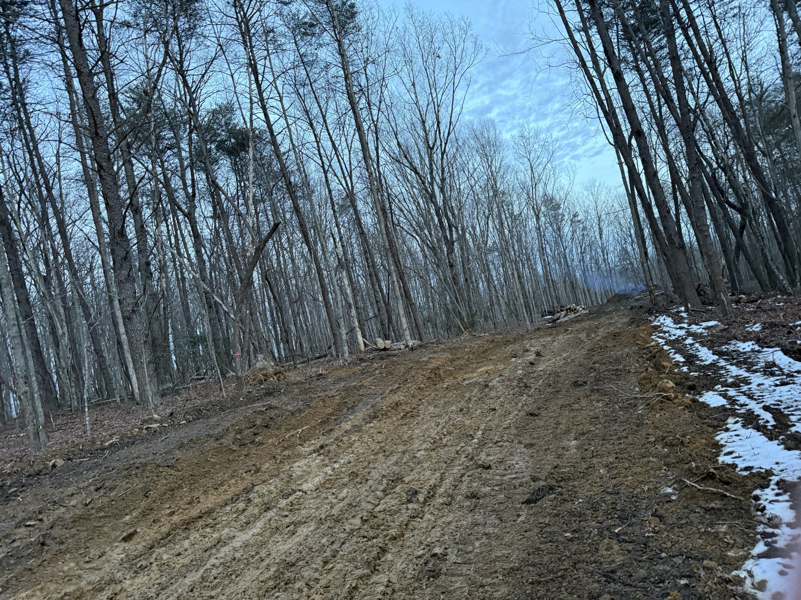

Rise to run?
Not 100% sure on the run. It's somewhere around 500' from the road to the top of the second hill. The house will be almost 1,000' off the road.
Looks like a lot of money and work to get that driveway right. And the party hasn’t started yet. :)
It's been a process for sure. Some of the work we did was probably unnecessary to most people, but I wanted it to be right from the start. The second hill is still a little steeper than I'd like, but when you buy a mountainous piece of property, you can only do so much before it loses the characteristics that made you buy it. I considered doing another retaining wall and cutting it more, but as nice as the wall looks, it would have been twice as big (length and height) as the front wall and it's just not fitting.
I'll get some more progress pictures when I get some time.

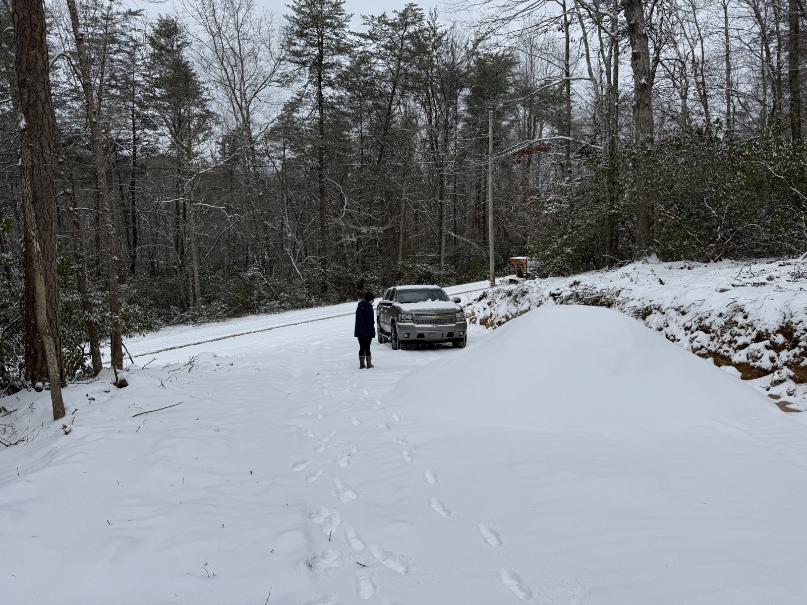

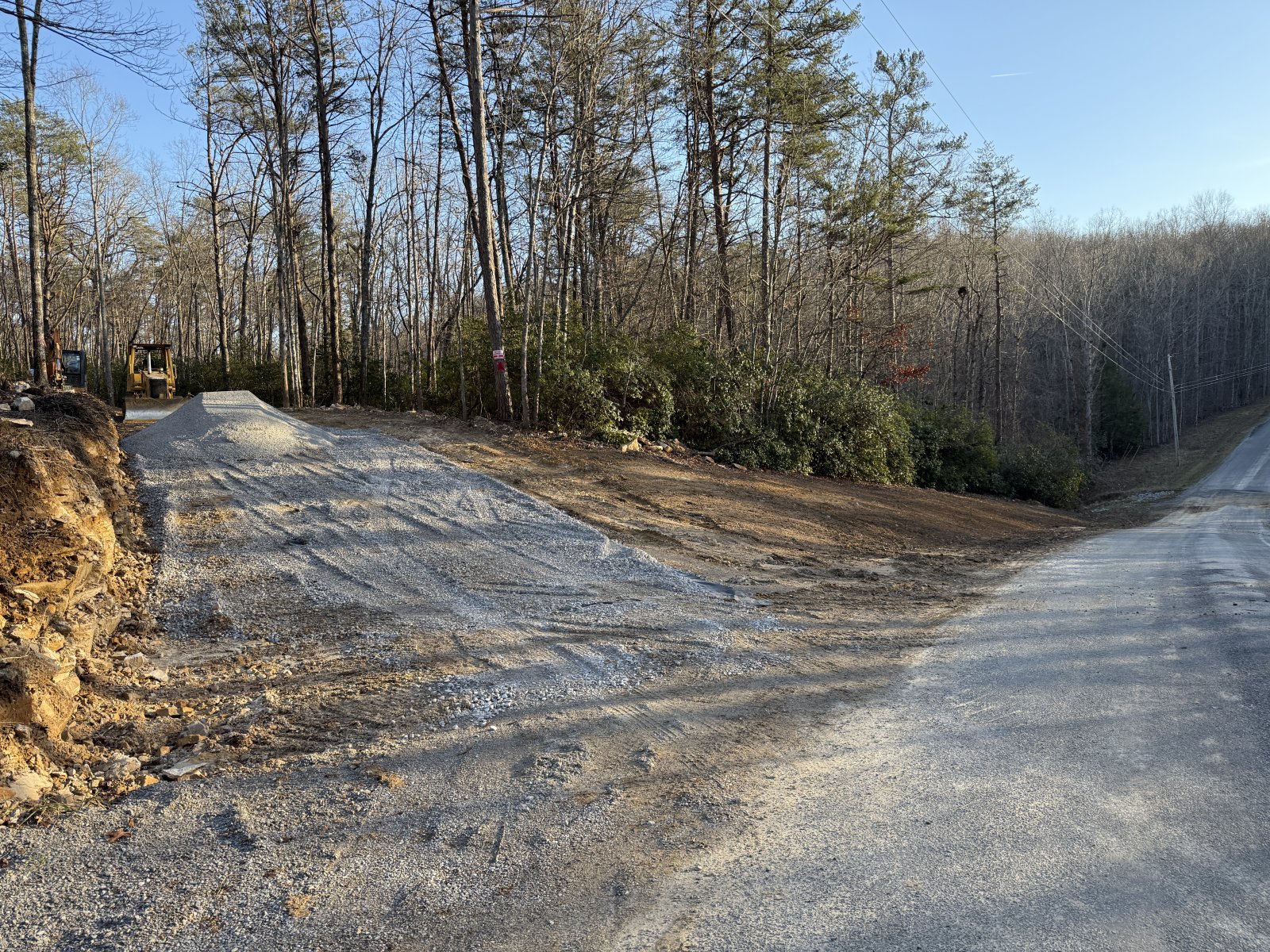

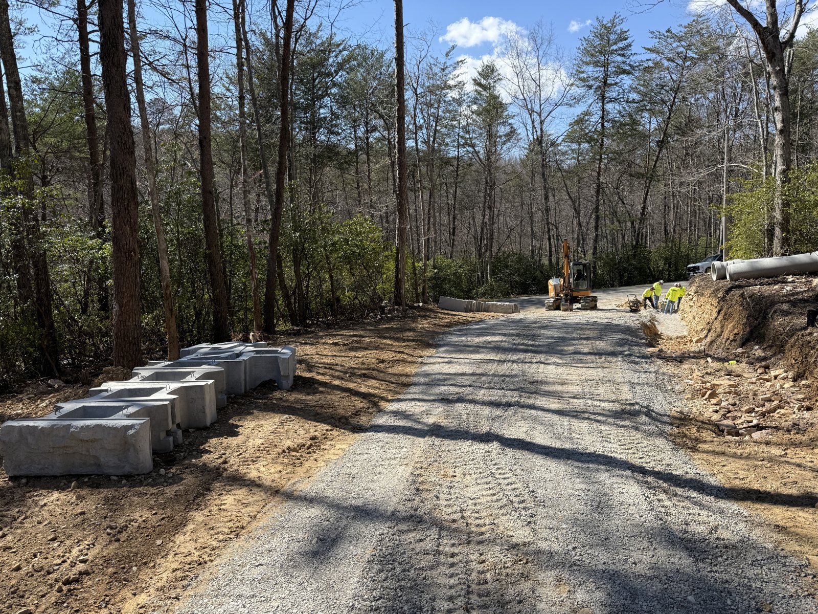

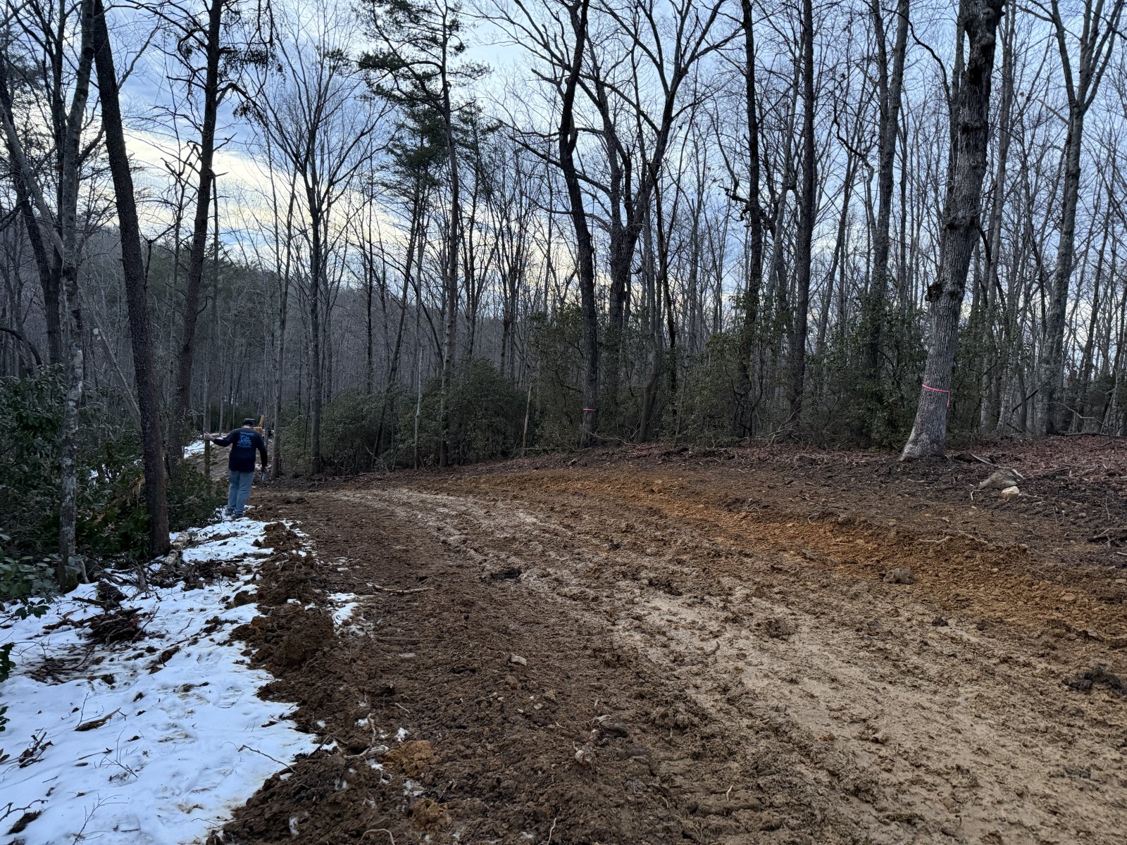

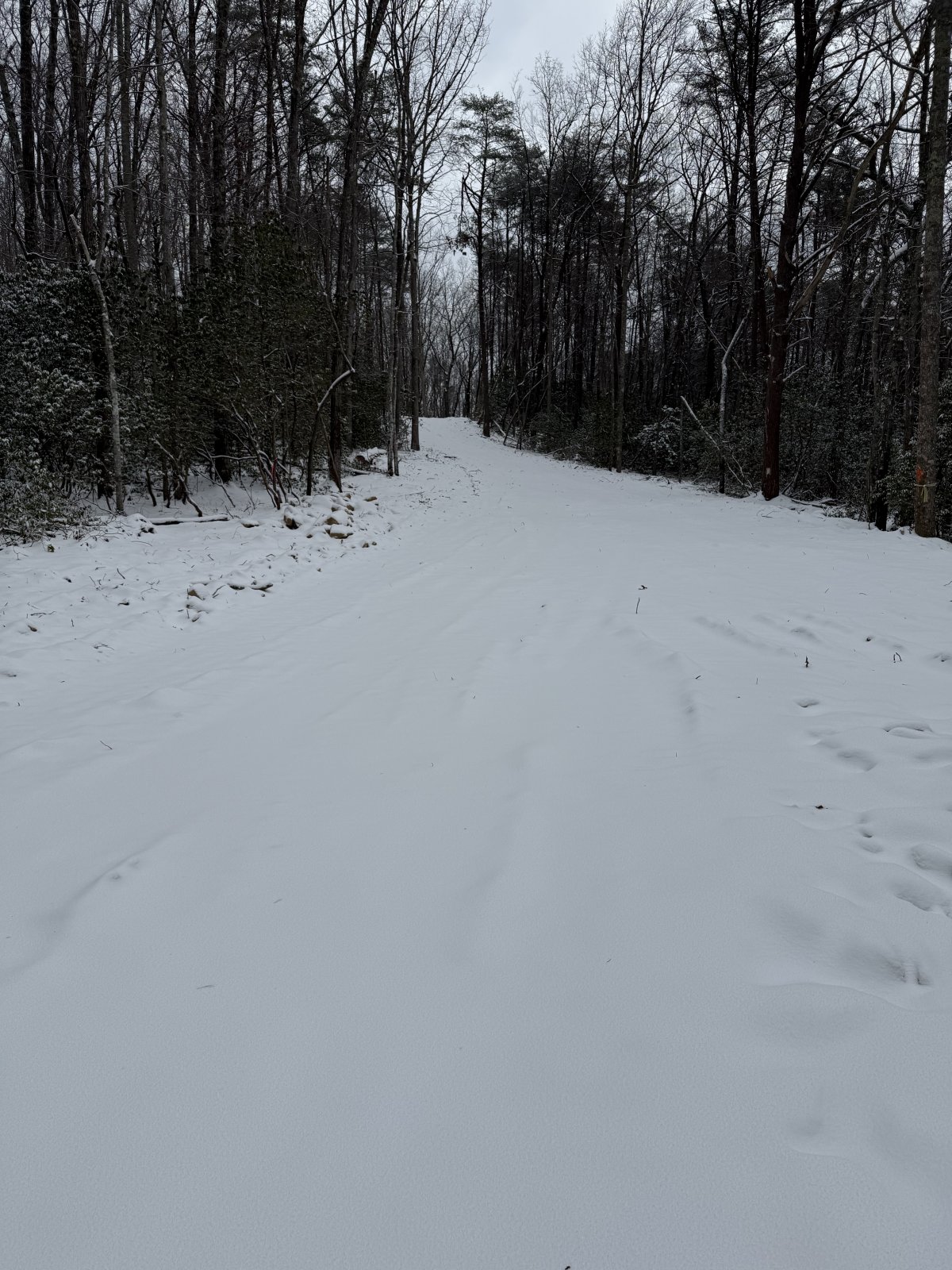

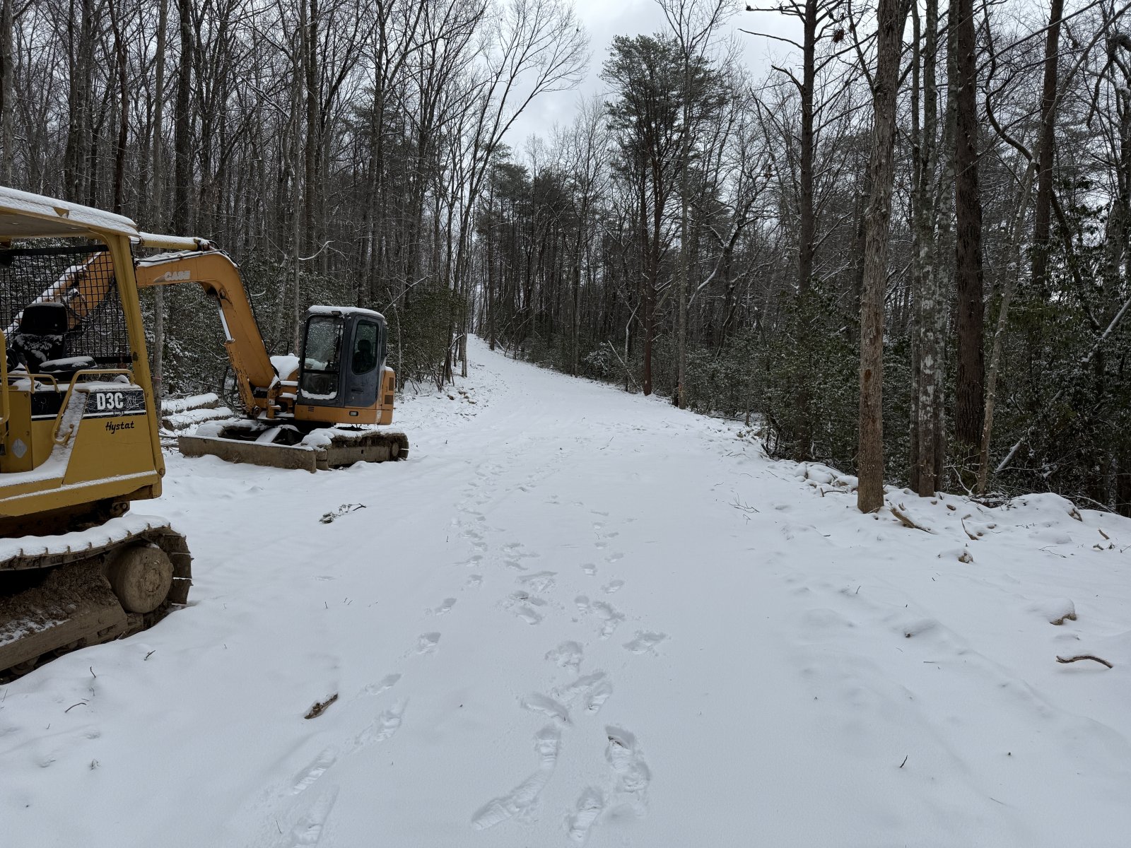

Here's where we were at the start of 2025. Rain and snow really slowed progress. We got the entrance graveled, more cut on the second hill and got the head wall set. This takes us to the end of January.
As you can tell, it's a muddy mess and we decided to focus on the front until we better weather.

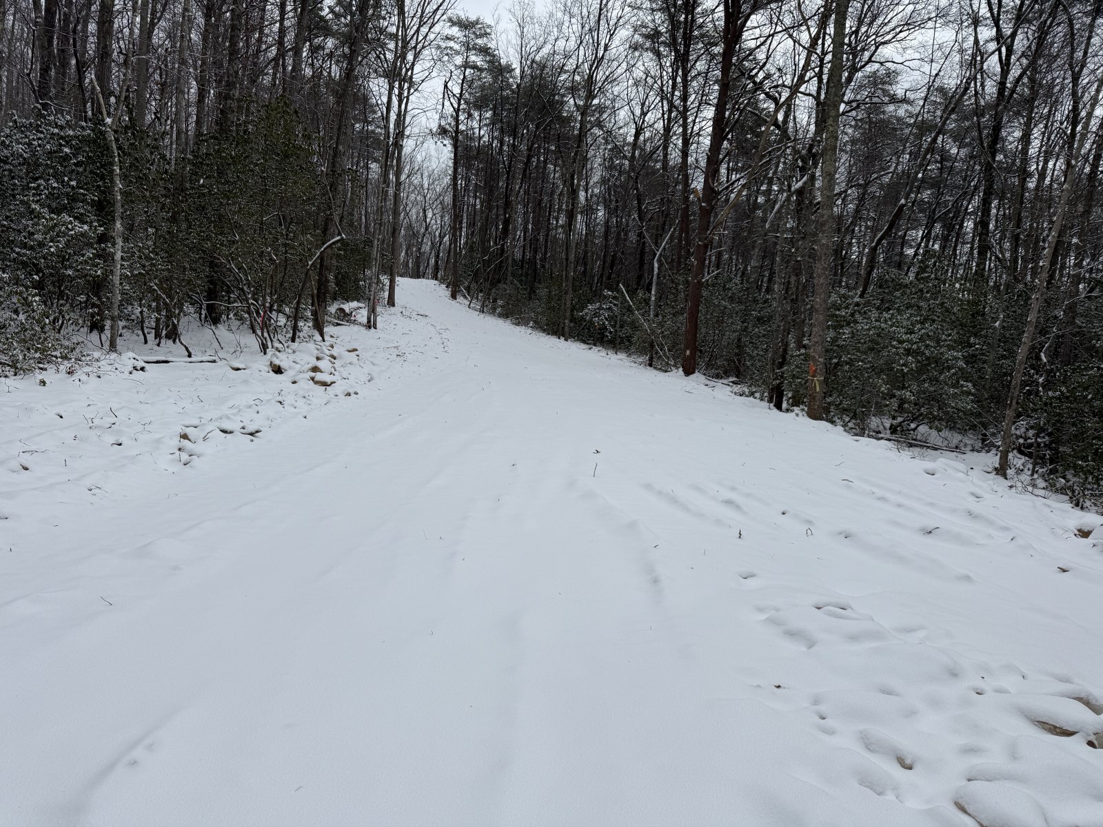

The snow gave us a glimpse of what we were working with over all. It was pretty satisfying to see it in a different light. Not just a mud hole
More mud after the snow but they pushed through and did what they could.

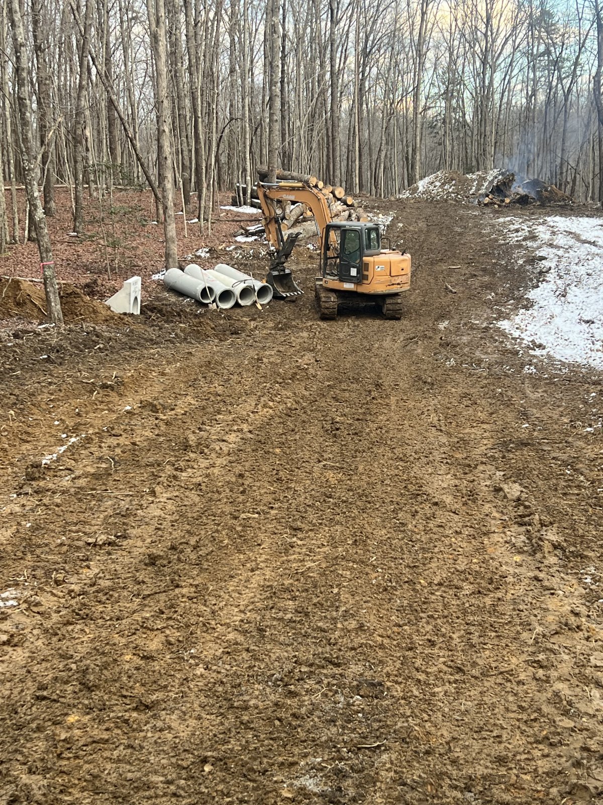

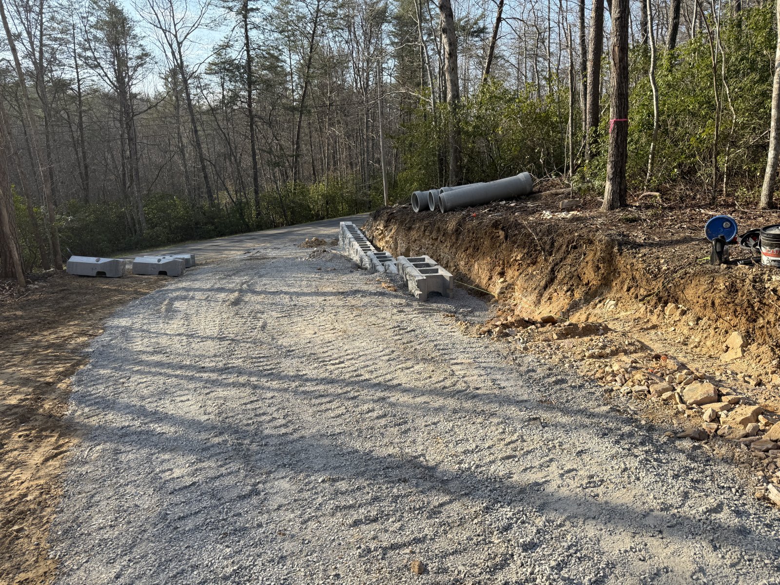

Shortly after, we got the headwall set and some of the pipe hauled back there. That's 18" RCP

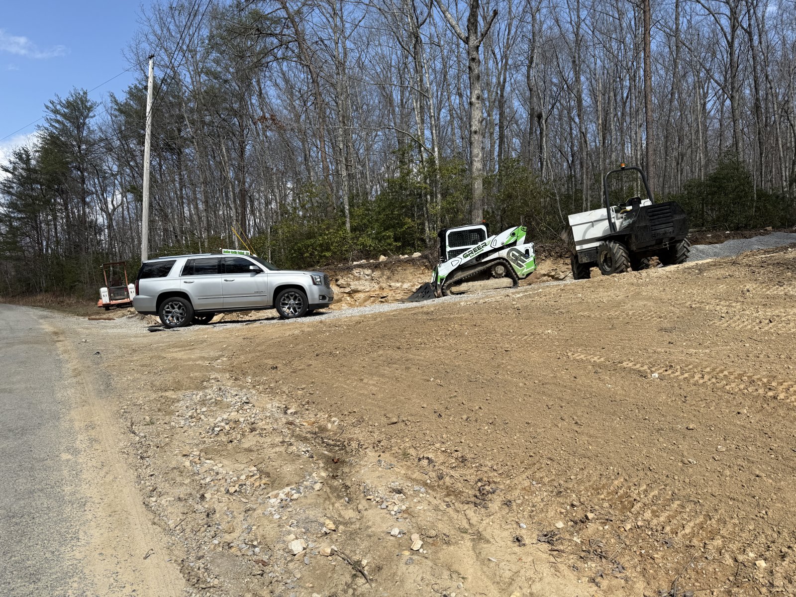

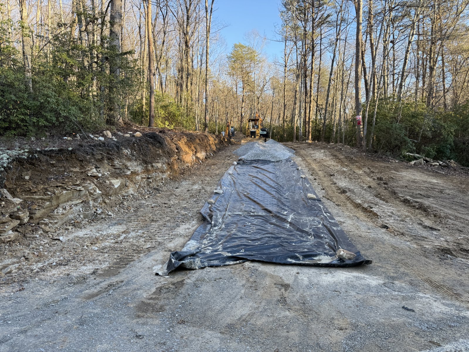

Have I mentioned rain and mud?

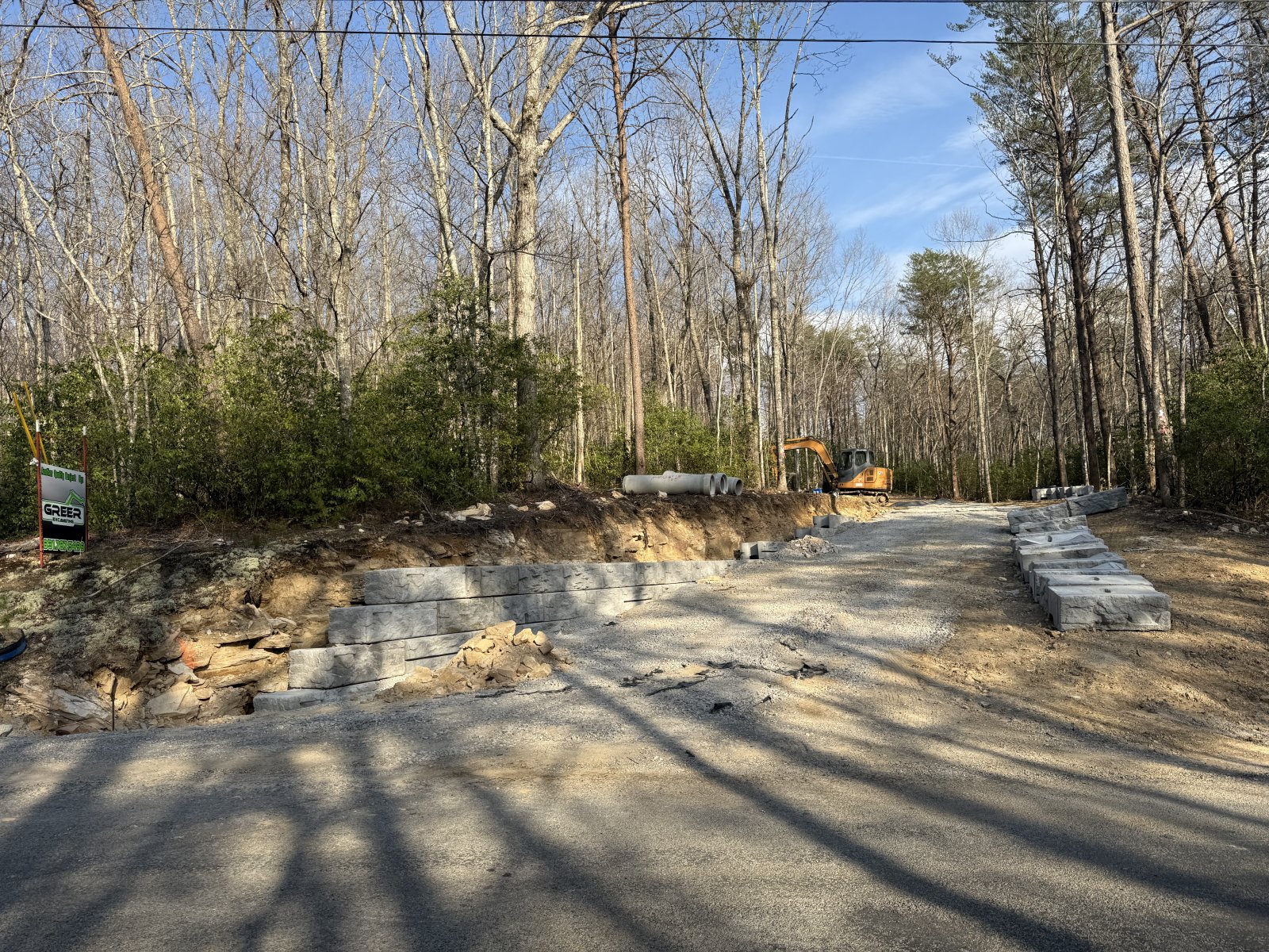

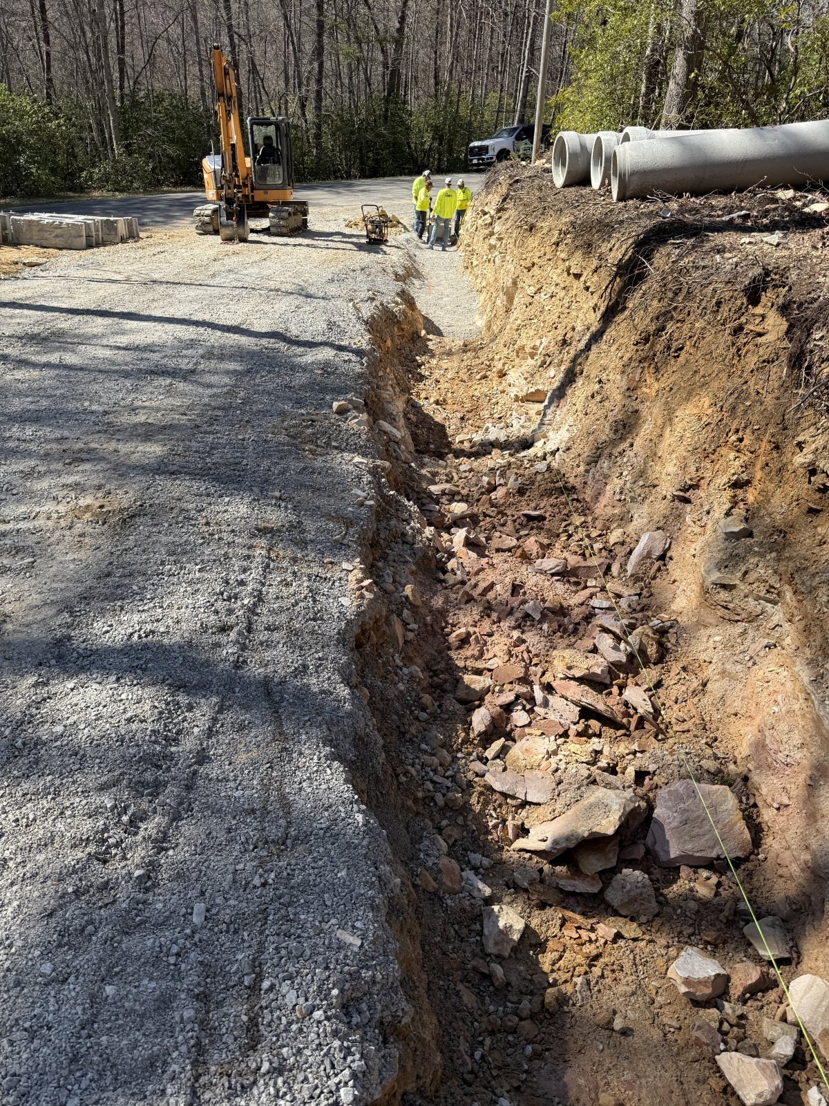

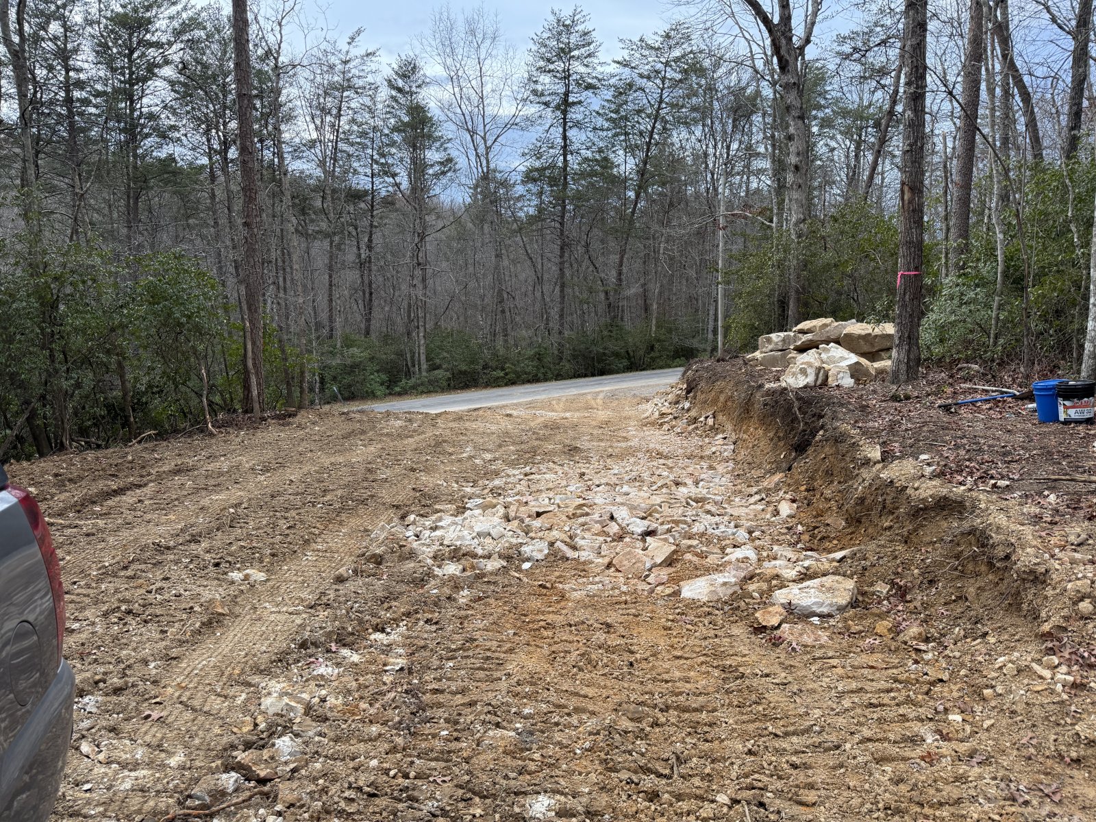

Since it kept raining, we decided to go ahead and get the front of the property shaped up.
Oh, rock. I've mentioned rock a few times.

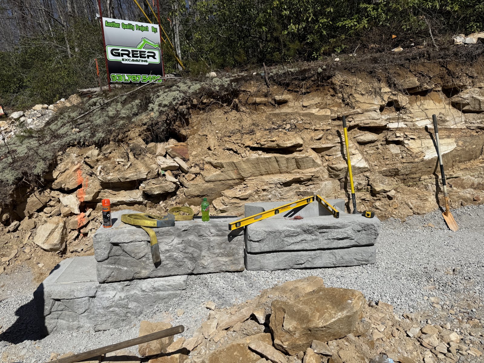

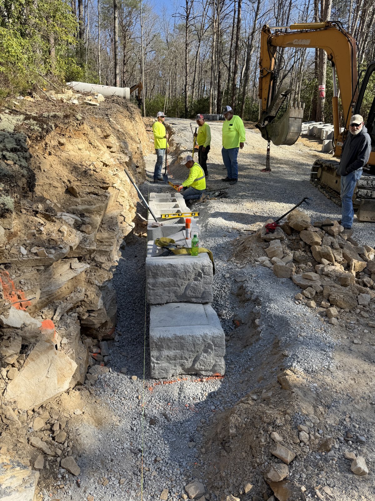

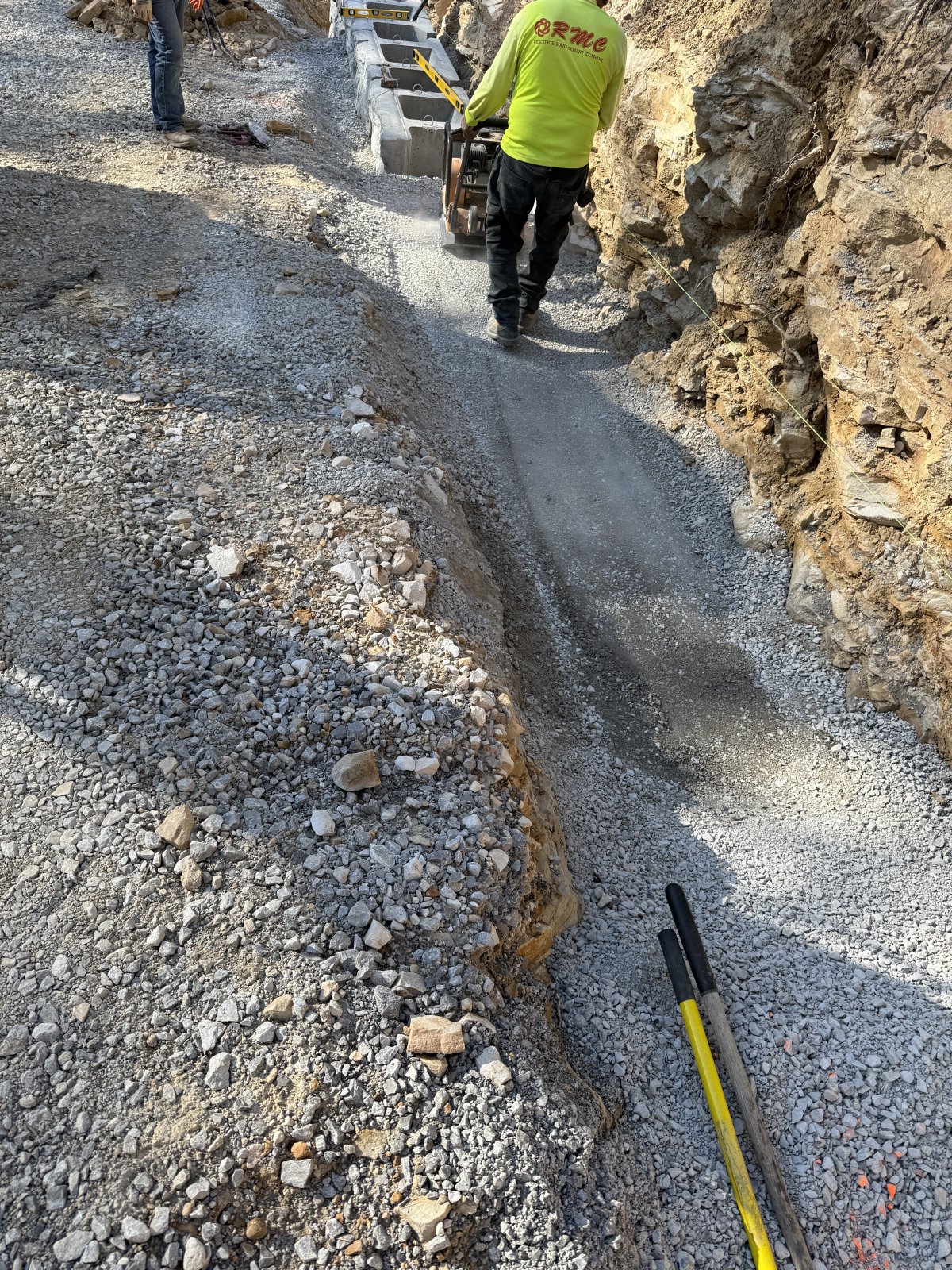

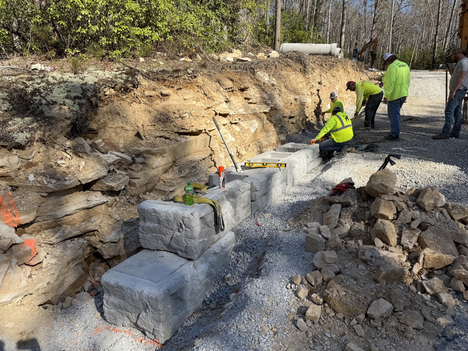

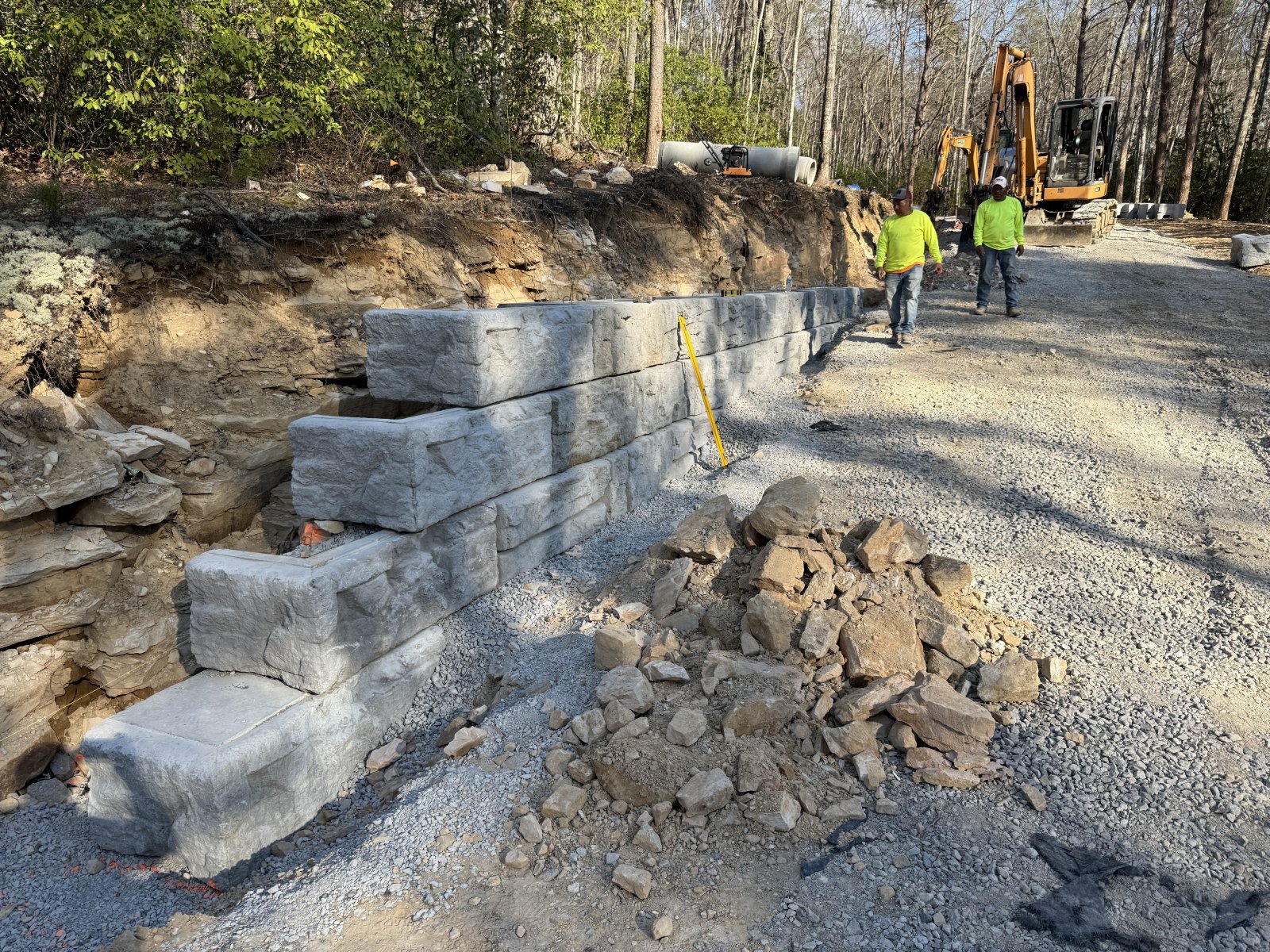

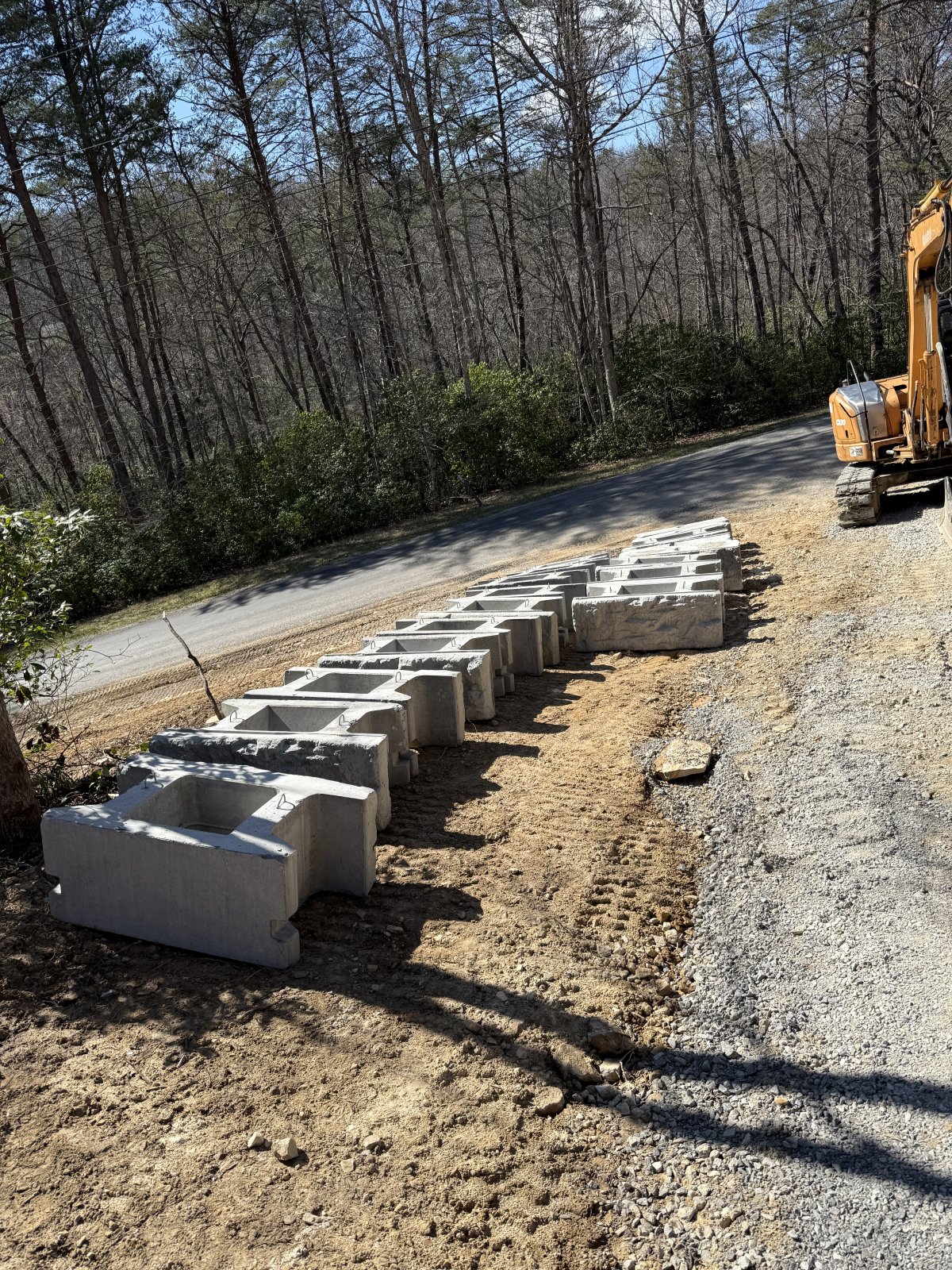

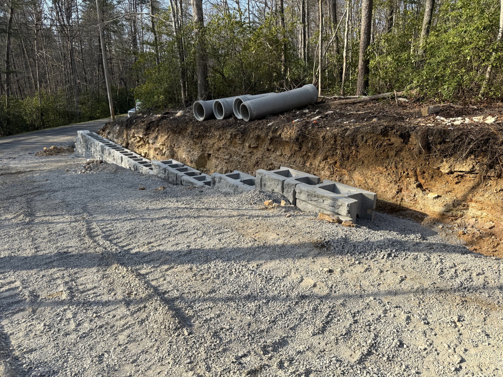

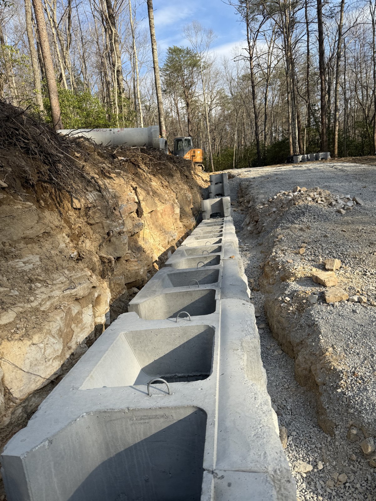

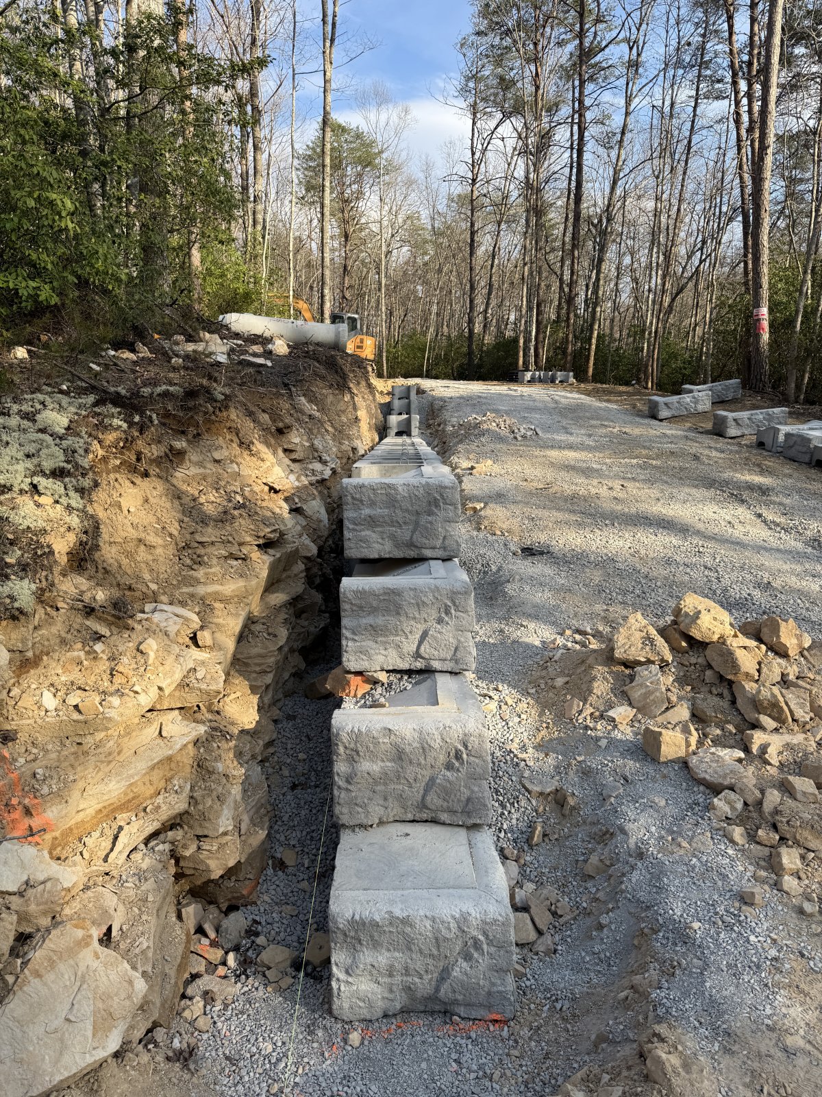

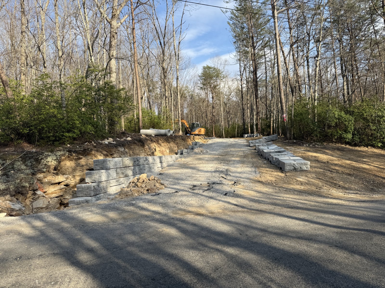

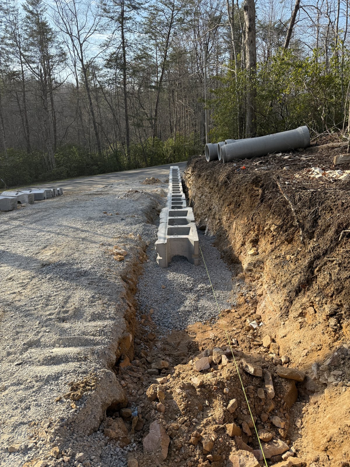

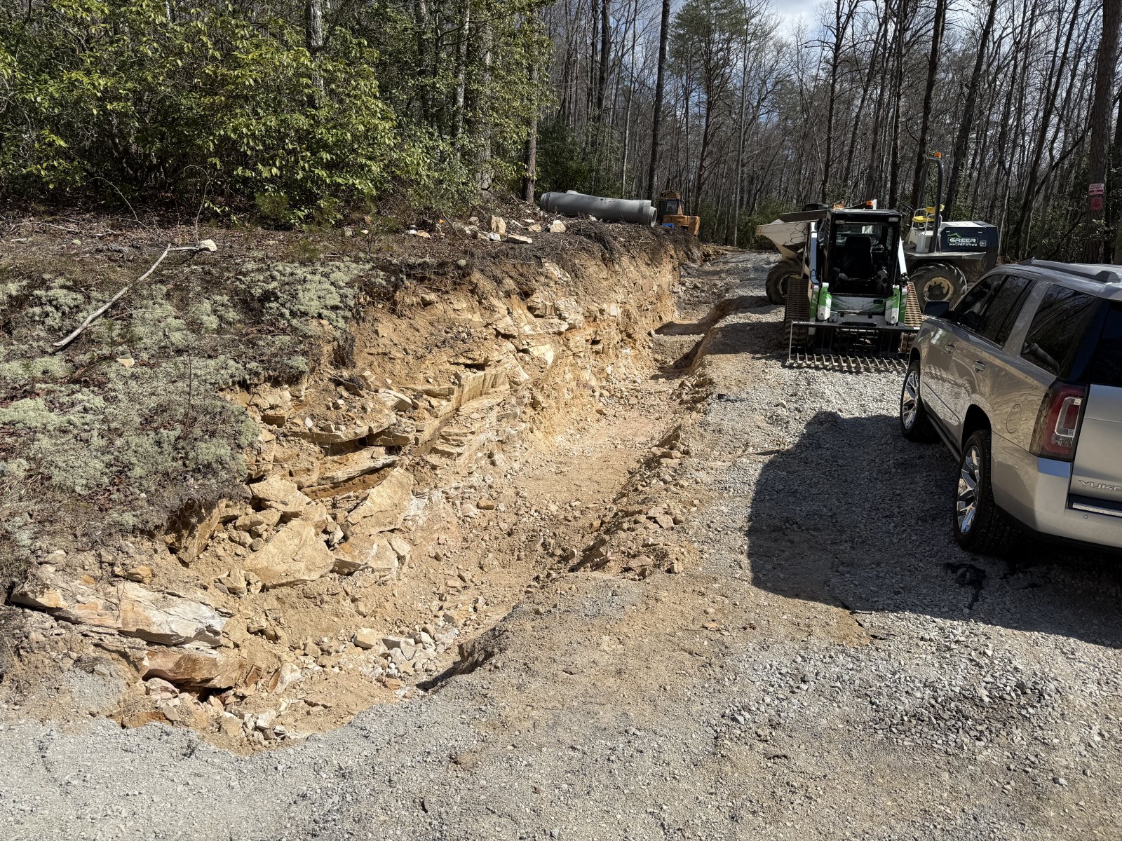

To get the base built for the retaining wall, we had to hammer out more rock. Basically go down a minimum of 12" and work up the hill. We over excavated (hammered) up to 30" deep to allow for the compacted base stone for the block to sit on. This process took a while, but it was a welcome change. Rain doesn't hinder beating out rock.

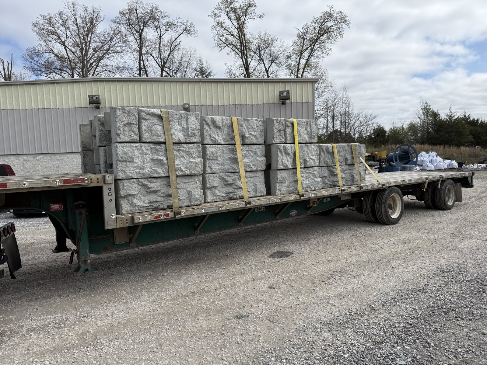

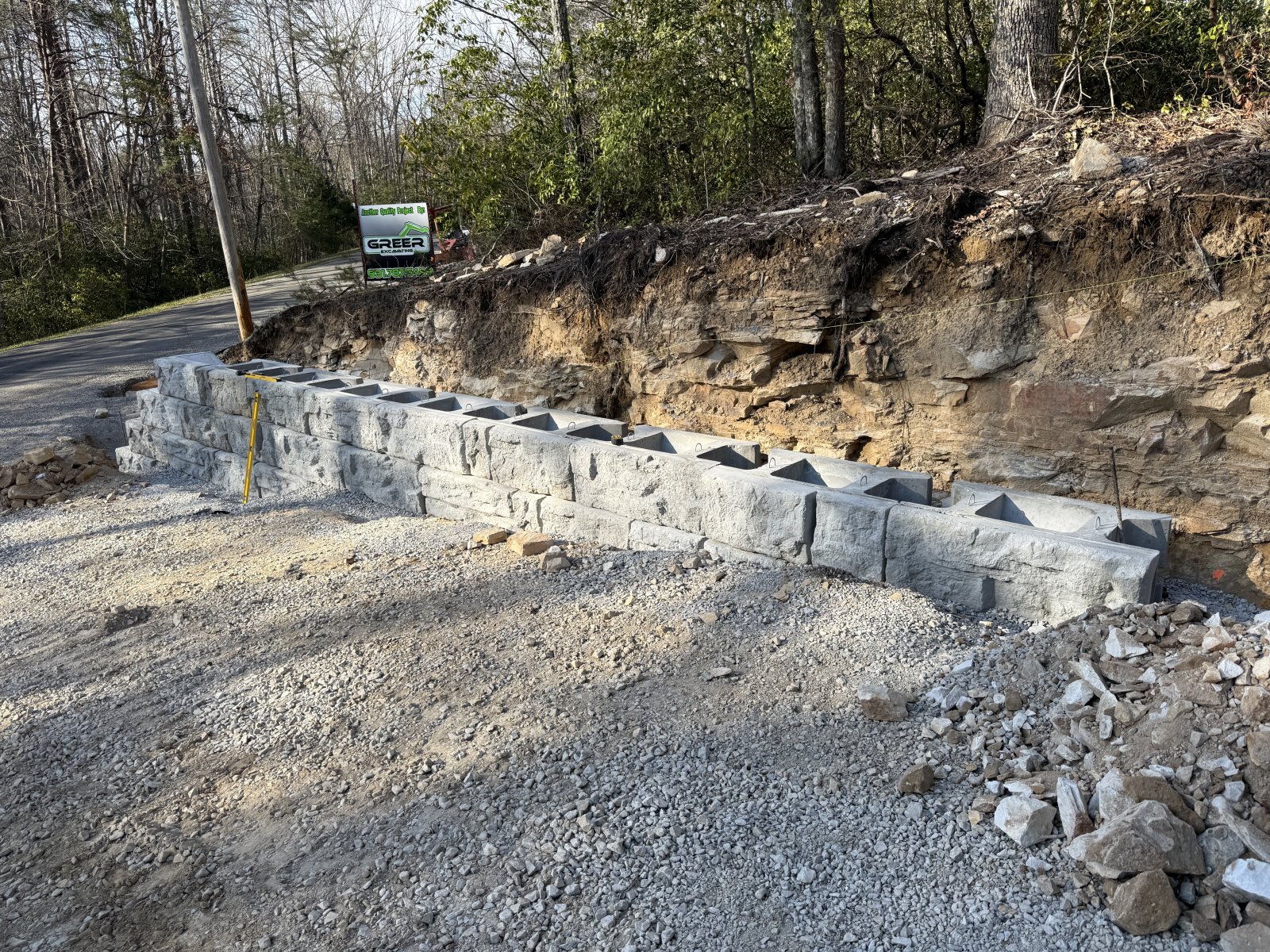

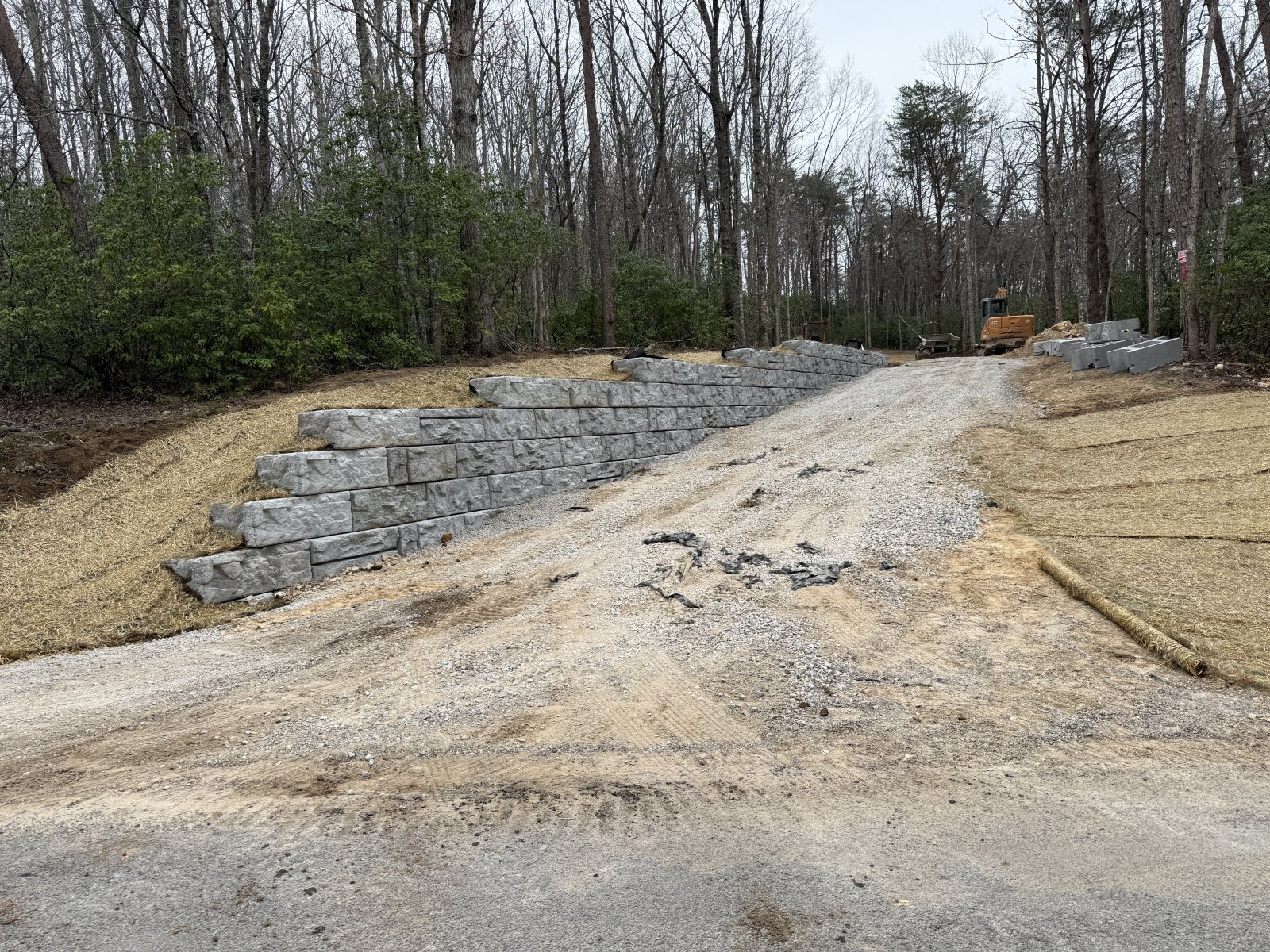

We went with the "fractured ledge" pattern from Stone Strong. We utilized the 6-28 block so I could reduce excavation behind the wall. Each block is 18" tall, 48" wide, and 28" deep, weighing about 1,500 lbs per block. This particular block can be stacked up to 6' high with no geo-grid or stone wedge.
(Shameless plug.... Visit www.stonestrongtn.com Pm me if you'd like more information)
This is the end of the hammering for the wall. Base corse takes the longest.
pwtr02ss
pwtr02ss
Apr 1, 2013
14,207
33,299
Tennessee

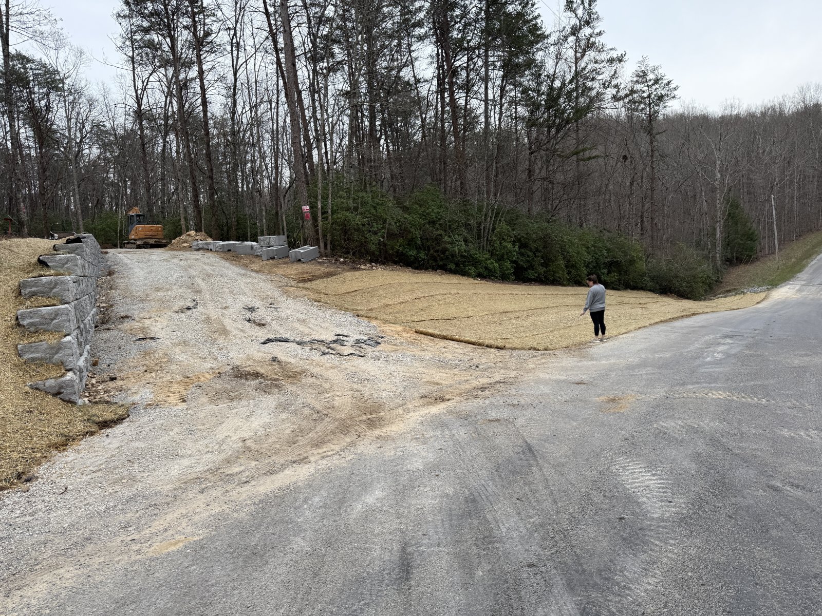

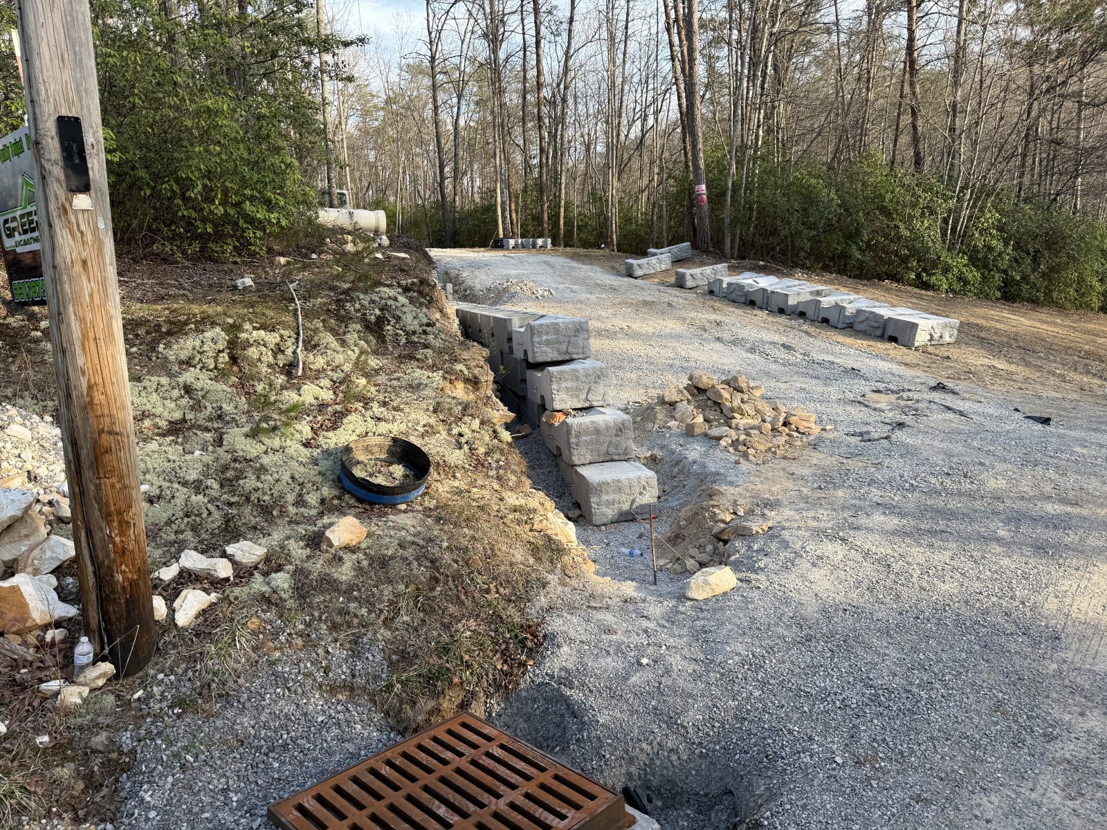

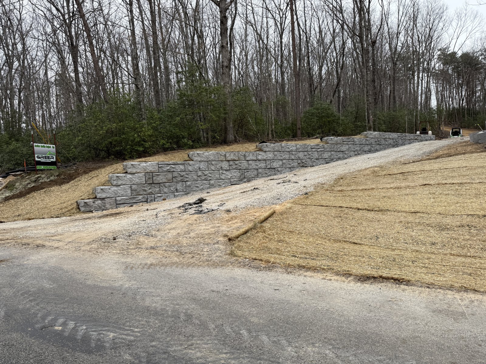

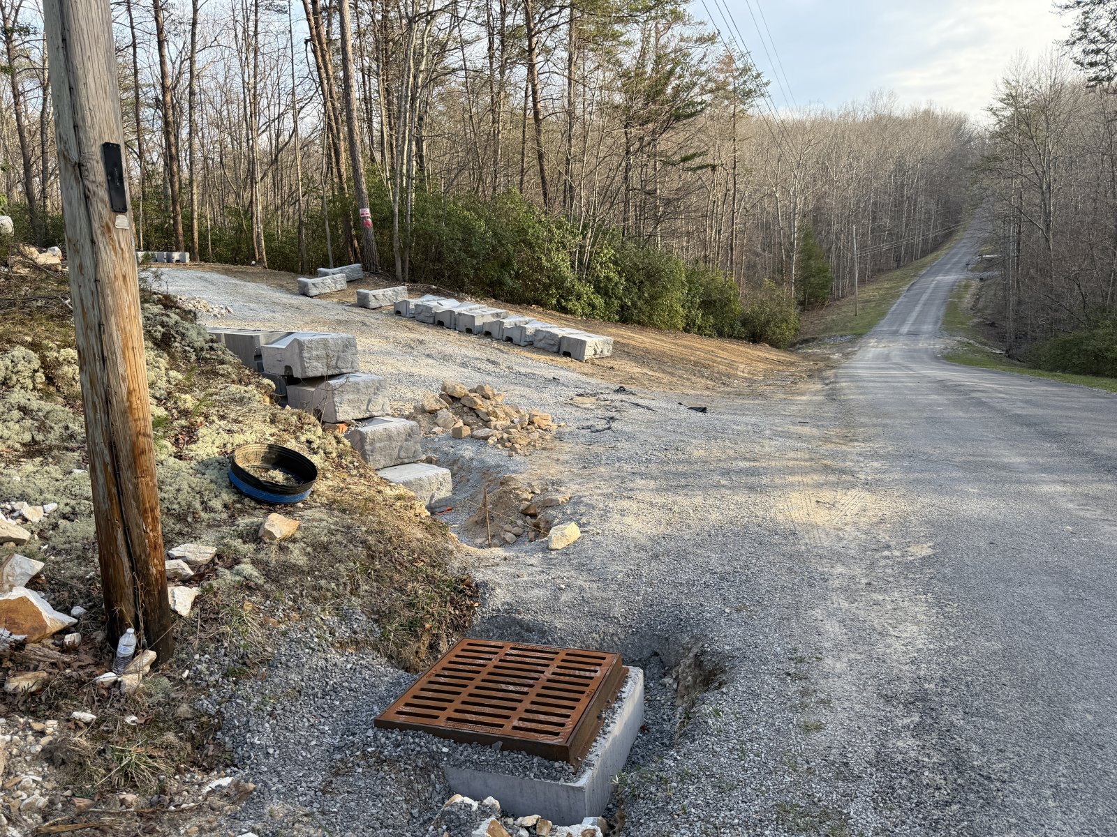

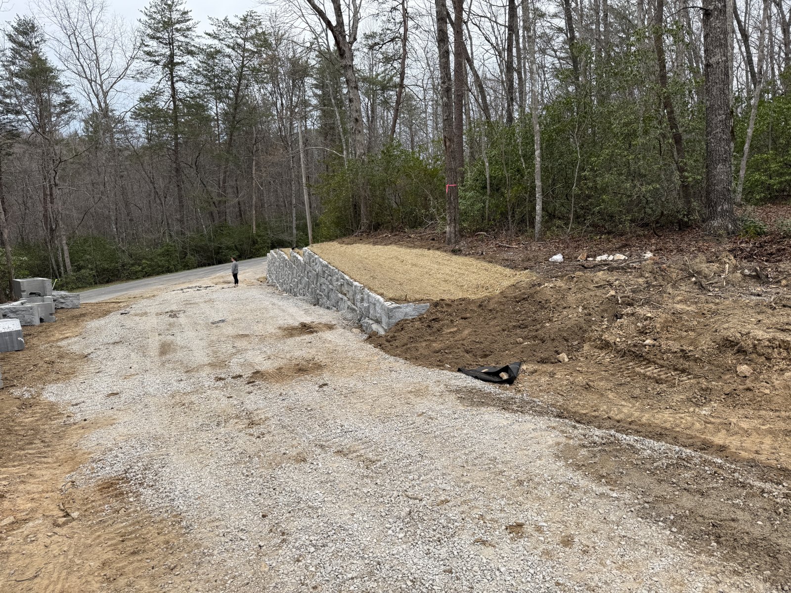

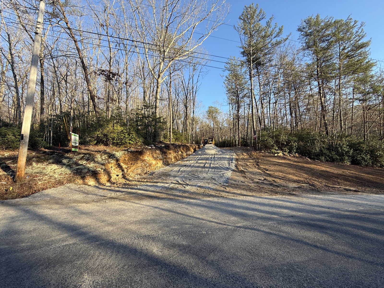

With the wall nearing completion, it was time to install the catch basin at the property line. The retaining wall has an underdrain running behind it, so I wanted to get that wrapped up so we could it into the the 18" trunk line that's running down to the creek.
Basin installed, last load of block shipping out.
Tada! We now have a retaining wall!
The void inside the block and behind it was completely filled #57 stone. This locks the block in while allowing drainage to flow to the underdrain. The stone is covered with non-woven filter fabric, then topped with top soil.

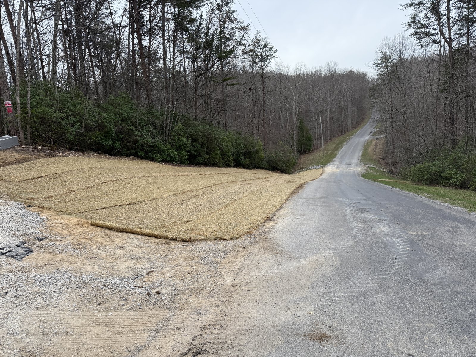

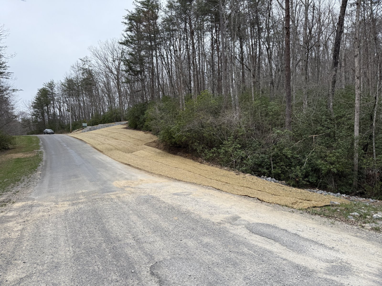

We seeded and installed straw mat. Rough grading behind the wall is also complete. The electric will need to be ran behind the wall, so this is just temporary. I was tired of mud washing in the road so this was a very welcome sight. Bet my neighbors are thankful too!
It's starting to take shape...
