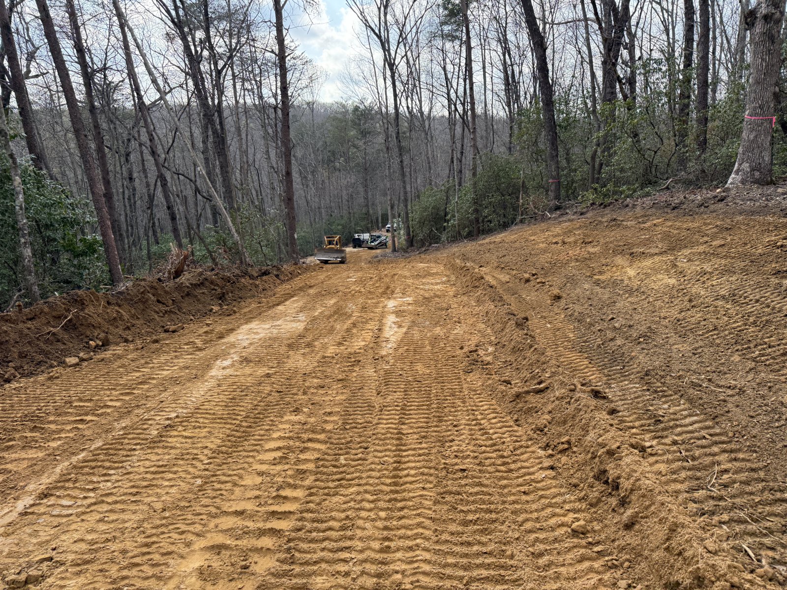

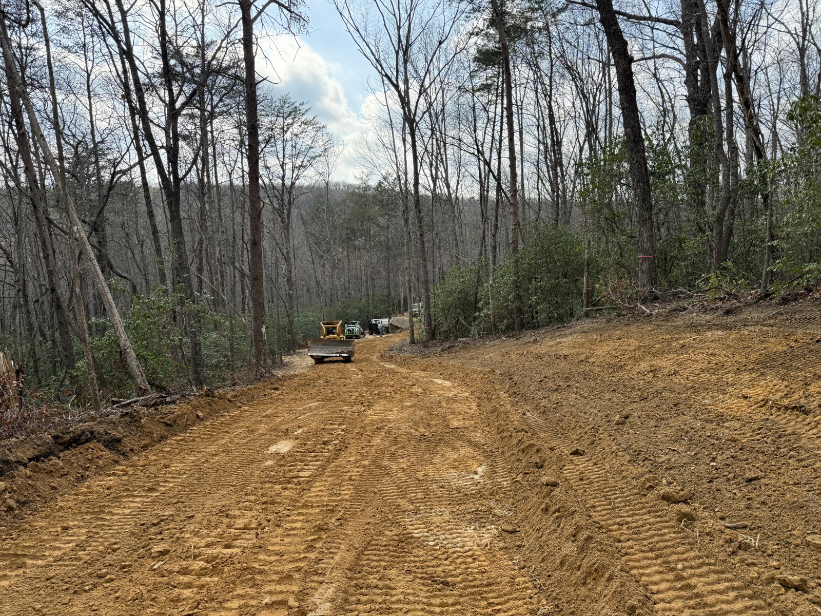

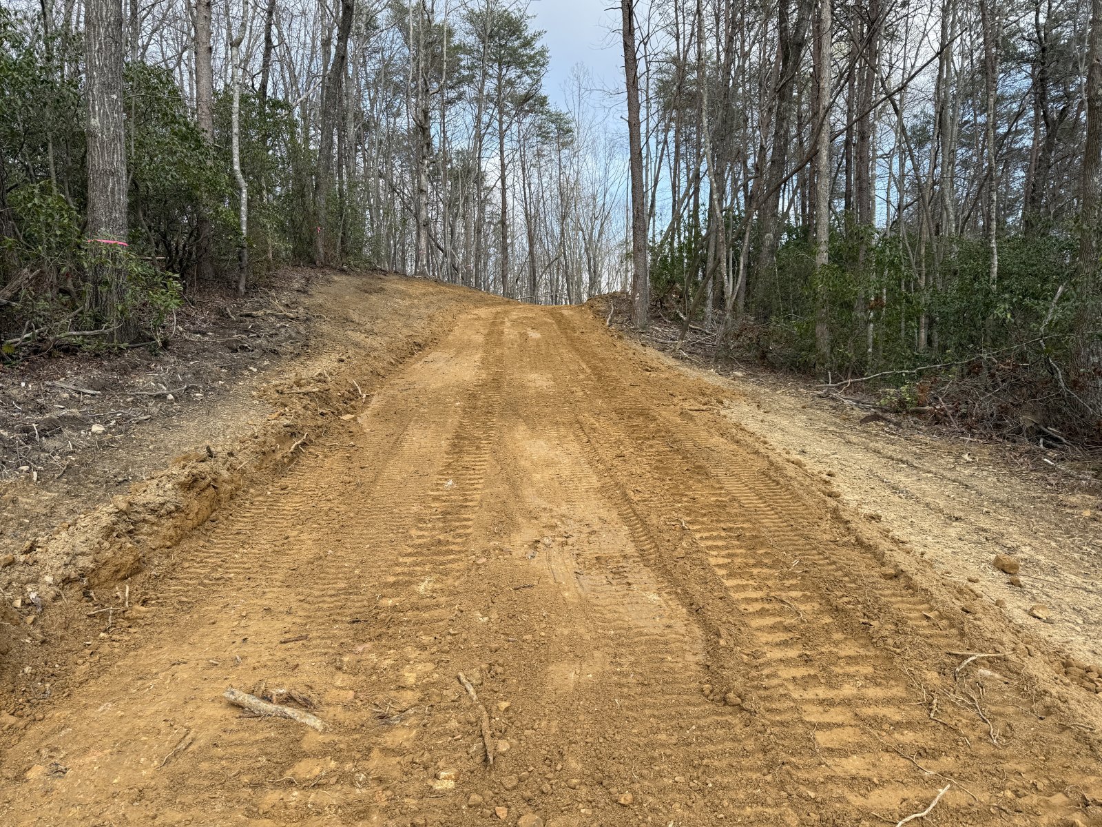

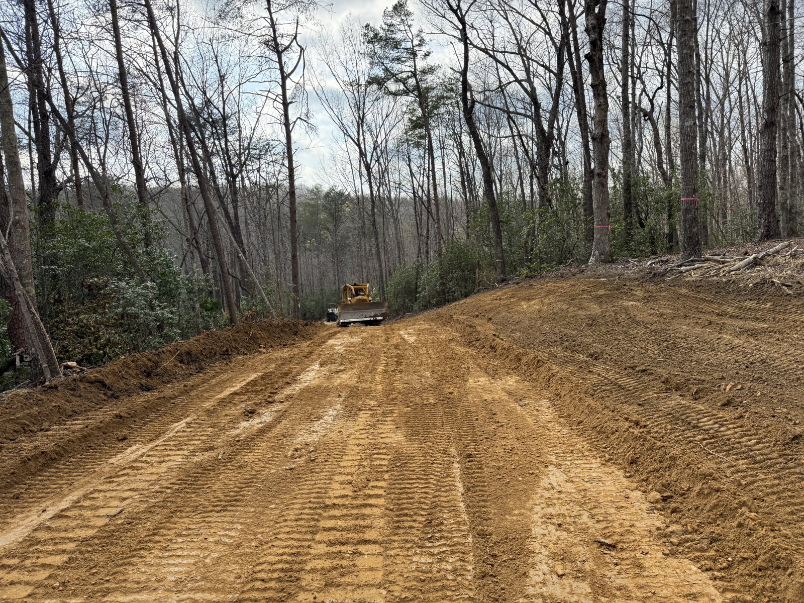

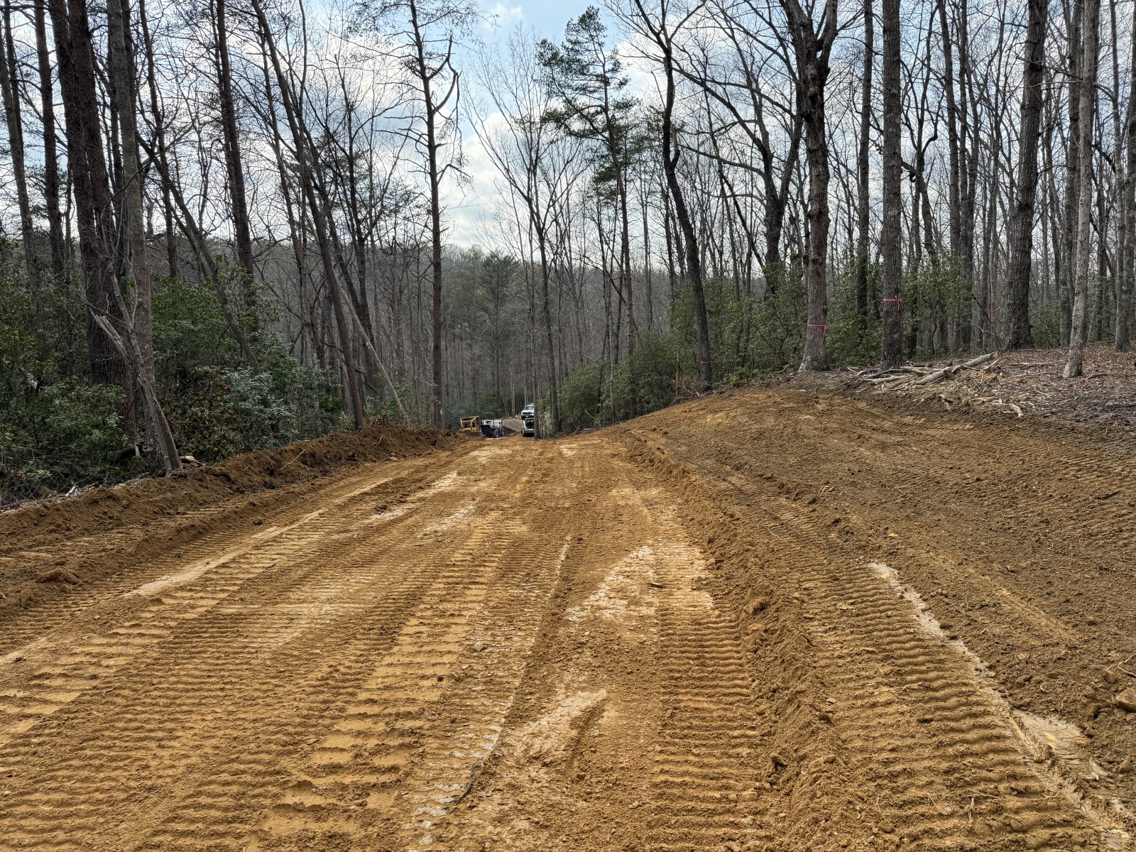

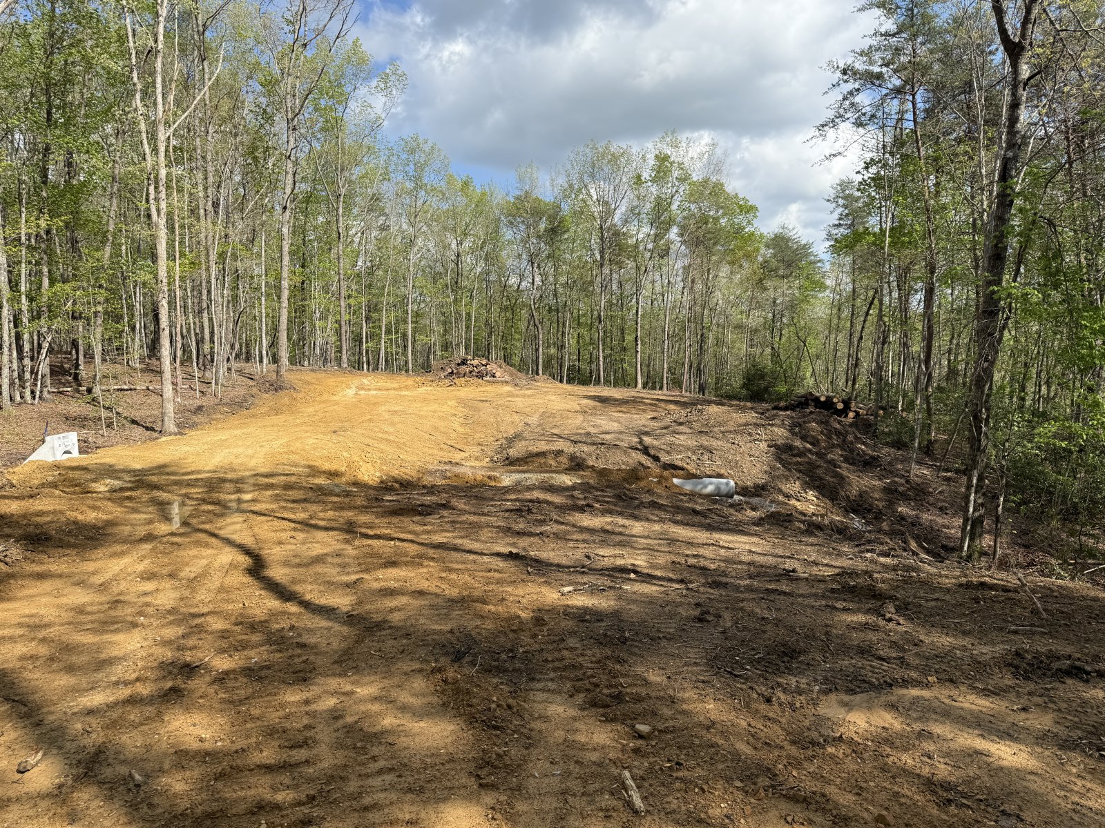

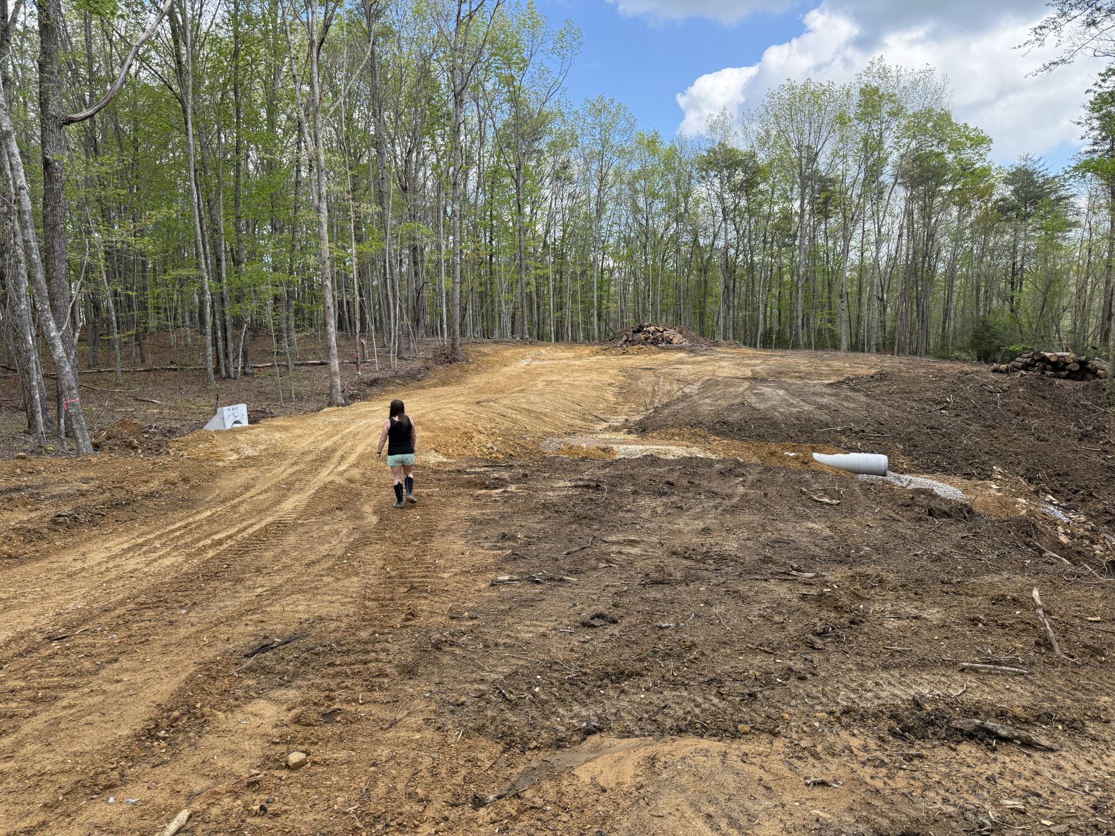

This gets us into April. Time to focus on the second hill. The grade was good about 2/3 of the way up, then it kind of ramped up. We cut about 12' total off the hill and blended it in. This helped the feel tremendously. This is final grade for that portion.

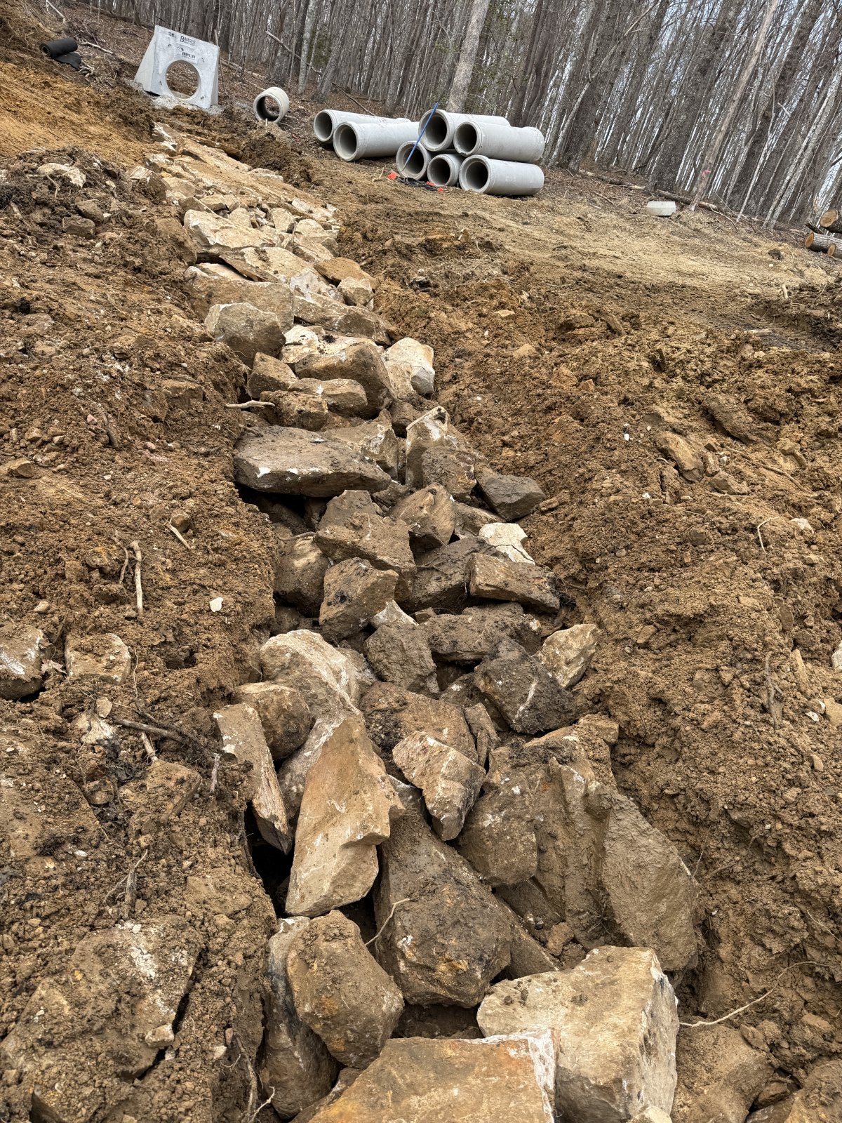

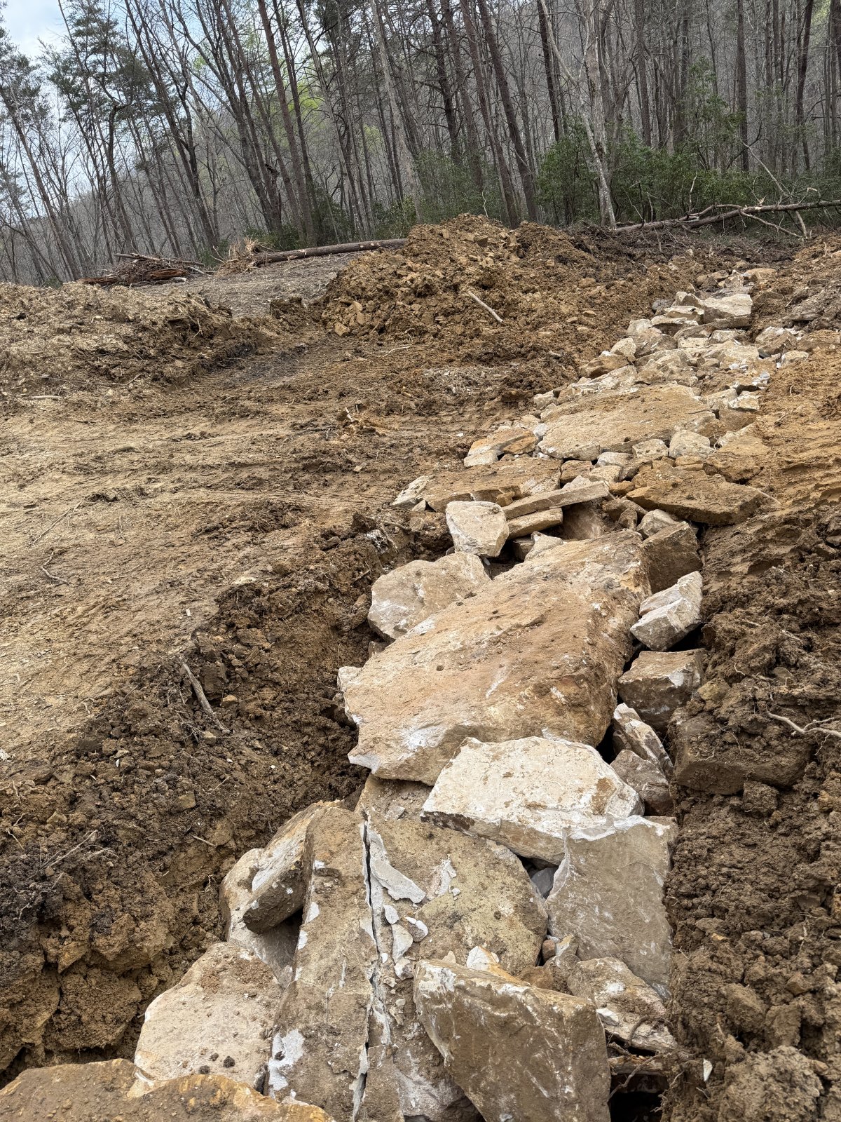

While they were cutting the hill, a second crew was preparing to lay the 18" RCP across the valley. While digging to prep the pipe bedding, they hit an underground stream.
To fix this, they excavated down about 6' to solid rock. This required more trees to be cleared so they could get the stream to daylight out. Once all that was done, they backfilled filled with busted boulders we had dug out from the front, backfilled that fill 1" stone, then covered with filter fabric and started on the fill. I went on vacation right after this.

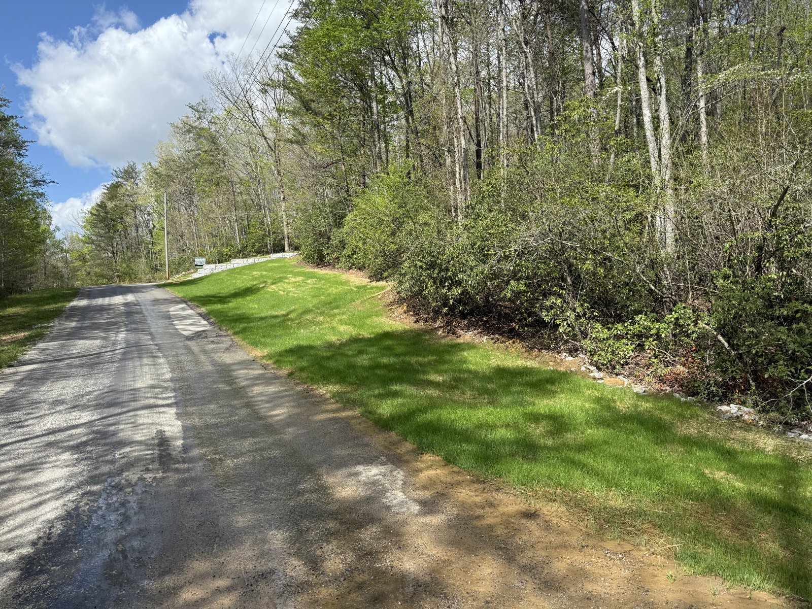

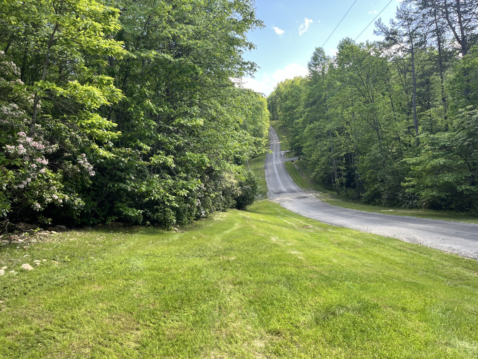

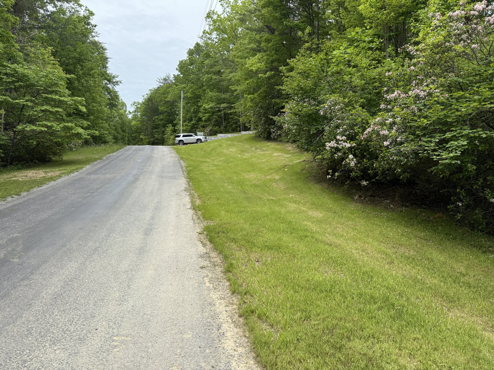

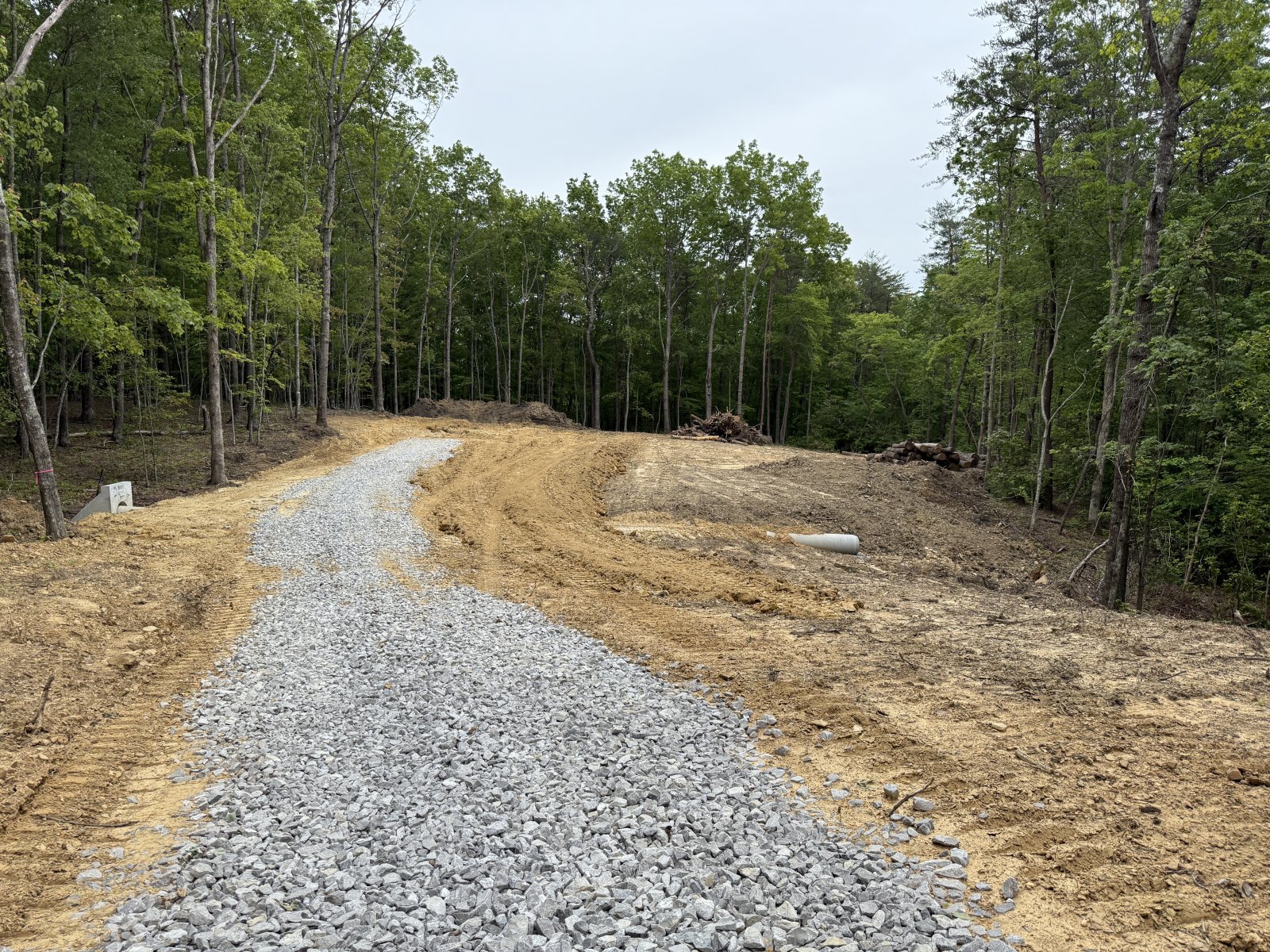

We now have a grass!
I still had the inlet protection filter on the catch basin so water was standing in that area. The excess ran out in the road. Good news, it's clear water and not mud. You're welcome neighbors!

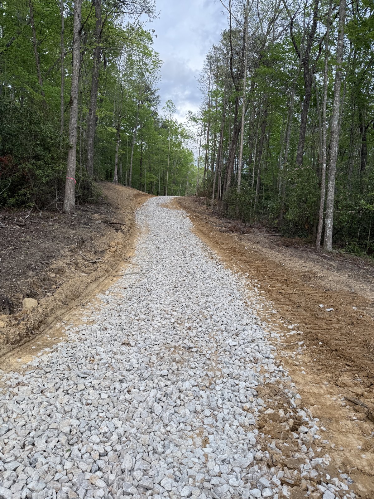

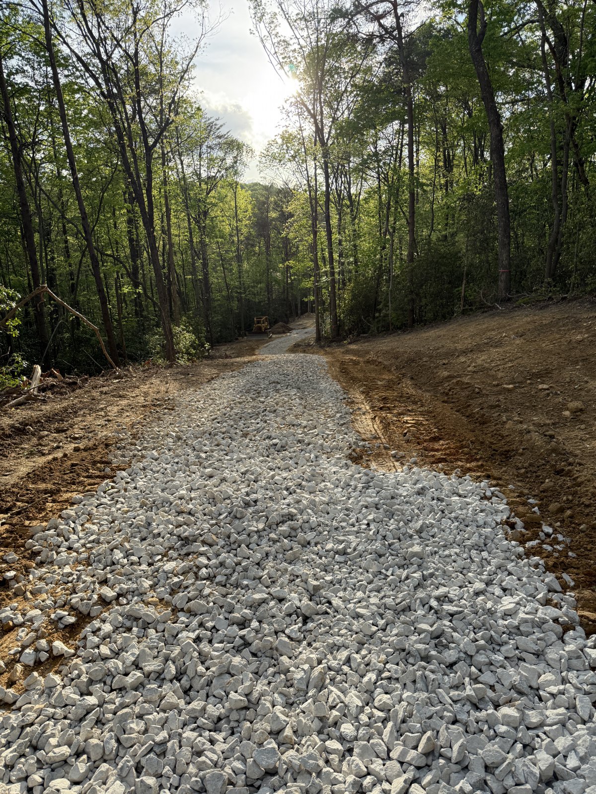

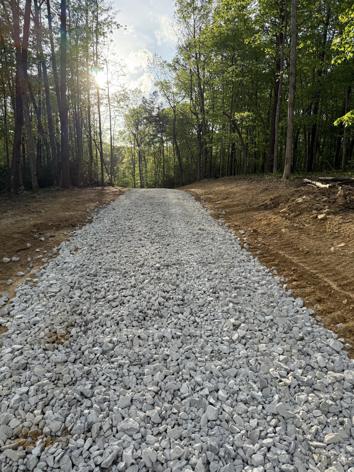

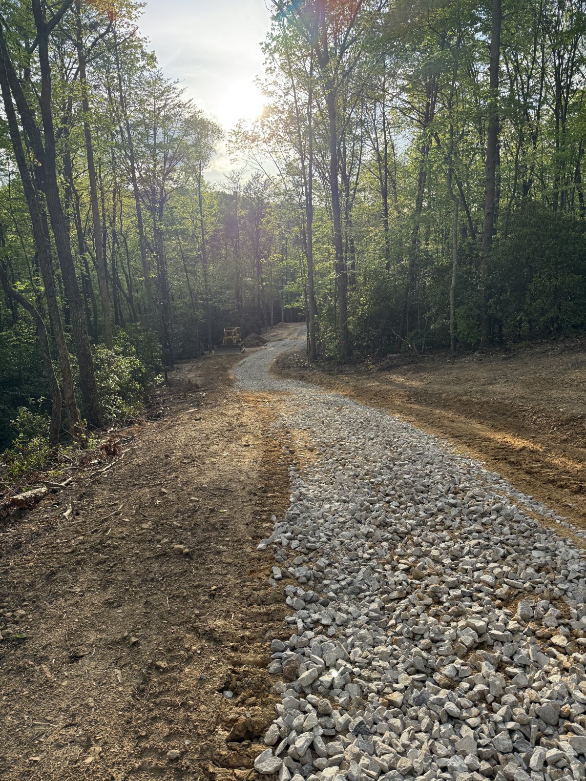

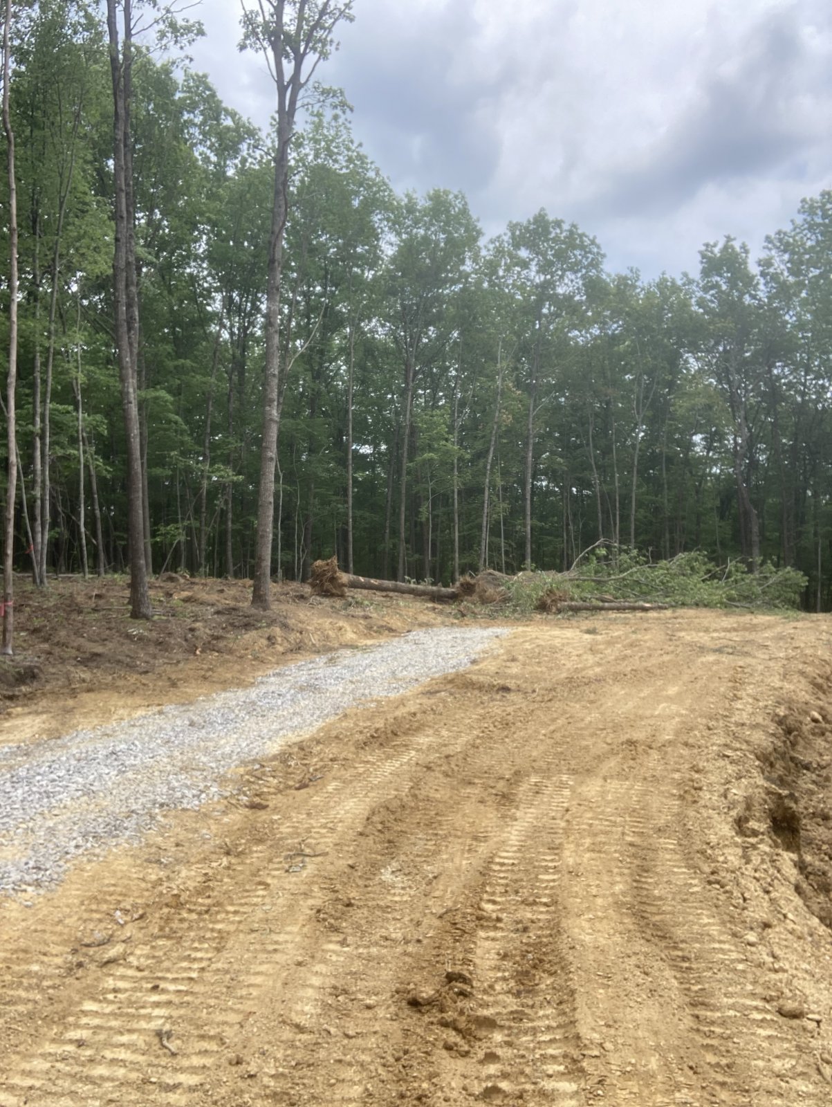

Next, they started laying gravel. 2" for base stone. They didn't get as much as I would've liked, but it's a start

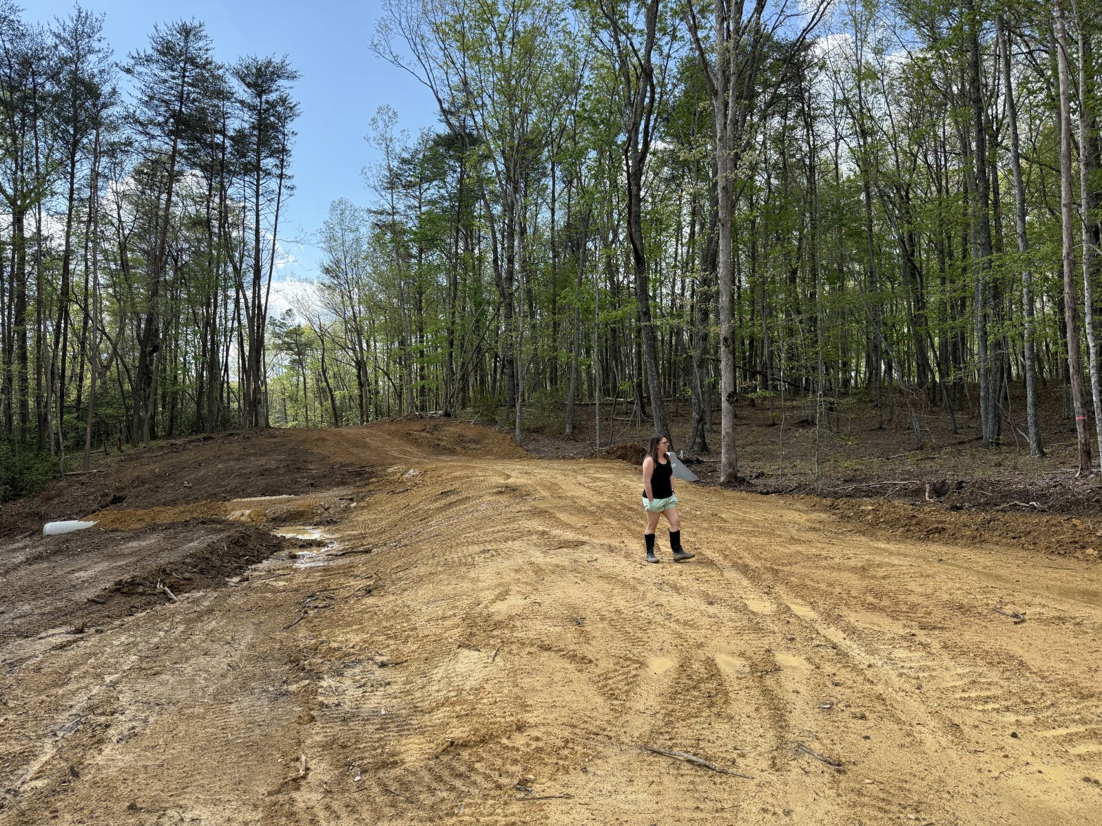

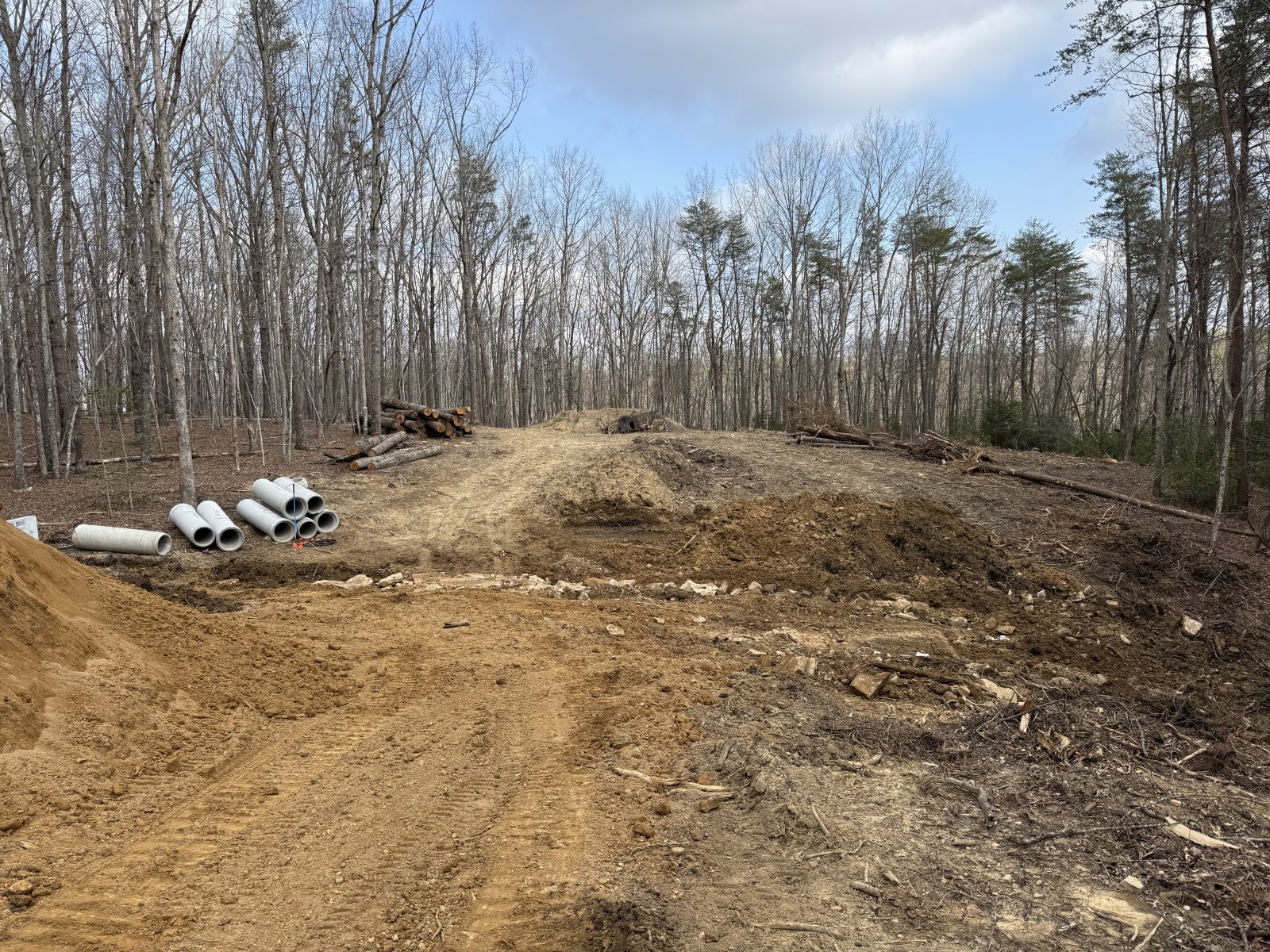

Our original plan was to leave the valley area as is and not clear anything. Simply run the pipe over to a good stopping point and put another headwall. Done and done.
Since that didn't happen, I decided to make the best of it and utilize that property. As you can see in previous post regarding this area, they had stripped the topsoil (the dark dirt) and pushed it over to the valley. This will be removed.

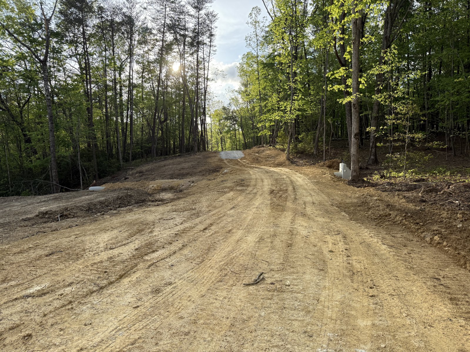

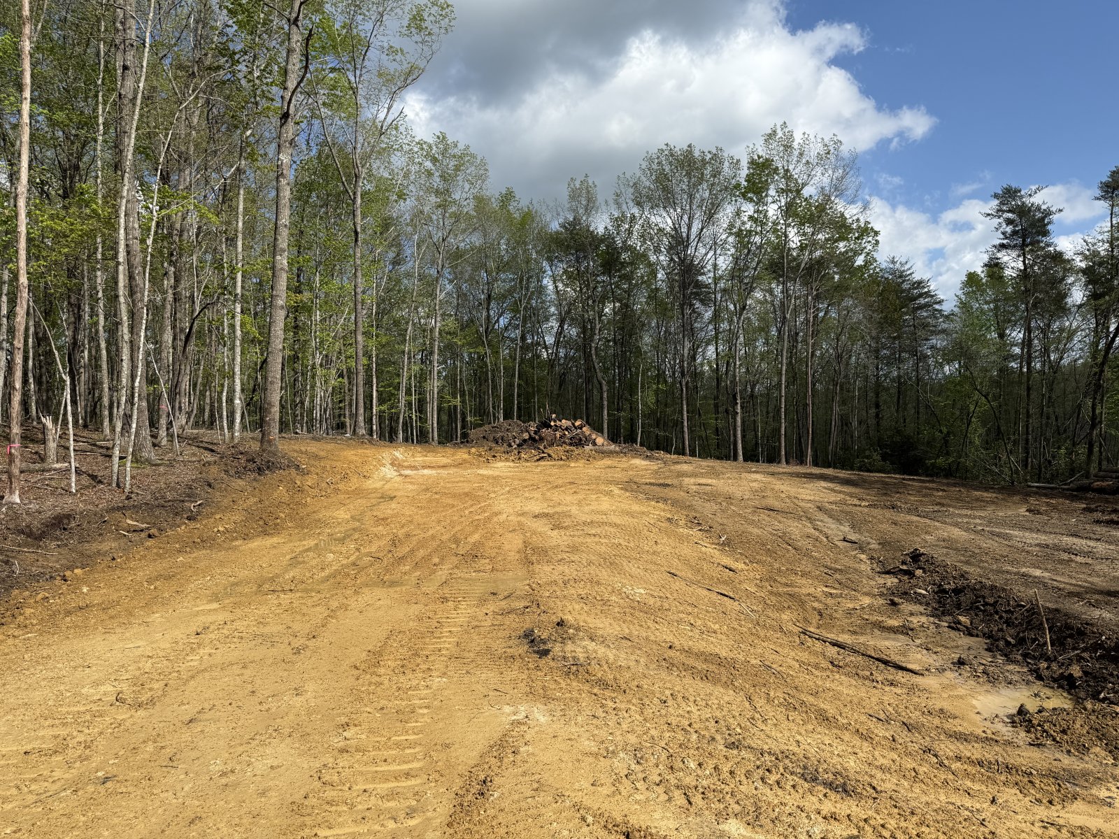

They started doing some cuts on the crest to balance the site better.

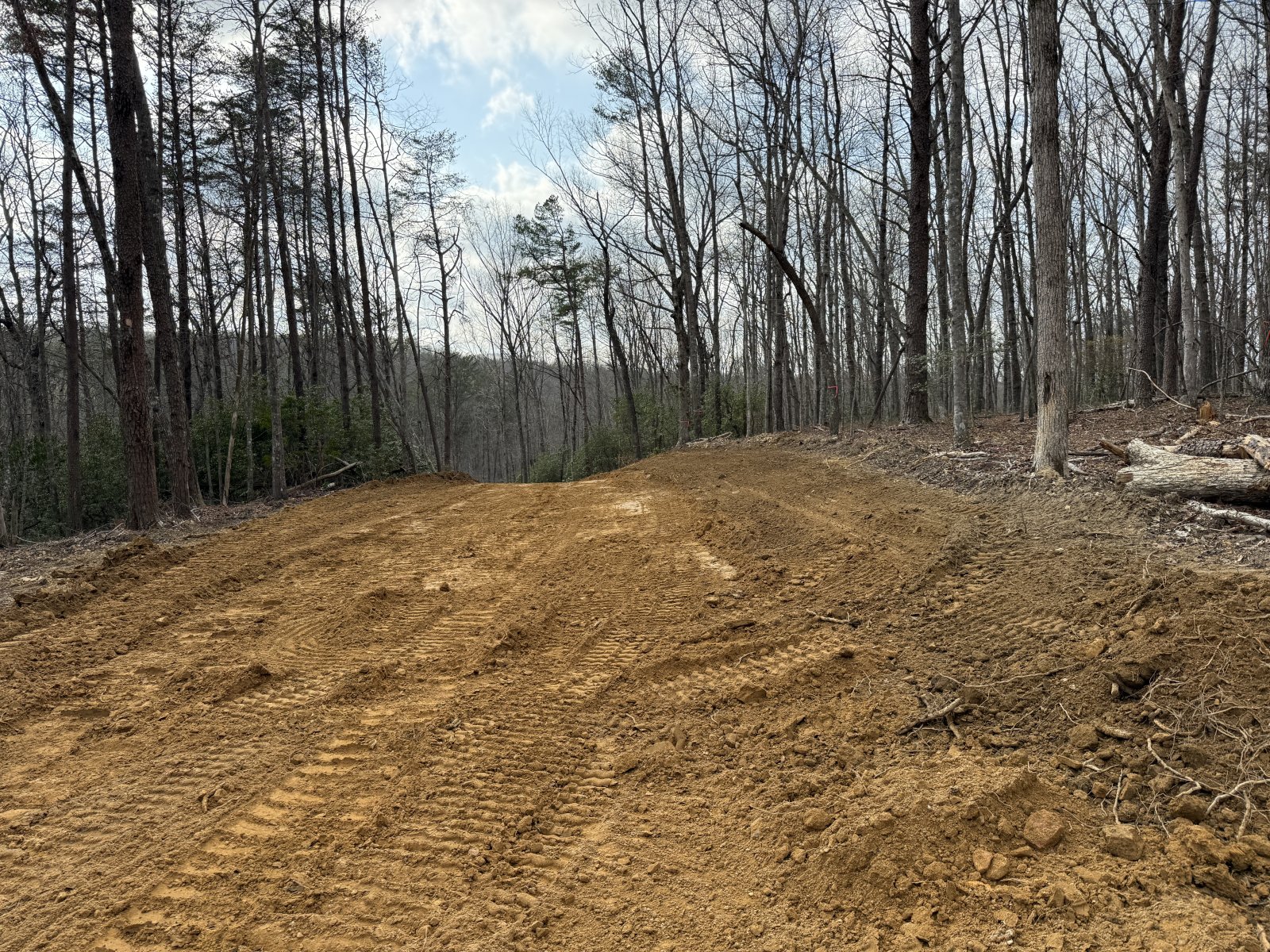

This is around a 5' cut. We're going to do a total of probably 8' or so. This was this past Monday
While we were out there, Steph and I added new markers to replace the weathered survey ribbon. During this, we realized we were sacrificing up to 75' of land if they continued the cut at the angle they were going. Now, they're going to go within 10' of the property line and cut. This will give me all the fill dirt needed to completely balance this area of the site.
They started clearing on Thursday. Here is a picture the guy sent me

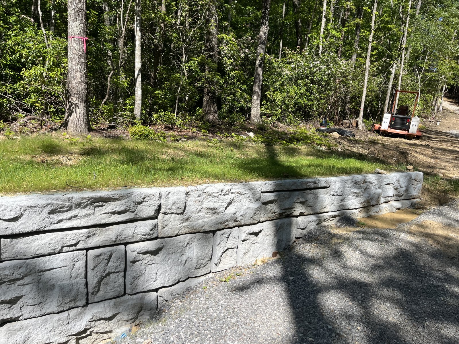

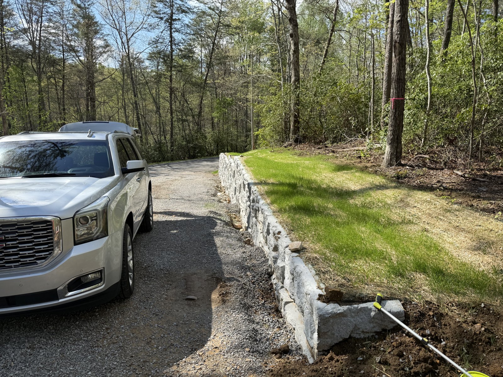

We also had the first cut on the grass. I'm really happy with how it looks.
I removed the inlet protection and so far, the water is running in the catch basin and not in the road.

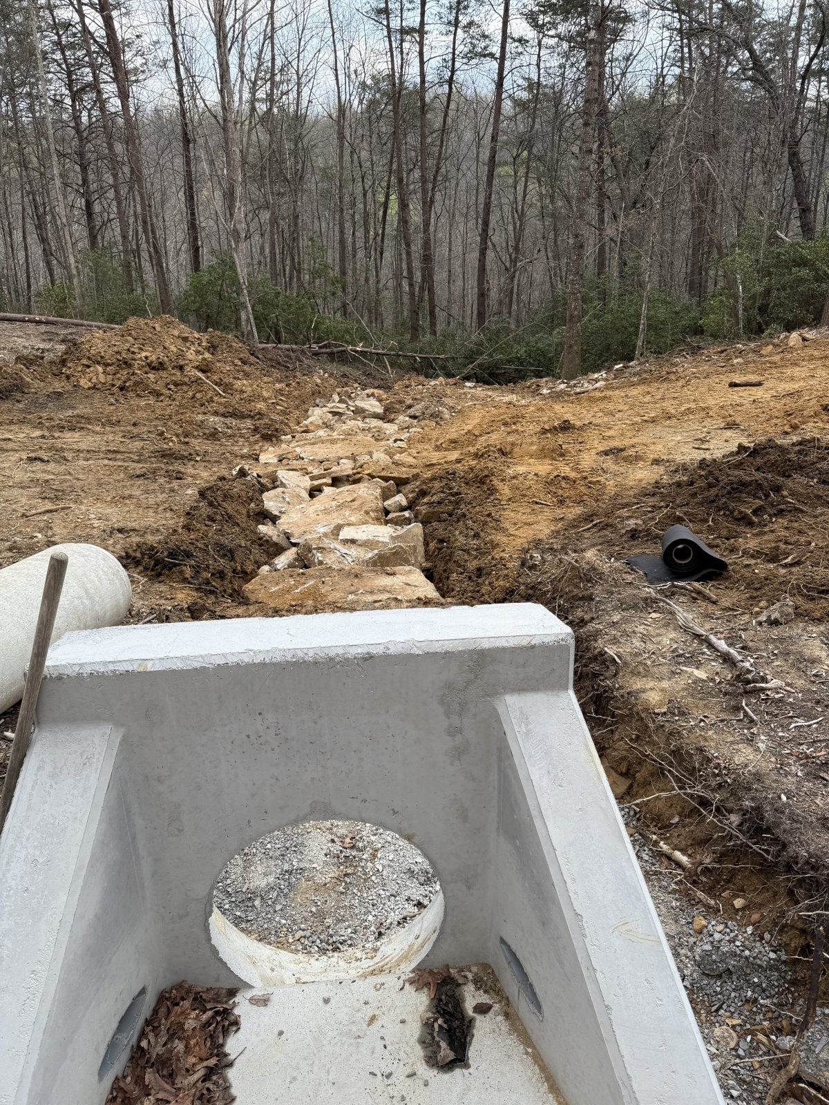

They shot elevations for my catch basin that's going in the valley late Friday. The pipe is going to come in about 10' higher than the outlet pipe. I'll also tie in a couple 4" under drains to catch the water from the under ground stream. This will pipe out to headwall and dump off the side of the mountain and into the stream, 90-100' down.
I'll try to get the structure poured on Wednesday, maybe they can install it Friday? It's going to take two more joints of pipe to get it to the structure, then I think 3 more to get to the headwall.
