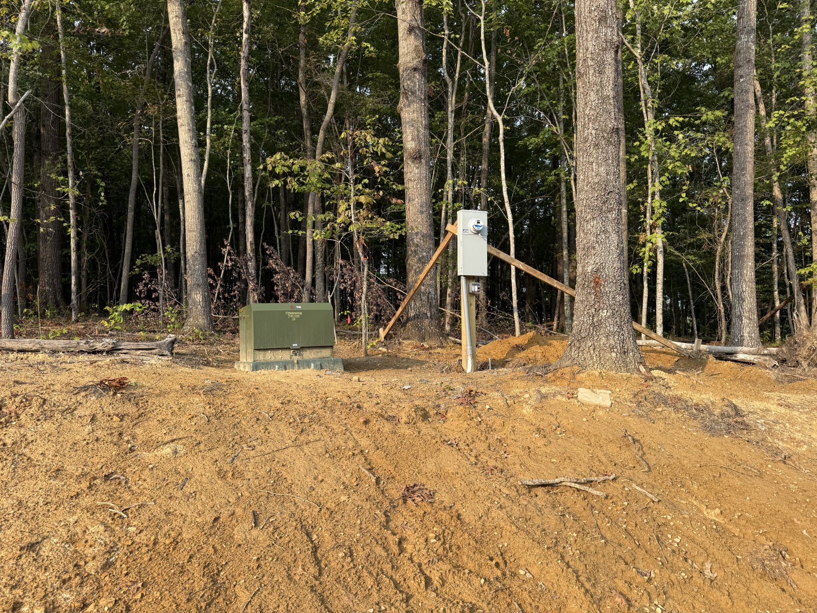

is the meter required to be on a post close to the road for utility company access or will it eventually be placed directly on your house?
This is temporary power all the way at the back. This is for the construction phase. Once the house is framed, they will come back and mark where they want it installed on the house. I just bought a temporary power pole all assembled. I think it was like $900. Power company provides 750' of wire, $8/ft after 750'. They estimated id need 1,035' so I paid $2200ish, plus the $200 hook up fee. This doesn't include conduit, temp pole, or installation of said conduit material
I'm having a 400 amp service for la casa.

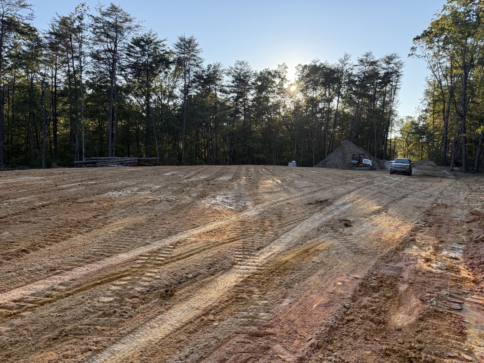

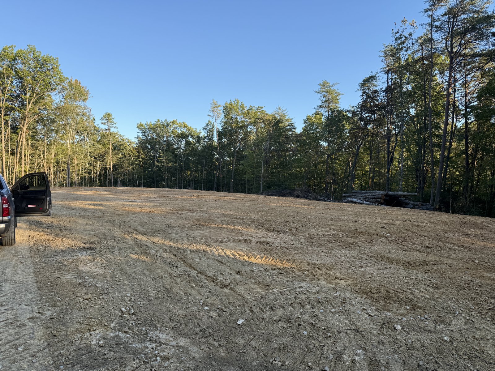

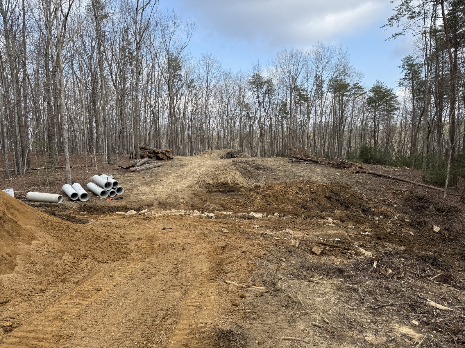

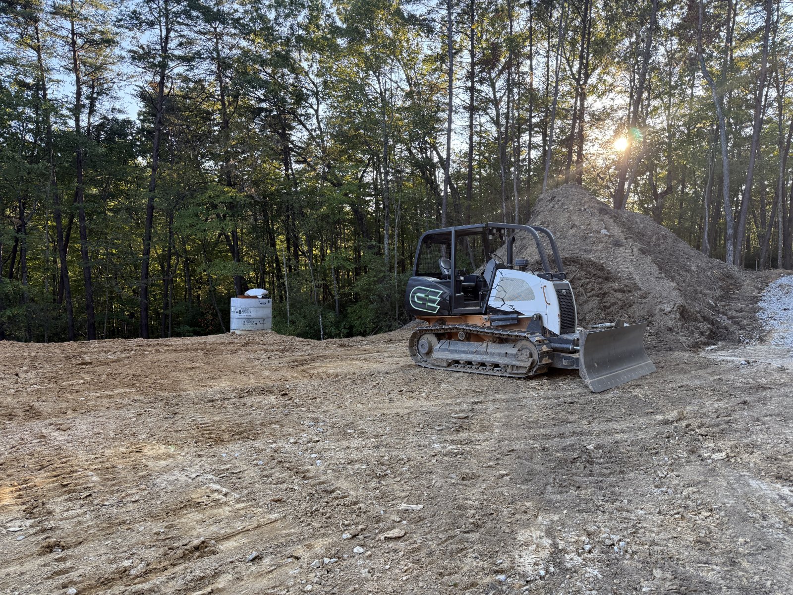

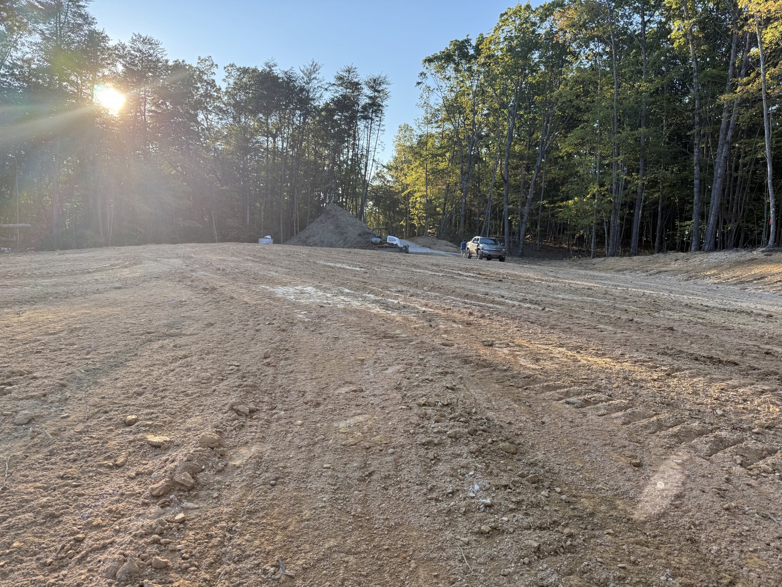

They moved a smaller dozer out there this week. They got the driveway cut 12' wide from front to back, worked on the ditches a little bit, and cut another 2' off the site. The shop building pad is leveled now. I'm going to be short some dirt off to the side, but the pad is good. It doesn't look like much, but it is. The current setup is 37' from the far edge of the proposed driveway to the front on the shop, then 40' deep shop. I didn't believe it, but confirmed with a tape measure.
No pics of the driveway, but here's the current state of things.
Here you can see where I'll be short on dirt. Catch basin is still stacked too tall..
The shop area
Said dozer
This angle shows the catch basin height relative to the level pad. Looks better, but still high and I'll lower it more than needed, then bring it to grade with a concrete grade ring. It'll need to be a little low for drainage
Steph because she hates it
For those of you that have been keeping up, we've cut around 9' off the highest point of existing ground and balanced the site with that material.
