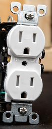

Have you ever walked into a room that doesn't have overhead lighting, and had to flip a wall switch to turn on a table lamp? Usually electrical outlets like that are wired so that one of the duplex outlets is switched on/off by the wall switch; but the other one is hot all the time, like a normal electrical outlet.
Pic of a duplex outlet below. Both sockets can be hot at all times, or one can be controlled by a wall switch. Or both could be controlled by a switch, but that's not very common.
I get what you're saying now.

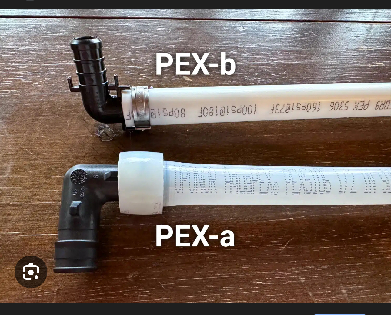

I asked because you mention restrictions a lot.
Pex b is most common but 1/2 is really 3/8s at the fittings. Pex A is true 1/2 as the pipe is stretched over the fitting and maintain flow

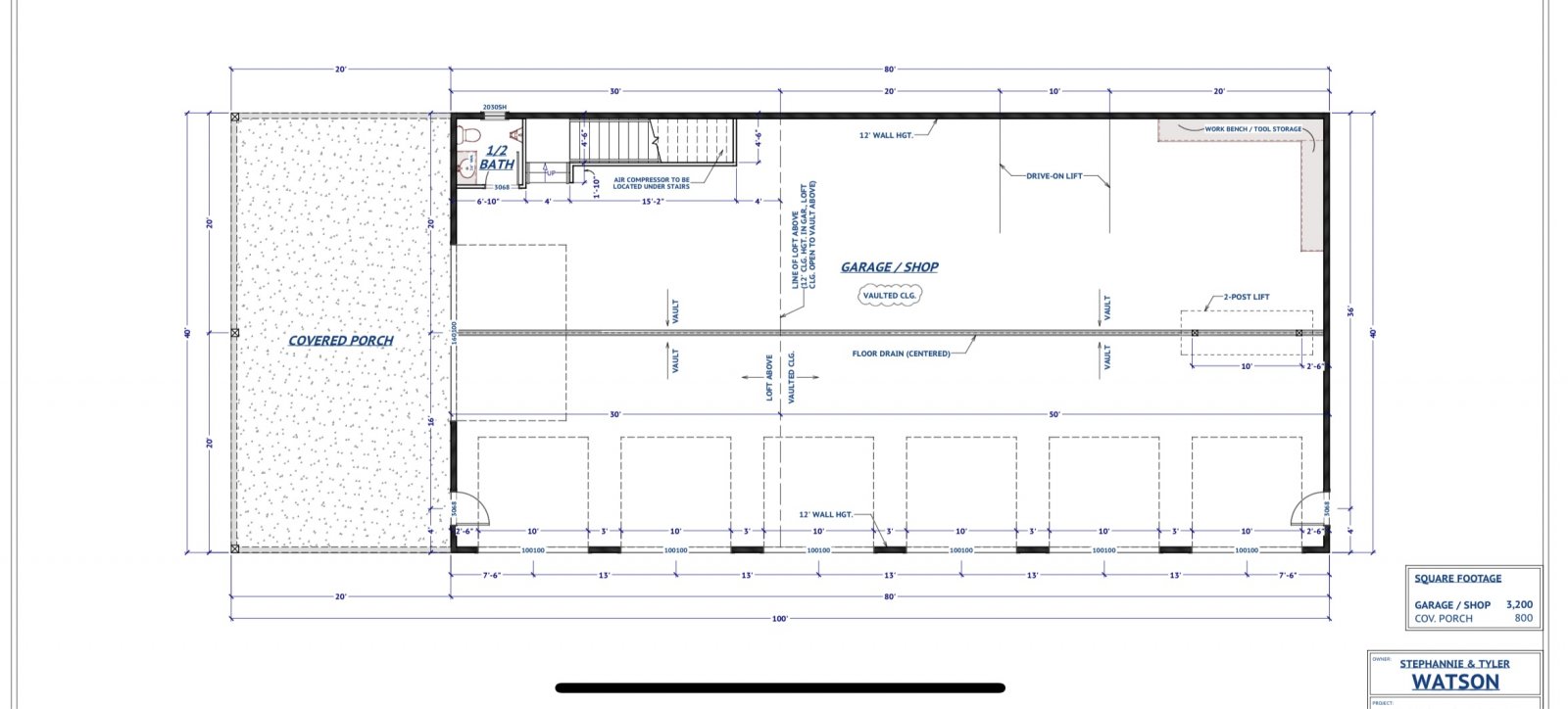

First round of the shed plans. I'll adjust the stairs. IMO, would be better going above the bathroom and into the bonus area.
Screenshot
i was gonna say, do you really need a covered porch at your shed? I just googled pictures though, looks like the porch would be functional for shaded outdoor work?
