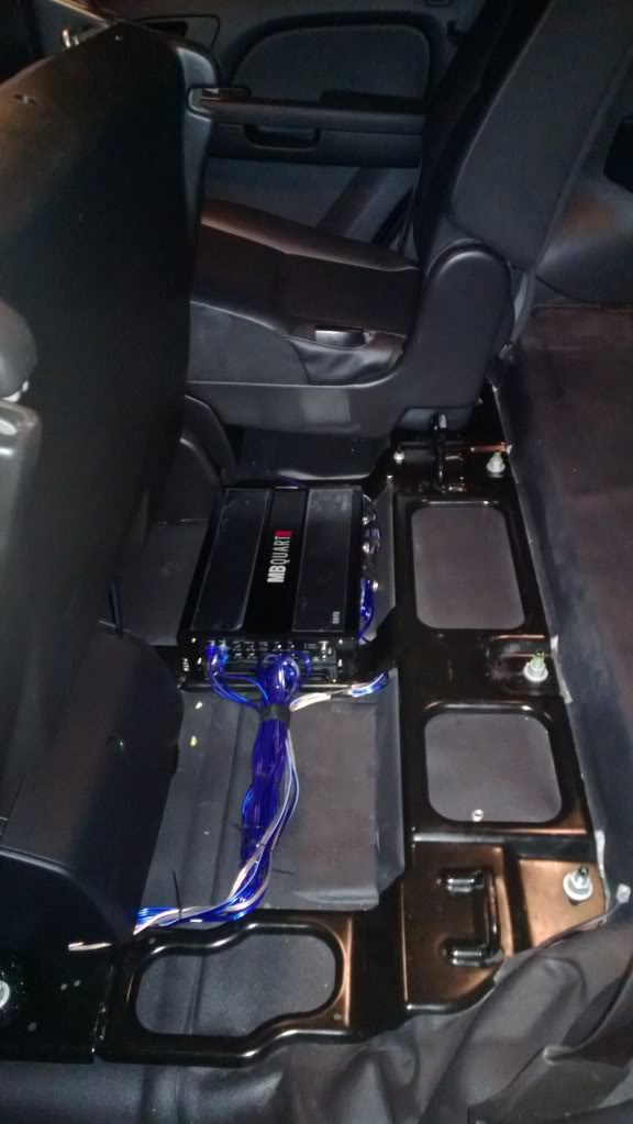

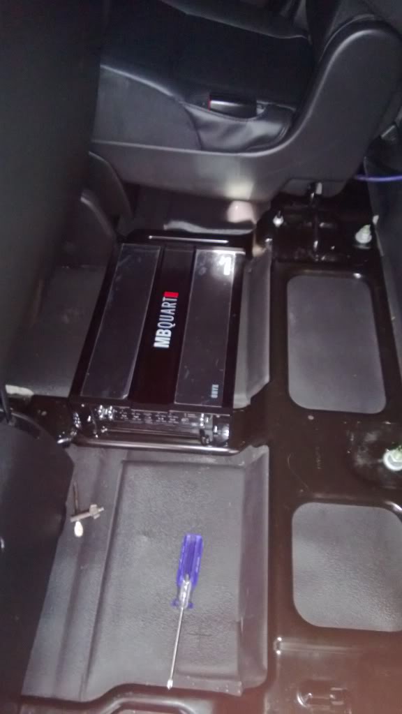

Mounted my amp under my second row and ran rcas, speaker wire, and power wire to it this evening! Decided that I'm just going to mount the eq inside the center console facing up, I won't really be using it for anything regularly, and if I want a physical volume button ill just throw a pac lc1 in my dash somewhere which now that I think about I'll prolly get soon and put it in lol Tomorrow night I'll be putting my door speakers in and depending on how fast I can do that I might be able to get a test run with everything :D

Nice work. I got to kick myself in the ass and get started too.
I think I'll also be putting the amp and sound processor in the center console. That will keep wiring much easier, and there seems to be a lot of room in there. If it gets too hot, than I'll probably install a pc fan to draw the heat out.
