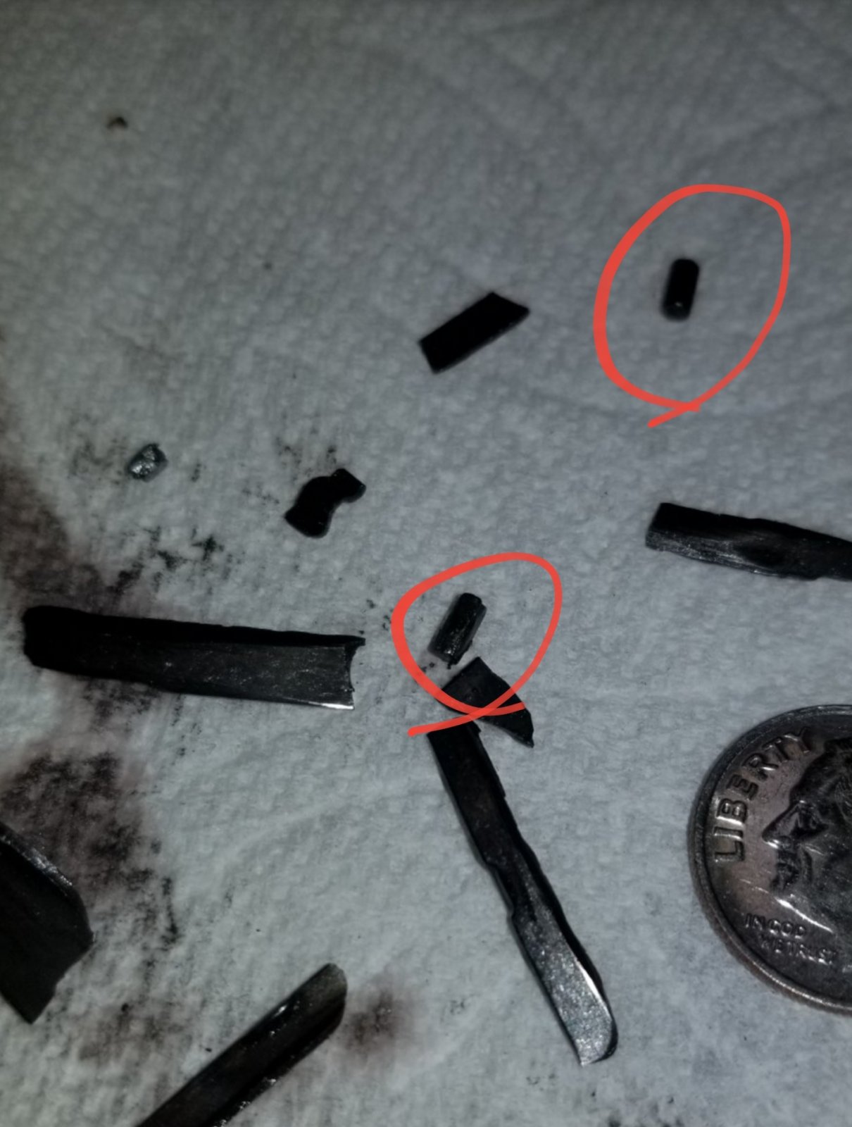

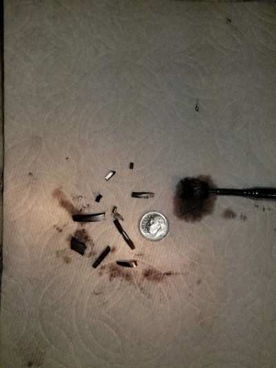

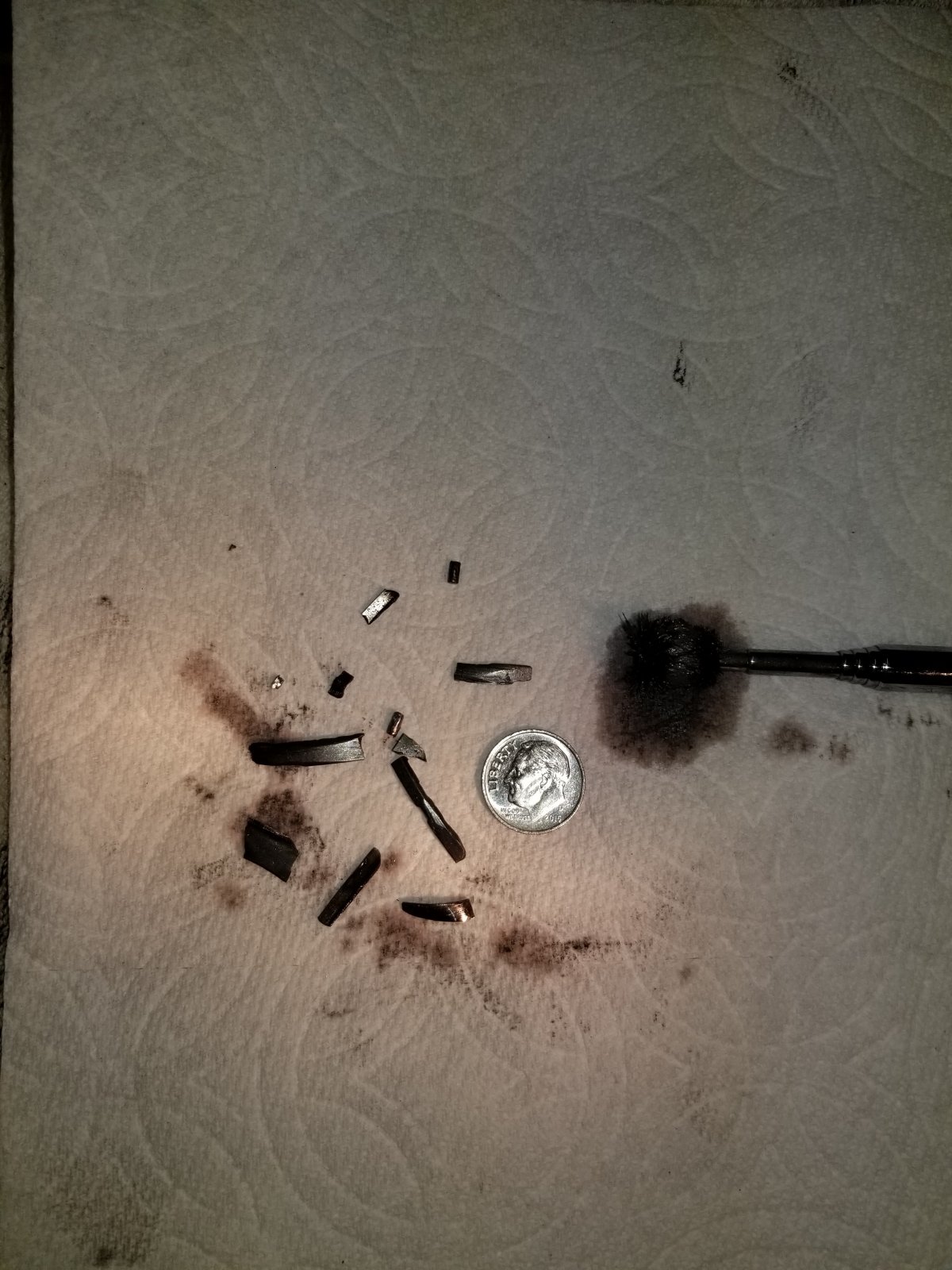

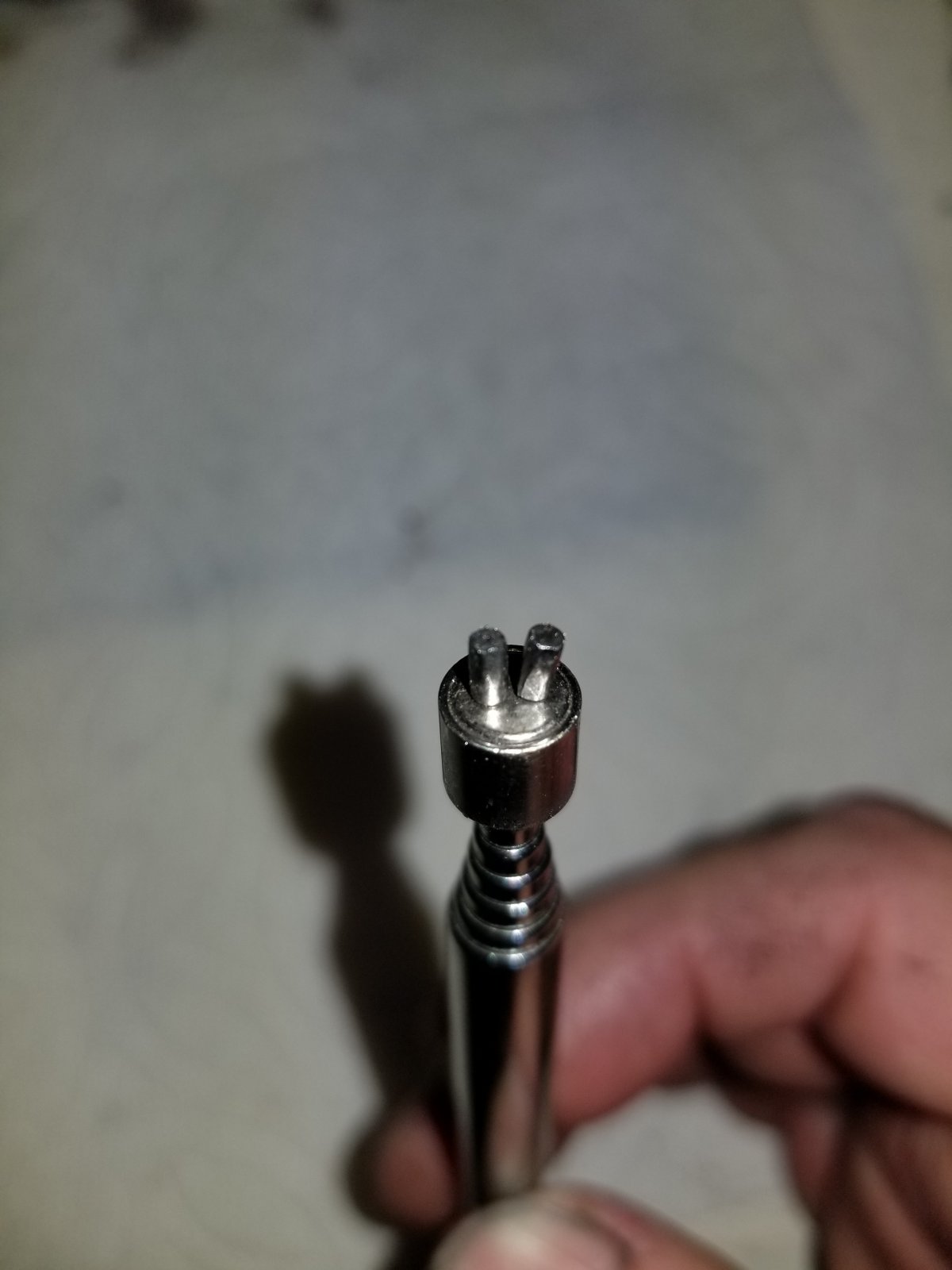

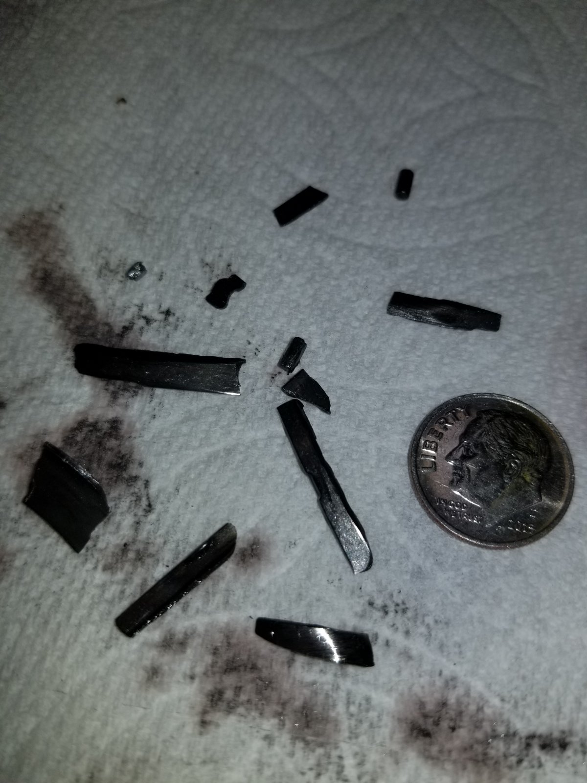

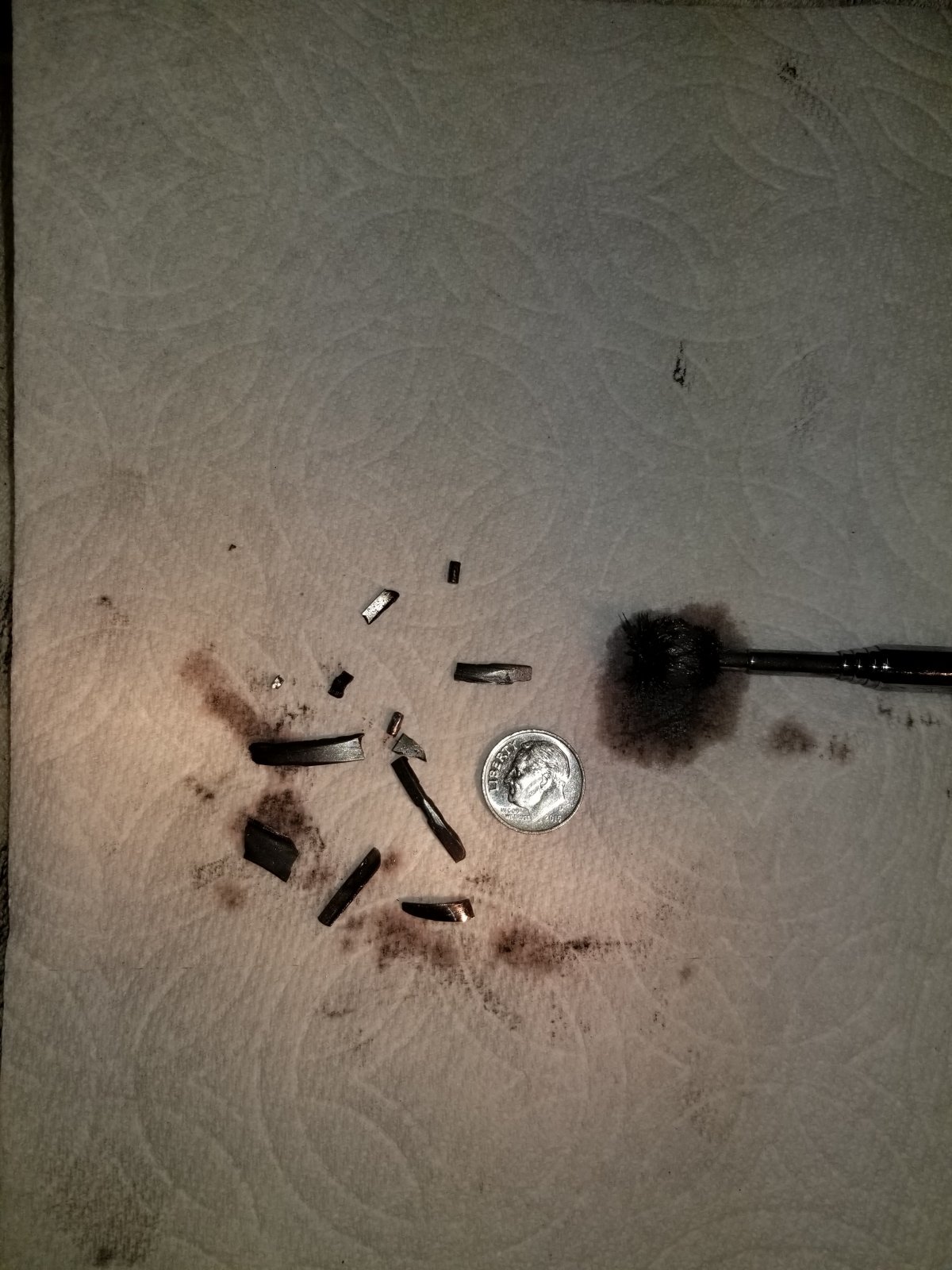

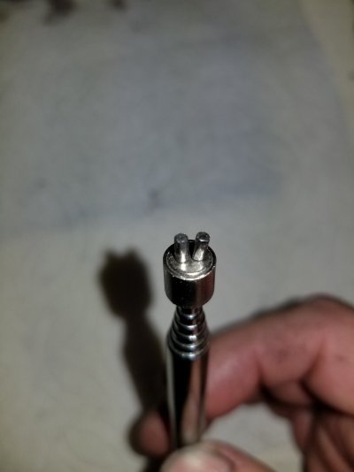

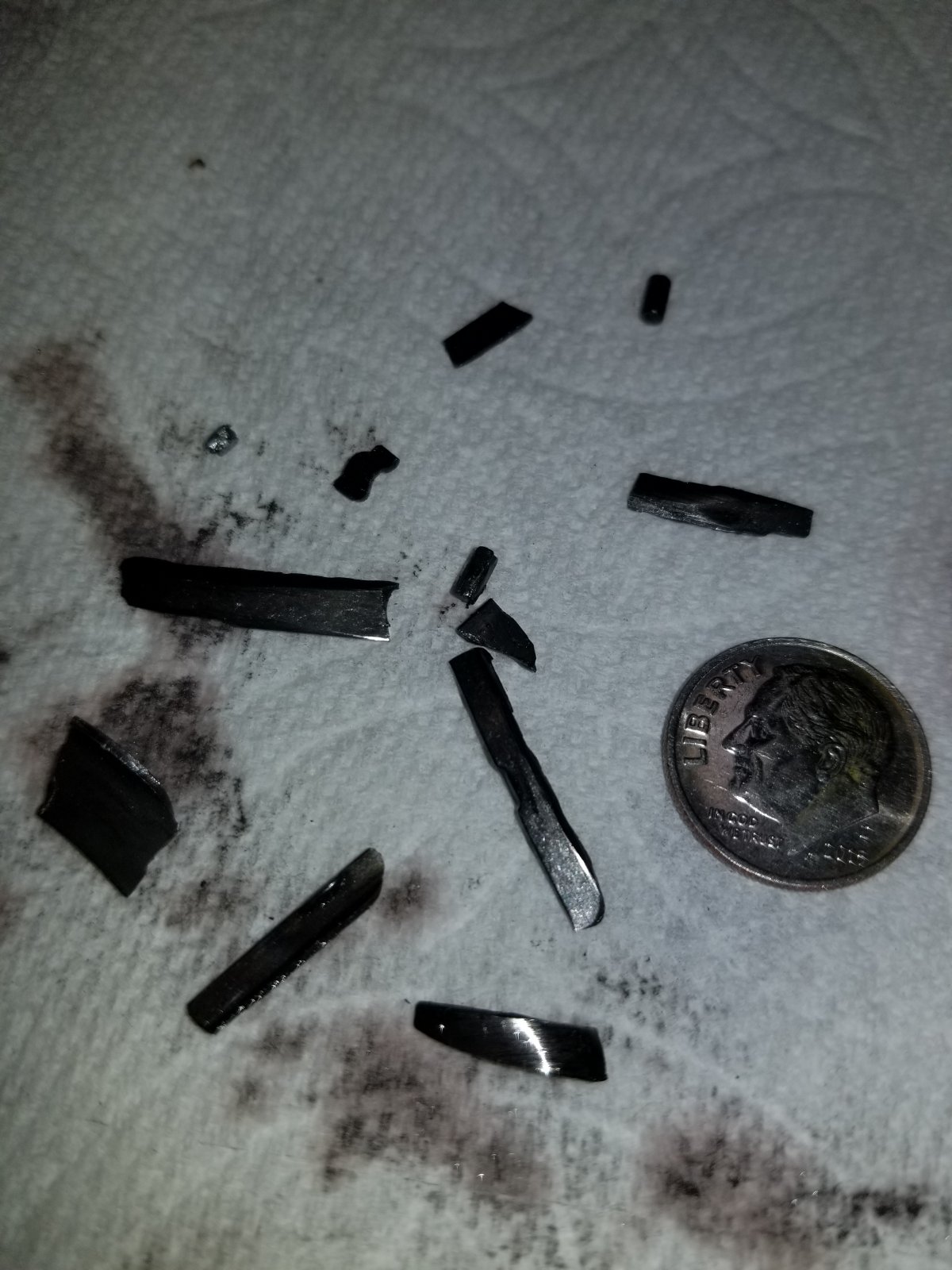

Yeah it ain't pretty. The majority of the oil went into my bulk waste container so anything in there's already contaminated. I did collect some from the pan into a catch pan. These are the biggest chunks. That blob is my magnetic pocket pencil. 20210911_130749.jpg20210911_130352.jpg20210911_130719.jpg

Yeah it ain't pretty. The majority of the oil went into my bulk waste container so anything in there's already contaminated. I did collect some from the pan into a catch pan. These are the biggest chunks. That blob is my magnetic pocket pencil.View attachment 350079View attachment 350080View attachment 350078
Yeah, there's a few guys on here intimately familiar with the internals, I'm not one of them. I'm finding it hard to speculate on where those slivers even came from.

Yea, those roller bearings came out of a cage and some of those other pieces are likely from the cage itself. CRAP ON A *******!!!!!!!!!!!!!!!!!!!!!!!!!!!

Well, there are a few possibilities.
1. That is part of the rear planetary torrington bearing.
2. The rebuilder did a shoddy job and those parts are from before the rebuild.
3. Might be pieces of the forward sprag, but i think they are too small.
Man, i should have said drop the pan before you went this far...
