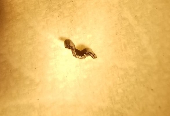

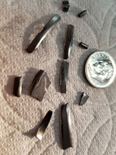

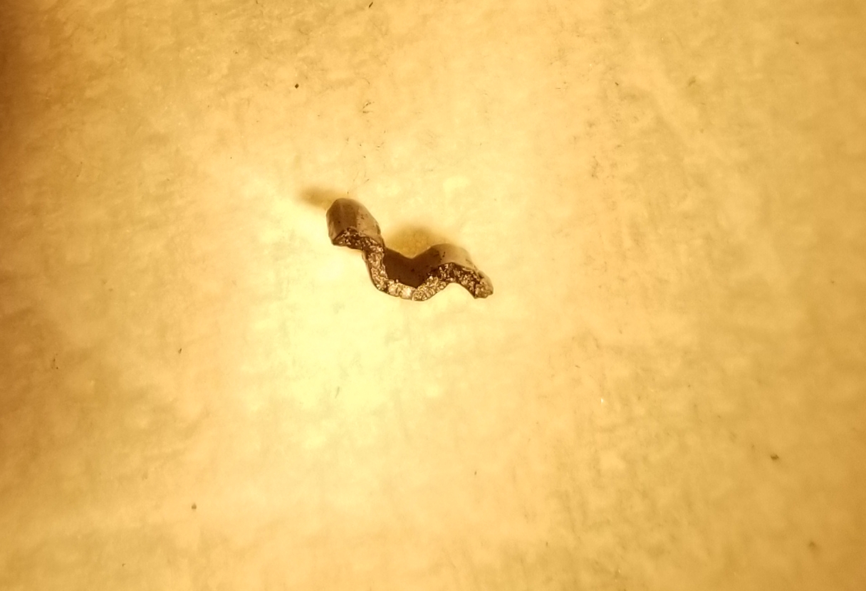

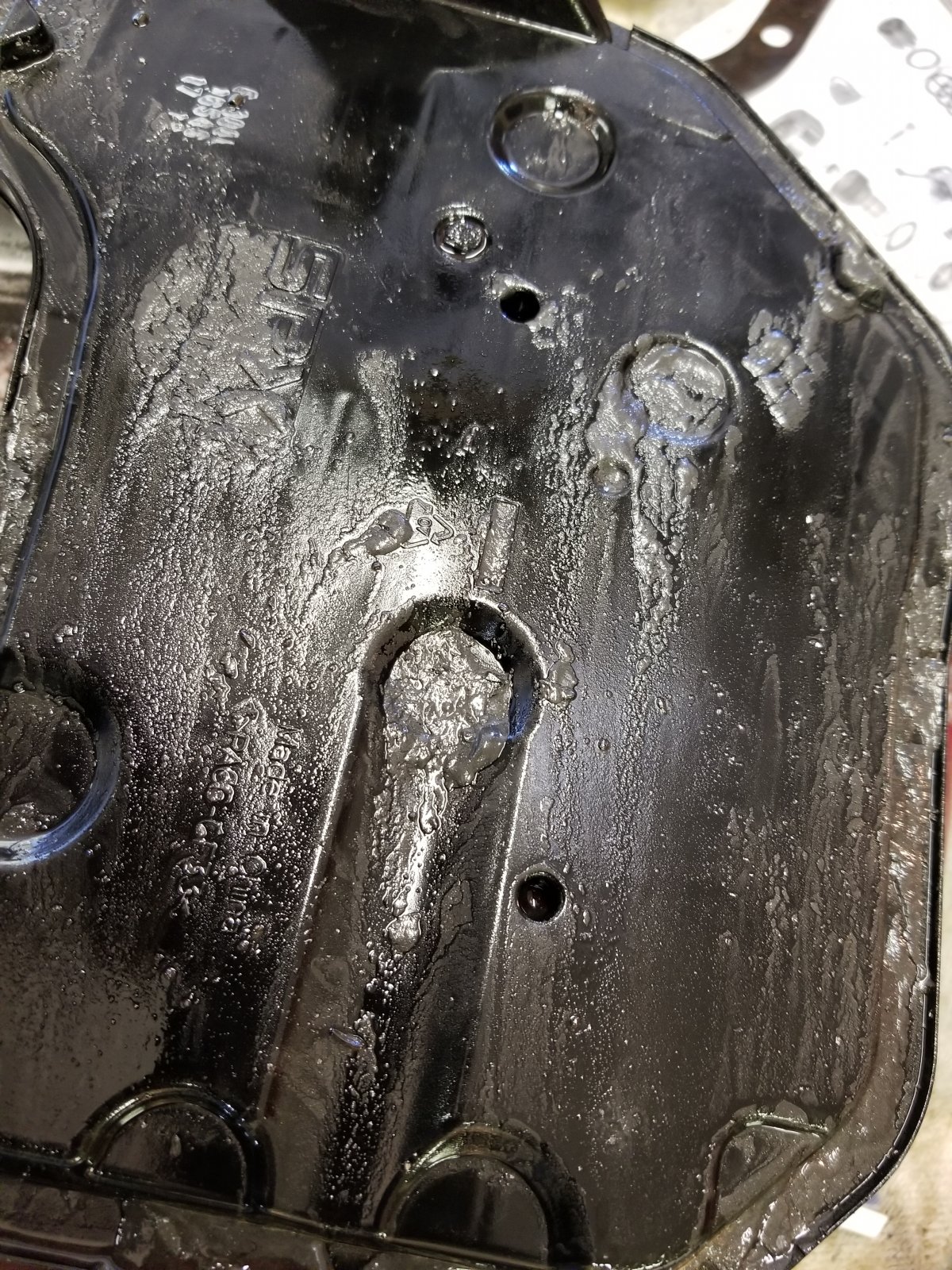

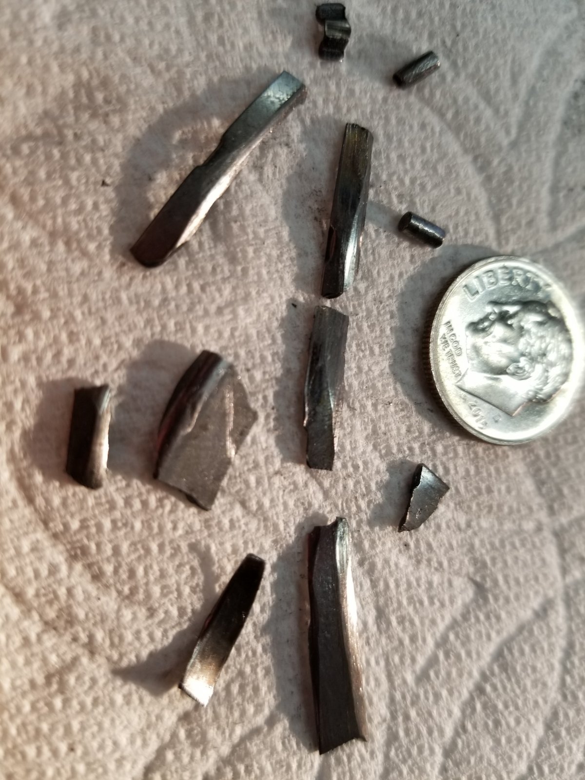

So I calmed down a bit and just accepted it all. Went out and took a few more pics for you guys to guess on. My photo skills aren't that great, but I'm learning what my Samsung can do. Note: I did find another of what appears to be cage pieces. And the small rollers look like they fit. But check out the sludge! And it's all magnetic. If you've been following my posts, remember when I was lying underneath and heard "tink, tink, tink, tink, tink", from the front of the transmission and then silence? That's probably when the pieces fell through as it was running.

Those metal pieces came from either your sprag clutch or planetary assembly. Those pieces that have angles on them are teeth and they appear to be steel. None of this is normal. I suspect a tooth was chipped because the rebuilder did not inspect for cracks or unusual wear and replace planetary/sprag. Its only going to get worse. Eventually the metal traveling through your tranny will cut a seal and then all bets are off and depends on which seal(s) get cut as to what fails next.
This tranny needs to be torn down, inspected for case cracks and replace all hard parts that have been damaged then standard rebuild kit.
