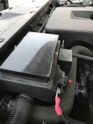

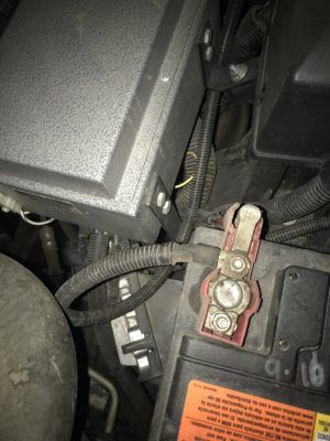

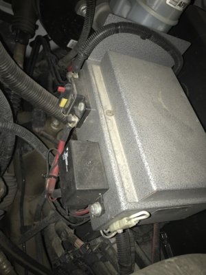

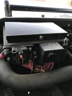

Hey guys just picked up another SSV Tahoe which was an unmarked SWAT Sergeants car. Has all the equipment still installed(lights/directional bar) but when they decommissioned it they just pretty much cut the engine bay fuse panel setup out.
So can you guy post pictures of your under hood fuse box for the auxiliary lighting and systems? The one that would be installed during UPFIT.?
Also if anyone knows the brand they have that would be appreciated as well. Just looking to hook everything back up and have it functional

Most of the wiring is probablu connected to the upfitters harness under the center console/dash.
The red monster
The red monster
May 17, 2017
22
A lot of upgitters add the additional harness under hood similar to this
