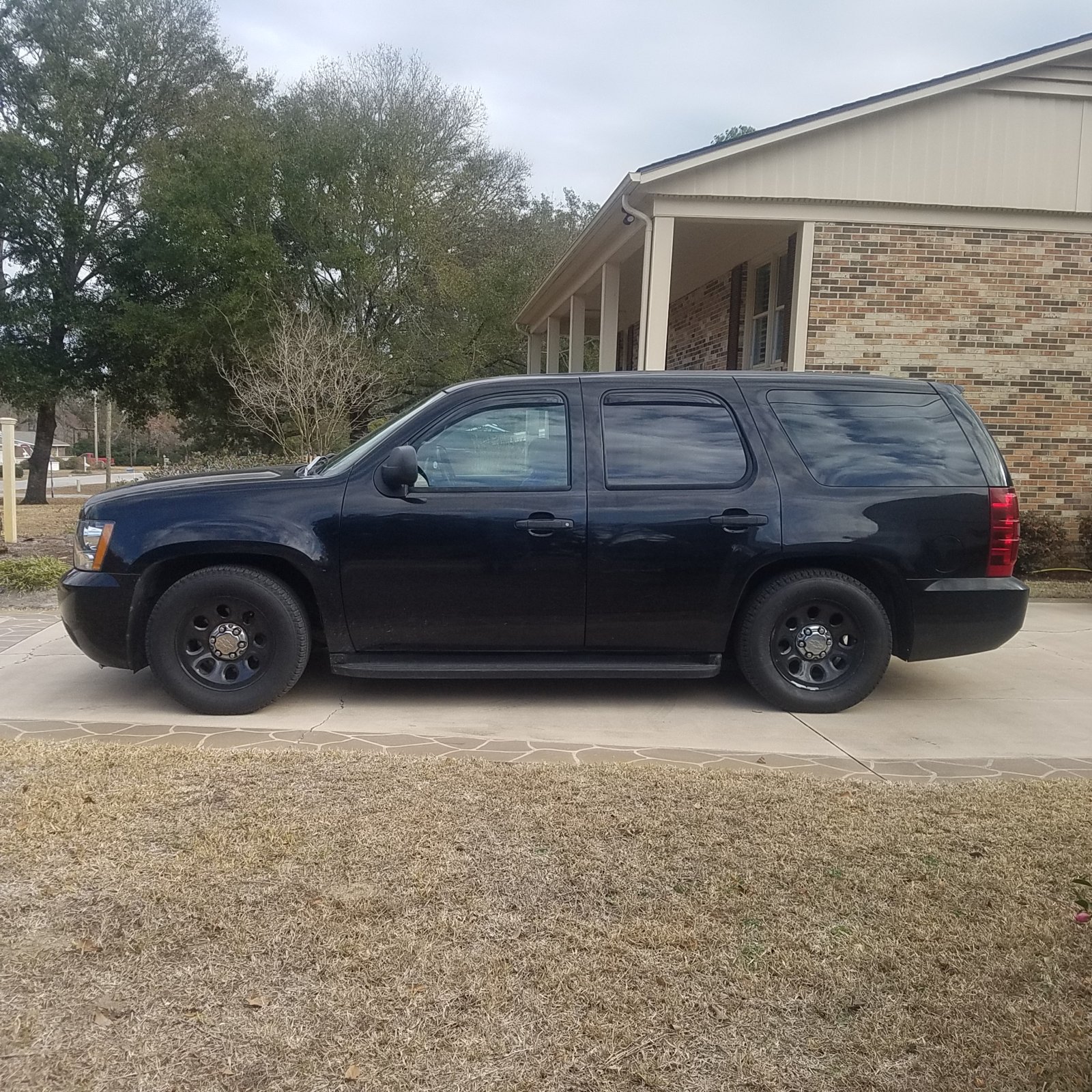

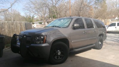

Parts:
Belltech 1-2 Struts (No spacers)
Belltech Shocks
Belltech 2" Springs
Results:
2" drop on all 4 corners
Much tighter ride
Decreased body roll
No change in comfort level with crew and associated payload

If you have 2" drop coils and no spacers on your struts, you have a 4" drop up front.
Lookin good

You should have used the 10mm ring. That will give you a 2'' drop from your struts. If you didn't use any rings,That might be closer to a 2 3/4" drop with the struts.
What is your fender to ground measurements.

Thanks @guy from norcal
@992dr - stock ppv coils, just belltech struts and didn't utilize any spacers. Pre/post measurements = -2". Is this still considered a 4" drop?
Since you had the coils in it previously, you are only measuring the 2" drop from the struts.
Yes, In total between the struts and the PPV coils, your total drop is 4" or there about :)

Stock fender to ground:
Front = 34"
Rear = 35.5"
After mods:
Front = 32"
Rear = 33.5"
Im using the 25003-008 struts, so my kit came with (8) 8mm spacers.
Per Belltech Spacer Table ....
"Lowering Height 2" - Number of Rings To Put On Strut = 0"
(meaning no rings)

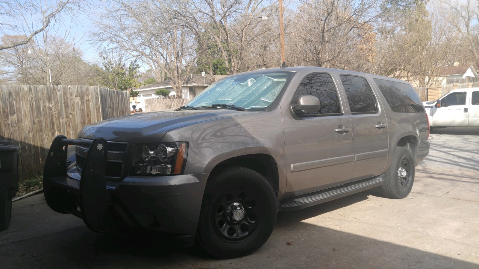

Looks great man. Diggin it. Did you get all the side windows tinted? I need to tint my pretty bad.
SidewaystheSeven
Jan 7, 2016
177
100
I love me some dropped Burb, just looks so clean with the long low lines. Plus, you don't see them very often if ever.
Oooooh, now that you brought it up do you have any pics of the C10? Always been a fan of the C10.
Don't hesitate, I'm usually around and always willing to help out when I can.
Yeah, thanks man, I'm really looking forward to getting it down. I never see dropped Burbs and I really love the look of the PPVs so I figured I'd copy it. Yessir, 5% tint on the sides and rear.
Front = 34"
Rear = 35.5"
After mods:
Front = 32"
Rear = 33.5"
(meaning no rings)
Very nice. Mine is at 33 3/4 front. But is also a 4wd, With Mcgaughys 2" spindles. I didn't have auto ride so i used the 10mm spacer. Auto ride is no spacers.
