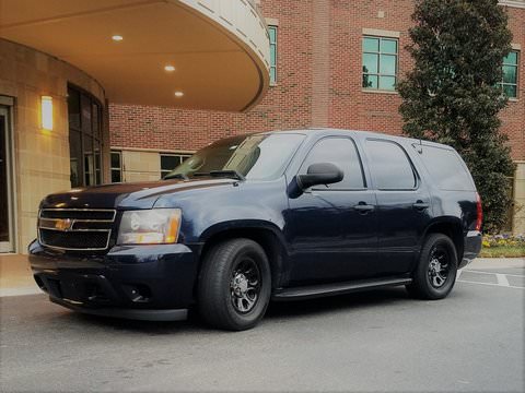

Did you by chance buy all this in a kit, or did you have to order it all separately. I like that stance and how would you say the ride quality is in comparison to factory.
Parts:
Belltech 1-2 Struts (No spacers)
Belltech Shocks
Belltech 2" Springs
Results:
2" drop on all 4 corners
Much tighter ride
Decreased body roll
No change in comfort level with crew and associated payload
NORCAL SS
SUV SUSPENSION GURU
Jun 9, 2009
8,744
610
I set it all up for him and i put all parts together. Im a dealer for it all
