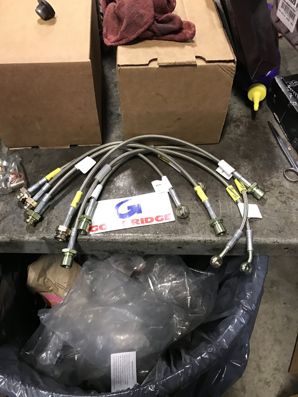

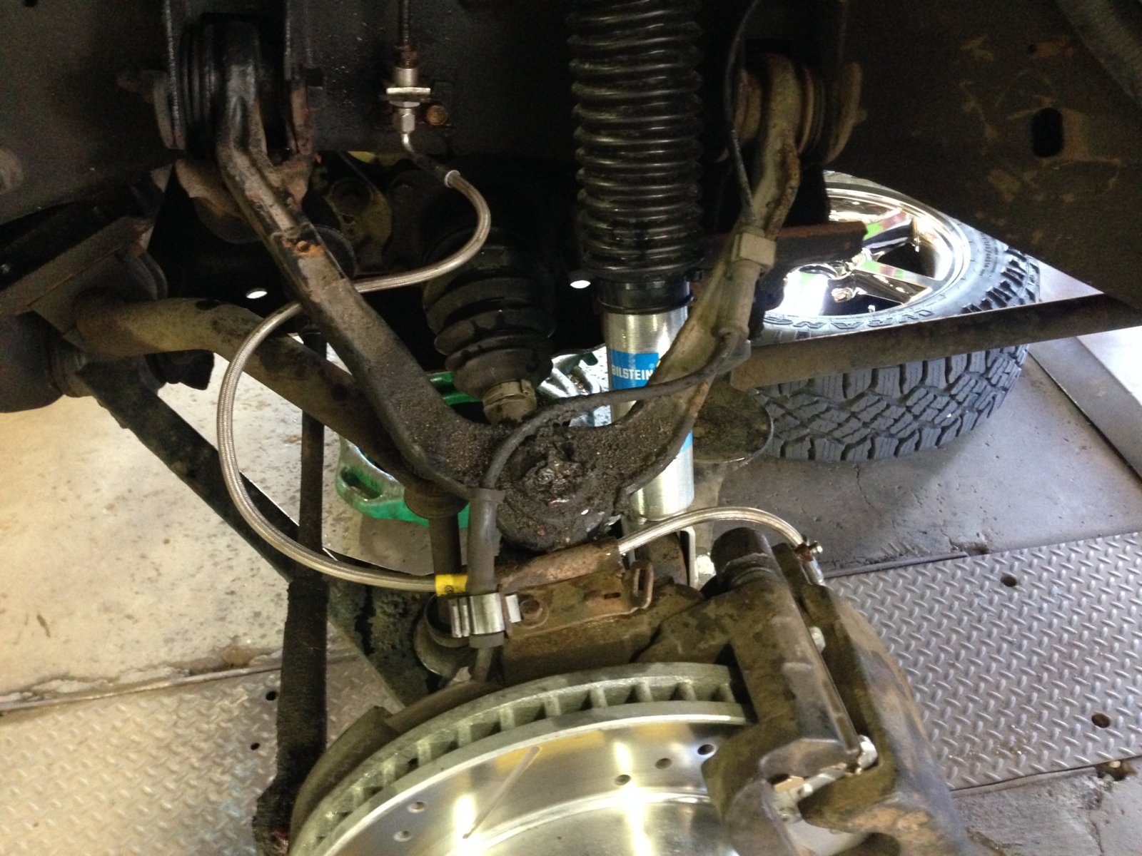

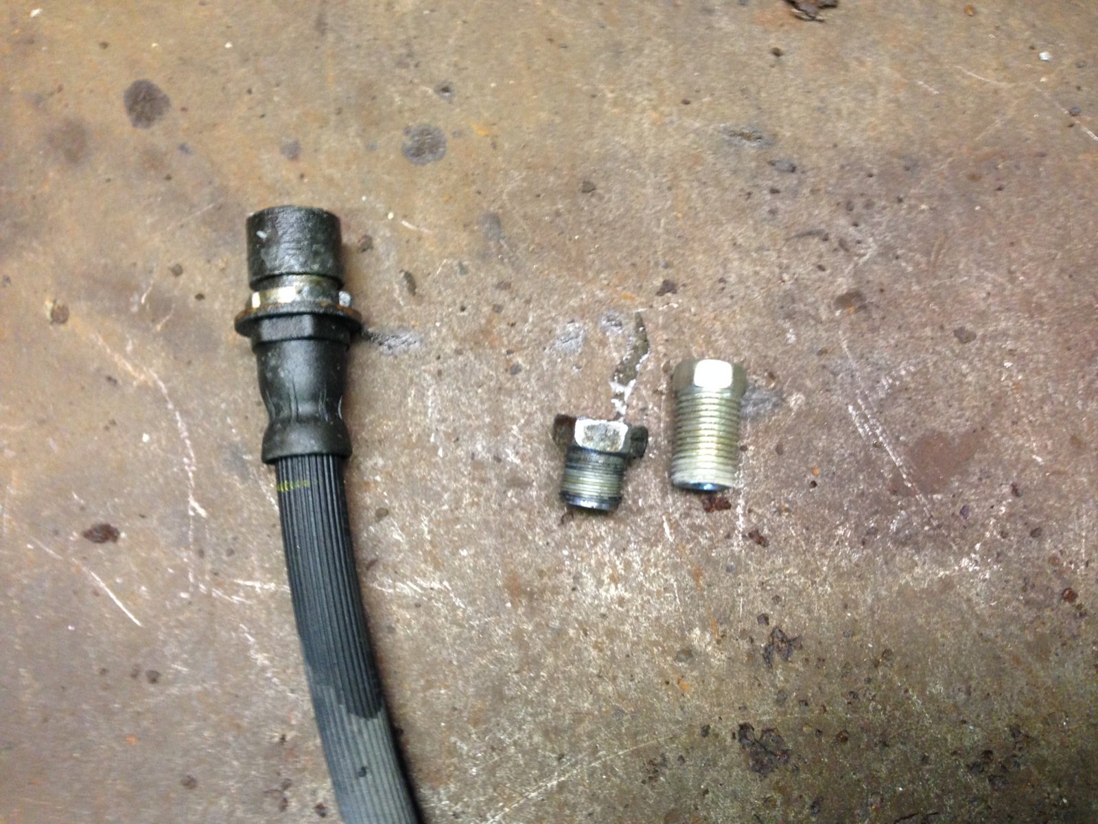

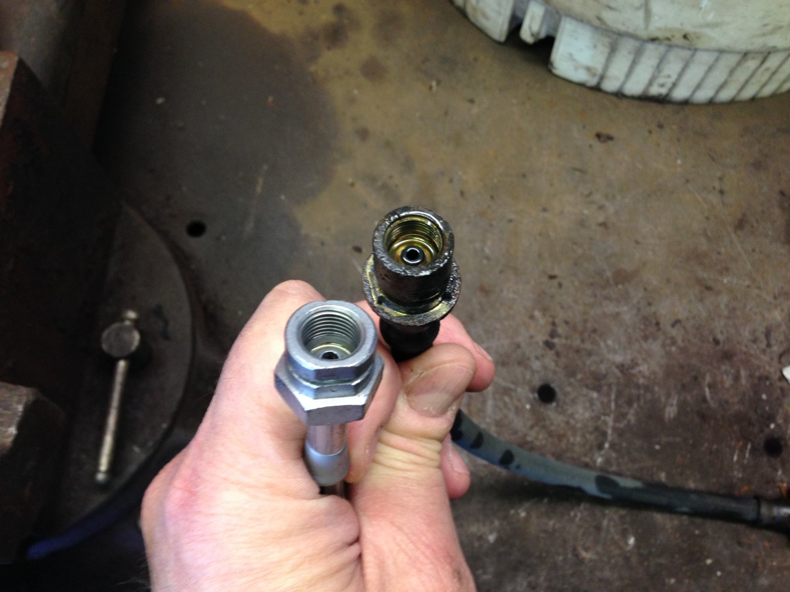

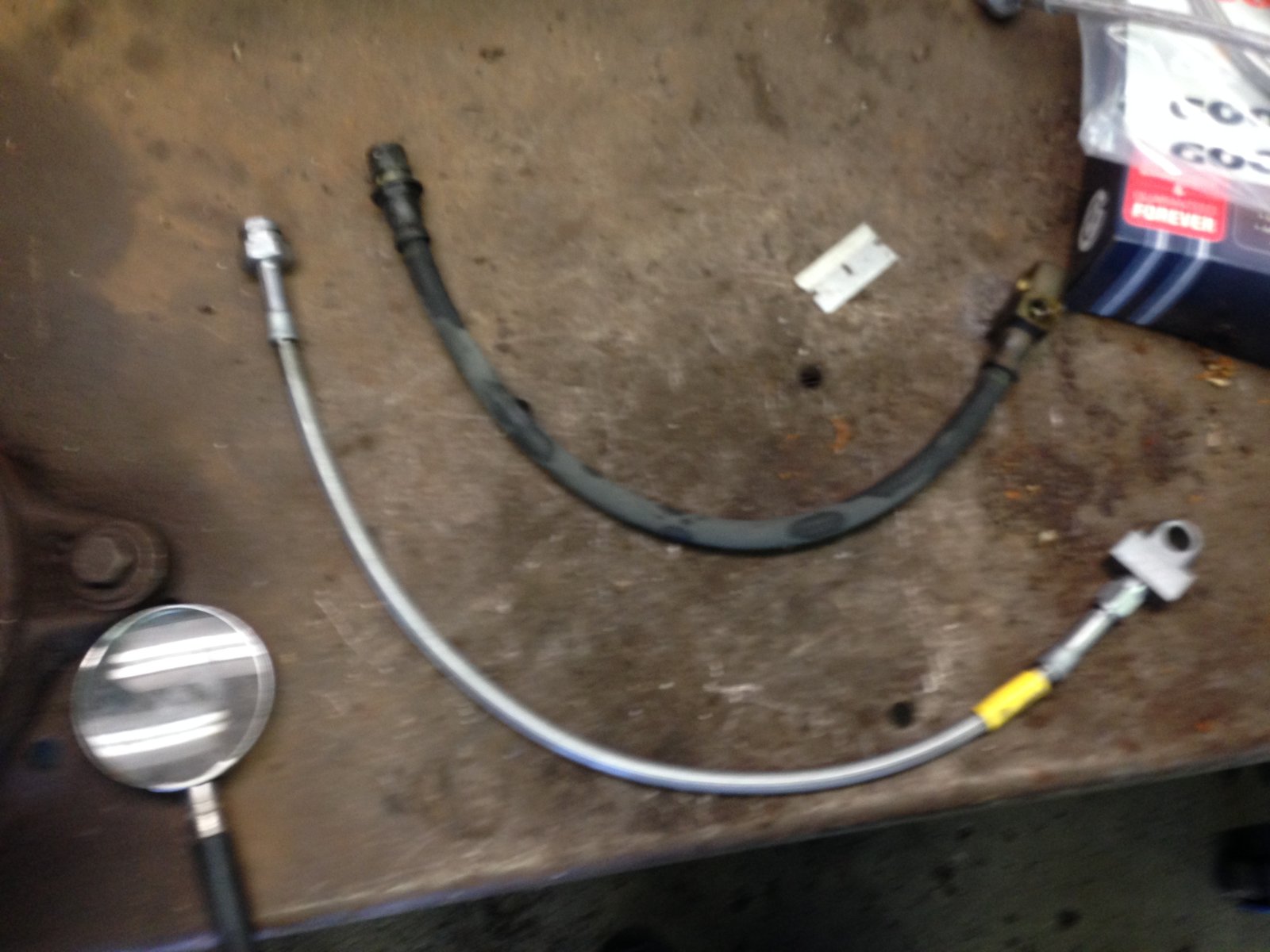

Ok so here goes with the new goodridge stainless lines installed today.We started at the back center line,came off easy and installing easy.When went to tighten down steel line to the new stainless the threads were not long enough to tighten the flare on the fitting.We imediatley stop and call goodridge they give me a number of a guy to call.He tells me possible fitting is different on some models-what it doesn't say that anywhere-this kit is for any 00-06 tahoe without stabilitrack.He recomends he sends me a few copper washers to put on the fitting.WHAT THE HELL ARE YOU TALKING ABOUT-i hung up instantly.So we cut the steel line and install a longer fitting-flare the end and were all good.The other lines went on no problem.Fit and finish seems good on the lines , routing the fronts was a tad different.So after bleeding and test drive i can say yes on the pedal feel.Alot firmer stops and barely touching the pedal now the tahoe starts to stop no mushy ********.SO my suggestion if you want a sold firm pedal do the stainless lines before trying to upgrade everything.Oh and make sure if your doing it your self on your back you have a flare tool and longer fitting for the center rear line unreal P.S make sure you can lower your spare tire,it will have to be lowered to get to the rear line to cut and flare. B.S
