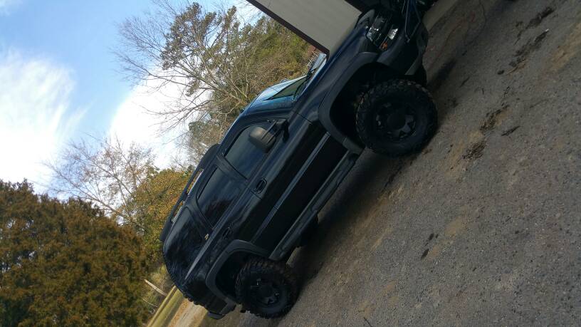

Your just wanting the front lifted? Nothing done to the rear?
Sent from my SAMSUNG-SM-N910A using Tapatalk
massivespl
I'm not mean, I'm honest.
Nov 25, 2013
2,197
1,876
Michigan
Yea the rear looks lower then the front already. Get a 6" lift all the way around not just the front. That would looks silly
liftedtahoe
Jan 28, 2014
277
88
arkansas
I want 6 inches up front i don't mind it normal in the back because i want it to squat maybe 3in in the back at most

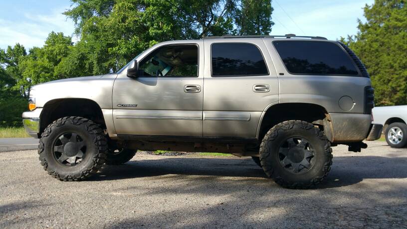

3in spindles 3in keys ? Will give total of 6 up front and if i switch my air ride system to shocks n bigger springs ill be able to get 3 or 4 in the rear?
liftedtahoe
Jan 28, 2014
277
88
arkansas
Most the lift knuckles I have seen need diff drop brackets too because you upper control arm stays in its factory location, an just drops the lower control arm/ diff, if you got lift knuckles you front end would be in a bind, an you would go through bearings balljoints and axles
Antonio Estrada
Dec 1, 2015
23
Fort Worth Tx
So its better just to get my lift all around and use my keys on top to get it higher in the front it be the safest thing and reasonable thing to do?
