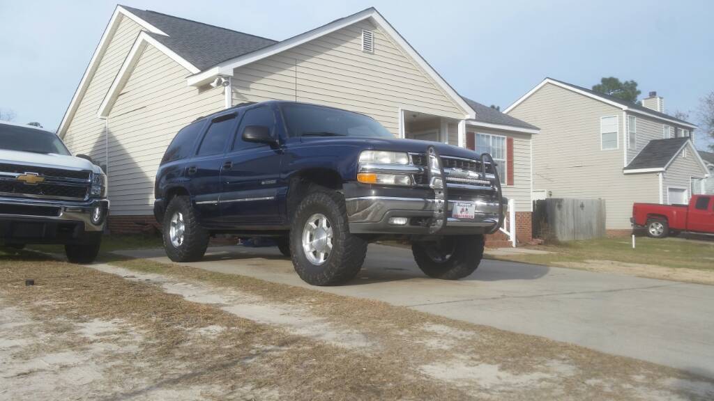

Supreme suspensions lift keys. Passenger side 04 torsion bar on my drivers side. Cranked a good bit on Yukon 17s and low tread Toyo 35s
Does not rub on fender or bumper/valance. Rubs on little metal bracket at full lock. Also rubs on rear shock bolt when rear cycles completely.

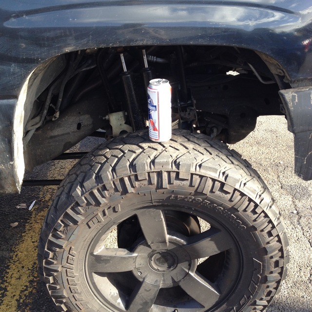

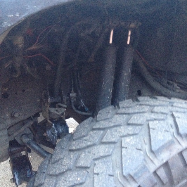

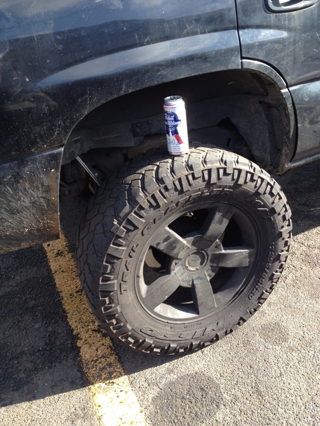

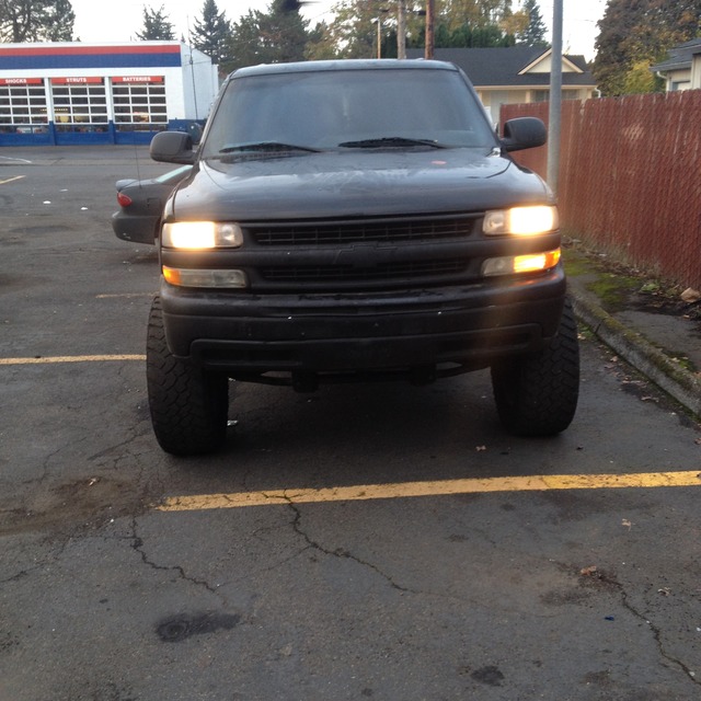

Need to get new pics but here is the gist
Here is the rear
That's clearance you want to fit 35s!
These are all old pics. Will get some new pics tmrw as the stance was adjusted and changed as well as track width in front.
I have 9" of lift with stock keys. 6" lift with 3" spindles up front. In pics it's way de crunk! To be more like 6".
Currently they are cranked like stock for ride quality. So the front is higher. Going to replace my 1.5 in spacer in the rear with either 2.5 or 3 and crank the keys or put in my lift keys. Riding decrunk is just too soft a ride. Lol

6" super lift up front with 3" lift spindles. Pretty much decrunk stock keys all the way out till I lift the rear. Pro comp 4" kit with 1.5" rear spacer. Going to go with a 3" Spacer and level the front to match. So overall it should be set at 7-8" lift when done!

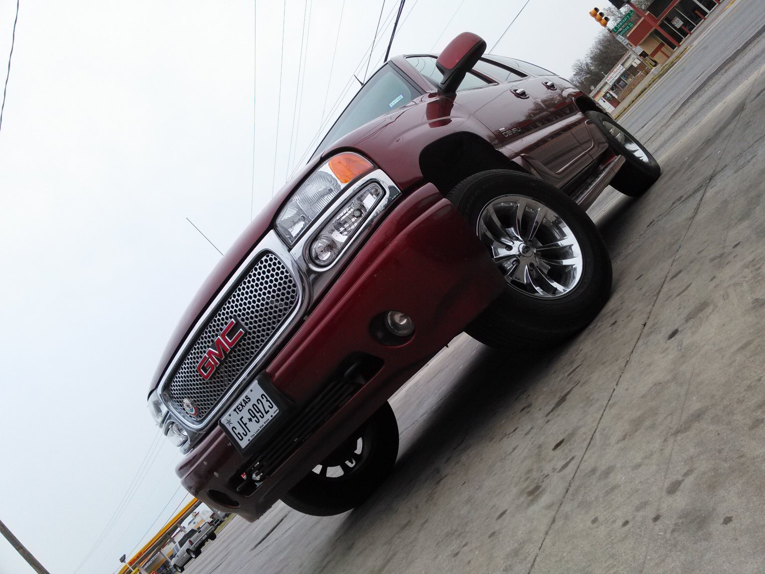

Hey im looking to lift my denali in the front more i have ready lift 3in torsion keys cranked all the way my front shocks are worn out and since they are finally out i wanna go to 6in lift just up front an thoughts on what i can do or buy to get those 6inches up front ? Id appreciate the response thanks in advance.

Awd?
