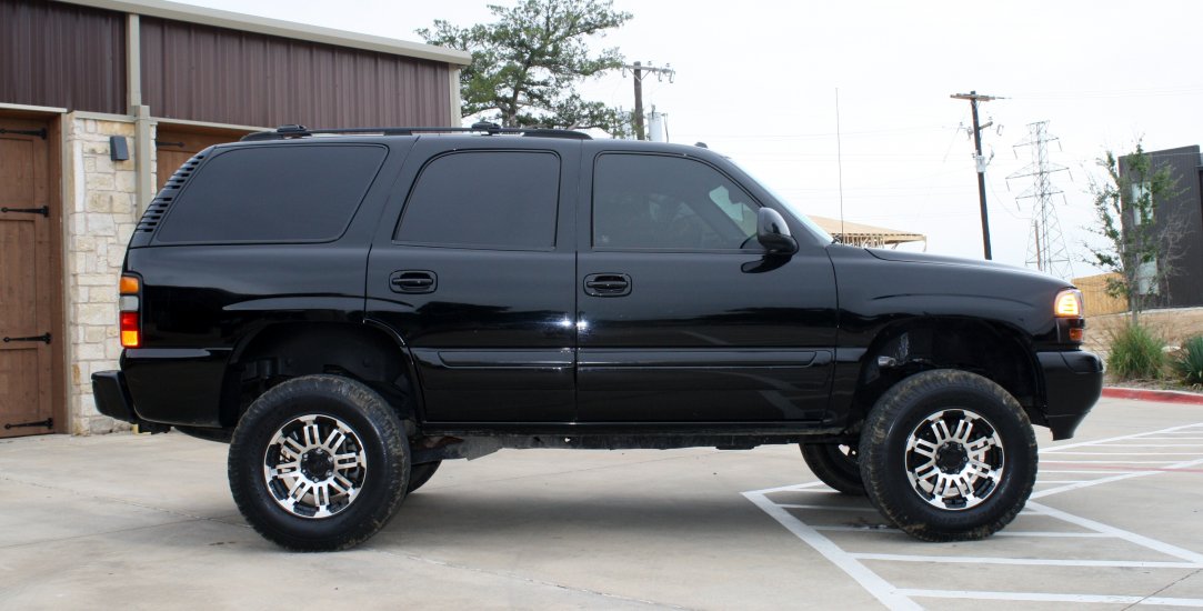

where can i order those spindles?
He's two wheel drive... You can't run lift spindles on a 4x4 without a diff. drop to correct the angles. If try to run just spindles, it will put your whole front suspension in a bind as well as your axles.

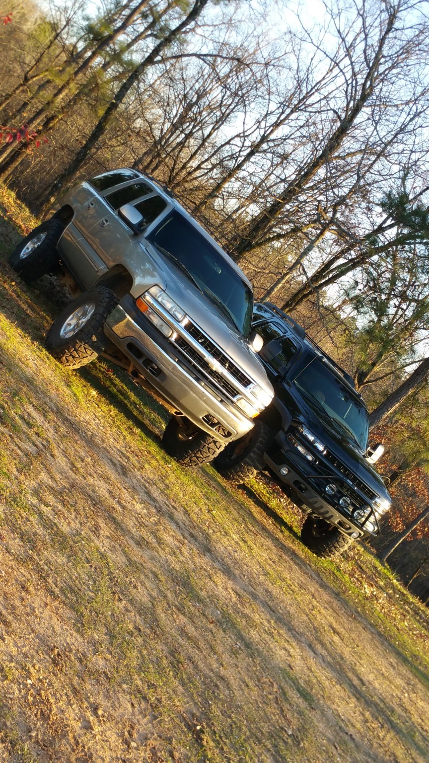

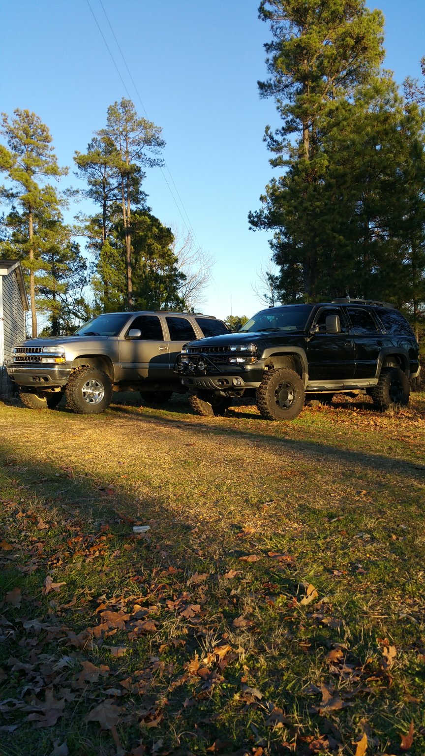

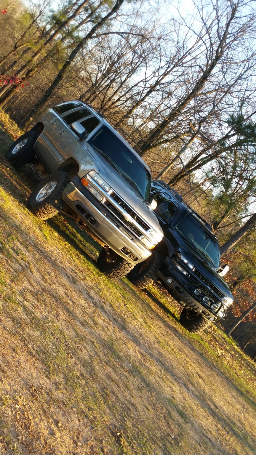

I wanna do pretty much the same to mine as you did to your black z71 how hard is the body lift ? And do you have you get a longer steering shaft?
The kit I ordered came with a steering shaft extender! It is not bad at all to install, but I also have a 2 post lift in my shop also which made it a lot easier!
Sent from my SAMSUNG-SM-N910A using Tapatalk

Yeah a lift would make it a lot easier !
Was there anything you ran into that you needed to modify or extend ?
Nothing that the kit didn't come with!
Are you talking about building your own?

Oh god no !! . Just wondering if i needed some kind of wire harness extender
Lol no sir you order the zone 3" body lift with bumper relocation brackets, it'll come with everything you need!
