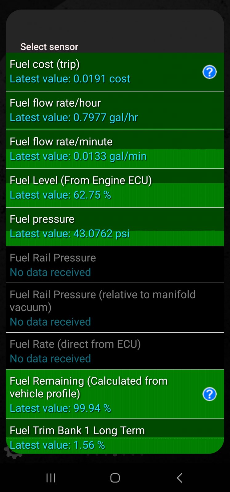

Not that it means anything but I ran Torque Pro and here are the results. Everything was ok except all the EVAP stuff. I also ran the data on the Fuel Pressure/Trim Sensors. When it was idling while the test was running, it seems to sputter a bit. 2011 Denali XL with Flex Fuel
