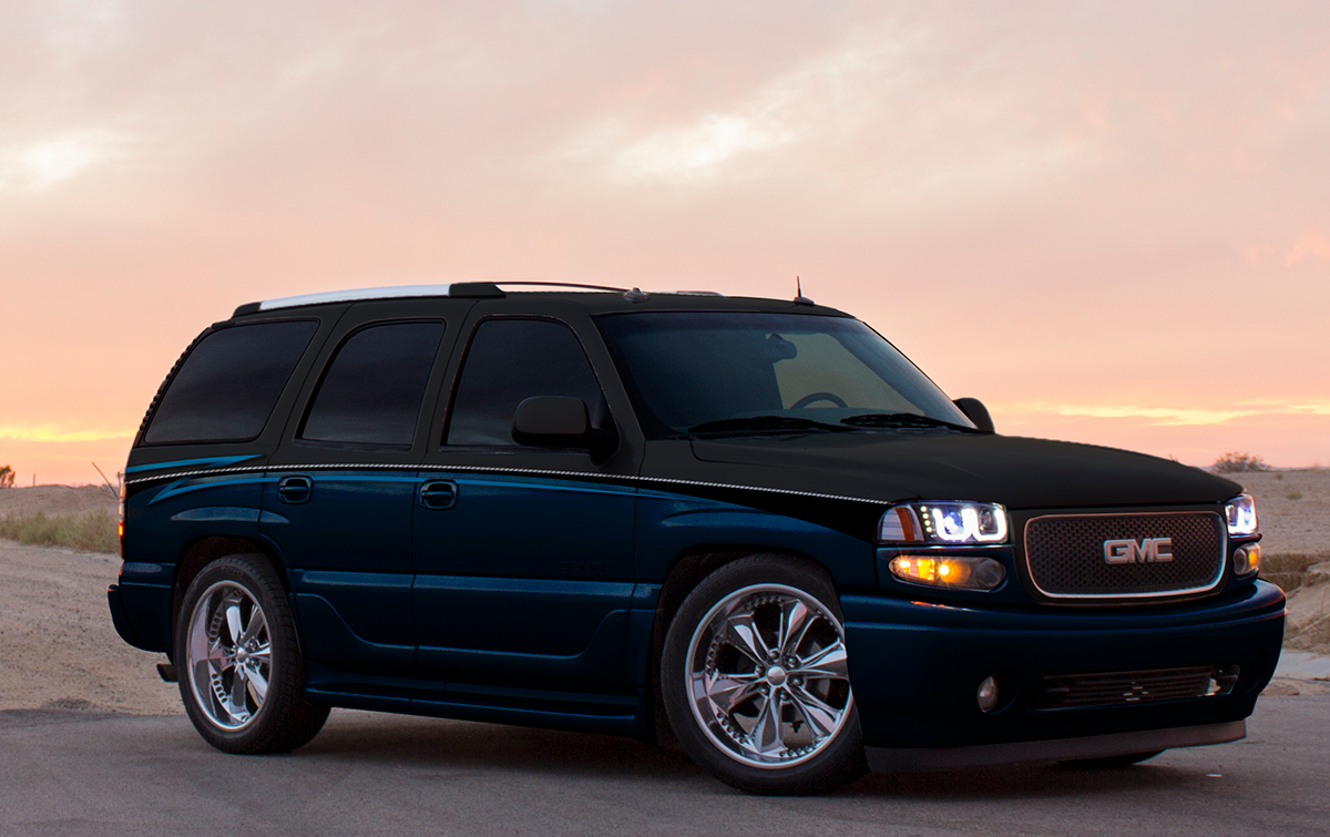

Moarlow... makes getting to the roof easier.
And I like numero 1. Simple design is simple.
Makes me want to remove the roof rack again.
haha, maaaan you aint lyin.. i wish i was about 6 inches lower to spray the roof! thanks, i like 1 too

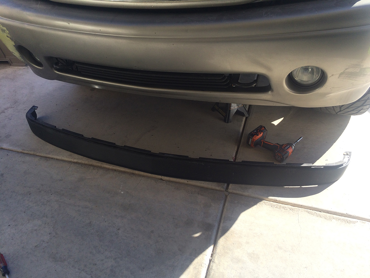

removed the front lip

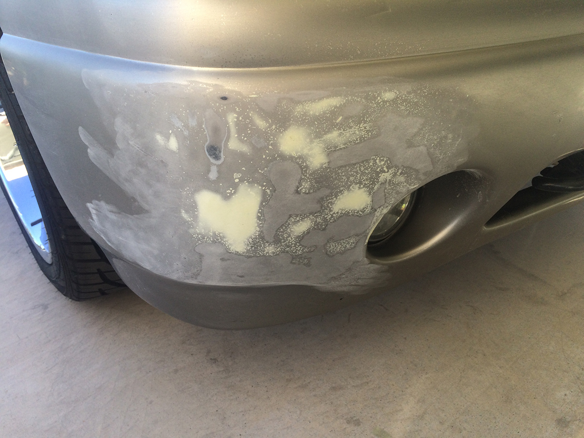

time for body filler/bondo!
as you can see all this acne on the paint on both sides of the front bumper cover.

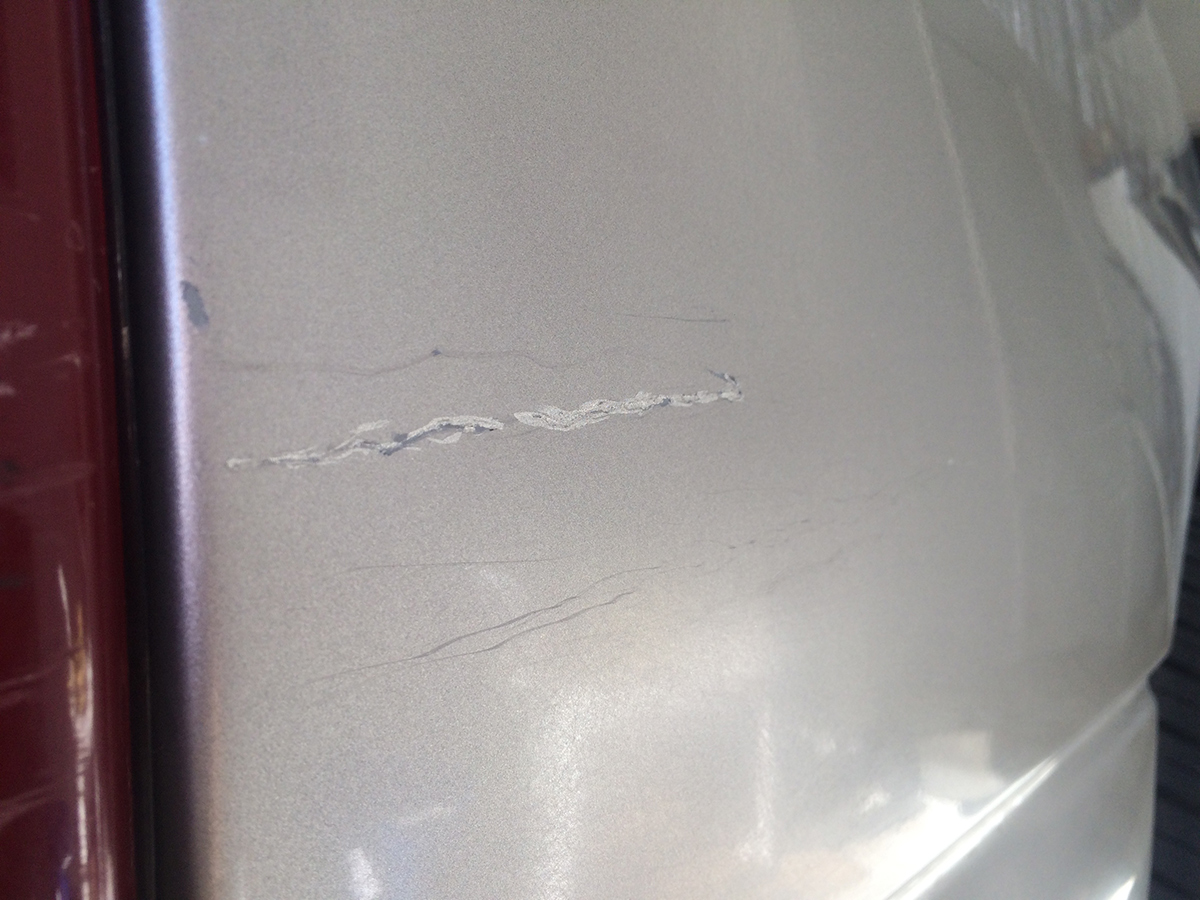

and this pretty nasty scratch/groove on the right rear
quick skim coat of body filler (actually i think i did 2 coats on the front)
after about an hour and a half of sanding with various different grits. primed
waited about an hour and then sanded all the primer until it felt seamless and smooth as new. hard to tell by looking, but it came out great.

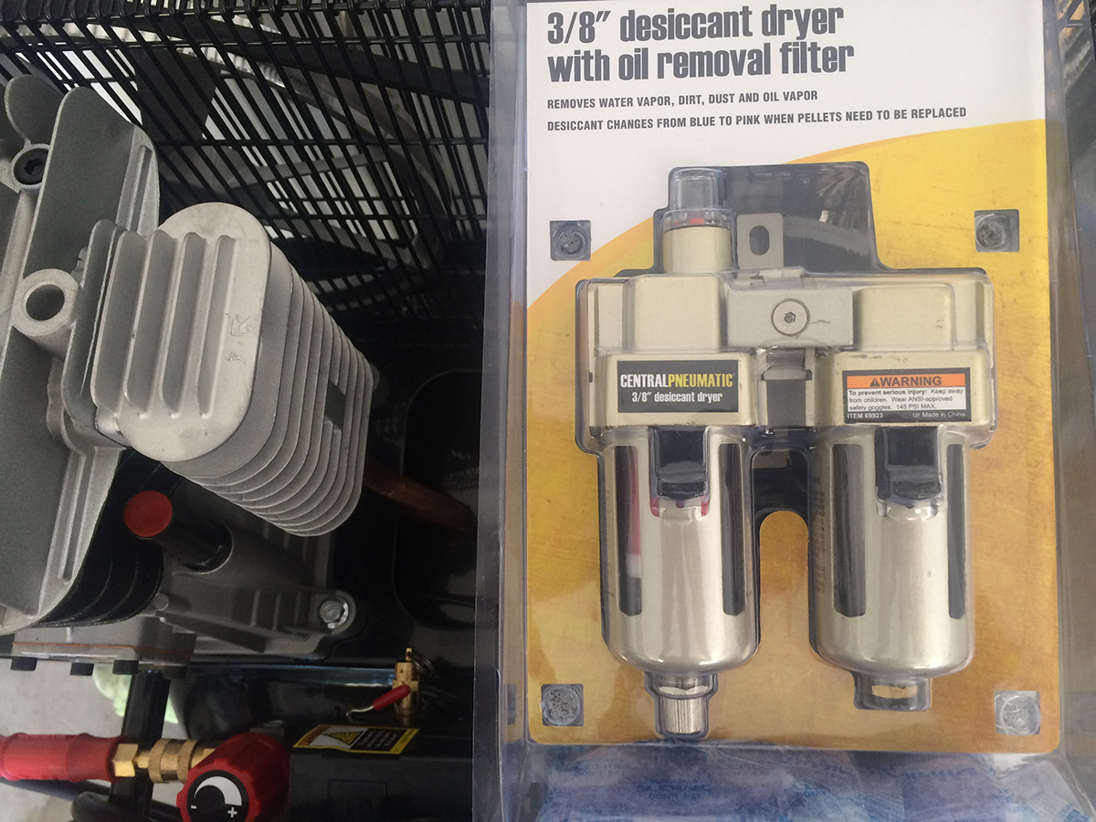

so what do i left to do? actually, the pain in the as$ stuff is pretty much complete. I need to install this dessicant filter somehow to my compressor so i am spraying clean air

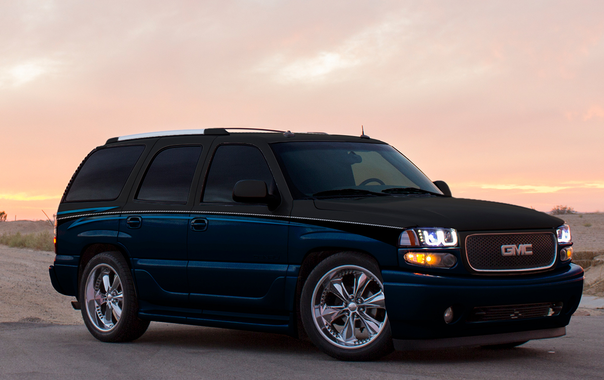

I keep circling back to this one. Something about the thin line paralleling the hood/fender line and coming right out of the headlight and rolling along with the sexy NBS curved lines to almost/at the top of the tail light if we are talking balance.
Any of them will pop, but this one keeps grabbing my eye. That dark color will sizzle the AZ summers. Man that is going to be one sweet looking ride rolling down the desert roads. Whoa!! I am looking forward to seeing this paint job. And nice work on the shifter.
thanks, Foss. I like all 4 of them in different ways. i like this one too, mainly because its darker and a little more subtle. Wanna come over and help me? haha, i have beer
