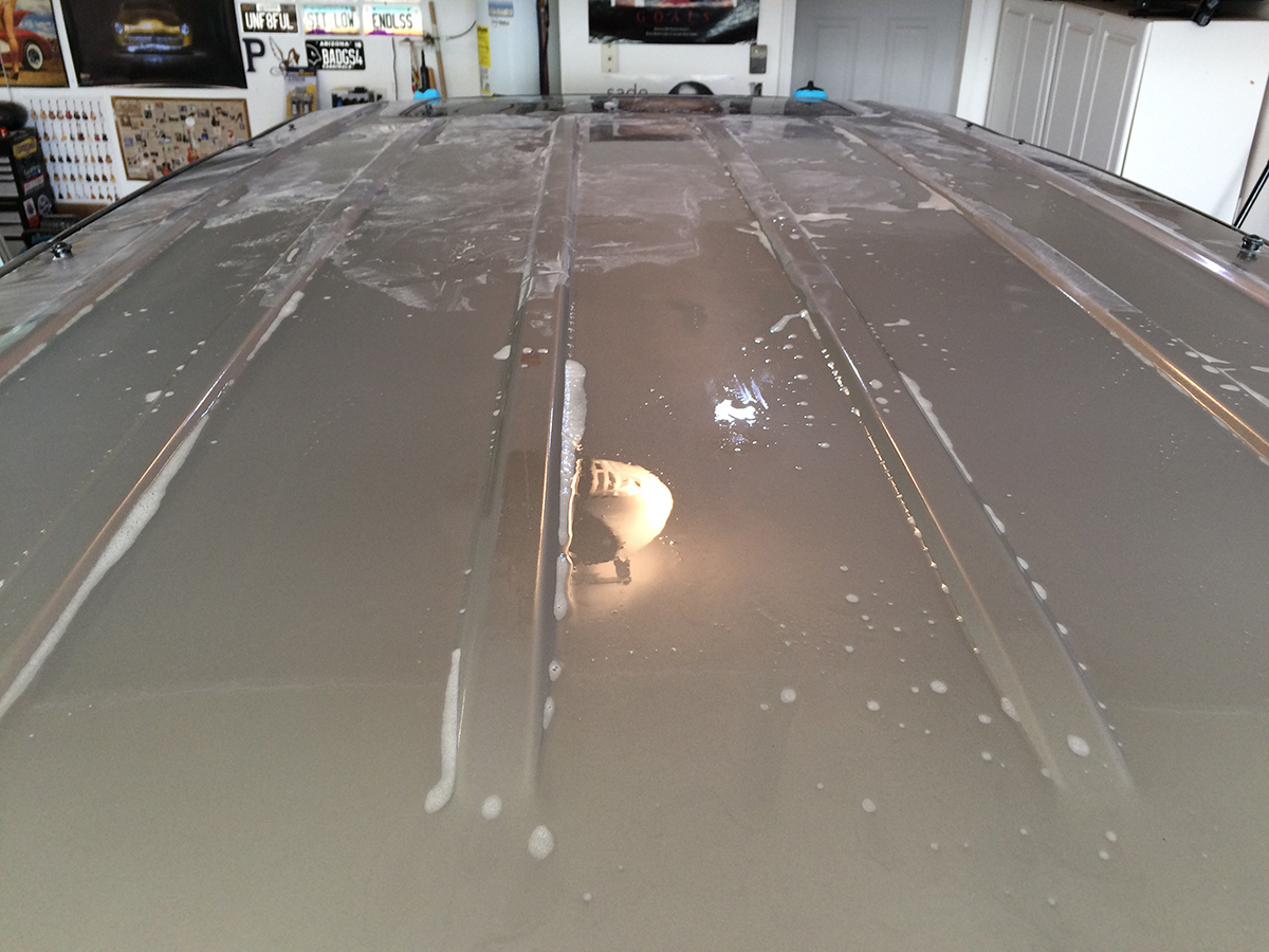

i just laid on the roof and took my time laying in the water as i sanded away

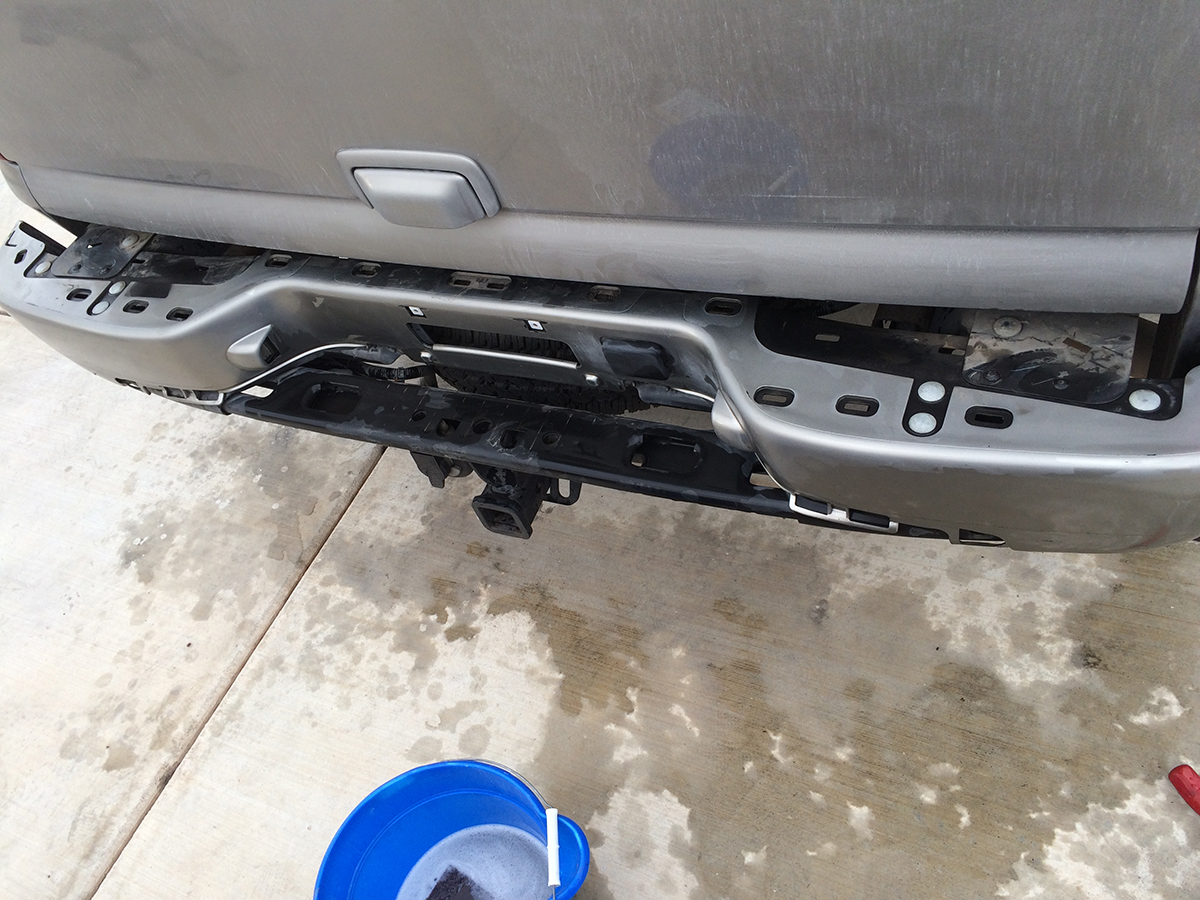

took off all the black plastics on the bumper.
just in case anyone is wondering how to remove these...
don't just try and yank them off. lay on the ground and look up, you will see they are held in by these thick squeeze notches. i just squeezed them with a pliers and pushed them through until the two left and right top bumper plastics released.
the lower bumper plastics are the same but they have the basic circle clip on the lowest bottom edge as well

and finally.. the whole drivers side has been wet-sanded

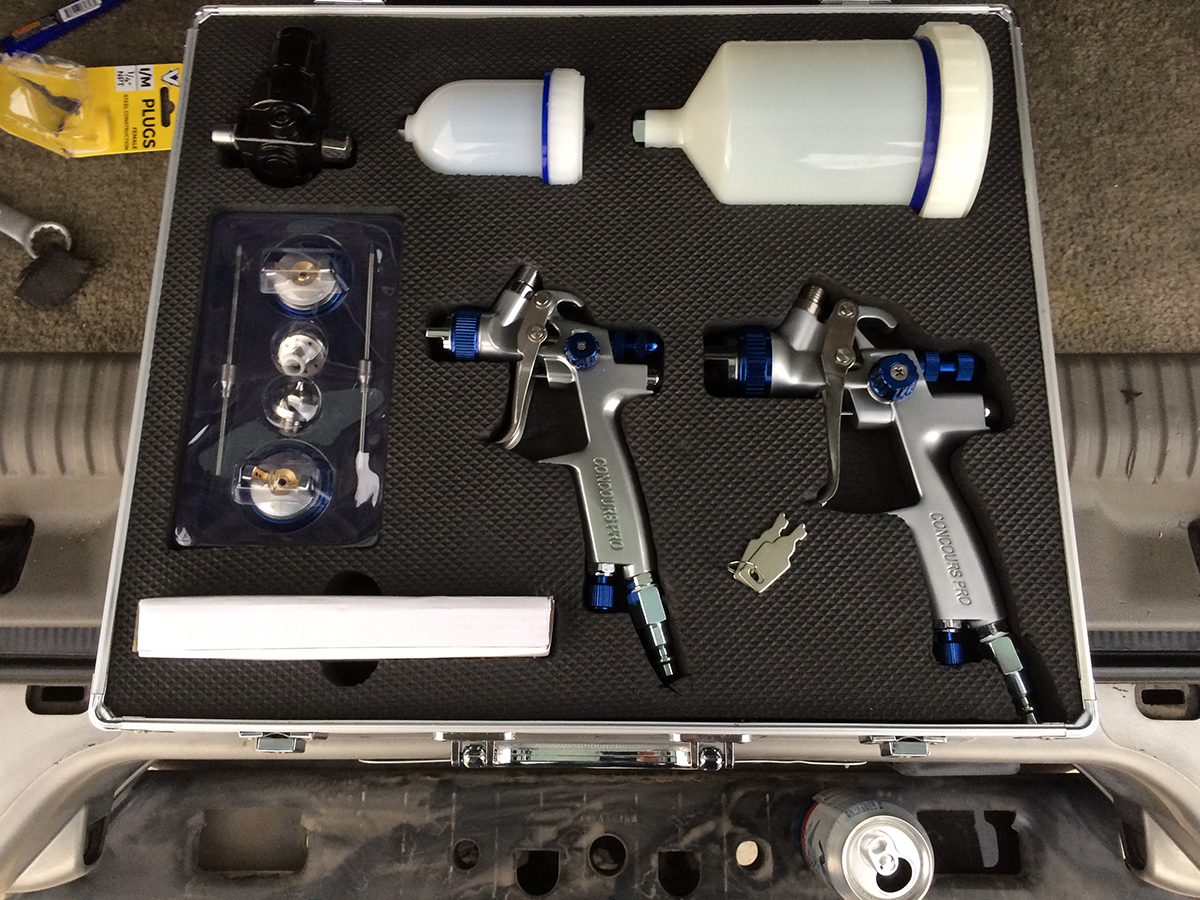

threw a couple plugs/attachments on my Gun so i could test the CFM,, and these puppies throw out a mass amount of air and the compressor seems like she will keep up with me... So that was relieving. Yes, thats a beer. I think i drank 12 for everyone
