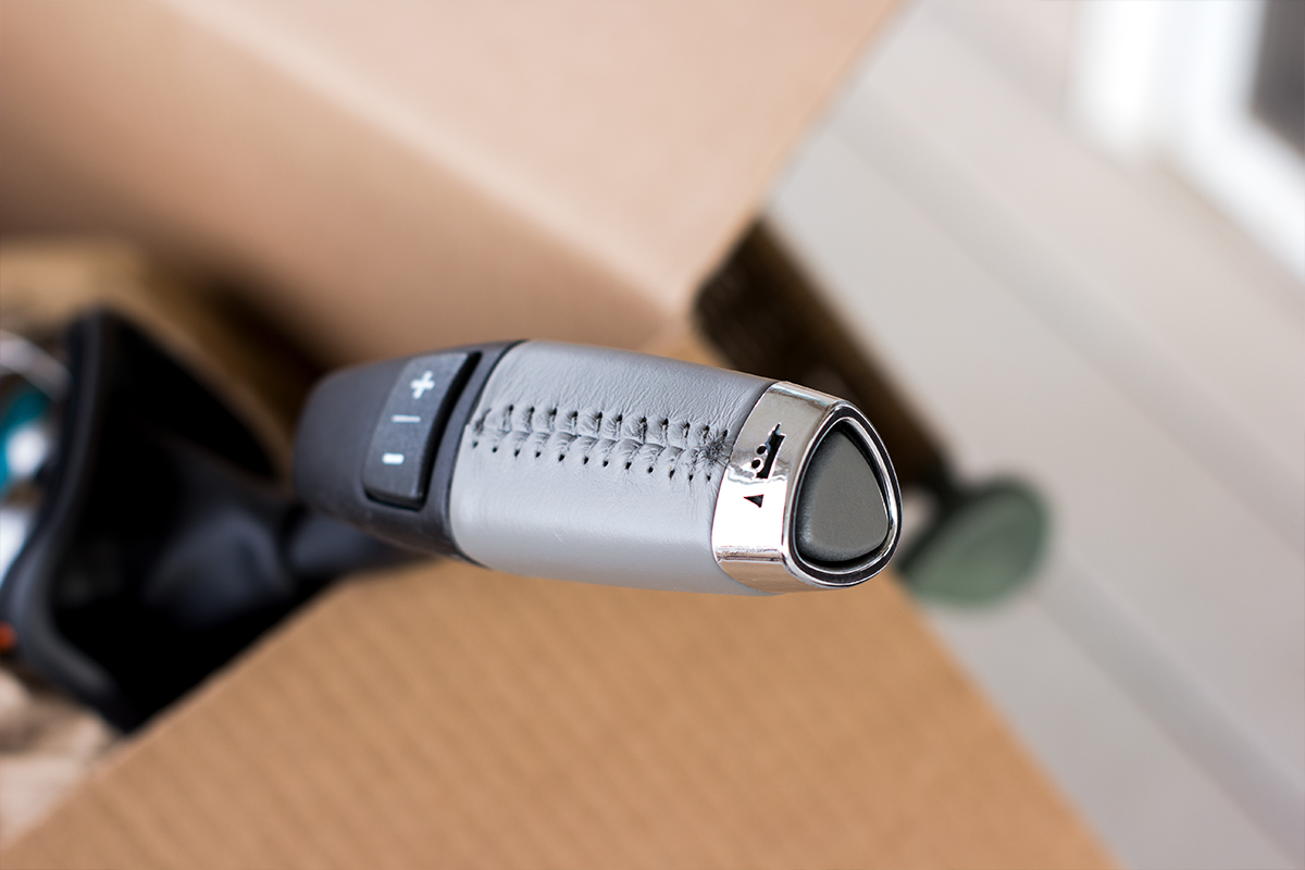

NBS to NNBS '09 Escalade Leather Shifter Swap
First things first.
1. Thanks to @Tonyrodz for tracking down a NNBS shifter for me. I ended up buying that dark brown one you found.
2. Thanks to @Rocket Man for helping me sort out the wiring. The NNBS had 4 wires (2 black and 2 white) whereas the NBS had only 2 wires (both white) so i was confused. He let me know i only needed the 2 whites and that polarity shouldn't matter, so i soldered those two together and everything went great.
Pics!

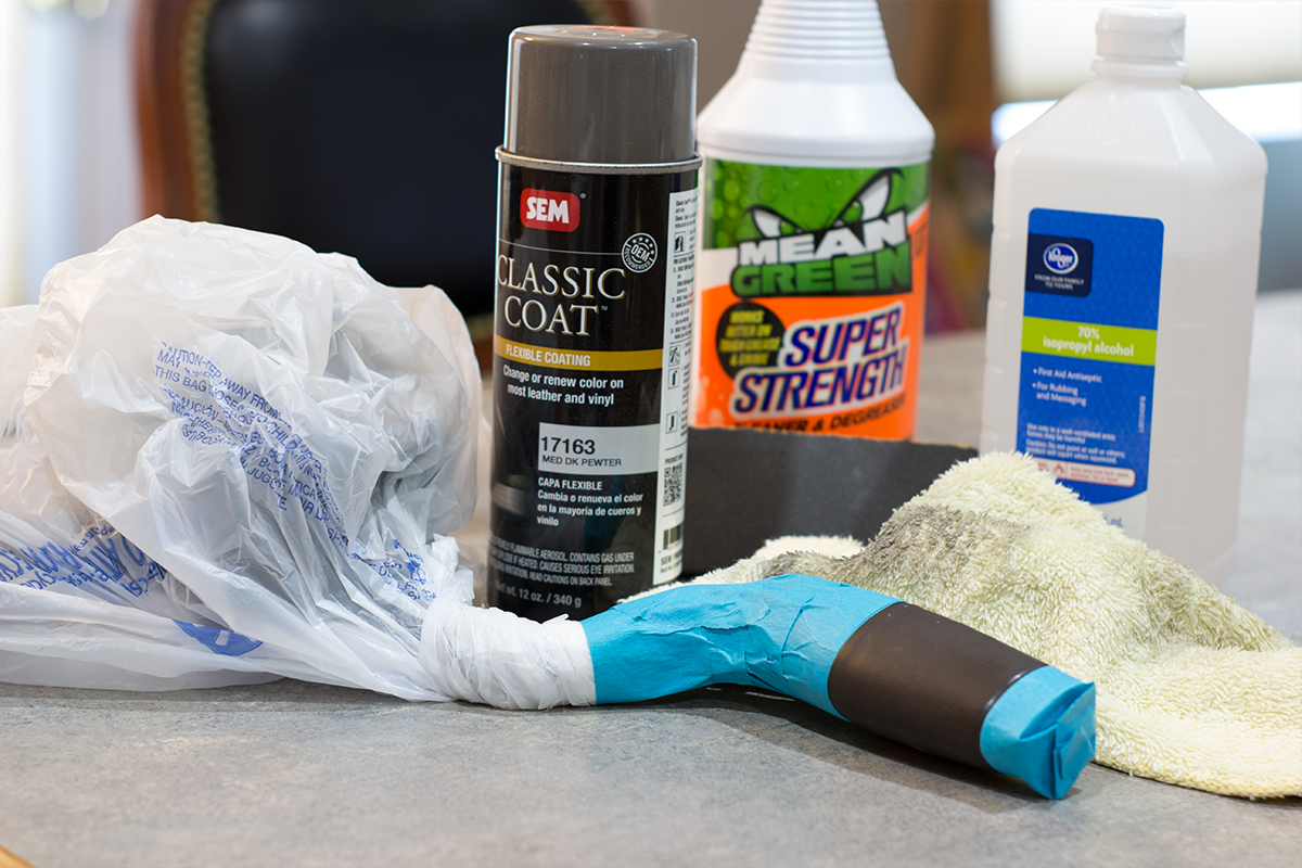

Here's what we started with.
it's amazing how many years of nasty DNA was embeded into this thing once i got to cleaning it. If you want a color of leather that hides dirt, get dark brown. I used mean green to clean it, then i very gently ran a lil sand paper on the leather to wake up the pores then cleaned it lightly with alcohol so the paint will adhere and then taped her up.

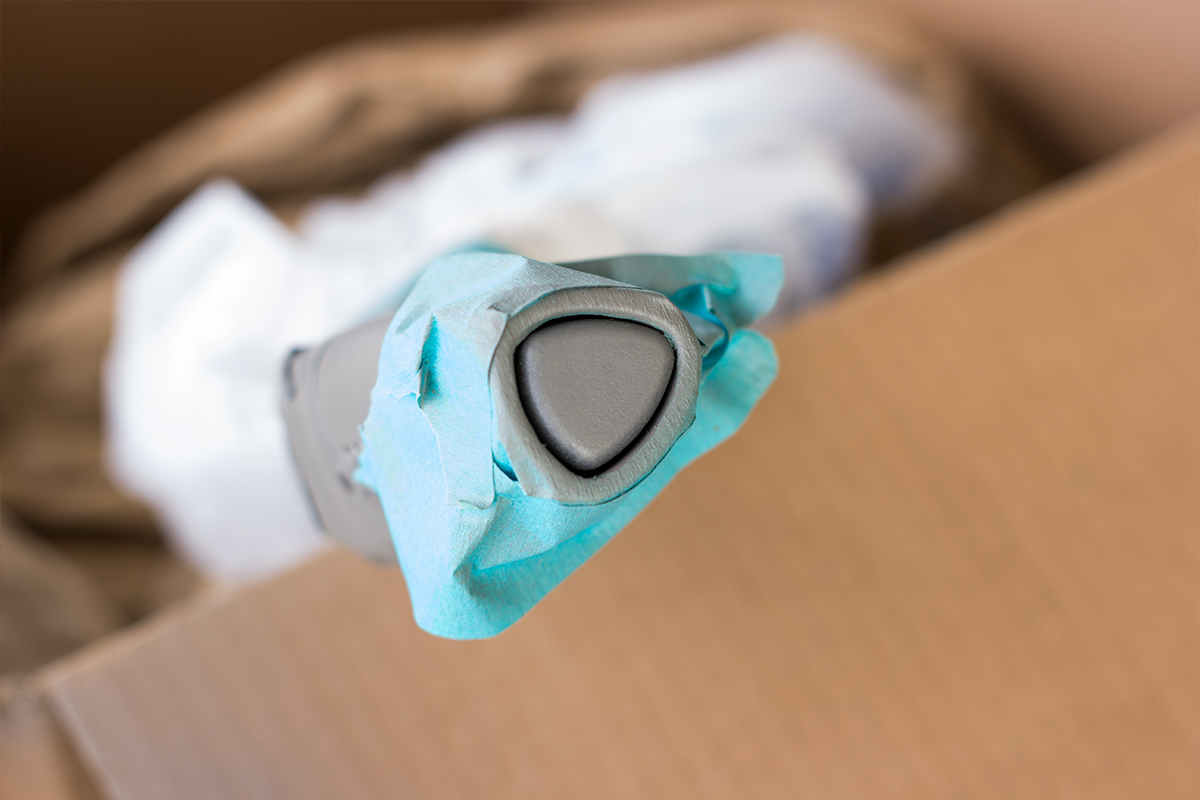

sidenote: when i was at the paint shop they had a huge rack of SEM and i took the whole color pallette outside to my truck and found the best match for Pewter grey leather. It's 17163 MED DK PEWTER (in case anyone needs to know)
i sprayed about 5-6 coats, waiting about 15-30 minutes in between each coat. (this is one of the most often used things you will touch on your truck so i wanted to make sure she would last.

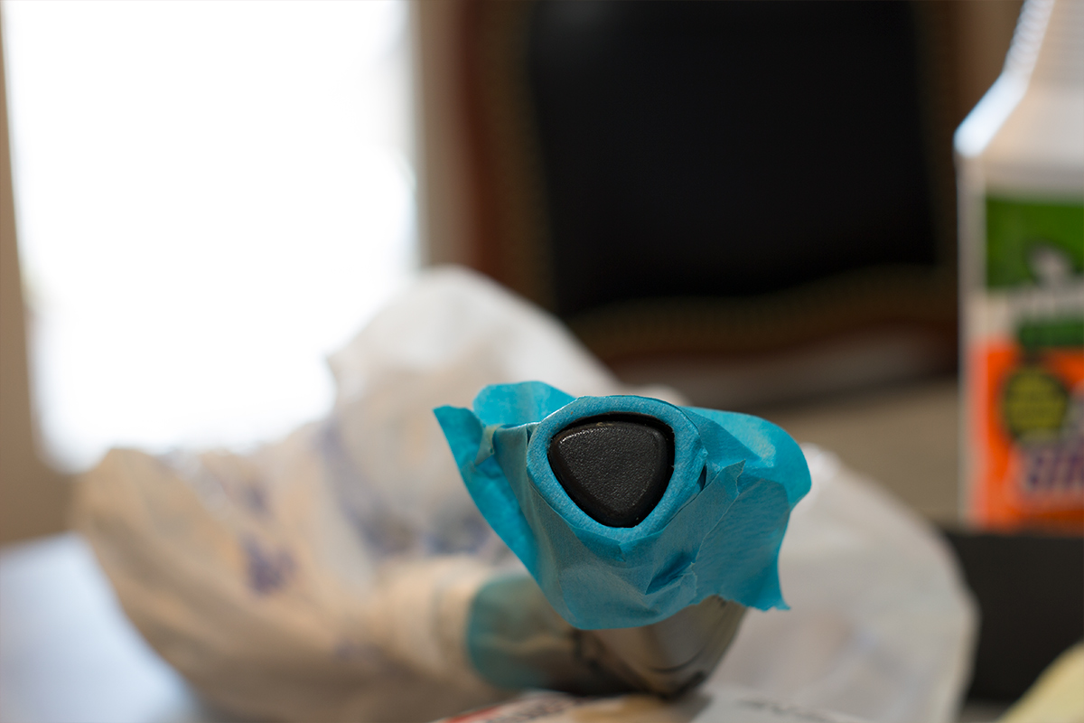

Then i looked at it, and thought it would be good to do the Tow button too.

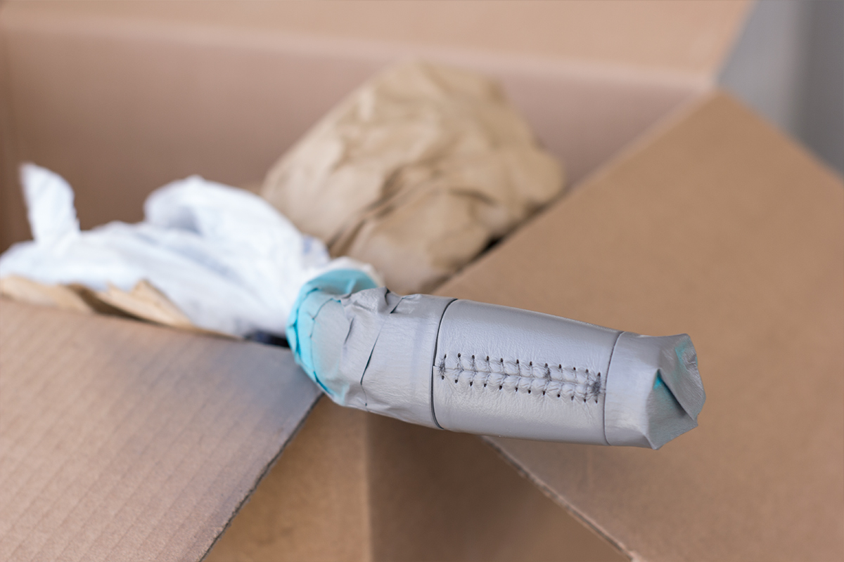

after SEM / Paint

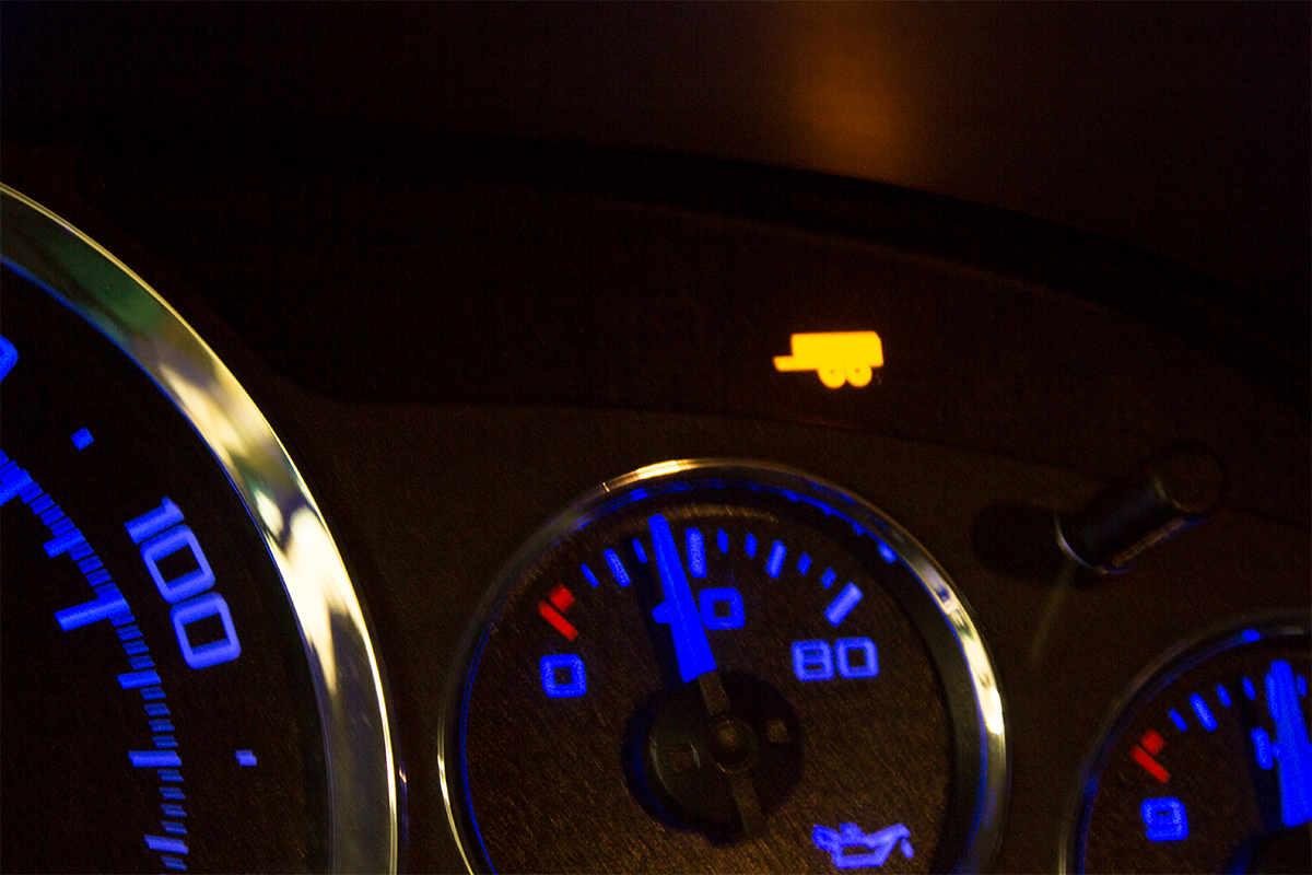

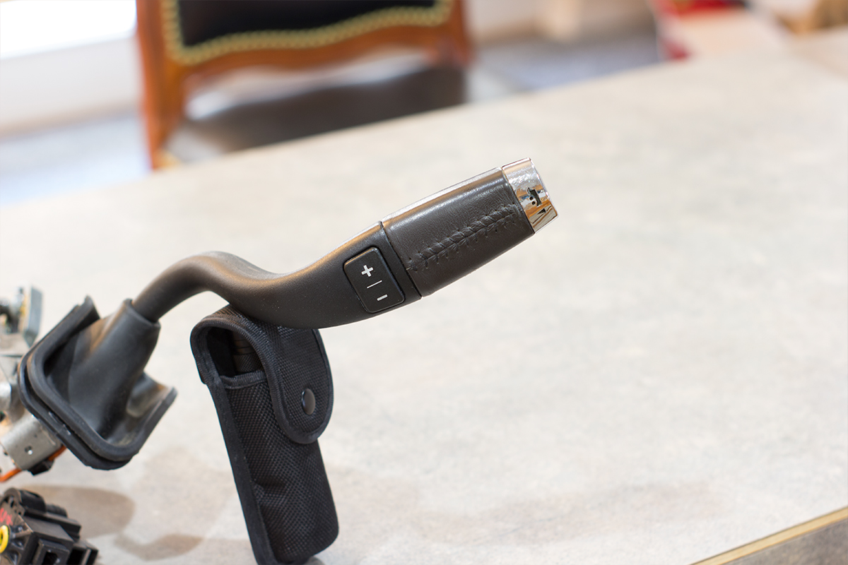

To install it i took the 2 phillips screws out from the lower plastic panel then separated them to get access. Used a T-30 Torx to to remove the one screw holding it on and then I cut the wire and spliced them with Mark's advice.
Just to show you, the Tow button works :)

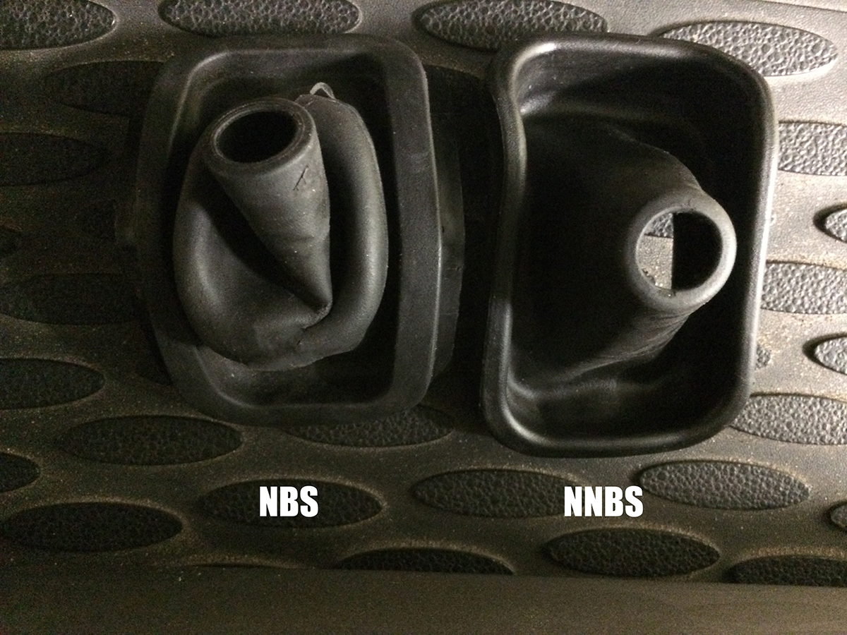

But then i tried to get everything snugged back together but the shift boot was giving me a headache. Then i compared the two and the NBS boot is smaller as you can see. Once i swapped the old boot to the new lever it all snugged up nice.
And here is the final result!

Well damn, this is what I need to do to match my Titanium interior...
Let us know in a couple months if the paint/dye holds up
also, you should have gotten the other style with the stitches in the back... ;)

Thanks. The SEM holds up great if you prep correctly. I had it on my OBS and all over my Lexus which i owned for like 6 years in AZ heat. Never chipped or wore through.
Also, i personally prefer the NNBS with the stitch facing. It proves that its leather to the eye. Otherwise it might as well be plastic painted grey.
Just my opinion. and thanks, man

I see your point, I like how it's on the back and out of the way. However, with the stitching out, that just means you need to do a custom leather/suede dash with the stitching in a different color...
next mod!!!

Does SEM have a clear? Just to act as protection.

That NNBS shifter looks smooth man! I really need to get on mine! Haha. Mine has the stitching on the back. Lol. Looks like I’m ordering more SEM tonight so I can get on this this weekend haha.

unless you wanted it to shine there is really no need for clear. SEM is durable as hell
hook it up man! its fairly easy. the wiring was the only thing that slowed me down
You know what would look better? Hydrodipping the black plastic to match the steering wheel....;)

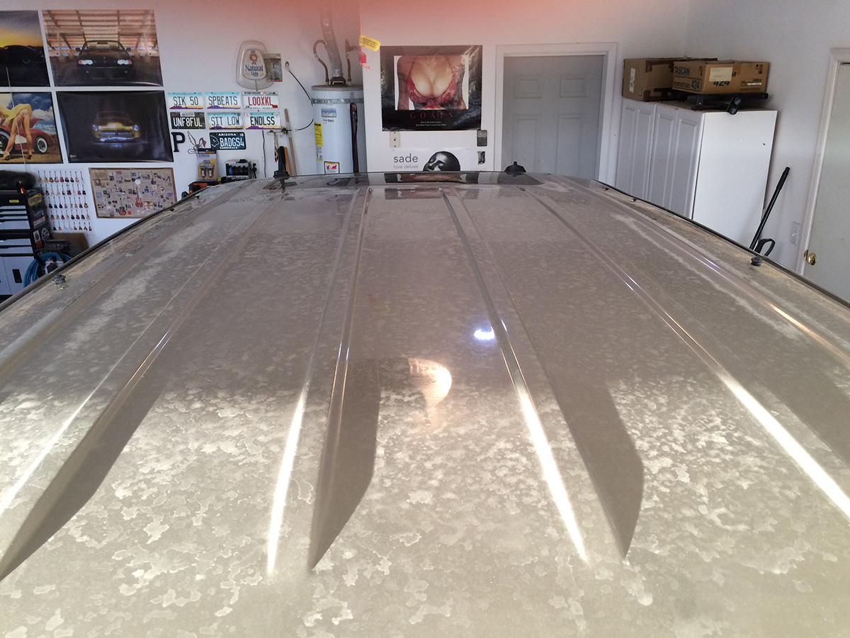

Well i started on the roof last night. Removed the esky roof rack. was going to start scuffing. But......
then i felt the sky glowing behind me
and i had to race out and capture a sunset..
Guess she'll have to wait till this weekend for more progress.
She is getting uglier and uglier before she is going to look pretty. It's hard for me to even drive her looking this way. But at least finally people are starting to give her attention :)

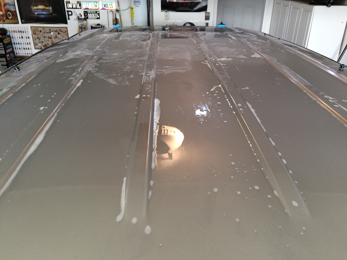

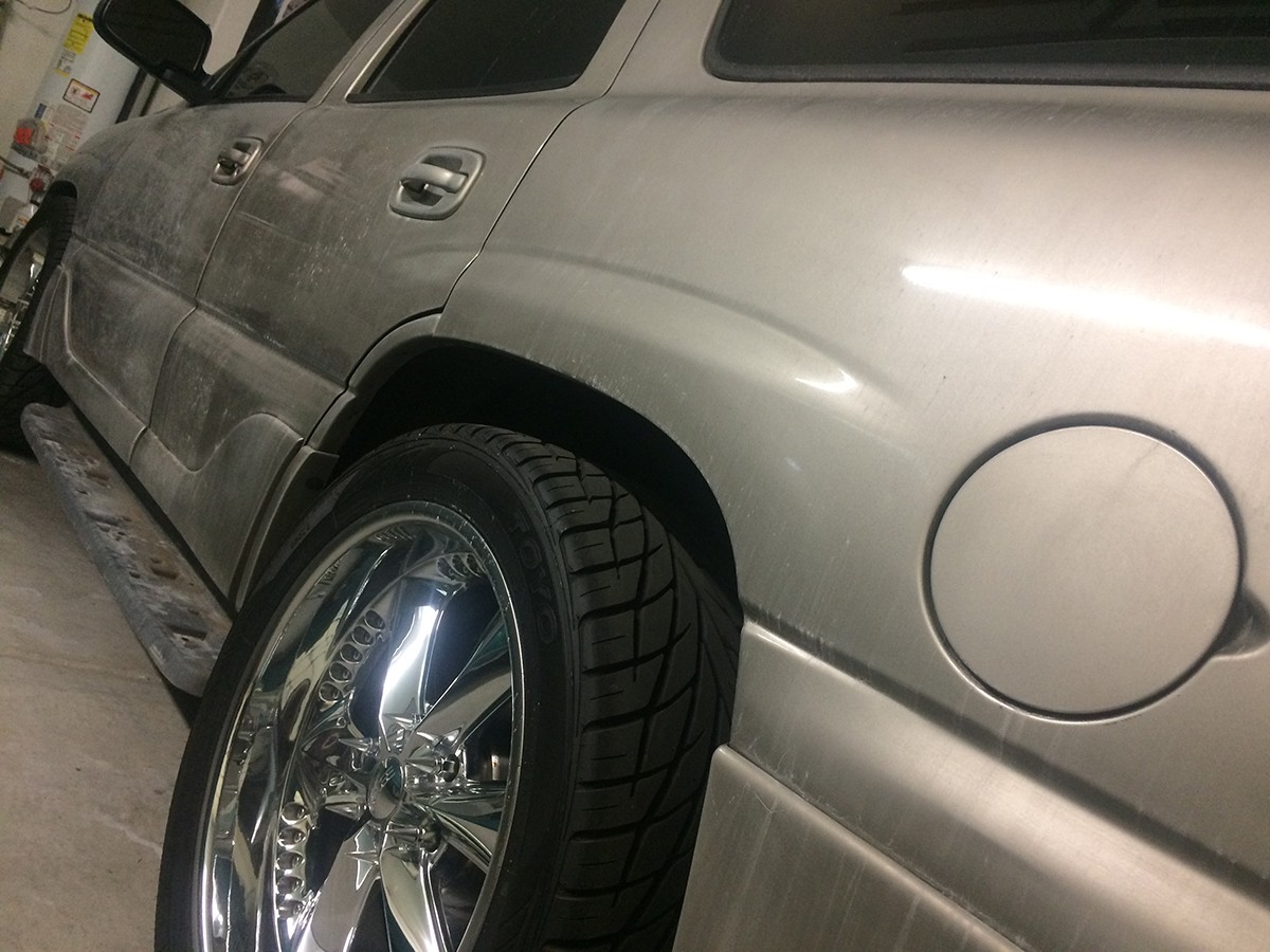

nothing to see here, just a bunch of prep/sanding pics
my 43 year old body and arms are sore as hell, haha
i just laid on the roof and took my time laying in the water as i sanded away

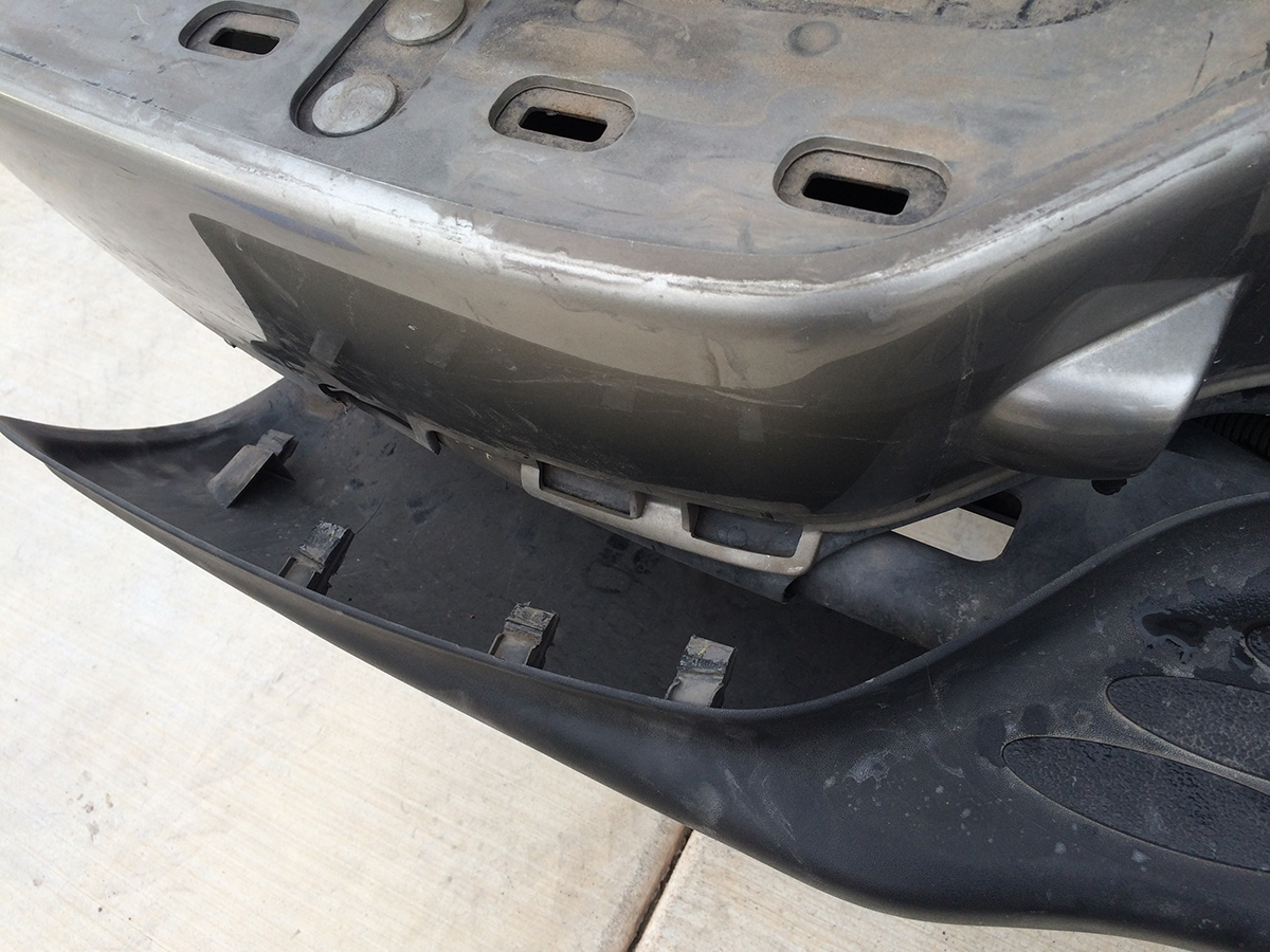

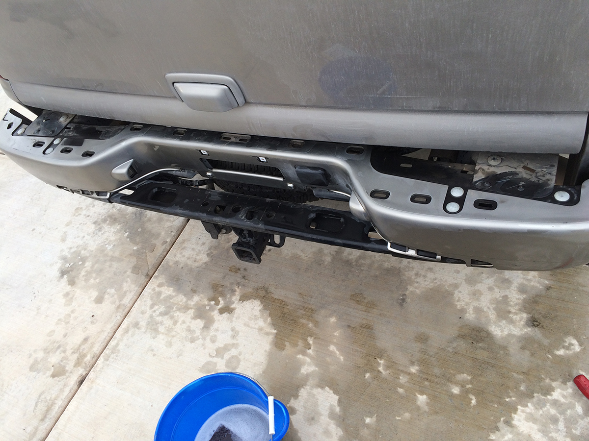

took off all the black plastics on the bumper.

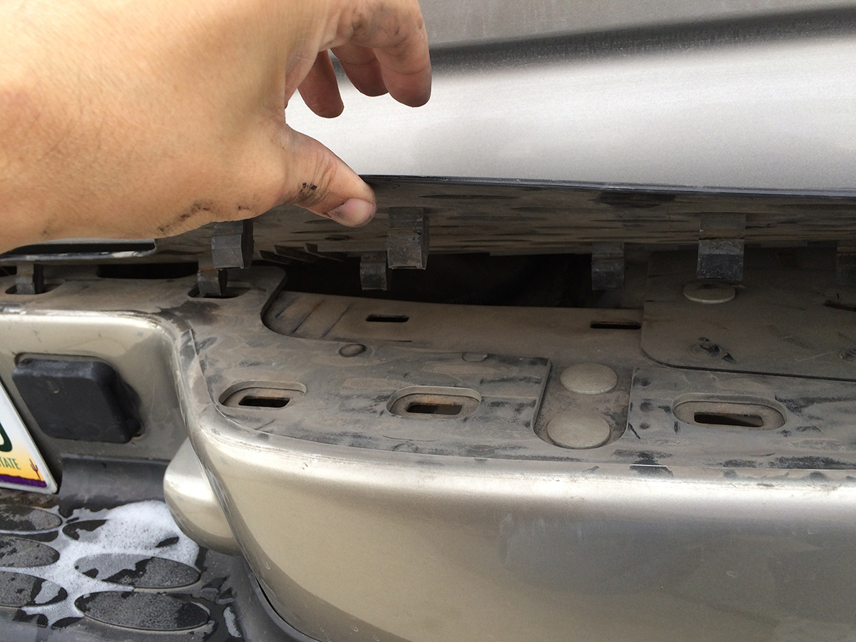

just in case anyone is wondering how to remove these...
don't just try and yank them off. lay on the ground and look up, you will see they are held in by these thick squeeze notches. i just squeezed them with a pliers and pushed them through until the two left and right top bumper plastics released.
the lower bumper plastics are the same but they have the basic circle clip on the lowest bottom edge as well
all off. gettin uglier by the hour :) sanded the back tailgate/bumpers
and finally.. the whole drivers side has been wet-sanded
threw a couple plugs/attachments on my Gun so i could test the CFM,, and these puppies throw out a mass amount of air and the compressor seems like she will keep up with me... So that was relieving. Yes, thats a beer. I think i drank 12 for everyone
:happy160:
So tomorrow i gotta remove the front lip. And then the final stage of bodywork which will be the scratches and imperfections on the front bumper and i got a deep scratch / groove on the right rear i need to fill with bondo/glaze, prime the area's, then sand and sand some more.
