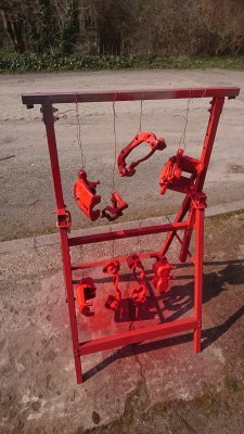

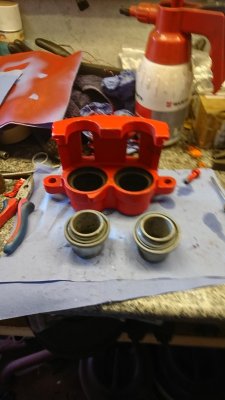

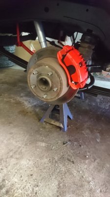

I was a little different, as I was using all new calipers, adding ss lines, etc. The only pieces I reused were the rear brackets, which i sandblasted prior to painting. I also rebuilt the parking brake with all new stuff while I was in there.
Not really an apples to apples comparison, time wise. The paint also comes into play. I used 3 coats of POR15 caliper paint. Took about 3 hours dry time per coat with a 24 hour cure at the end. Brushed on, which takes time. I will say it was well worth it. It is very thick and glossy with a good hard finish. I can tell that it will wash clean easily and last for a good while.
