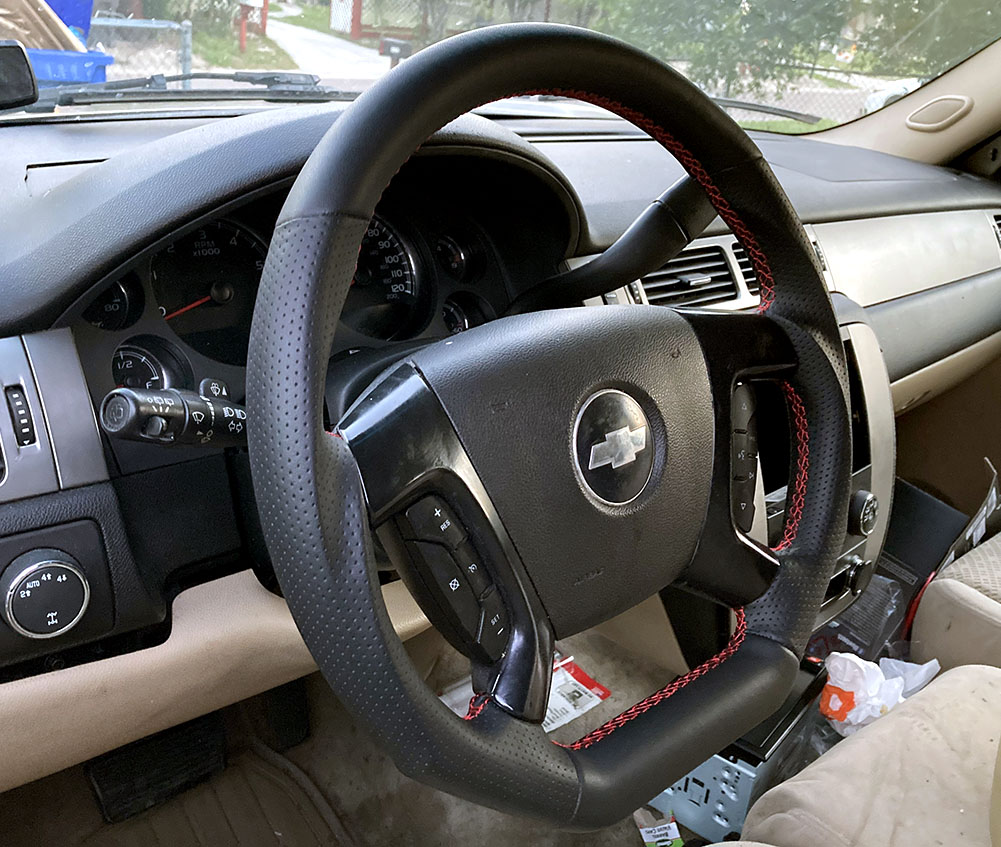

- New steering wheel (actually it is more comfortable, the wheel itself is thicker as newer models and more comfortable)

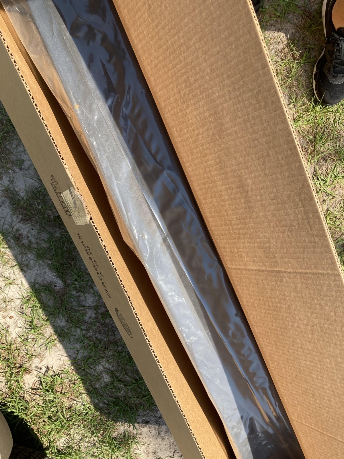

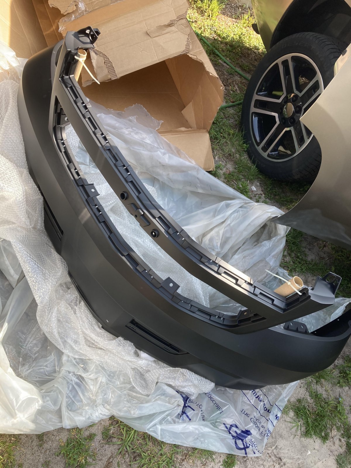

Just picked up the Lower air deflector from a hybrid version. There was no hassle here with purchasing this part locally.
Nice and tall version of the deflector. Hopefully bumper will come before Saturday so I could try them on this weekend.

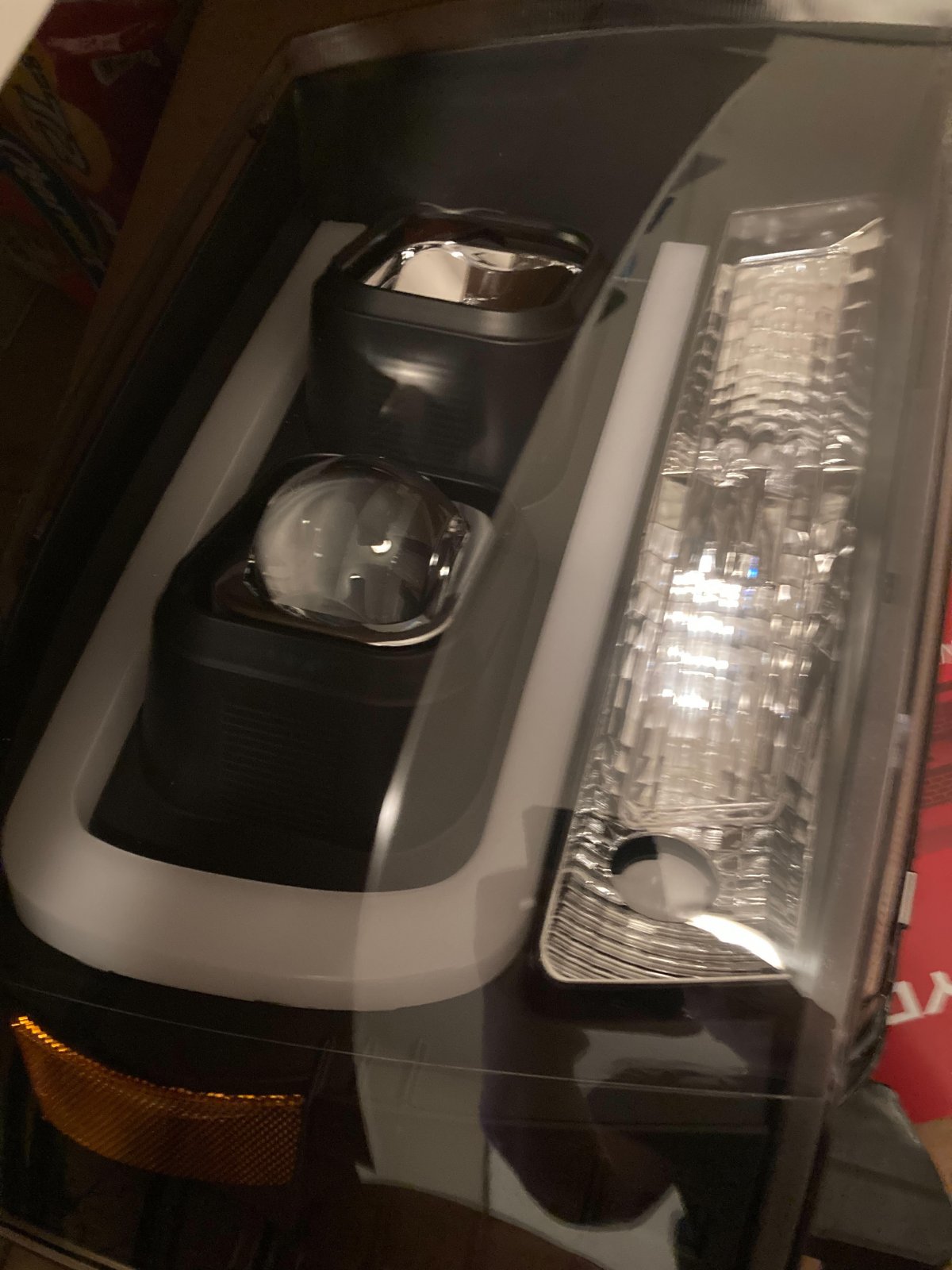

Spyders are here and I got some LED lights
(hopefully they won't melt the headlight)

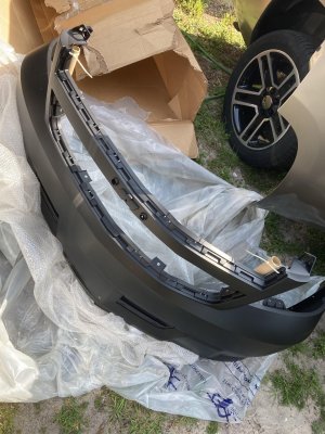

Never received folded bumper covers before, hopefully it didn't do any damage but I was excited to find out that the bumper got here before I woke up!

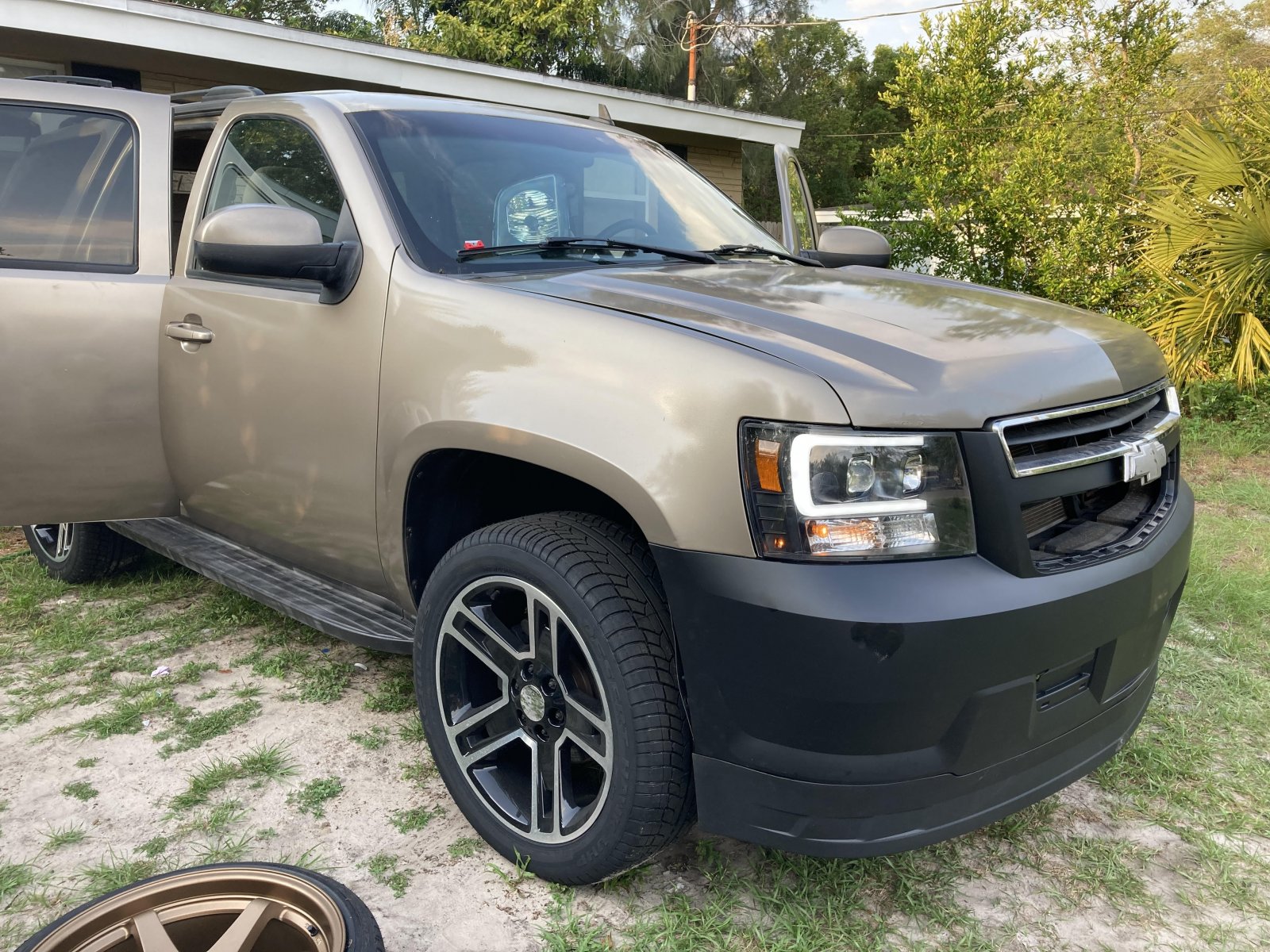

Mounted.
Next step: removing seats to change carpers + change the caliper + knuckle .

You’re not going to paint it? It’s way easier when it’s off the truck.
I just tried out the look. The hole thing has to be taken down before to paint.
Planning to paint into 2 steps/2 days. Roof + bumpers & hood, other day - the rest.

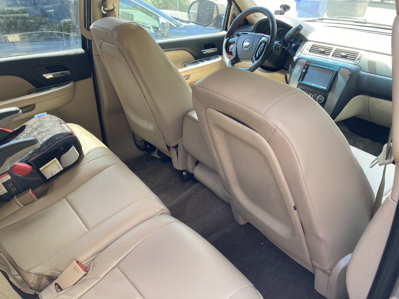

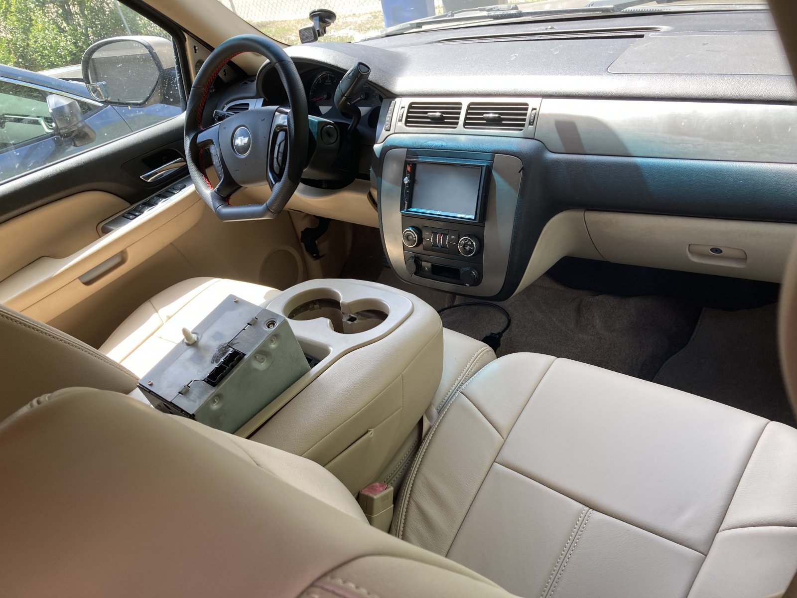

Then Katzkin leather seats covers came in. I couldn't resist and until 1am was replacing them + new carpet floor.
1am. So far mounted carpet in the front side of the car + front seats + middle one (9 seats ls).
I hope tomorrow will wrap the seats and share some pictures.

A steam gun with a hose attached to reach into the corners helps greatly with installing the Katzkins. You can get the foam to puff up into the corners so they come out tight. Believe me it makes a world of difference using one to eliminate wrinkles. To do the headrests, remove the old covers and put a thin plastic bag like the ones from a grocery store over the foam, clamp the headrest using a vise on one of the posts, and wrap the open end of the plastic bag around your vacuum cleaner hose attachment and tape it closed. Turn on the vacuum and it will suck the foam until it shrinks enough to get the cover over it. Get it positioned right and then turn off the vacuum. It will come out perfect. Cut the end off the plastic bag and bingo.

Thank you! Someday this week will put on headrest following your advice. Progress so far.

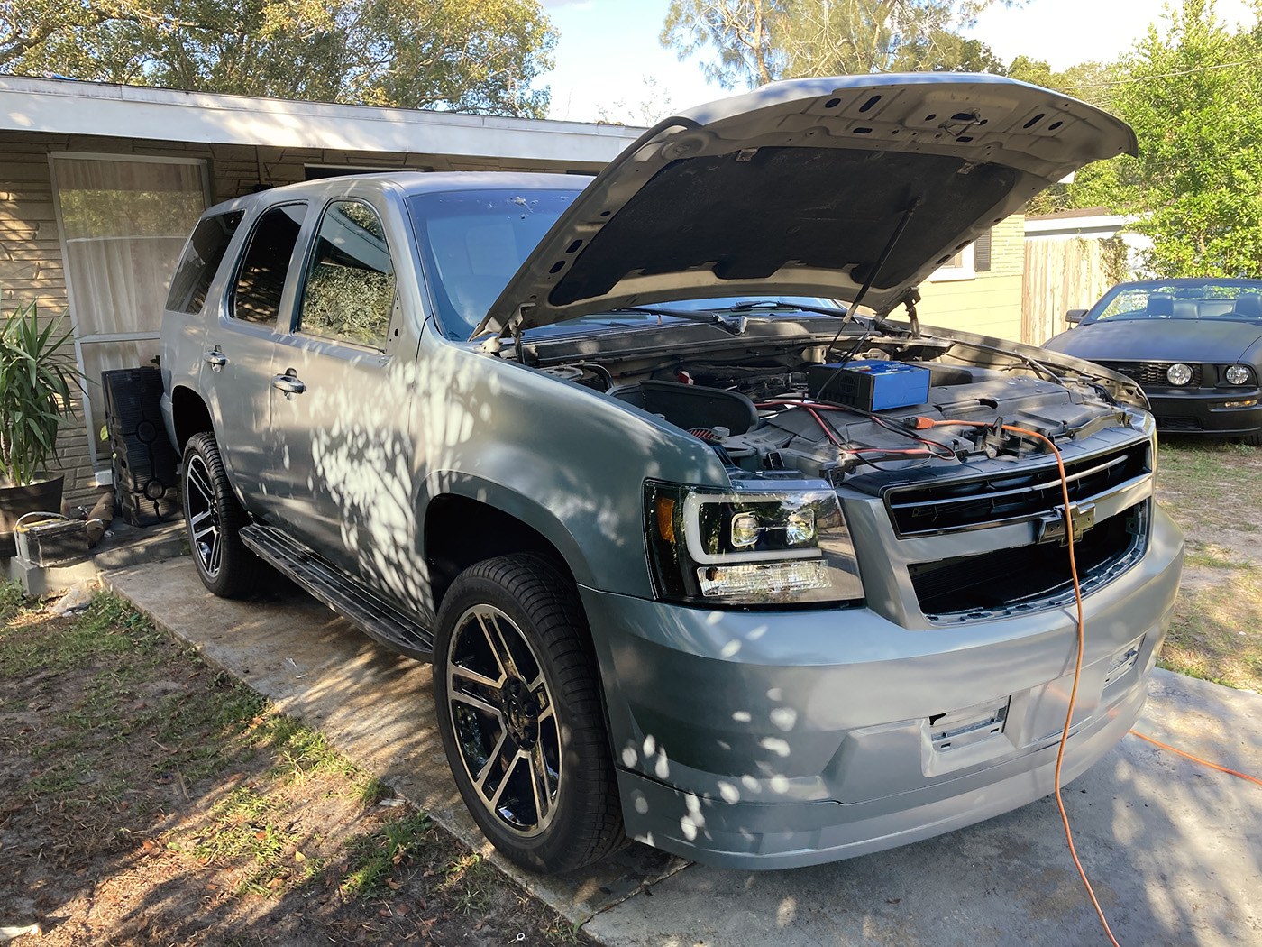

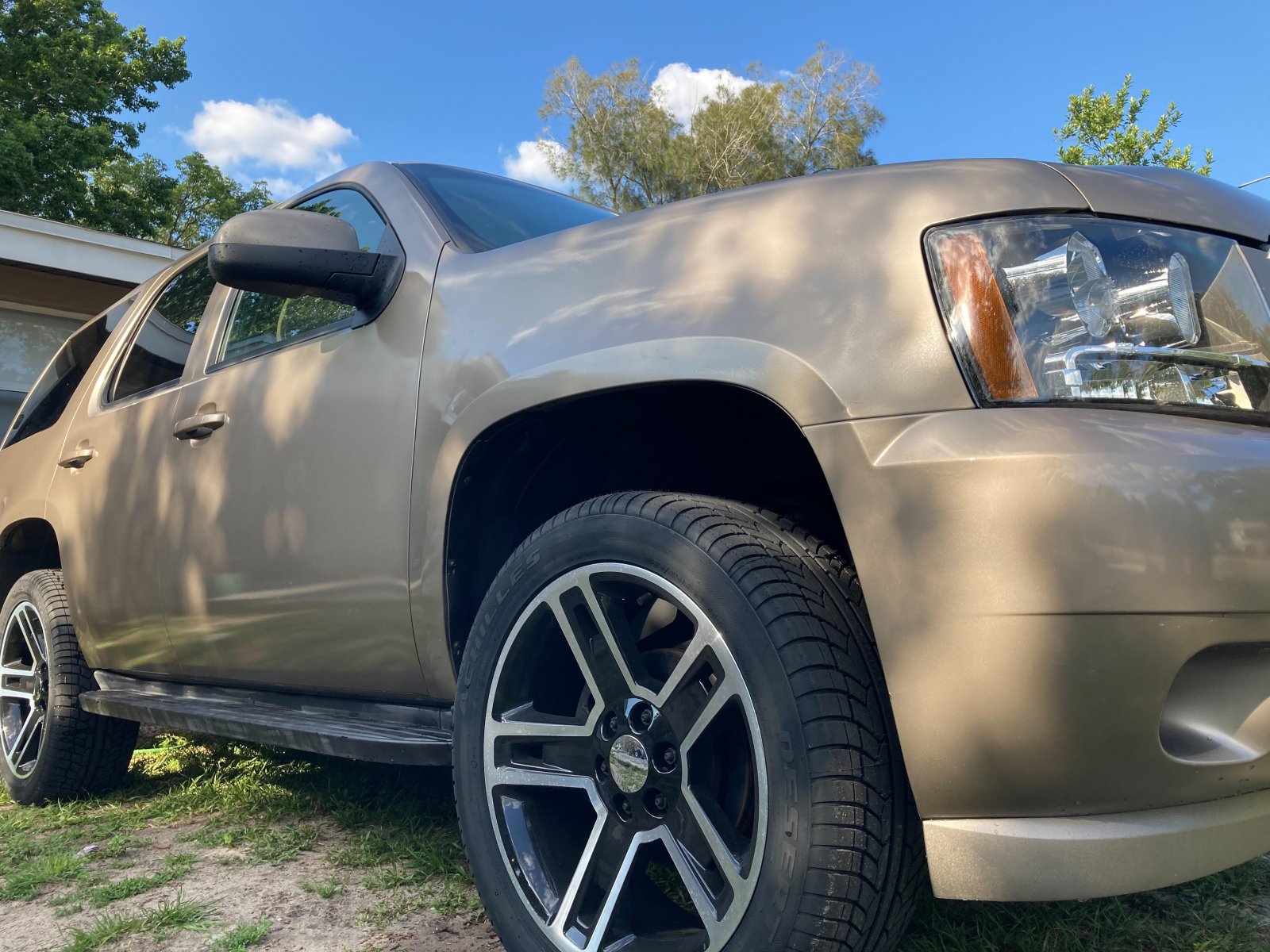

Was a but busy with a few other car projects, but finally came back to Tahoe. Painted last weekend (was experimenting with paint + clear, ended up with very very strange color -> semi-gloss industrial gray blue/greenish shade in the shadows with high contrast).
Time to cleanup, paint mirror covers in high gloss black, put new plastic steps and ready to roll.
BTW, I HAVE NO IDEA HOW TO PUT IN LOWER GRILLE! Broke bunch of plastic teeth on the top of the bottom grille :( Any advice?
While the truck was sitting waiting to be painted, right led light died. will check what is happening.

Nice. Of course we need more pics of the paint.

That’s a cool color!
