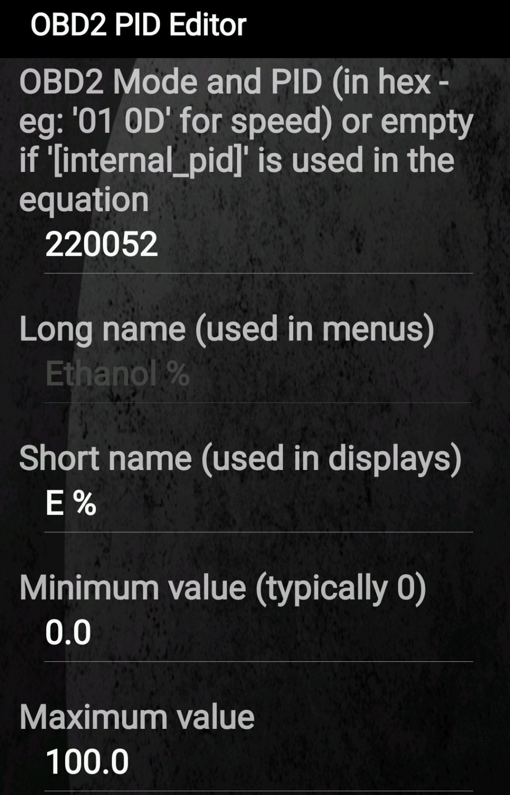

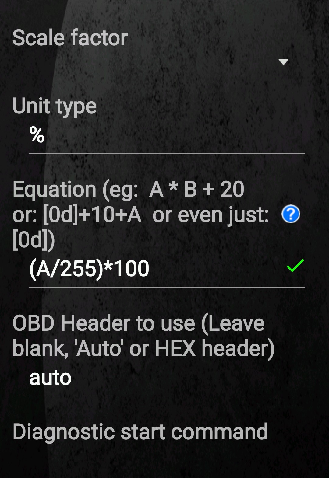

I have the Torque Pro app, I didn't think think vehicle had a flex fuel sensor?
It doesn't have a physical sensor, it has a virtual sensor so to speak.
It uses the O2 sensors and fuel trim data to calculate the ethanol percentage.
You can set up a custom PID in Torque Pro using these parameters to see your Ethanol percentage...
