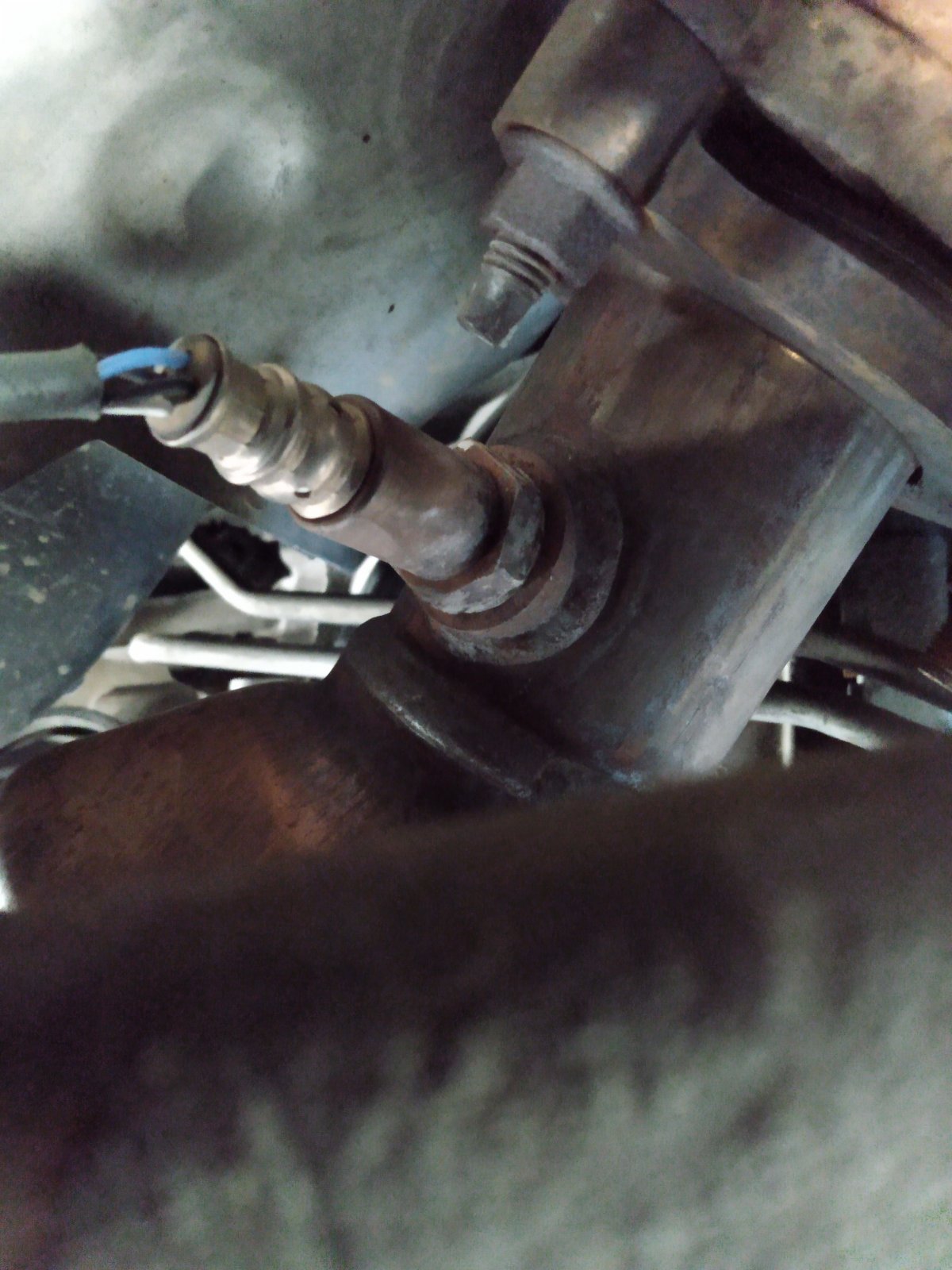

Just tested for leaks. Used the vacuum method like treehan suggested (thanks for the info). No leaks.
Here's a picture of the down stream and up stream O2 on the passenger side. They certainly look OE.
I think since I'll be replacing my cats I'll just replace the O2 sensors as well.
Question. Since I'll be replacing the cats will I have to have it retuned? I'd think no but, then again it will be a freer flowing cat compared to stock and slightly smaller in size.
I may swing by my mechanic to have him test the cats just to be sure. He's a good guy and will probably do it for nothing. I'll just weld something up for him in return haha.
Thanks again fellas, the info is much appreciated

Dang sorry it wasn’t just an exhaust leak. I fixed a v8 Lexus with a tiny leak and p0430 that the dealer estimated the owner $2300 for new cats and sensors lol.
No worries my friend, been welding for 22+ years. This is fun stuff for me, plus I've been wanting to do this for a long time. Now, I'll have to get the show on the road. I'll end up driving my Charger while I do this, want it to be purty haha
21,296
30,248
No tune or relearn necessary, it will adjust quick enough. Just remember, new cats can throw a code within the first 50-100 miles as they break in. Perfectly normal, just clear it and keep driving.
