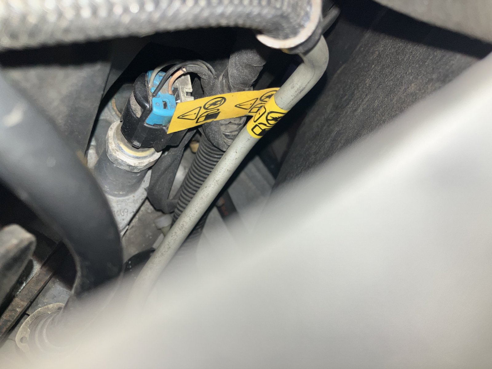

Is there a special trick to unclip the plug? I pulled up on the white tab and tried to squeeze the blue to no avail. I was hoping to avoid pulling the intake, but I will if that's what it comes to.

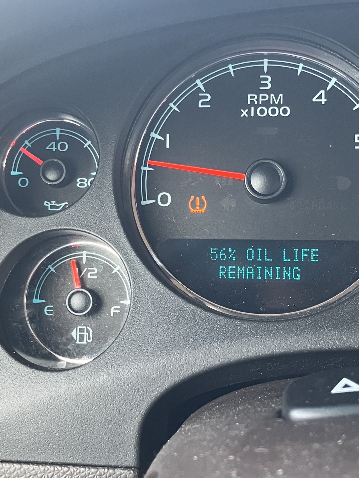

Attached pictures of oil pressure at the time of the oil change. IF the oil pressure reads under 40/20 and the stumble is still present after sensor and filter replacement, is the pick up tube o-ring likely the next culprit?
Thanks for your help!
your oil pressure in your pic is normal.

you need to pull the white lock tab up and then squeeze the black tab under it, the blue colored part has nothing to do with releasing it.

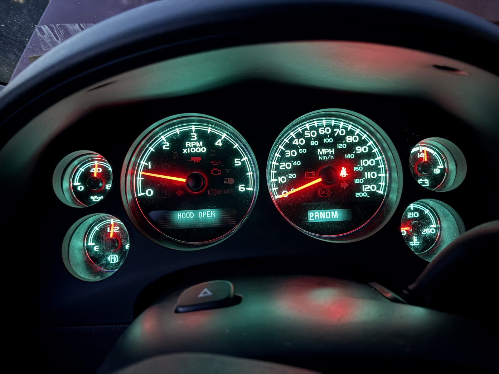

Back in business! Thank you for the help!
Side note- how important is that white retaining clip? It must have fallen off while the sensor was unclipped, as I was stubborn and decided not to remove the intake.

It’s just a safety clip, it only keeps you from being able to squeeze the release. The connector still clips on securely.
