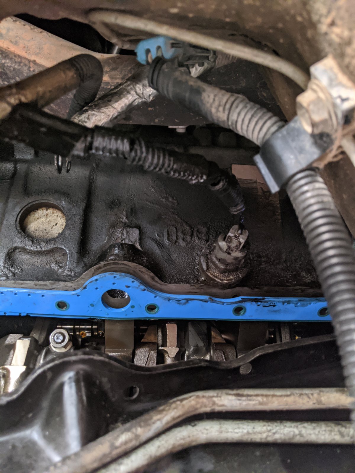

Photo of the sensor in question. Right by the oil dipstick.

This is a 350, right? I’m having a senior moment and cannot get my bearings in your photo, but they use a knock sensor in the block near the starter.
They can be quickly swapped out without losing too much coolant.

Ah, a knock sensor. My photo is taken with the starter removed.
So the knock sensor is in the coolant too?

Torque spec for the knock sensor is 14 ft-lbs, so it doesn’t take much. Mine came with thread compound already on it. No need to drain the coolant if you’re quick enough.
