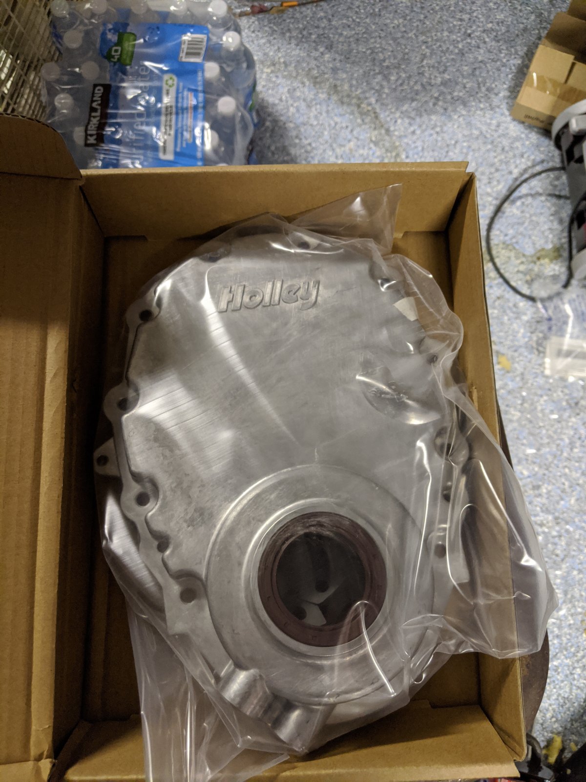

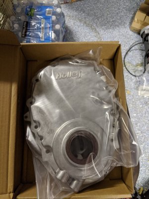

The Doorman one is. I'll snap a pic when it comes off.
This one is going on.

Replaced my oil pan gasket a few years ago with a Felpro; OS 30693R included was a instruction sheet that clearly said not to use any type of sealant on the gasket. Most people are using sealant in the corners which makes perfect sense I did not. Cleaning the engine mating surface properly is probably most important as is the oil pan surface. Now I see why your replacing the front cover. The Gasket is not the reason for the leak it is the installation process or something else. Hopefully a new front cover is the fix.
After taking the front cover off, I suspect it is the issue. The gasket on the plastic doorman cover is a small o-ring. The new cover comes with a paper gasket that covers the entire surface between the cover and the block. The plastic cover, that o-ring does not cover that full surface so you essentially have a small area that isn't sealed right in the corner. So this cover may work ok if you are using the sealant in the corners. But without that, I don't think the Felpro gasket would really seal in that area.
I have used Felpro before, I think they make a really good product, it's just twice now it hasn't worked, and it may be no fault of their own. I suspect that if I were to re-install the Felpro with the aluminum cover it may be fine this go around. But, I'm a little leery to go that route with two previous issues. And the original AC Delco gasket did a good job. I'm optimistic that the third time will be the charm :)
