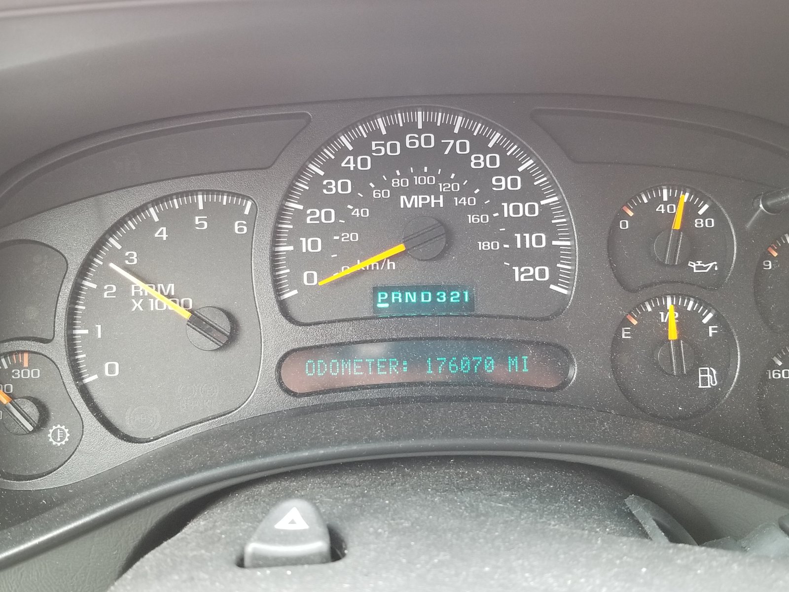

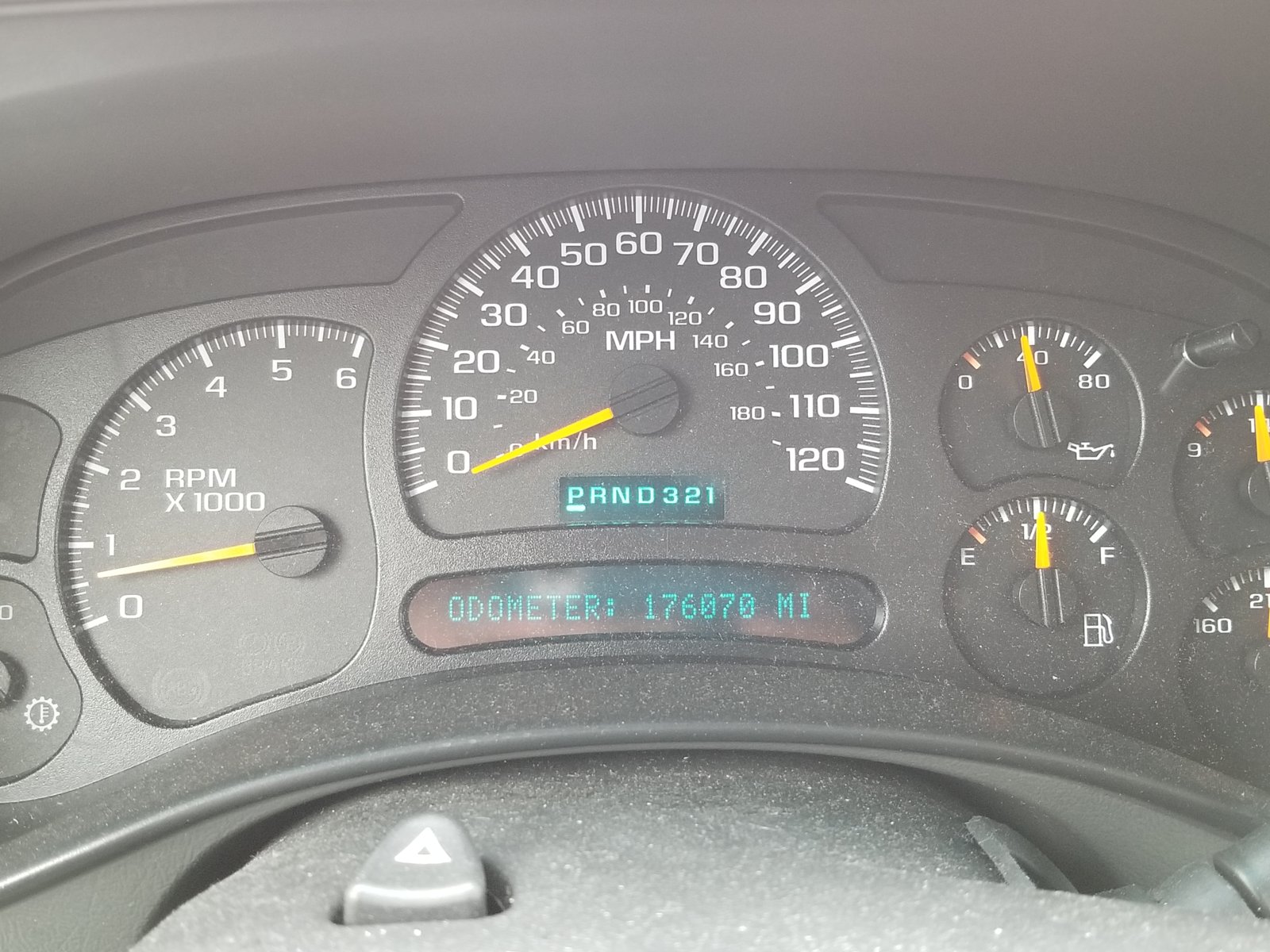

Here is oil pressure with engine fully warmed up after 2+ hours driving around town. First pic is at idle and second is at 2500 rpm.
