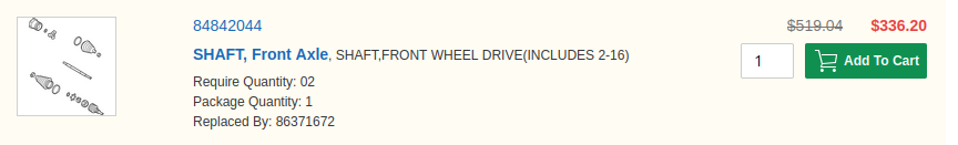

Resurrecting this to ask a stupid question because I think I got a stupid answer from one of the on-line GM Parts vendor's agents (or so I think it was).
The question was "Does the same front half-shaft (cv) axle fit both sides as there is only one part number shown (which I provided)?"
That was in reference to 2008 Tahoe LT 4wd and GM part 84842044 .
The agent's answer was "No, because they are different lengths."
I pointed out that only one part number was shown on their site and the answer to that was "Even though there is one part number there is a LH and RH added".
There was no such thing (LH or RH) in their or other listings, thus the reason I say I got a stupid answer.
When I pressed the issue the agent closed the chat. Perhaps he realized that he was talking out of his butt.
Or maybe I got an AI agent with a name and that would explain the suspected contrary answer.
Anyone who has done both sides, was it the same axle on both?
In the mean time I can getting back under there with a tape measure to get an approximation.

Changed both CV shafts and wheel bearing hubs on my previous 2008 Tahoe Z71 and current 2019 Yukon SLT and both vehicles used same shaft for both sides. Rockauto or AutoZone or similar should confirm
EddieC
EddieC
Aug 9, 2014
966
801
The half shafts are the same, L or R. There's a newer model number.
https://www.gmpartsgiant.com/parts/gm-shaft-asm-frt-whl-drv-half-84842044.html (I wouldn't recommend purchasing from this dealer)
Thanks.
I ordered one of the old model number and received a different number shown on the label above. I did run across a site that had quite a few superseded numbers.
I presume it's just a number change but not sure. It installed and works fine.
The dealer's price that you shared is up there compared to what I paid.
