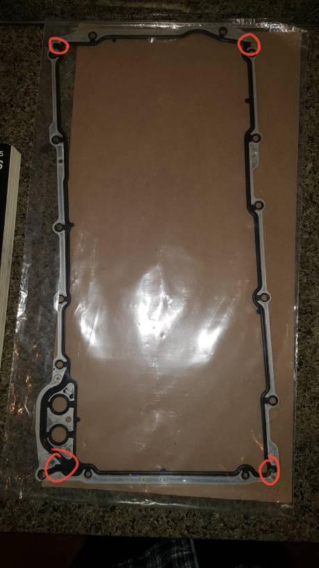

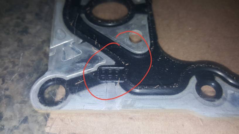

Curious, another guy on youtube is applying a dab of sealant to these waffle shaped corner peices on the gasket then putting it in...

All along the back side? Wow. Definitely not reading instructions or trusting the oil pan gasket to do it's job. Again, all we are doing here is just filling in those small gaps caused by the front and rear covers. Once you see the areas on the block corner you will understand.
Sent from my SM-G925V using Tapatalk
I saw that waffle shape area on my gasket as well. I don't know for sure if those are the areas that match the block. I did apply the RTV on those waffle areas but I may have been mistaken. The instructions do say..."apply directly to the block".

I saw that waffle shape area on my gasket as well and if i remember correctly I did apply the RTV on those areas. The instructions however do so..."apply directly to the block".
Awesome, yeah that makes since. I imagine that seam would leak. My lt1 I last did this on didnt have the seam like the 5.3L. Not sure why the waffles but appears as though gasket ia designed so.
I have the same black rtv you said you uses. I have always used that. Not sure why gm calla for something different.
Makes me a bit nervous but honestly i am just going to use thr black rtv designed for oil like you used. I think it should work good.
