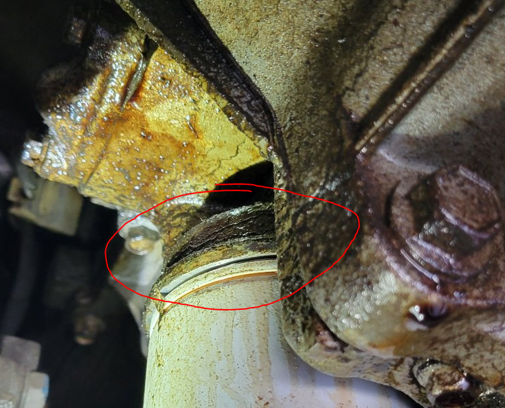

Have a 2007 yukon denali 6.2 liter. Have an oil leak that isn't the rear main seal. Trying to figure out where it could be coming from. Oil drips off of the oil filter but the filter is tight. 2 pictures kind of show you where it's wet on drivers side. Thanks

Classic leak spot is that little block-off plate with a bulge in it just above the oil filter. The cover warps over time and the thing starts to leak. Putting on a new seal won't stop the leak. Buy a new billet cover with an integrated o-ring, and you'll be good to go. Careful with the torque spec there also. They're small bolts threaded into aluminum. I *think* the spec is 106 INCH pounds.
Update: I have found TWO torque specs for those bolts - both from GM on different vehicles with LS V8s. One lists it as 80 inch pounds and the other lists it as 106. Having personally stripped one of those bolts out, followed by the joy of installing a helicoil in the hole with zero room to work, I would err on the lesser side and stop at 80 inch pounds. And, I suspect ICT includes an additional torque spec for their screws with the kit.
How are you so certain that it is not the rear main seal? There is also a rear cover gasket that leaks, and it is just as hard to get to as the rear main. When I replaced mine, there was no way I could verify the rear main for certain. In fact, the rear cover gasket was leaking more than the rear main.
I would replace all the easy gaskets/seals such as the blockoff plate, oil pressure sensor, oil pan, etc. They're cheap and easy to do. Also, at that age, if they're not leaking yet, they probably will soon anyway. If it still leaks after doing those, then there's only one more thing to do.

That thing above the oil filter is sopping wet, that's the oil cooler block off plate like others have said. I would suggest looking and making sure that isn't the cause of the leak.
Also.. what in the world is this thing? Are my eyes deceiving me or is this a sponge that someone put in place to hide oil from dripping on the driveway?

If there’s no evidence of a leak *inside* the bell housing, we can generally rule out a rear main seal leak on these engines.
I could not see any evidence of my leak inside the bell housing. This is because it drained down the back of the engine. See post 112 here:
I'm not saying that yours is a rear main leak, but don't discount it either. Again, I would recommend doing the cheaper and easier stuff first.
Double gaskets?
