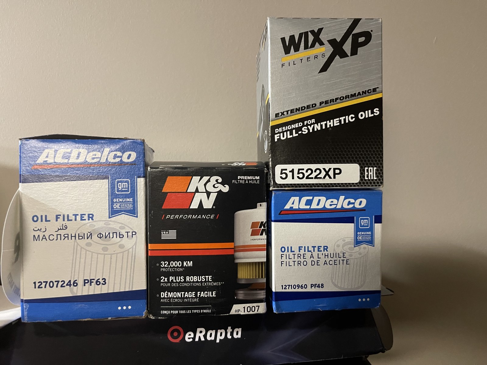

pf 48 looks like it was replaced with pf 48e-what i read is to get pf-63 instead everything the same except longer and more filter media.Anyone heard of that or using those.Maybe they are to long and would risk being struck by something.
No problem with them. Been using the longer filter without issue for years. Rock Auto has both PF48s and PF48Es along with the longer ones.

mobil 1 full synthetic 5w30 and the wix done today-i dont know why i thought the pf63 fit our tahoe's it does not.

I have been happy with NAPA Gold 51042.
Manufacturer of this is WIX...
Rated for 21 microns.
The NAPA Platinum is also rated for 21 microns, so Gold is good enough for my Tahoe unless Platinum is on sale...
The Wix number starts with the "5" and the NAPA filter drops that 5. Otherwise same number.
The longer filter is NAPA Gold 1522 filter or WIX 51522 (I use this one); the Wix can be found as the 51522XP with synthetic media.
