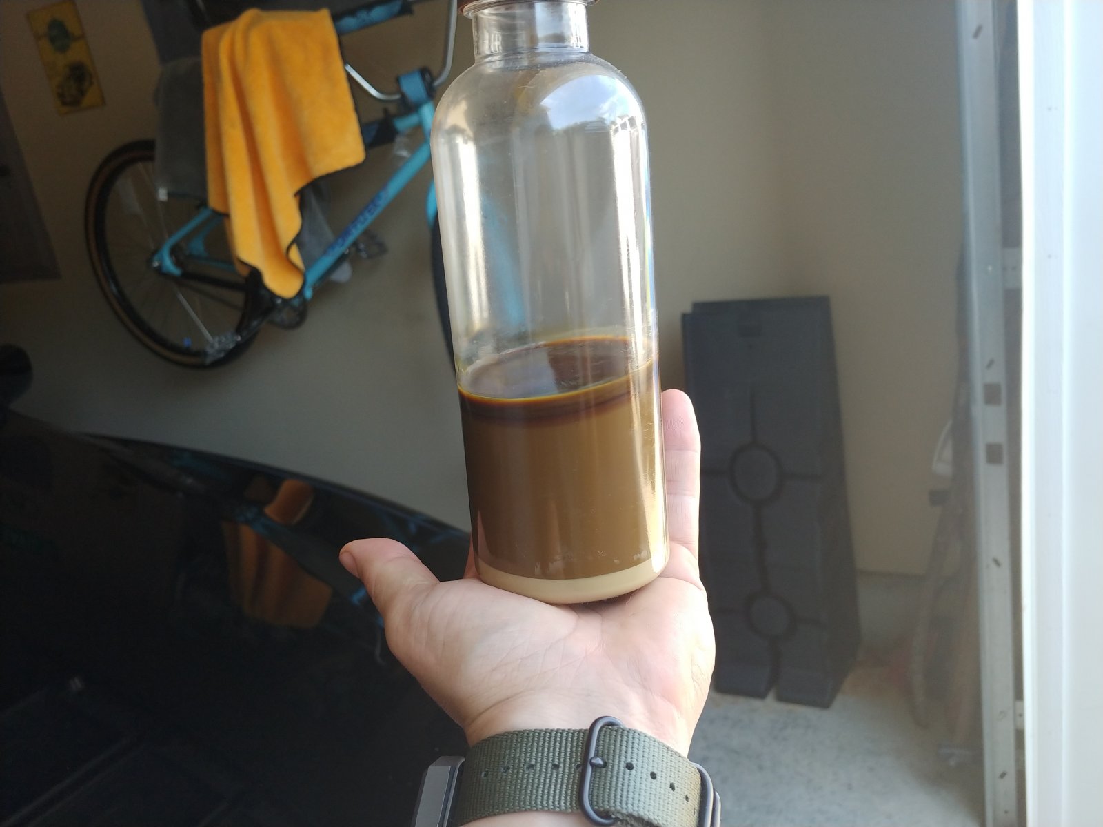

I am capturing about 1 ounce of oil in my catch can for every 1000 miles driven.

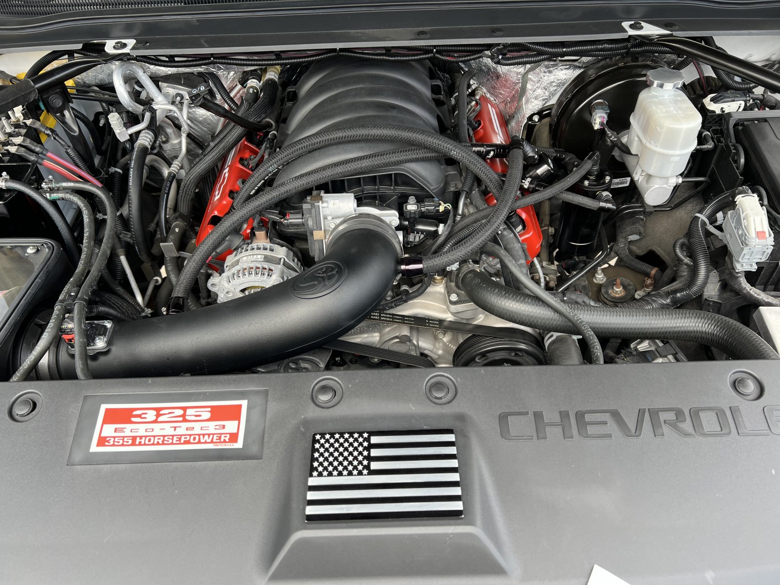

Although costly, the UPR setup is awesome because all hose connections utilize oem GM quick disconnects. Customer Service was top notch and I didn’t mind paying the premium price tag on a $60k+ vehicle. YMMV

As @iamdub stated above, mounting it next to the alternator makes for easy emptying and out of the way for normal maintenance work.
