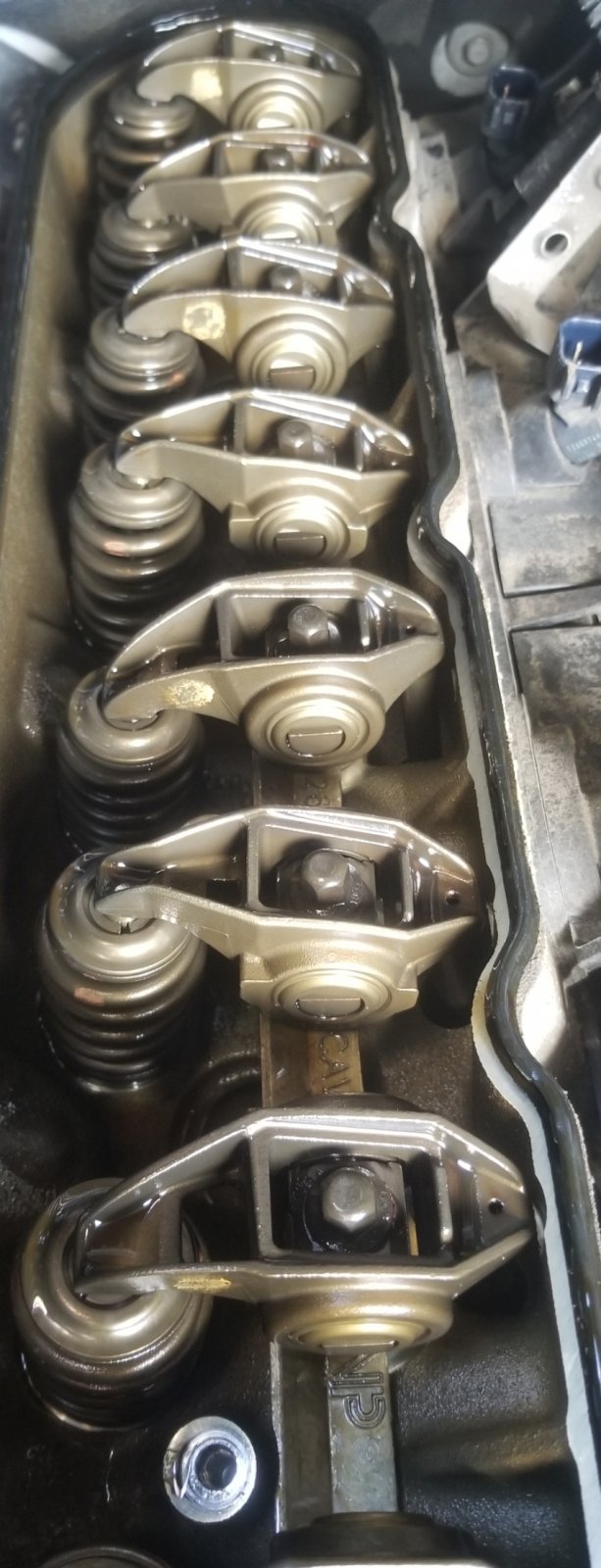

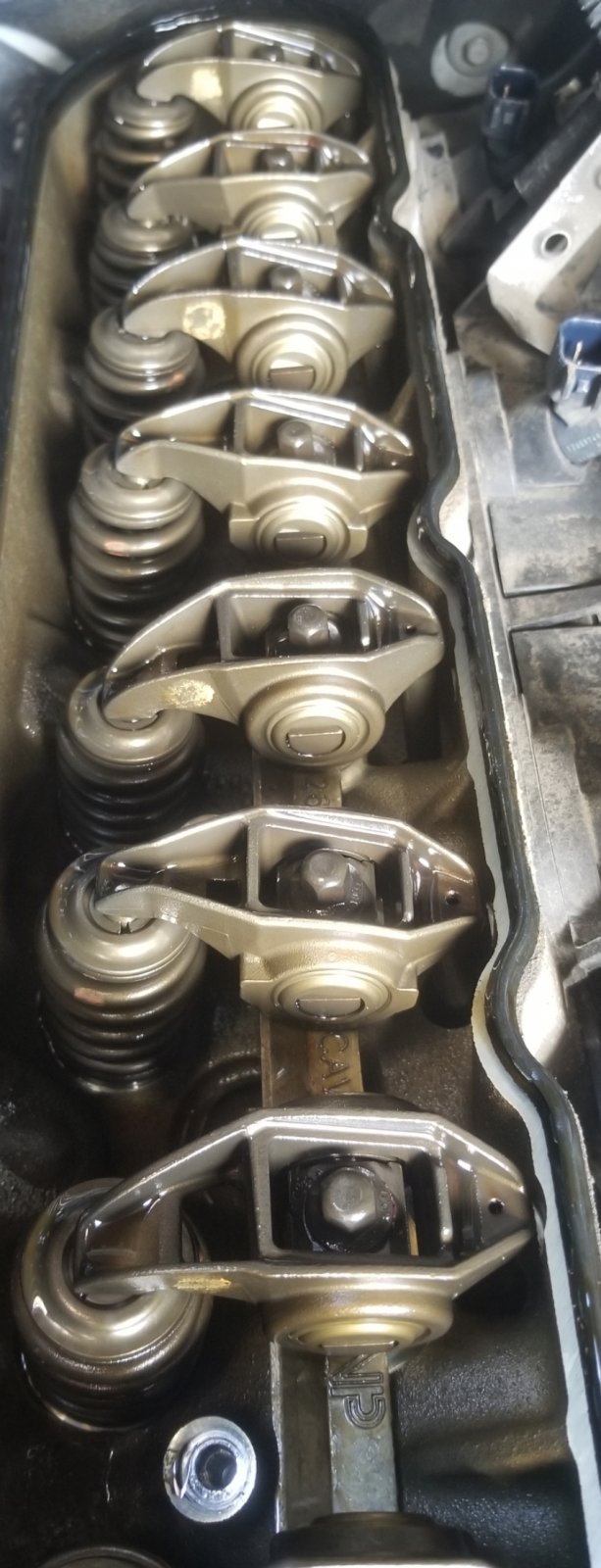

Update on this....
I used a stethoscope and it seems the loudest tap is around cylinder #6, so I pulled the valve cover to start getting into this.
Valvetrain looks real good as far as cleanliness, nothing looked out of place.
I wiggled all the rockers after I rotated them off the heel of the cam, all had normal back and forth but some have a little up and down.
I pulled #6 intake and the pushrod bore looked clean and the lifter looked ok from a visual perspective.
I then pulled #6 exhaust and there was quite a bit of up and down movement in the trunion....probably at least .030".
The #6 exhaust lifter bore was clean and the top of the lifter looked good, sorry, the video when on top the lifter isn't as clear as my phone display, but nothing out of place and naturally this tells me nothing of what may be going on inside the lifter. I shot some B12 in there to soak just in case after the fact.
This is the up and down movement on the #6 exhaust trunion....this IME, should not be like this. The intake moves up and down a little, but not like this.
Luckily there's a dealer near me, open late and has one exhaust rocker on the shelf. I'm going to get it and see if this hopefully changes things.
@Geotrash yeah, definitely looking like a hard part issue.

I have some good news and some not yet good news.
The not yet good news is I still have a very light tick.
The good news, I suppose, is the tick is on #8 and not an AFM cylinder...#6.
What I did was replace the sloppy #6 exhaust rocker and I checked cyl #4 and that seemed ok, not as bad as #6.
Before I replaced the valve cover, I pulled the #8 exhaust rocker and that one is worse than #6 exhaust. I still ended up replacing the #6 exhaust rocker since that was where the noise was concentrated using the stethoscope.
When I started the engine it took 5 min for the tick to start, but overall the valvetrain was slightly quieter and now the ticking noise is very pronounced on cyl #8. Since #6 is quiet now it's very easy to isolate the location.
I will likely replace all the rockers eventually, but the next step is to replace both rockers on #8 and probably the intake rocker on #6.
At least it appears I'm now dealing with a non-AFM cylinder so fingers crossed there's no compromised AFM lifters and another new rocker will fix this.
I was surprised to see the new rocker has a slight movement up and down in the trunion, but nothing like the old one. You would think there would be near zero movement up and down or radially.

The #6 exhaust rocker in the video has a good amount of radial play, but #8 had more. Rockers will be here this week and will at least get those changed out. For $12 each it's worth a try.
