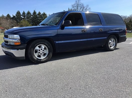

Customer wanted to keep the 16 inch rims for now so only way to do it is to go with the arms.
In front I had him decrank them all the way ended up getting 3.75 inch drop and in rear my springs with rear hardware kit got 6.5 inches drop over stock.
kit used
http://tbssowners.com/store/index.php?act=viewProd&productId=88

Love that! So, if I want to keep the PPV wheels on mine, it's better with arms instead of spindles?
