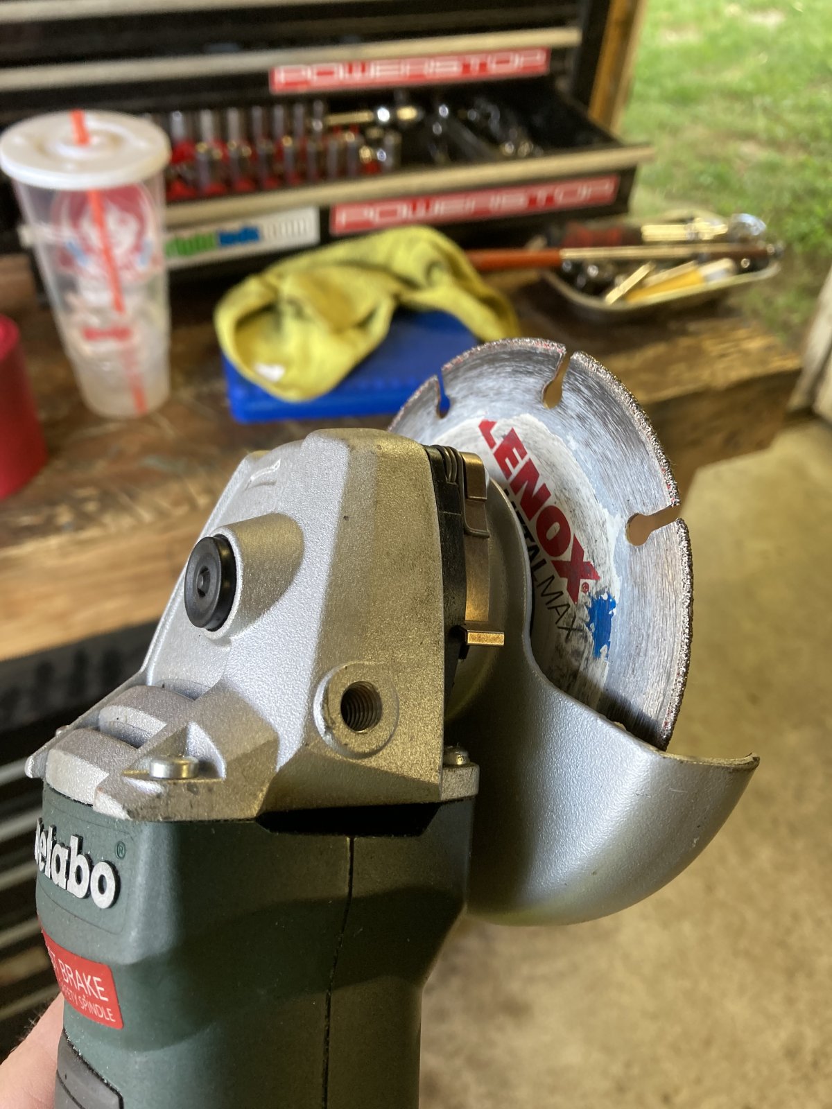

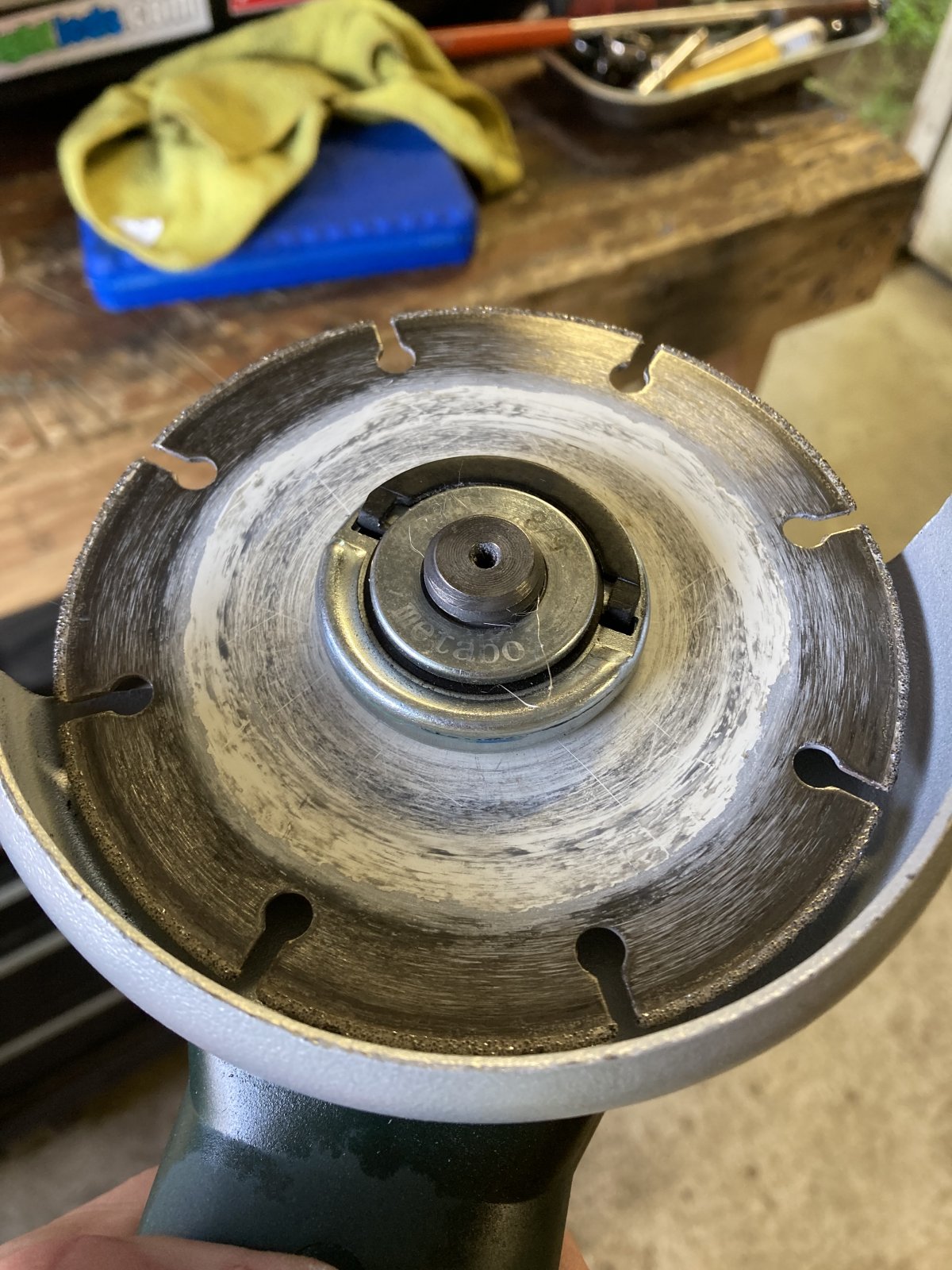

Or a single diamond cutting wheel. I can't tell you the last time I used an abrasive since I slapped one of those onto my grinder. It's been well over a year for sure. I was always waiting for one of those abrasives to grenade may ass to shreds. Many time they got caught and snapped into pieces on me and I got lucky. I still have a box of them for backups but the diamond one has been holding up very well. Definitely a lot less anxiety tearing into some steel.

I always thought the diamond ones were for masonry. I don't like the abrasive cut-off wheels from HF since they're thin and wear too fast. But, if just for this project, they'll be fine. Experience and PPE is a must. I use a cut-off wheel as my scalpel and the best ones I've found for the money are DeWalt. I'd have to look at one in the shop to get the exact model number. I sliced an entire door of a safe in half with only 1.5 of the DeWalt discs. I should see if Project Farm has a test on them. I think he does and I've probably seen it.
Here is the one I have, I think Diablo makes them too.

I've had good service from Diablo and Lenox. I've probably seen those and just assumed they were for masonry without actually reading the labels.
I use Lenox stuff at work never had any issues but Diablo has been ️ for me
