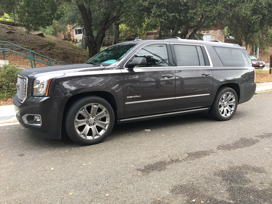

This customer had a mcgaughys kit and disliked the kit alot so he wanted to start from scratch.
I ended up swapping everthing to my kit and as soon as he drove down the street was muchhhhh happier.
I will be going lower (my strut mod front plus rear adjusting autoride another 1.5 lower) since he wants to go to 24s.
I've tested all kits out there and hands down for price and drop my combo by far works the best in magride or non magride 15+ suvs.
Kit used and if you have questions just ask.
http://www.tbssowners.com/store/index.php?act=viewProd&productId=609

Looks really good. How is the rear set up with your kit to achieve the 3.5” rear drop?
CMoore711
Jul 18, 2017
1,586
1,526
Does the rear of this Denali XL have the Heater Hose Mod WITHOUT the stock spring isolator put back in here to achieve the 3.5" rear drop?
  • Rear Belltech 5305 Coils
  • Rear Belltech shock extenders
  • My autoride links (if needed for autoride trucks)
  • Rear shorter endlinks which relocate swaybar
  • Rear bumpstops for free travel mod
  • Rear 5/8 heater hose for springs
I just want to confirm installing everything in this kit for the rear as listed gets you the 3.5" drop in the rear.
