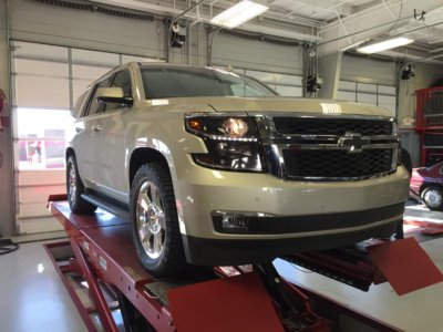

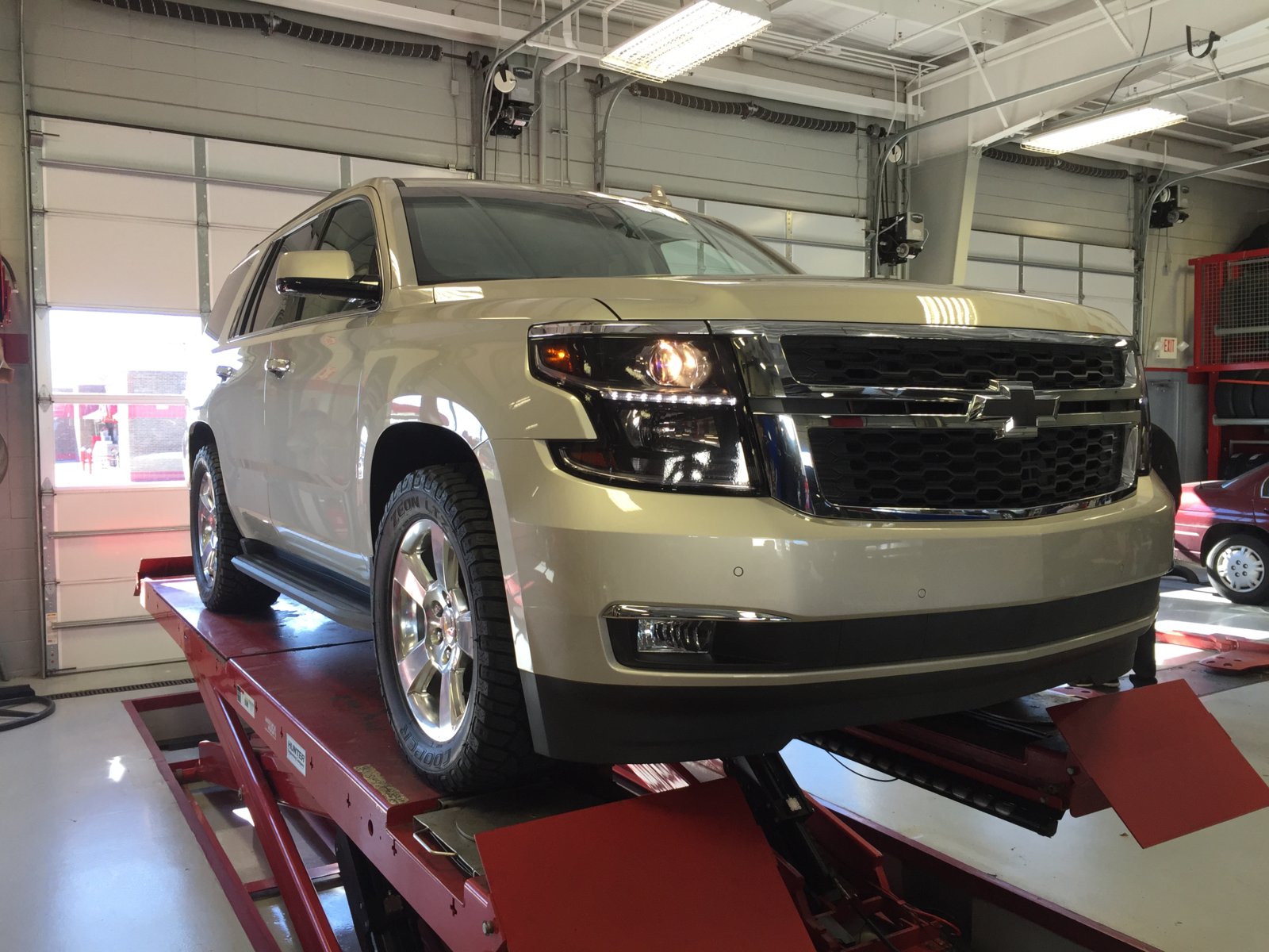

Sorry, just saw your question. Mine is kinda Frankensteined together. I went with McGauhy’s rear 2”, and then the 2” front drop cups with two spacers (supposed to drop 1”). Found out the front dropped too far (for me) and the stock front struts sucked, so I ended up putting the cups on Bilstein 5100s raised to their highest setting with one spring spacer installed.
Ultimately, if I were to do over I would go with McGauhy’s rear 2” and front 1” drop springs, Bilsteins all around (if Arnott still has them for the air rear), a Spohn adjustable pan hard rod (which I ave), and Spohn lower trailing arms (which I want).
The pic shows the Tahoe on the alignment rack in the final configuration-about 35” from ground to fenderlip in front and about 35-5/8” in back. Equals approx 1” drop in front and 2-1/8” in back (used heater hose trick per Nocal SS).
