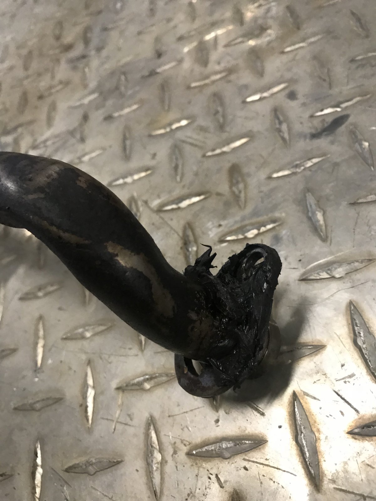

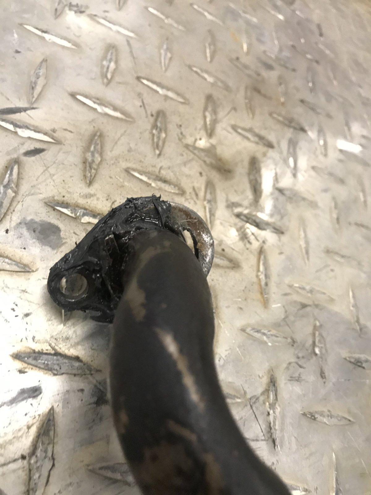

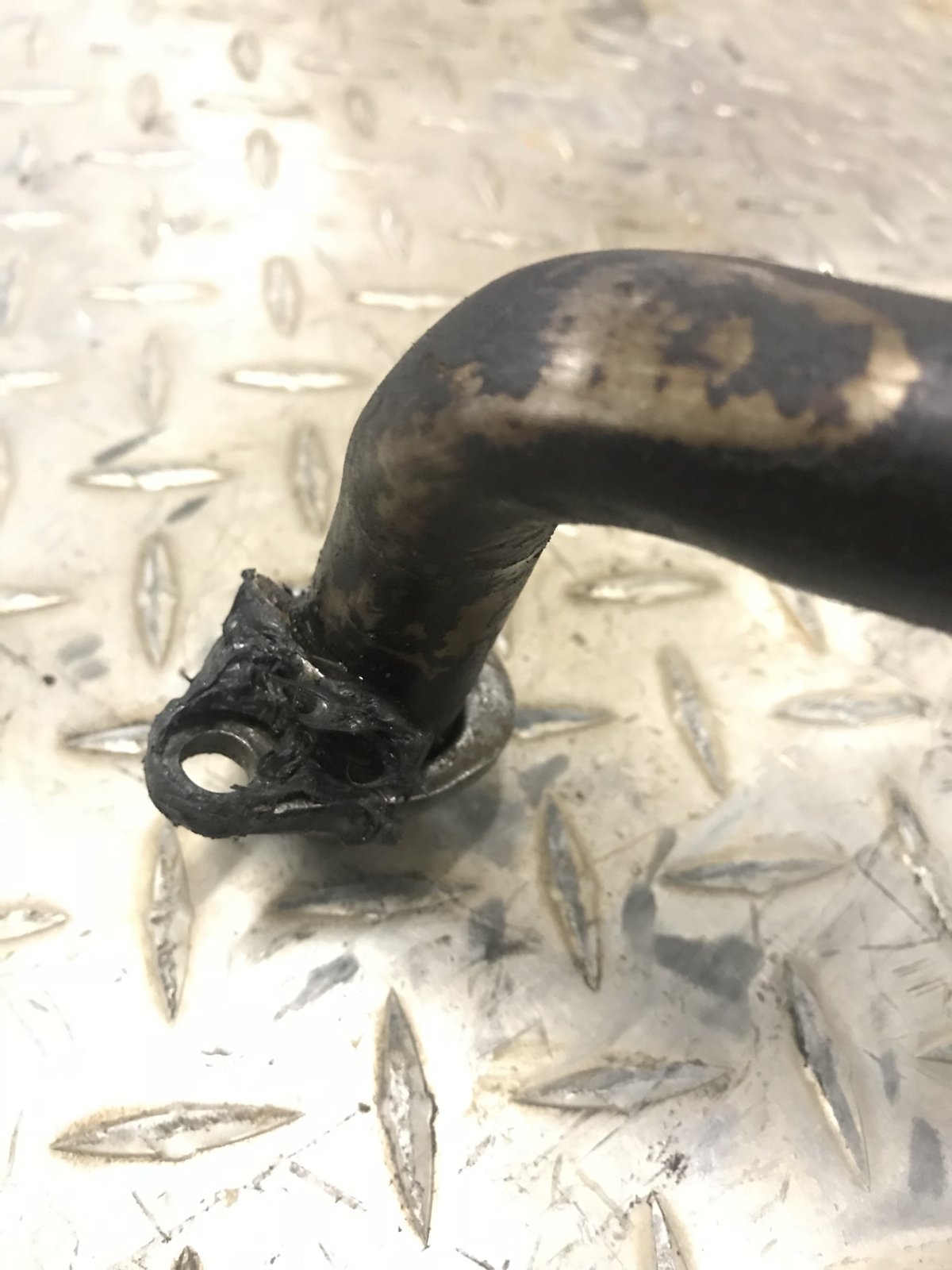

I wish I would of ordered a new Oil Tube because they are cheap and would of been nice to have a new one after doing all that work but most people probably don't think of it so you clean up the old one the best you can and get your truck back on the road.

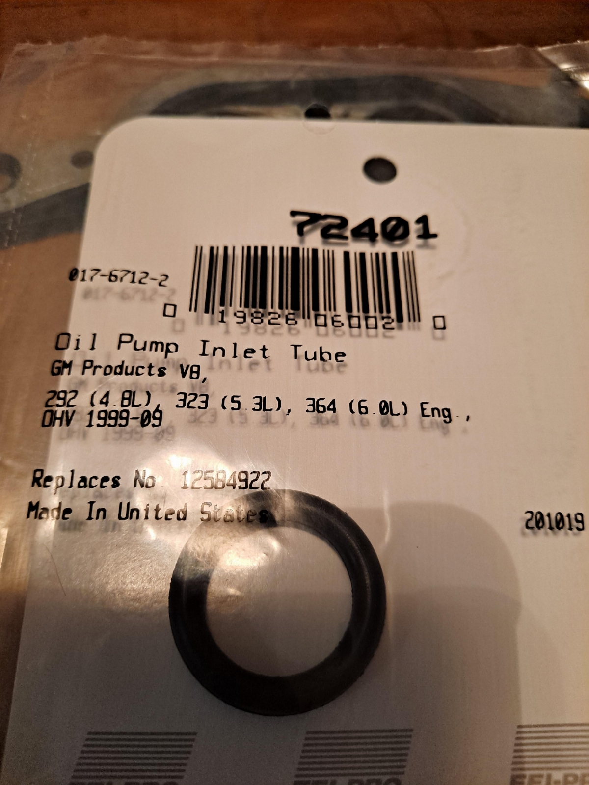

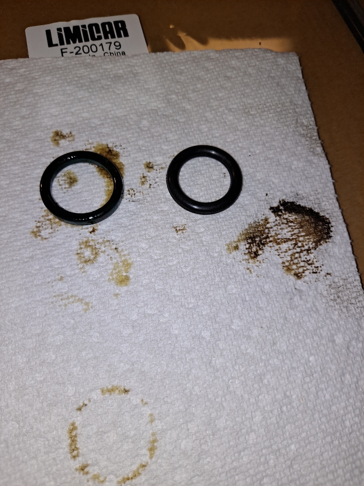

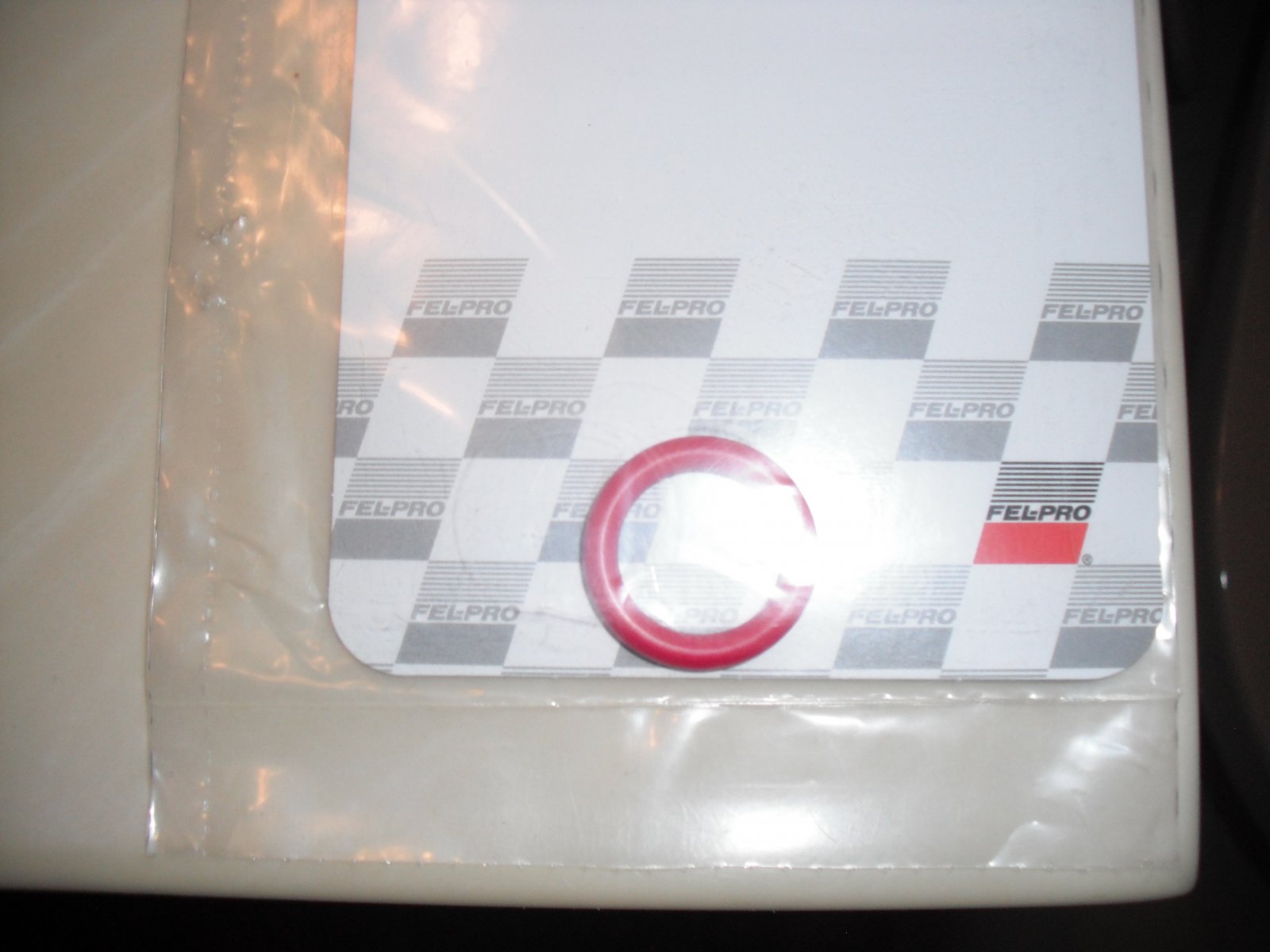

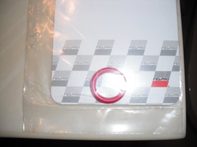

I'm doing this tomorrow and will update afterwards. I received my Felpro o-ring from Amazon. It was black but the correct part number with manufacture date 10/19/20. Other pics on amazon reviews show a red o-ring and their bags are dated 2019 and earlier. I called Felpro and the guy said I was not the first to ask about this and he was waiting for an engineer to answer him... I need the truck ASAP, so I might see it it fits.

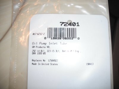

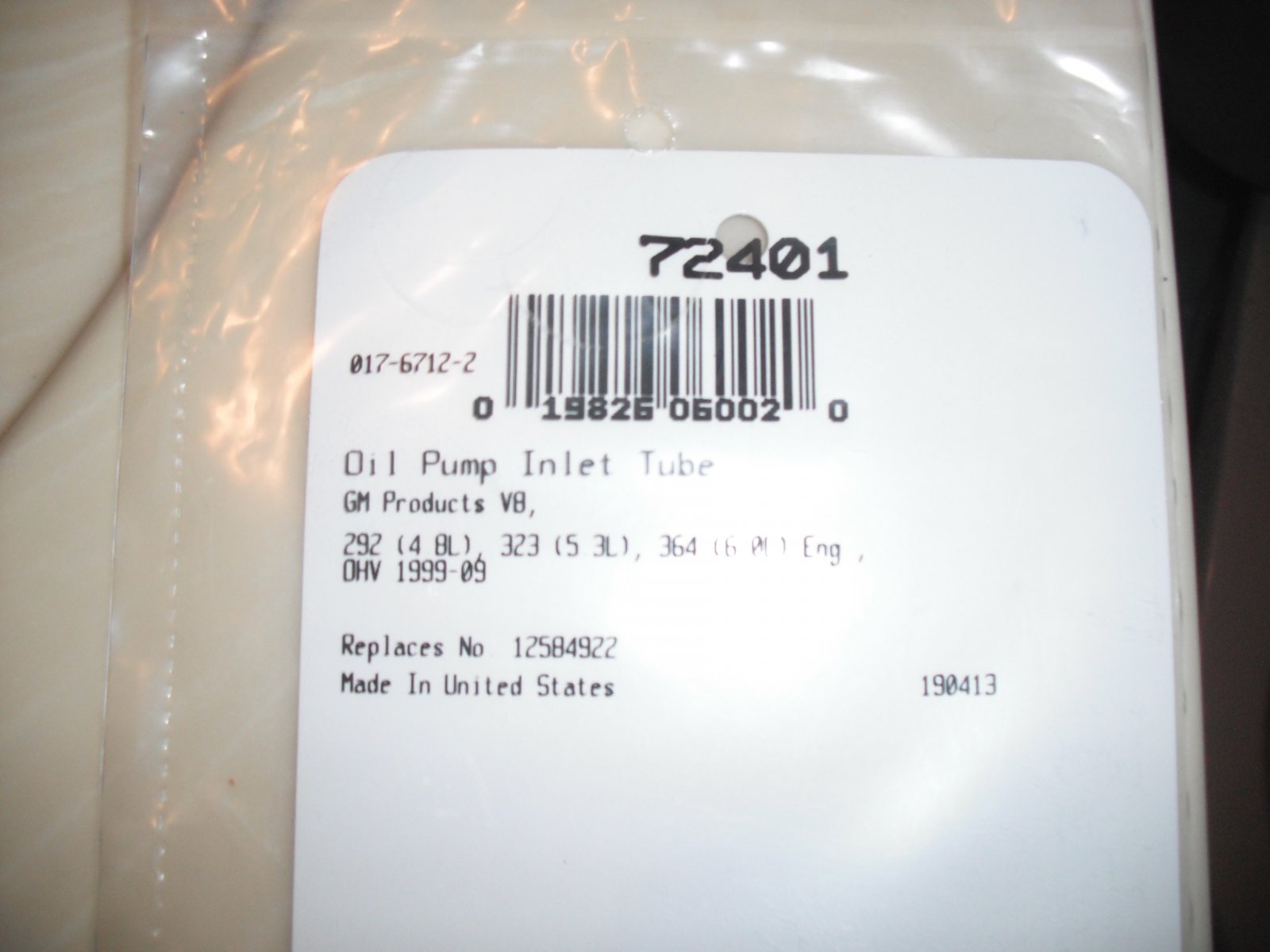

DSCF3847.JPG DSCF3848.JPG Replaces GM; 12584922. These are available at most auto stores.

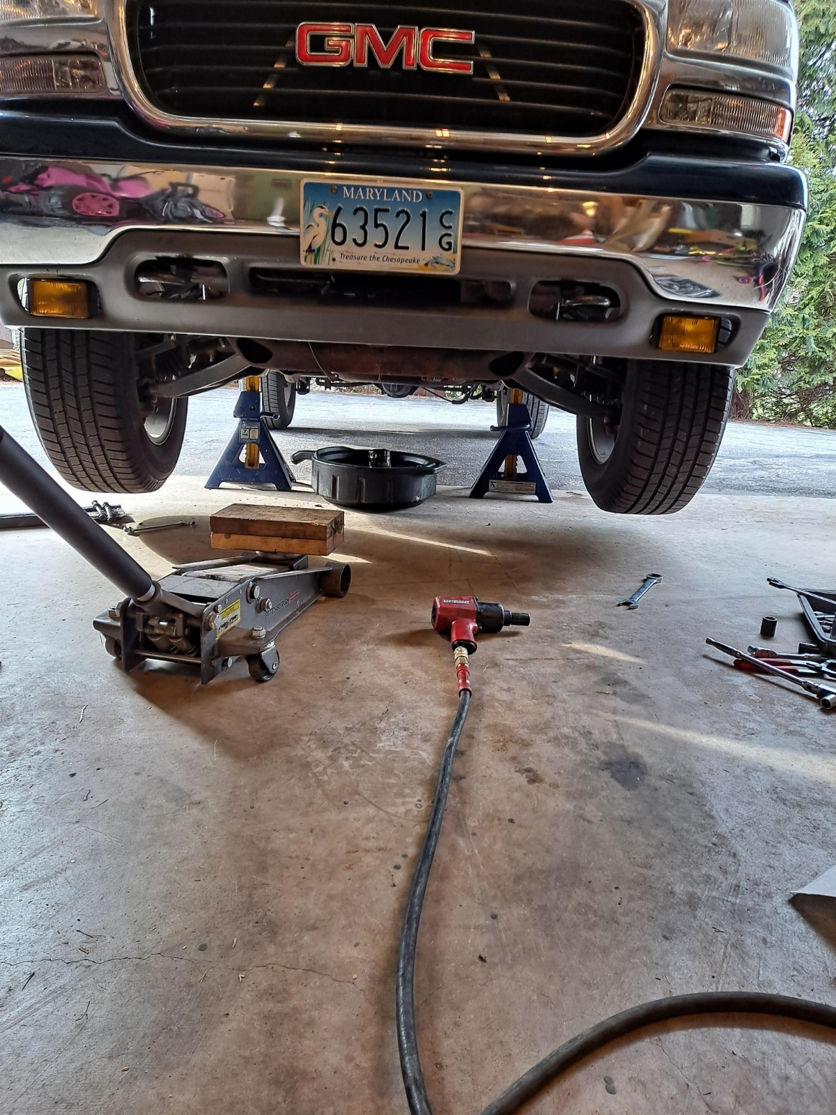

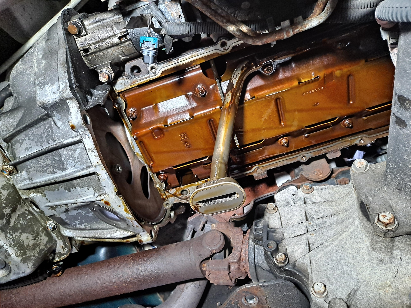

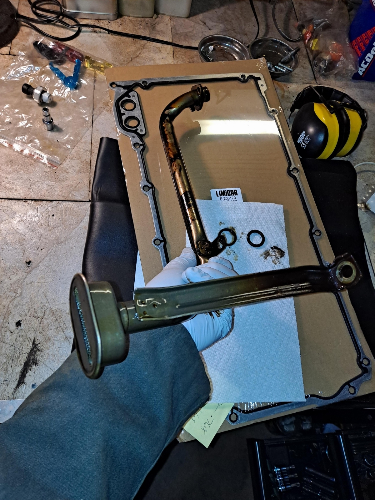

Thanks. I installed it yesterday. 4.5 hour job, even with air tools, with wasted time cleaning the oil pan and aligning oil pain and gasket together.. it world take much longer with only hands tools. 2 zipties helped to keep the gasket aligned and a dollop of RTV on block at cornes for frontand rear covergaps .. Dropping the axle down is simple enough, 21mm ratcheting wrenches make it easy for driver's side mounts. At 285k I had very little sludge and the color of the engine internals were honey/ golden brown, which in my opinion is pretty good. Many of the YouTube videos I watched had dark brown almost black pan and engine internals. It's had synthetic oil is whole life and it shows.
I measured the specs given to me by Felpro and the black was same using my digital calipers. My date code is newer than yours.
My pressure was at 40 at cold start. Dropped to 30 and was bouncing around erratically , I will install the new pressure sensor next week. Maybe that's the problem??? No oil drips or leaks underneath after letting it idle for 30 min so my terrible leak is fixed. I'm not 100% satisfied, I'll find out next week. Even in the cold start and not priming oil pressure by pulling fuel pump relay there was no clatter of the lifters. In trying the Costco Kirkland 5w/30 full surgeon for first time and usual Napa gold/with filter.

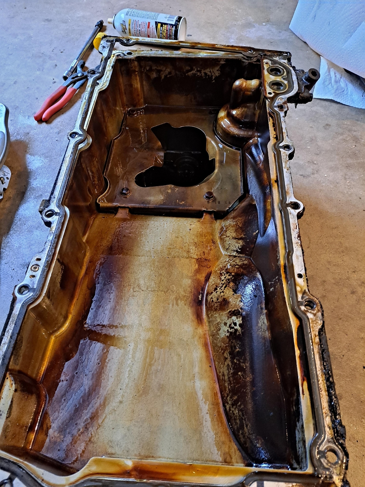

As you can see not all the oil drains out of the oil pan and it's nice to clean all that out while you have it off. I went as far as going to my local car wash with car ramps and washed off all the oil and grime under the entire engine, the front of the oil pan and the crossmember which helped keep me and my floor a bit cleaner. I also removed and cleaned the tray that is below the bottom of the engine.
