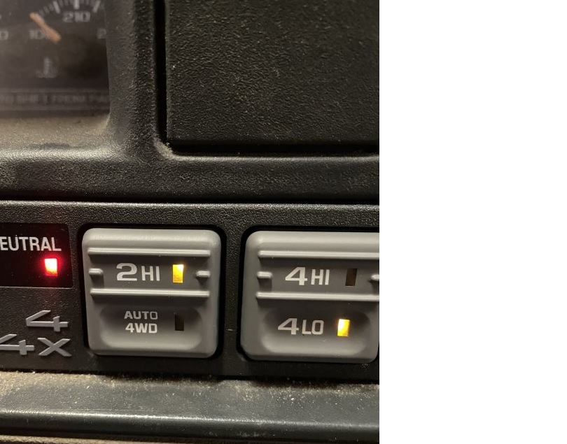

I didn't get the results I expected. Where the old one would flash into 2hi- 4hi (but not 4Lo) and pick one and stay, the new one has a solid Neutral, 2HI and 4LO lights and nothing seems to switch back and forth. Those three lights are solid. I did have to manually move the transfer case lever to Neutral with a 15MM wrench. It bolted up fairly easily after that.
I'm at a loss at this point.

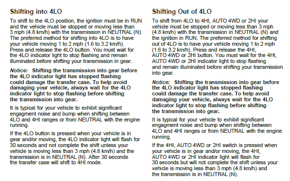

Is your 4Lo mode commanded like the later models? (tranny in neutral, ignition in run position, slow or no speed, etc.) This is from my '04 with the Auto transfer case NVG246:

Yup. Have to be in neutral, slow speed, etc..
