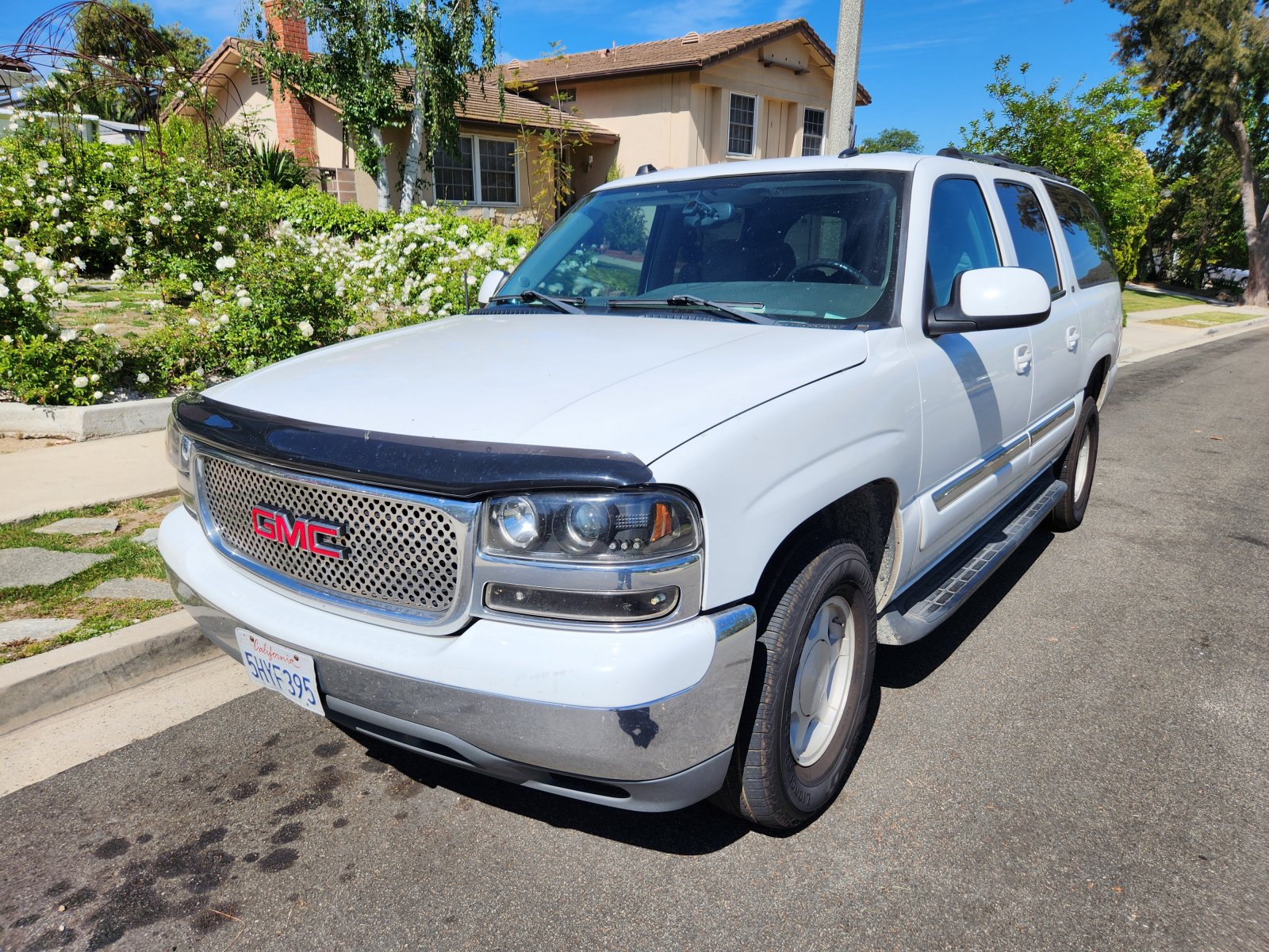

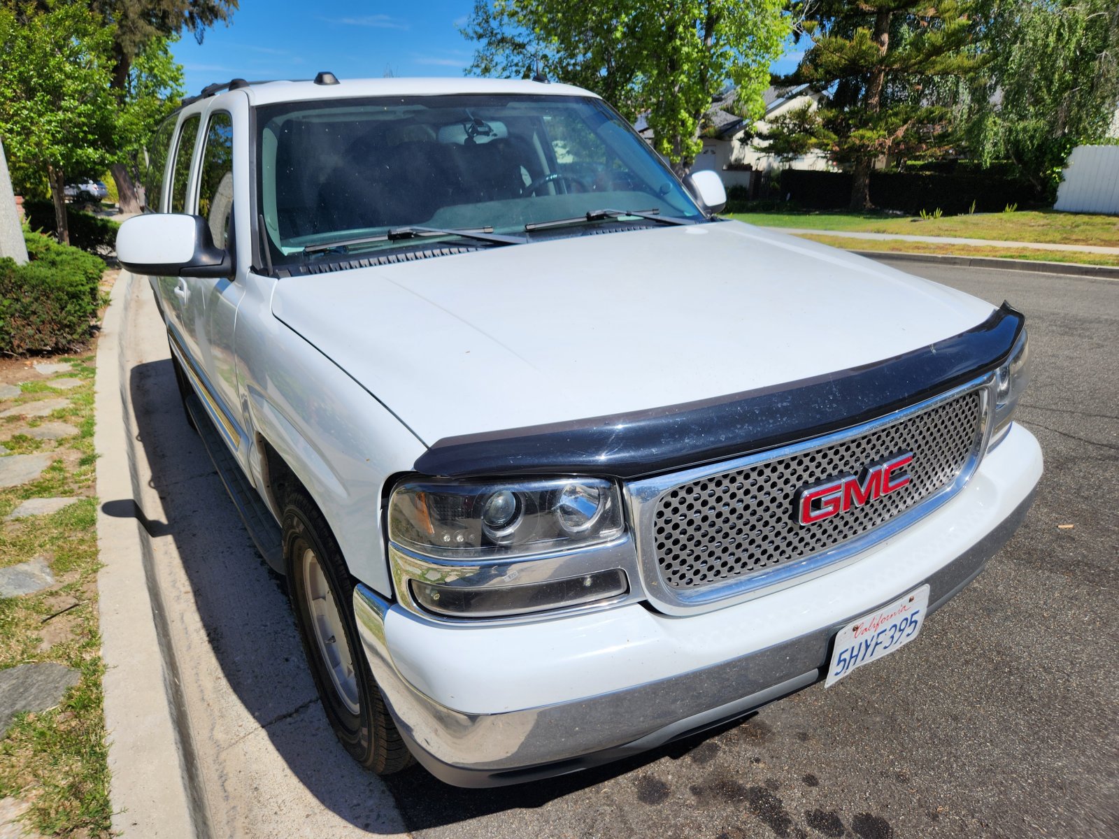

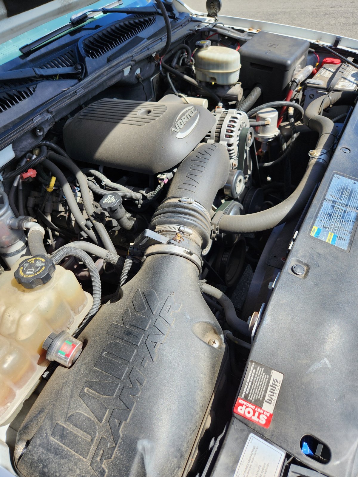

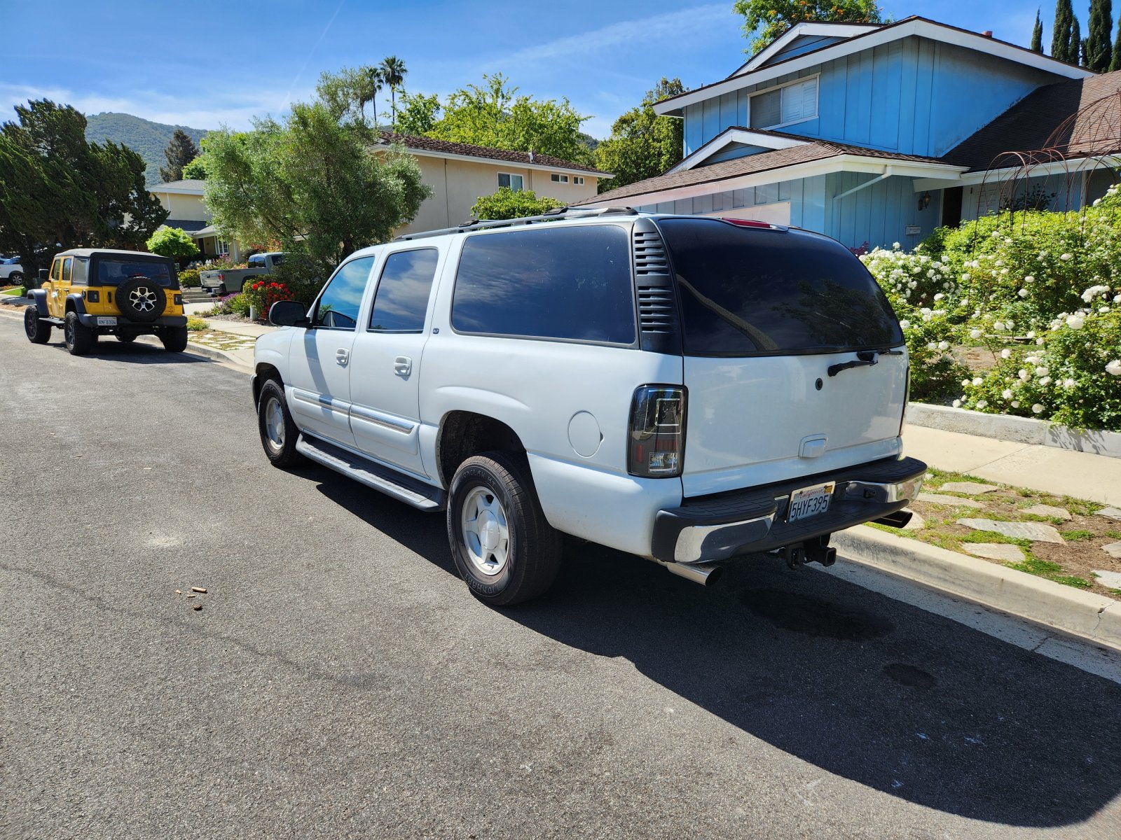

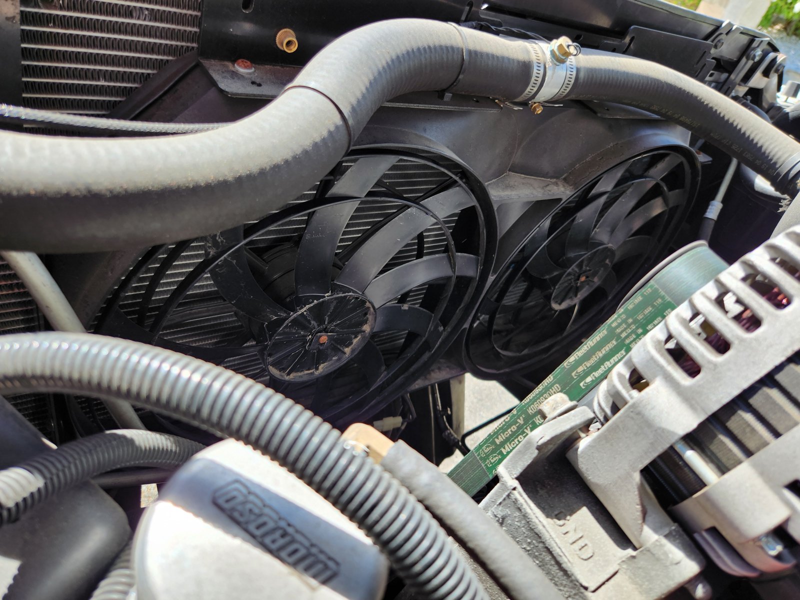

@Joseph Garcia , truck shots below. Iin terms of mechanicals since purchase we've swapped out the mech fan for a dual 16 and the stock radiator for a 3-row aluminum, added the oil cooler lines, upgraded the oil and water pump to push more of both, changed out the wheel hubs, installed Bilsteins all around, upgraded the rear springs to a longer cargo spring, Banks CAI, full dual exhaust from the heads to the tailpipes, transmission was rebulilt, and the usual sundry parts as they've failed (TPS, MAF, 02's etc.) The intent with the vehicle is long-distance reliability in very warm climates, as we take it out on the road every summer. Last time we loaded out we totaled about 1600 lbs in with five people and an XL top box, and the setup handles that with surprising grace.
1000005624.jpg1000005623.jpg1000005625.jpg1000005626.jpg20250511_102740.jpg1000005629.jpg
View attachment 456922View attachment 456923View attachment 456924View attachment 456925View attachment 456926View attachment 456927

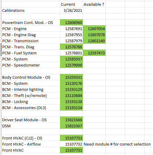

Your seat issue may be a problem with the BCM or the DSM, not the PCM. There are multiple calibrations for the various modules and sub-systems. Here are a few of the calibrations that I verified and updated on my '04 (L59 engine):
@Fless , that's very interesting. Thanks much for this, would get my vote for a tech sticky (if you folks do that kind of thing here). What's really got my attention are those last three entries--ultimately, that's kind of what I was asking about. If there are custom selections for HVAC calibrations, and they corrupt or get out of alignment, could explain some of the ongoing issues related to how the whole system functions (or doesn't). Will research that further.
