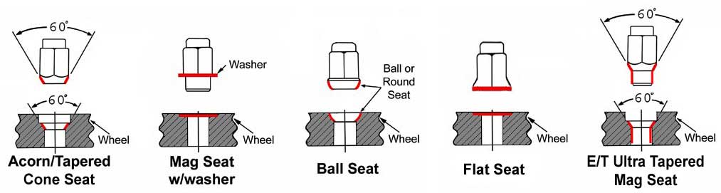

No thread locker. Torque to proper spec. If you have one of the old lug nuts compare the taper at the bottom of that to the taper on the new lug nuts. Should be the same. The TPMS is something I am not familiar with, don't have it on my rig but someone here will know. I think you have to reprogram with a Tech 2 maybe? The tire shop should have reset for you, if they had that capability.

Do not use thread lock on your wheels... you need to check the seat on the rims and the lug nuts to make sure they are correct for each other...

The lug nut style needed depends on your new wheels. Your old lug nuts may not seat properly, but the tire/wheel shop should be able to determine if you have the right ones to match the wheel.

At this point you also need to make sure the wheels are not damaged where the lug nuts seat. The shape could now be damaged and the hole hogged out some.
