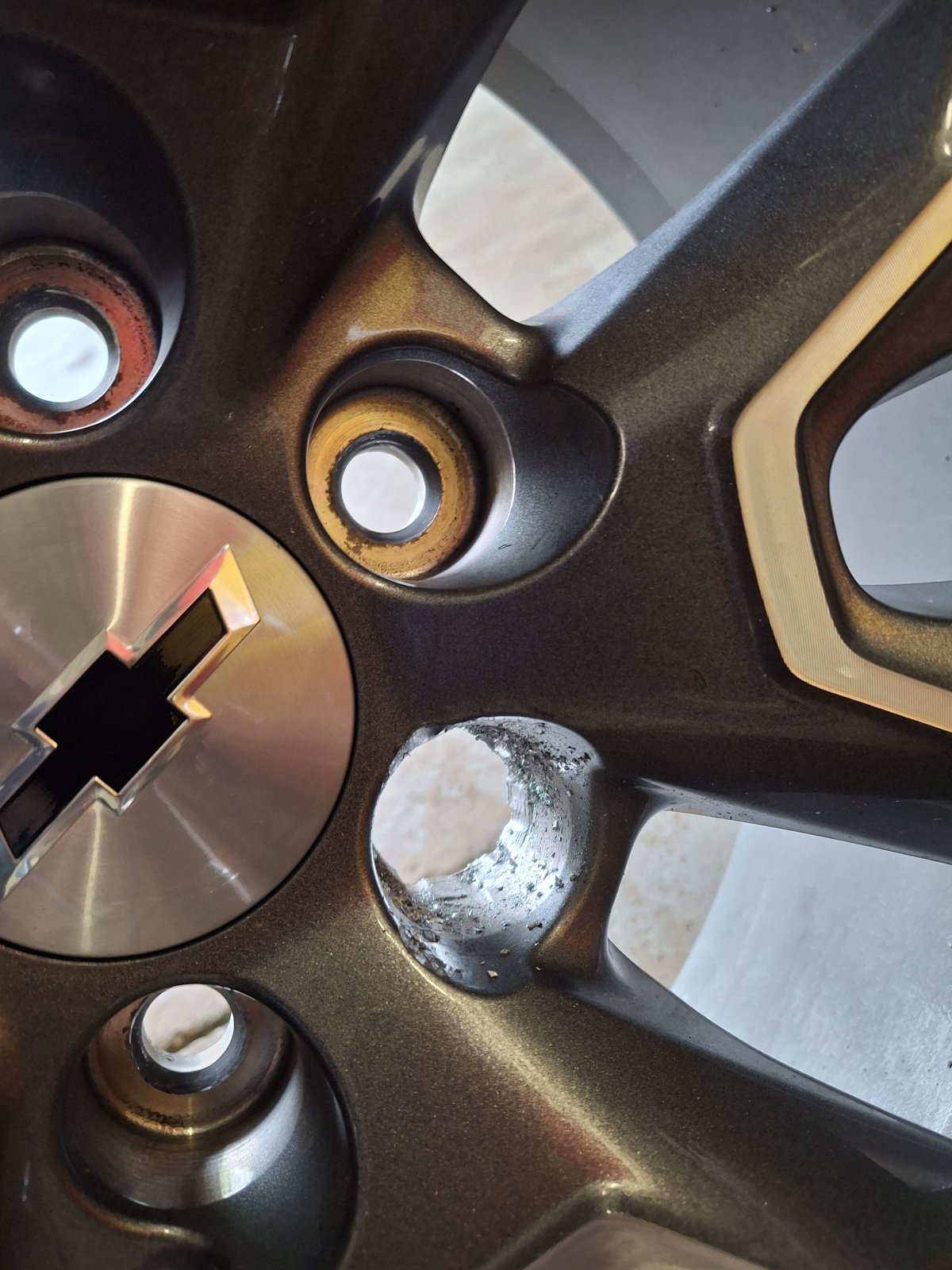

I second @Scarey and say don't deal with them. They can be a royal PITA if they are over torque, loss of key, etc. My Denali came with them and I ditched them after the first tire rotation. See pics of what can go wrong - my doing a favor for a friend resulted in buying a new wheel because the locking lug nut broke upon removal......
