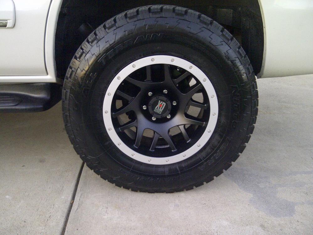

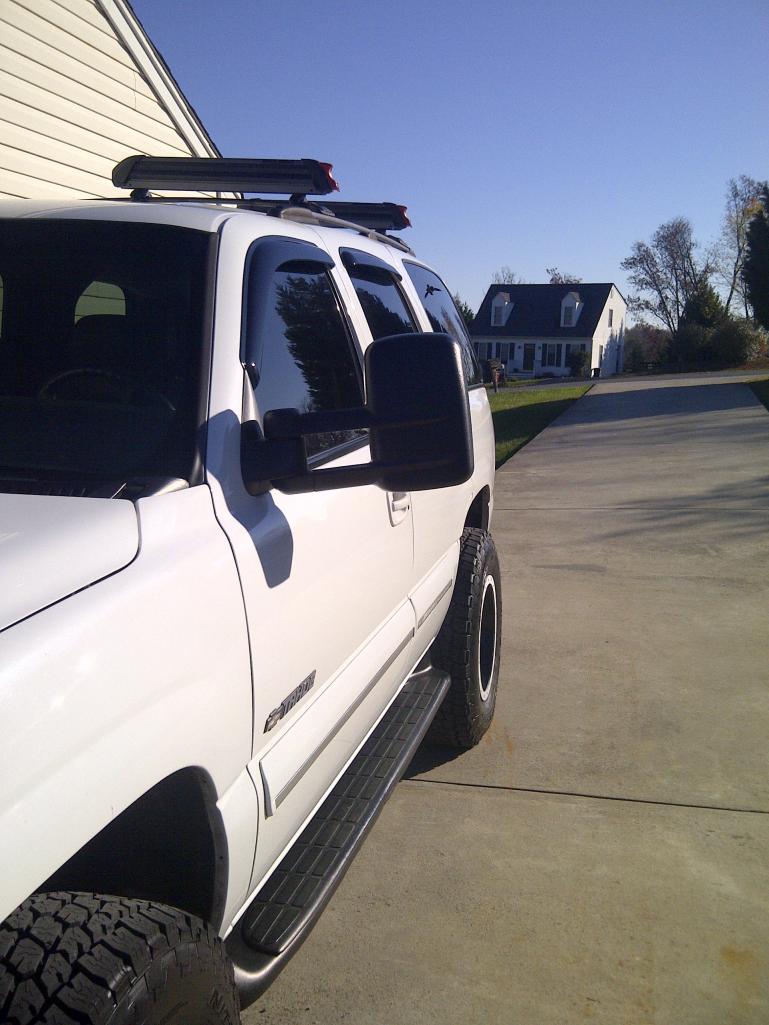

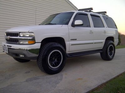

Keys up front with stock shocks for now, 2 inch billet spacers, removed auto-ride and put airlift bags in coils and just bought some cheap shocks for now. The wheels are 18x10 KMC XD Bully's with 295/70 18 Terra Grappler tires (34.4/11.6). The offset is a little more than I wanted, but I got a killer deal on the combo. I have some oem style fender flares being painted now that should help. I had to cut the shit out of my front bumper, inner fender, and running boards to not rub, but it wasn't too bad.
Got some 2500 HD mirrors too.

They are Yakima Big Powder Hounds for snowboards. Thanks guys
