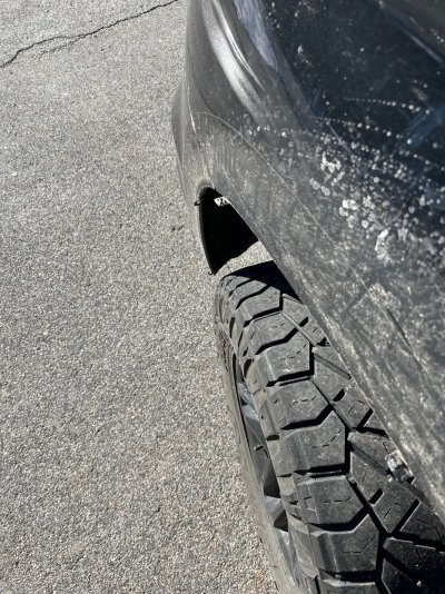

Here's the front wheel well before trimming, with fender flares removed. The fender flares actually stick out from the vehicle approx. 1/2-3/4" and also extend over the OE body. When wheels are turned straight, I had about two fingers of clearance or approx. 1.5". When I turned the wheel to the point of MIN CLEARANCE, I measured about 1 finger or 3/4" of clearance. The point of MIN CLEARANCE was actually not very far from wheels straight...
ORIGINAL Tahoe Front Wheel - Wheels Turned to MIN CLEARANCE - spacing 2a.jpg
ORIGINAL Tahoe Front Wheel - Wheels Turned to MIN CLEARANCE - spacing 2b.jpg

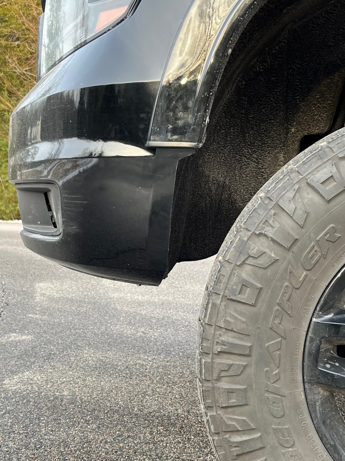

Following the trimming of the front wheel well, lower front valence and front fender flares, I now have realized a great deal of space to allow for increased articulation over obstacles and care-free driving when approaching them. I measured approx. 3.25" of clearance now with about 2.5" of clearance at the MIN CLEARANCE point. That's actually about 115% increase over original setup!
In order to accomplish this trimming and spacing, I used the BDS Suspension front trimming instructions and modified to suite my needs. BDS Instructions here: https://bds-suspension.com/instructions/021307-021309.pdf
