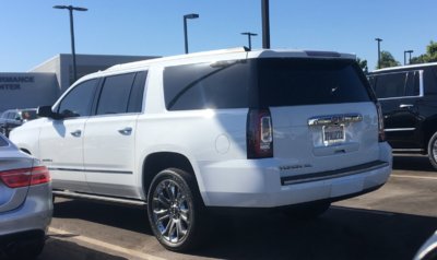

I recently bought this 2016 Yukon XL Denali 4wd used with 60,000 miles (clean carfax, regular oil changes, local 1-owner, very clean) from a local dealer who got it in on a trade for a 2019 Navigator. I was happy with it until I started to notice two issues 1) Chevy shake (like driving over rumble strips) at varying speeds from 35 - 55 mph. I think this is it PIP5337E. 2) Very stiff suspension (rides like my 96 F 250 did). For a truck that stickered at $75k new, this is pretty frustrating.
Here's the steps I've compiled to fix the Chevy Shake. What have I missed or is anything out of order? Am I looking at big dollar signs here?

Pic attached of it sitting at the dealer before I bought it.
