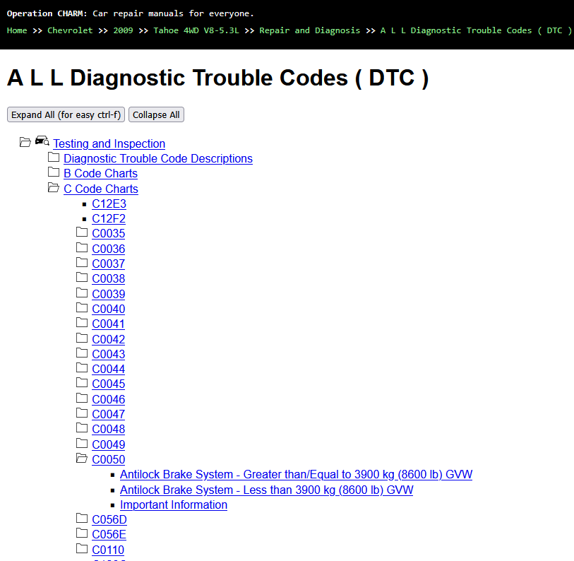

Go to the link below and verify that this is your vehicle, then expand the Testing and Inspection link, and the "C Code Charts" link, and scroll down and expand the C0050 code. There you'll find diagnostic aids for the specific code. Note that some codes have suffixes that can help narrow down the issue, if your scanner can show them.
